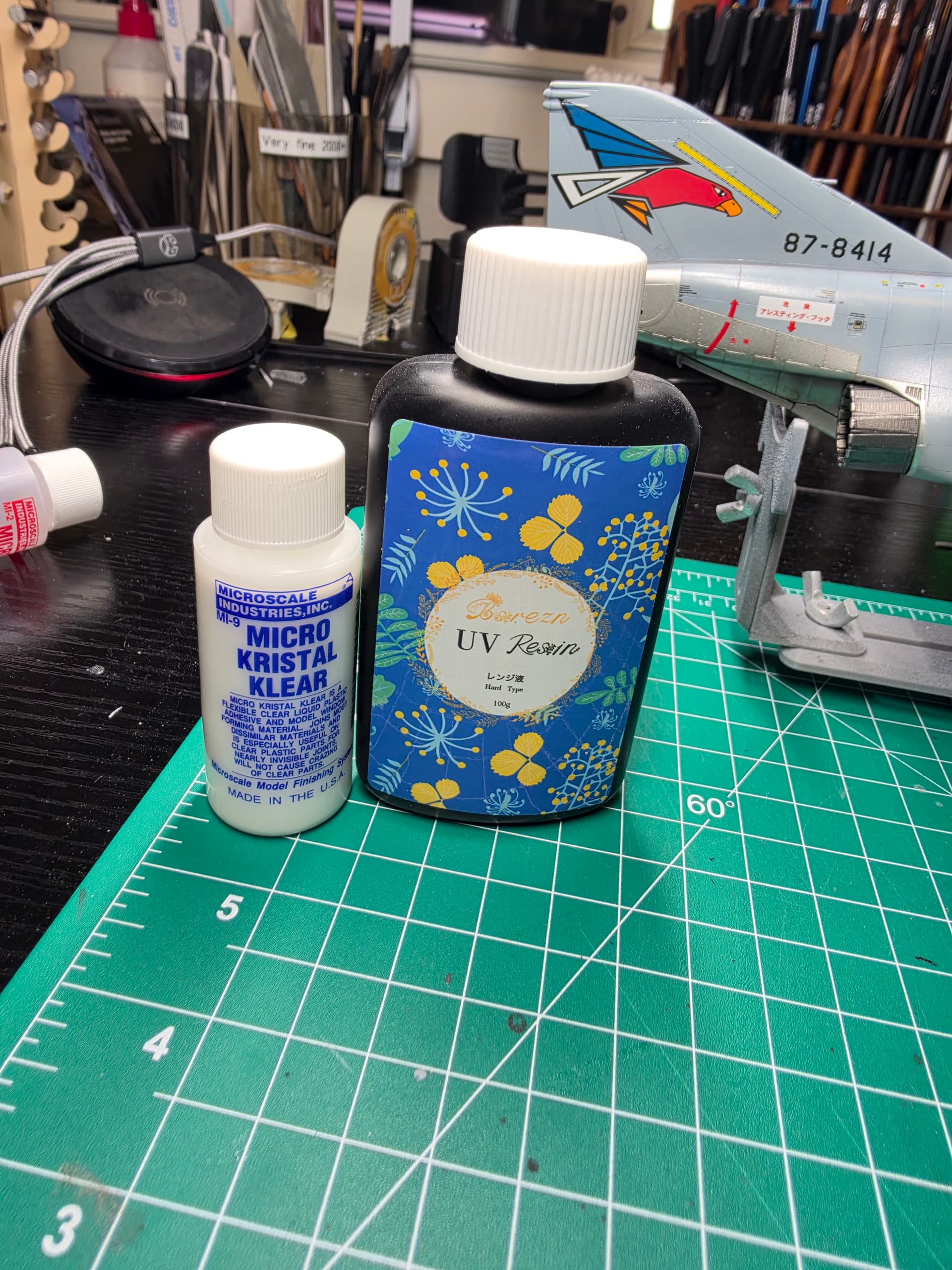

For windows and other clear parts, these are the two products I use. Micro Kristal Klear is made for exactly this kind of thing, and I also sometimes use UV resin. Both work really well for attaching windows and canopies without leaving the residue you can get from regular model cement or CA glue.

I do like the UV resin for things like lenses because I can control exactly what shape I want before hitting it with the UV light to cure it instantly. Thanks for the tip!
