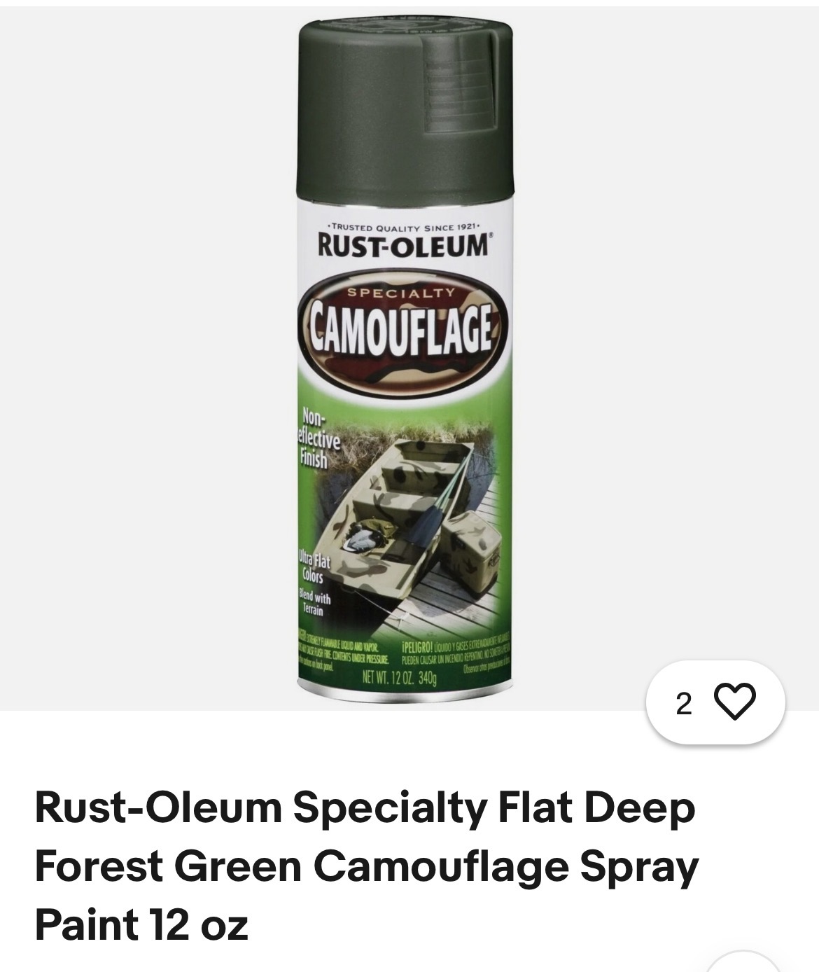

Different subject but curious to know your opinions. Regular spray paint. Krylon, Rustoleum, Do It Best flat black best spray paint ever made. I’ve had no issues using these spray paints on models. Other than they clog up and stop working if you don’t use the entire can in one setting. Forest Green Camo by Rustoleum makes for a most realistic look on a military helicopter. Krylon fusion has never steered me wrong building track cleaning cars for trains. I do note that the gloss paints have a tendency to run if you stay in one spot too long.
I’m assuming this is the Paint that you’re talking about. I’ve used it before, and it is the most ultra flat spray paint I’ve ever used. This stuff is great. Very realistic color too for helicopters
Well, I’ve seen guys paint entire 1980 Toyota pickup trucks with the stuff, so I figure if it’ll work on one of those, it’ll probably work on a scale helicopter model. :joy:
It does sound like the trick is to go easy with it, though. Some of those rattle-can paints use pretty strong solvents, and a heavy wet coat can apparently be hard on plastic or whatever you’ve already painted underneath. I’d definitely test it on some scrap plastic first.
That’s the one. Painted it straight onto the plastic, no priming or prep. I actually used it later as primer for the small parts. Then painted the stabilizer bar silver, the rotor controls gun metal, even painted over the tiny lights and anti-collision light with some dark red. Painted the rotor blades black with some Krylon Flat Black, directly over the plastic (no primer coat). Painted the seats and cyclics and collectives, and the deck and ceiling with primer gray krylon, then painted the individual parts with model paint. It appeared to take. Oh, one of the things the YouTube video builder used to paint small parts hard to hold, he used masking tape with the ends folded backwards so it would stick to his table, and then placed the parts on the sticky part that he intentionally made face up. He used an air brush sprayer but the idea was the same. Keeps the parts from blowing away.
