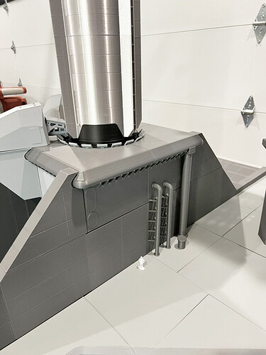

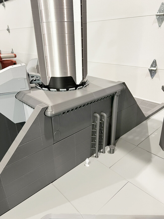

I think I’m finished with the Base and Flame Trench. A few water supply pipes for the deluge system were added.

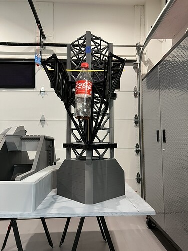

Yep, even in 1/72nd scale it would be five feet tall…

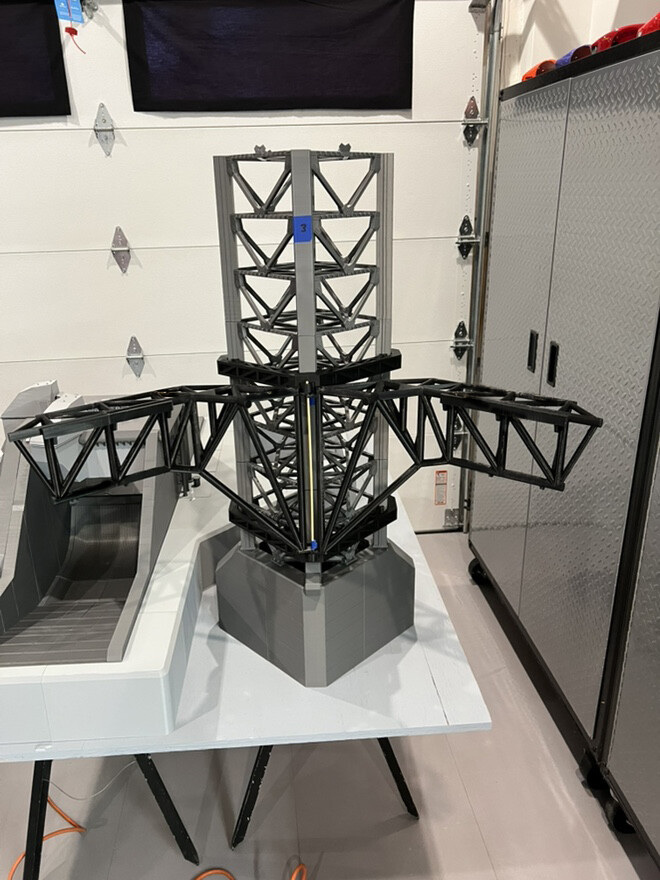

The chopsticks have been assembled, they were cut up into three pieces each in order to fit on my printer’s build plate.
I temporarily mounted them to the tower while the center support bar is still being printed.
I can now see why they cut the real ones shorter. The mass these things must have is incredible.

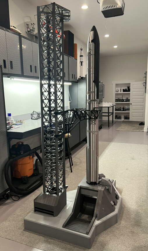

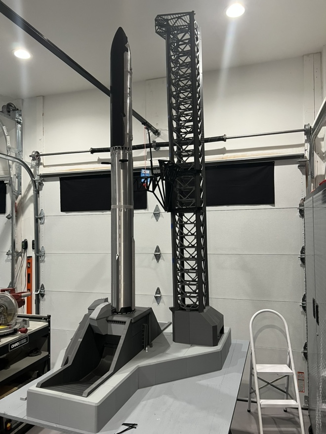

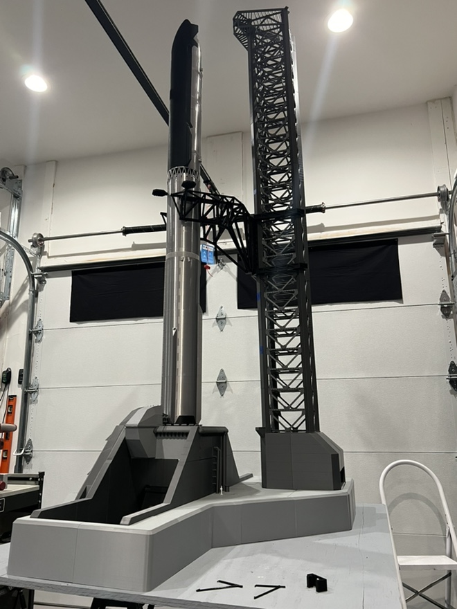

Full test stack complete and I didn’t knock it over. :+1: Chopsticks work and line up correctly.
I met my neighbor who lives down the street the other day, he worked on the International Space Station. He’s coming over in the morning to check it out, so I had to make it look presentable. :slight_smile:
BTW I installed a “C” clamp on the garage door track (see lower left hinge) so that it doesn’t get inadvertently opened and cut this thing in half.
Having your neighbor who actually worked on the International Space Station come over to see it would certainly give you a good reason to make sure everything is looking just right. :grin: You’ll have to let us know what he thinks of it.
The full stack looks impressive, George. Seeing the whole thing together really puts the size of this project into perspective.
And installing a C-clamp on the garage door track may turn out to be the most important piece of engineering on the entire project. :joy:

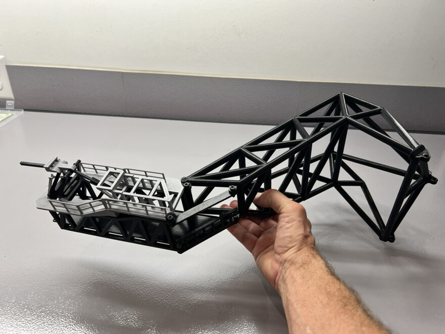

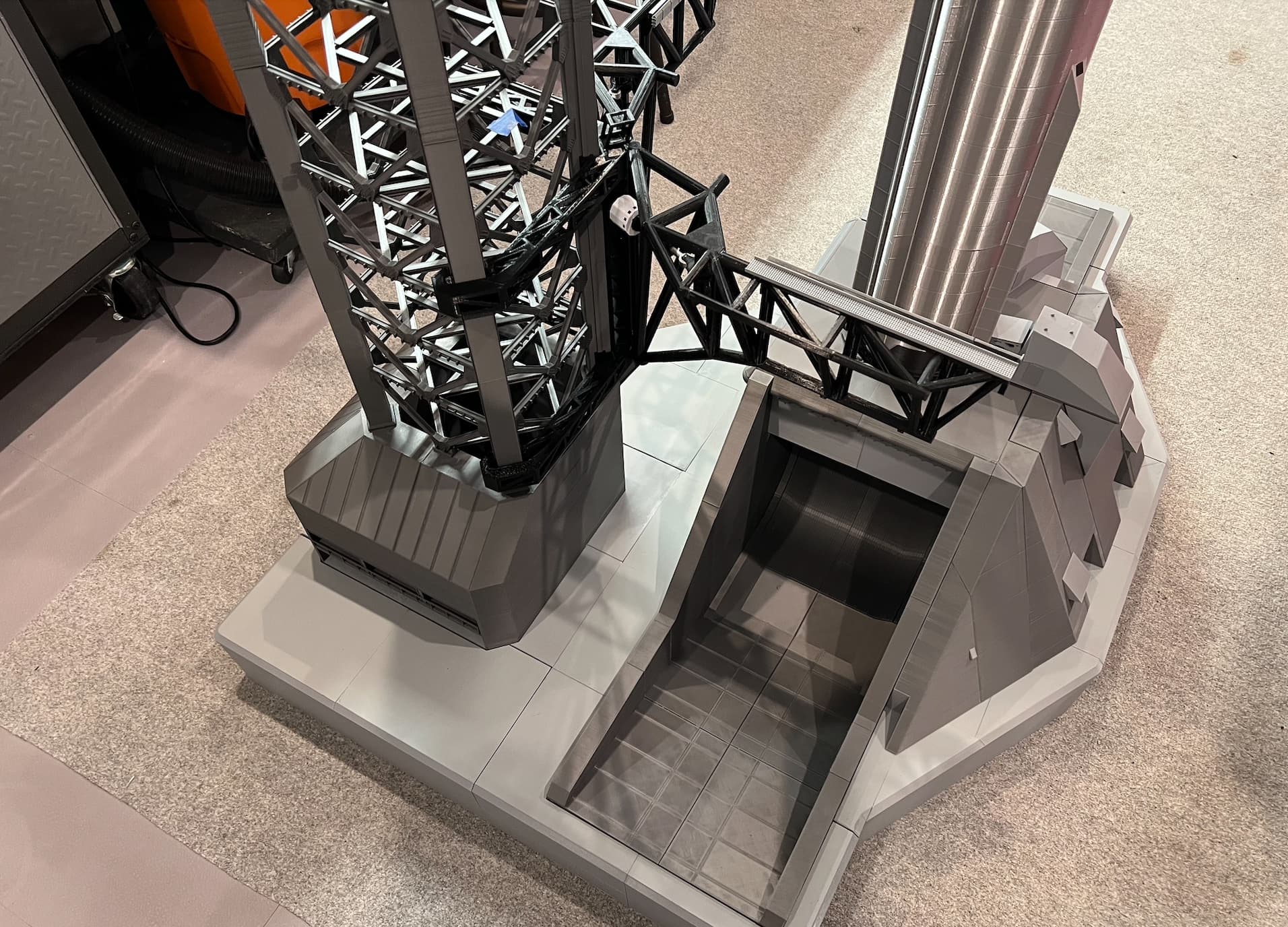

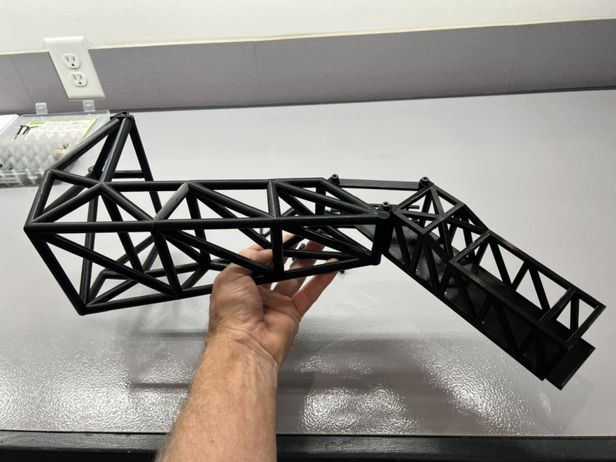

Here’s the main SQD Arm printed out,…and I’ve officially ran out of black filament. More is on the way but won’t be here until Thursday.

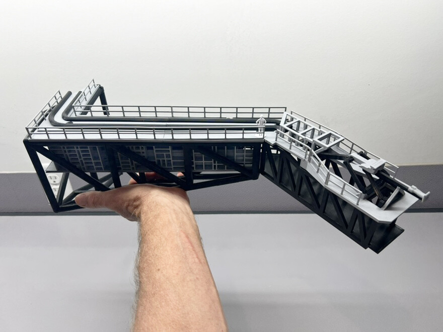

Here are some service platforms added as well as the part of the propellant QD mechanism

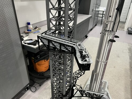

More details added to the SQD Arm, more to come after I go through my screen captures from YT videos.
This thing is getting heavy, hope my brackets hold.

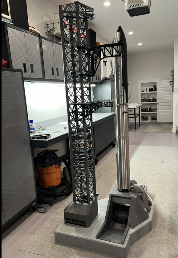

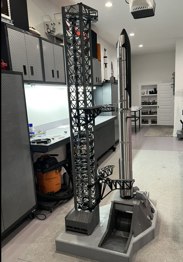

I archived a huge milestone today! All the arms are now attached and everything lines up as it should.
The Chopsticks slide up and down manually for now. Here they are in the lowered position.
And here they are raised to the upper position, not all the way up, I couldn’t reach it. The tower is not glued together so I had to be careful not to knock it over.
I started adding walkways and will be adding cable trays and various other details to the Chopsticks, I also started work on the Chopstick lifting mechanism pulleys and elevator pulleys up top.
I’m not sure how they run the cables, I do know they changed from 4 to 6 cables down to the main block at the Chopsticks.
