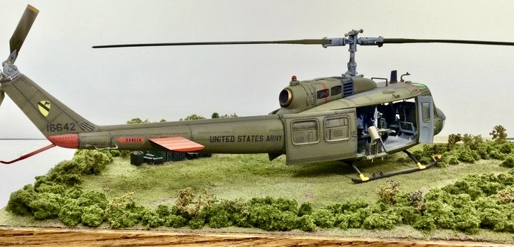

The Huey is my favorite aircraft. I flew in them a lot at Ft. Lewis, WA. (As a passenger, not part of the crew). Unfortunately, no model company makes a really accurate 1/32nd D/H model. Kitty Hawk made a good one, in 1/48th scale. My only complaint was the stabilizer dampeners. They were to high on the rotor Mast. I looked into building the Revell 1/32nd scale UH-1. (Until I saw the shape of the nose, and the rotor mast). I don’t think there is anyway to fix those two glaring issues. I did build the 1/35th scale Dragon UH-1, but had to do a lot of scratch building to make it better. (It didn’t even have a Jesus Nut on top of the main rotor). In the end, I threw in the towel on fixing anything else.
For the life of me, why can’t a company make an accurate UH-1. I know they would sell a lot of them. It’s 2026 for Pete’s sake!!!
