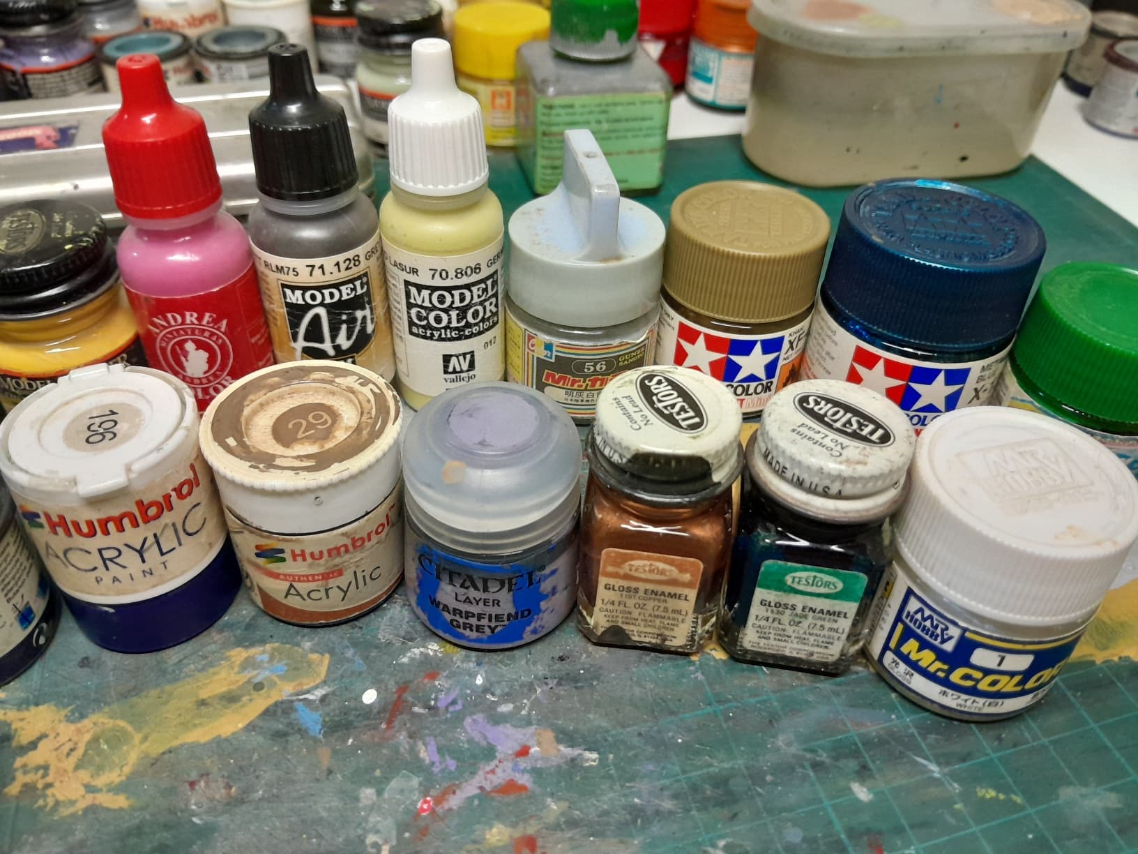

Whats your paint type choice, and why?
Hey :slight_smile:

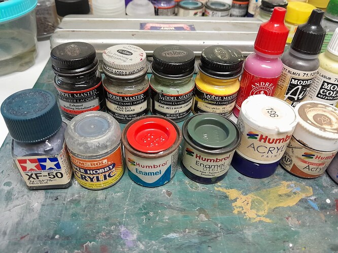

I generally use Vallejo, since I use their acrylics to paint the white edges of my paper model aircrafts.
I have few transparent paints from Mr. Color to imitate the red, yellow, green lights on the wings :thinking:
I prefer enamels. Brush well and spray well when thinned properly and produce a durable finish. ModelMaster was my go to. Since they’re gone I went to Mr Color. I think these are called solvent based acrylics like Tamiya X-# paints. MRP are great for airbrushing and Alclad II are my go to for natural metal finish.
I could never figure out the combo to get water based acrylics to work so I’ve punted on those. I have a few humbrol, testors square jar and Revell email enamles as well.
I just stick with Vallejo paints, the premium range I mainly use doesn’t need thinning for the airbrush and they coat well and so are cost effective. I can’t get on with enamels, I know they give a stunning finish but the drying times, odour and cleaning up i’ve found a hassle. But i’m open minded and if anyone can give an enamel/thinner/cleaner combination they’d recommend I’d appreciate it

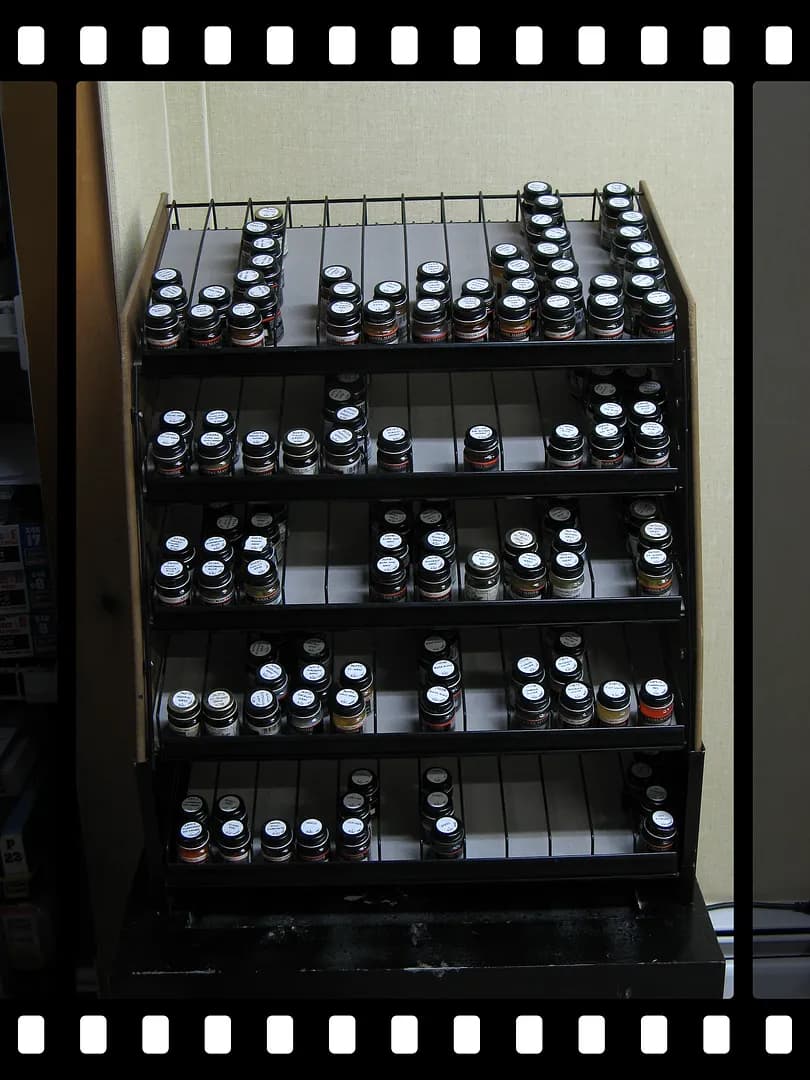

You know I suspect the reason why Vallejo lasts so long is because of their bottle’s tiny opening.
Ones in the picture I believe are more than 11 years on the shops shelf.
Still hand painting no problems. Happy I tried them.

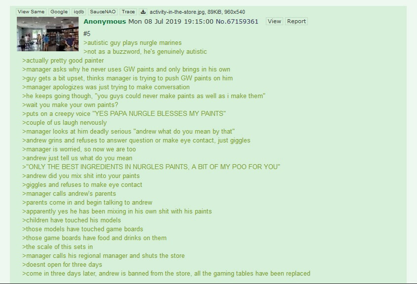

I figured the other gamers were wondering about the smells of my Master and Humbrol Enamels in thier Games Workshop while I was there building my miniatures among them. They hadnt seen anything like it :wink:
Believe it or not, that’s not the worst paint that’s ever been used in a GW…
What a nasty kid…
Out the window with him… :face_with_steam_from_nose:

I could have bingo cards made up with all the weirdest awful things I’ve ever read about modelling or, frankly, anything else… and I don’t think I’d have ā€˜feces in paint’ for the next hundred years.

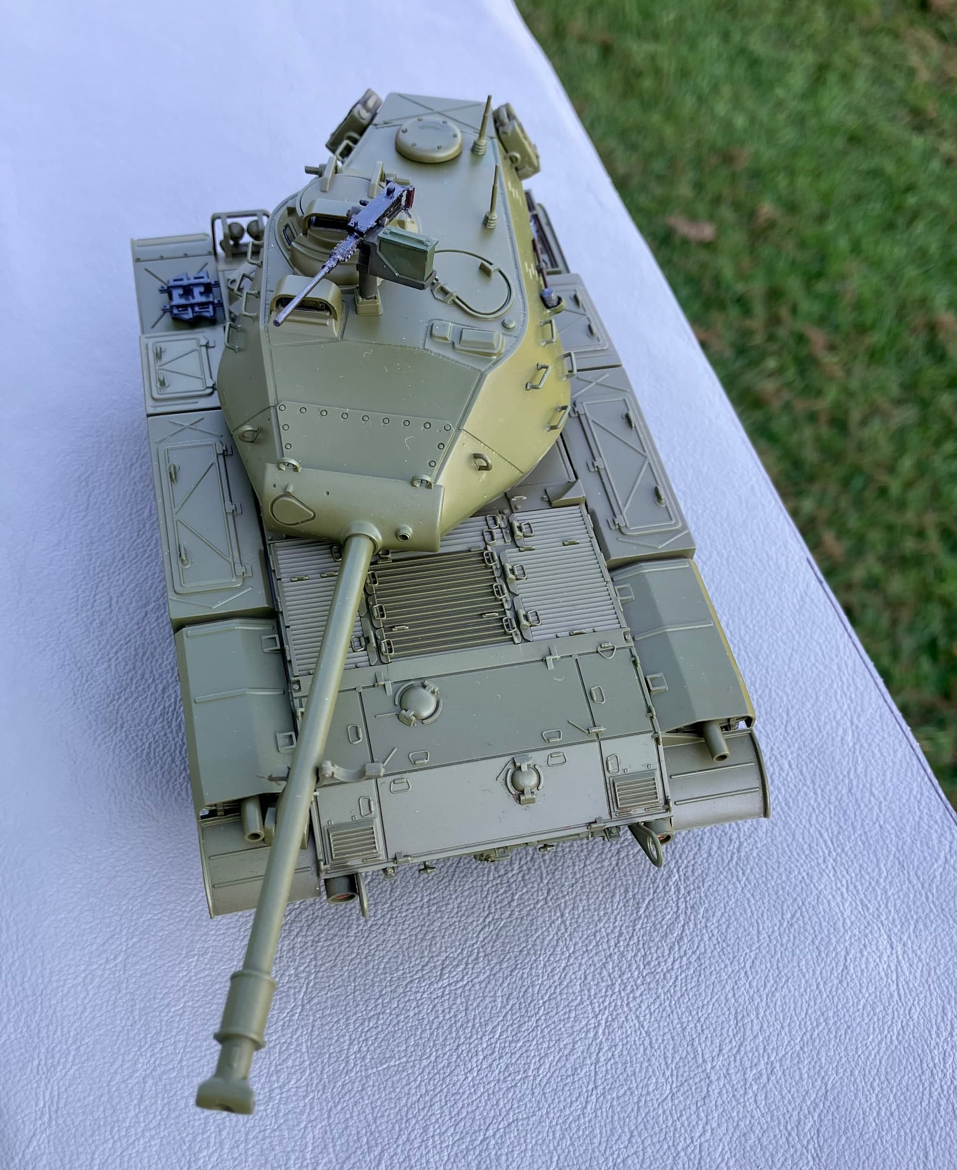

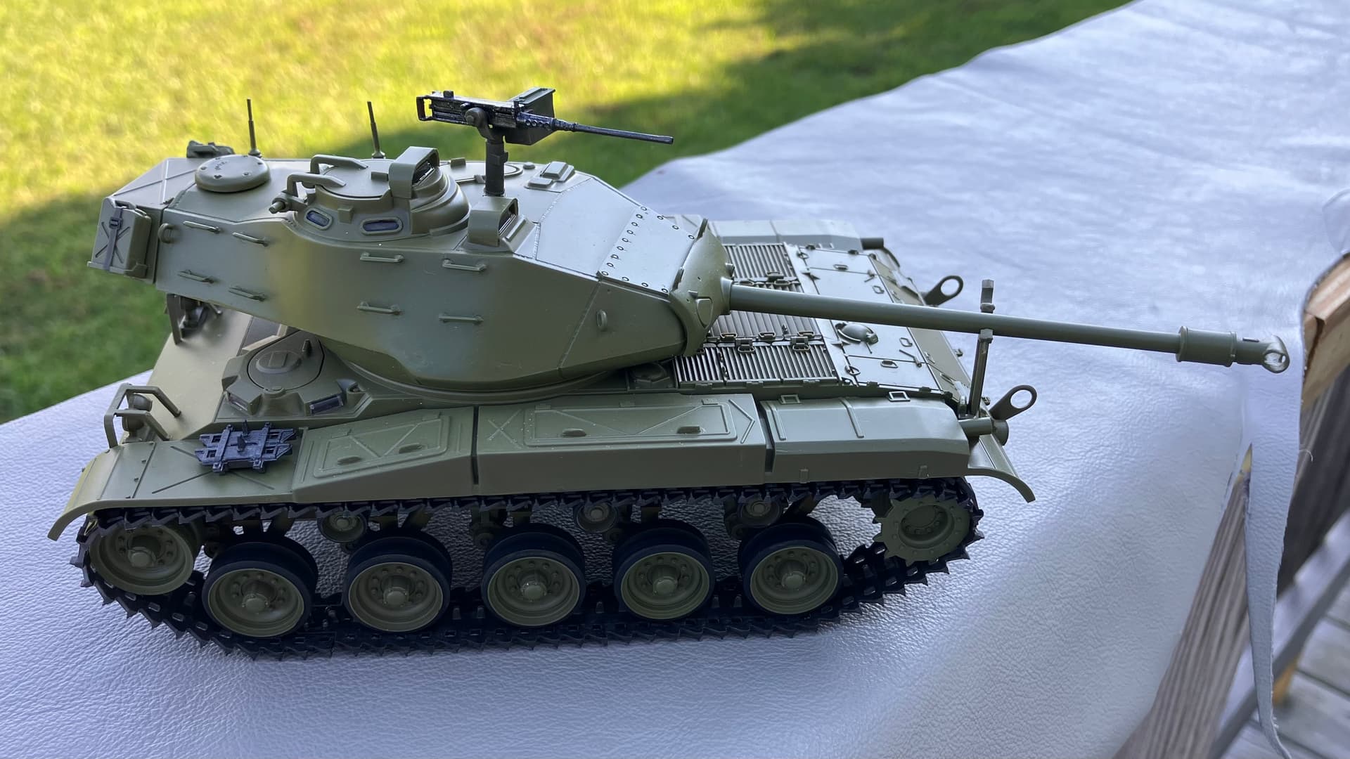

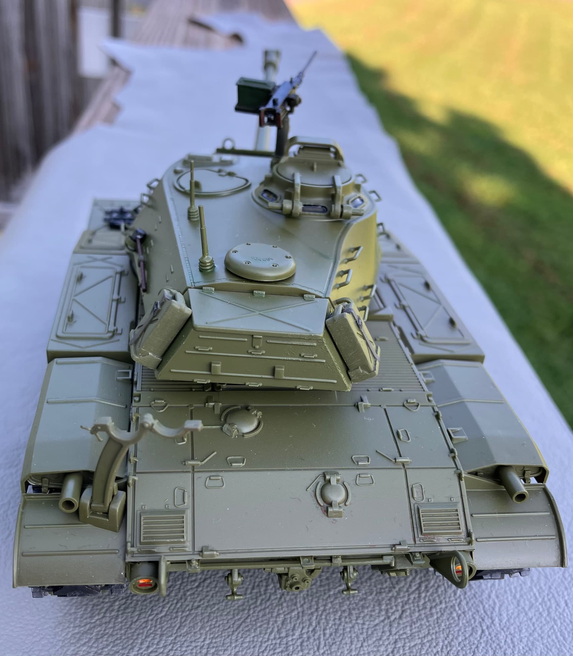

I primarily use Tamiya paints, a few bottles of Vallejo and a bottle of Testors that I purchased for a specific color. That said, and this might be sacrilege to some, but I recently purchased some of the Hobby Lobby new Airbrush paint to try it out. It won’t replace Tamiya for me, but I thought it worked fairly well and turned out ok. This M41 was done with the new Hobby Lobby Airbrush paints. (Edit-I forgot to say that I painted this with no primer.)
