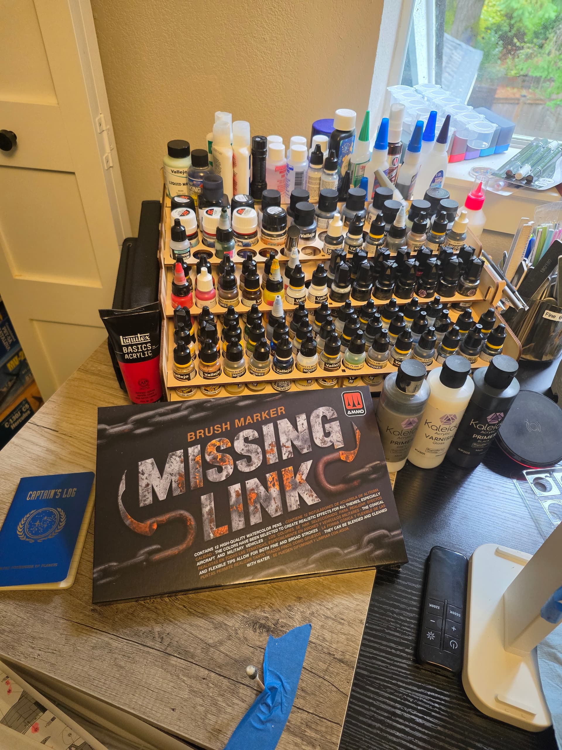

As you can probably tell, I have a lot of Vallejo. :joy:
That’s mostly because Vallejo is what I started with when I got back into modeling about a year and a half ago. I’ve learned how to airbrush it successfully, I understand how it behaves, and I really like not having to mess around with a bunch of chemicals. For the most part I can clean everything up with water, and that’s a pretty big advantage for me.
I also have some Kaleido metallics, which spray beautifully, and a handful of specialty paints that I’ve raided from my wife’s art supplies over the years. :joy:

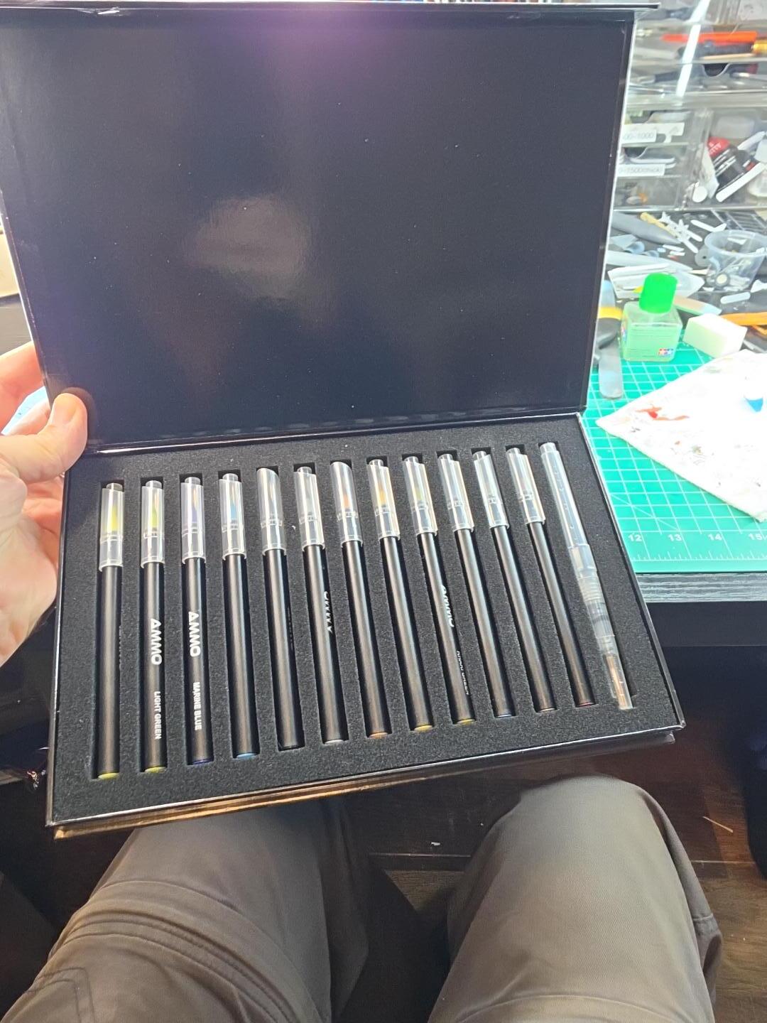

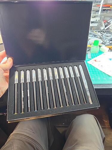

And then there are these AMMO Missing Link Brush Markers. I’ve discovered that these things are wonderful for weathering. They’re easy to control and have become another tool I’m really enjoying experimenting with.
I’m really looking forward to Kaleido eventually coming out with military colors. If those spray anything like their metallics do, I can see myself gradually switching over as I use up my Vallejo.
But for now, Vallejo is definitely the vast majority of what I use.
