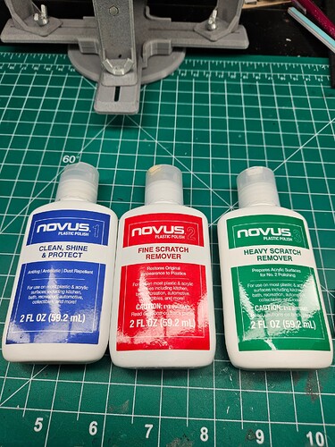

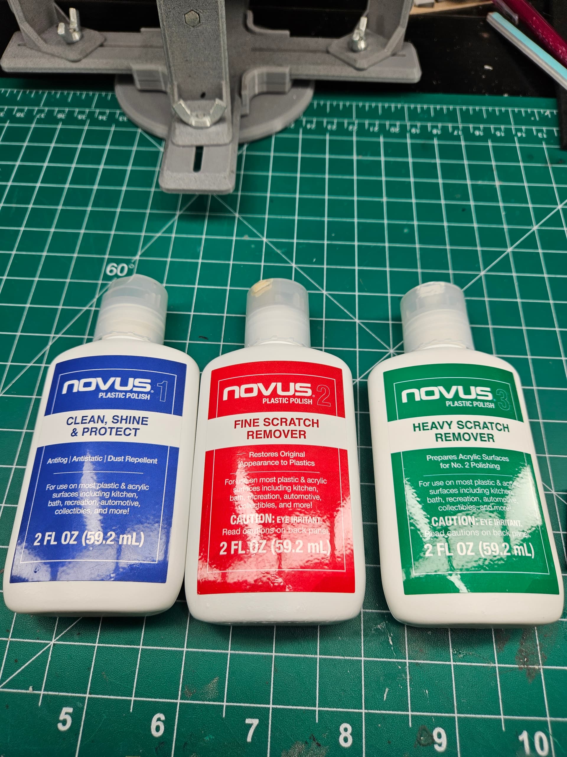

So the F-2A arrived yesterday all sealed up in shrink wrap in perfect condition. I excitedly opened it like a kid opening the biggest present :wrapped_gift: under the tree :christmas_tree: on Christmas morning. Looking through the sprues with excitement :star_struck: to see what to expect… all looks great… beautiful detail, lots of parts… then I get to the clear parts and find the dreaded seam line right down the center of the canopy bubble. UGH!
This will be a learning experience for me since I have never had to sand a seam line out of clear parts before. I quickly jumped over to scalemates to see if there was an after market canopy available but they don’t show one. So, if I mess this up, there will be no coming back from it. No pressure though. :sweat_smile:

Try a 3 in 1 nail buffer on your canopy seam like this one. May want to practice on a spare canopy first. Investing in some Micromesh polishing cloths is not a bad idea either. Then there is the Novus plastic polish which is also good to have.

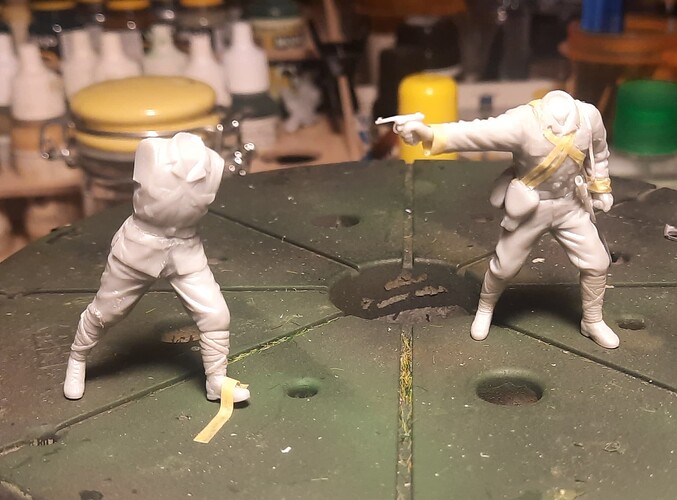

I’m going to try a vignette with the DML Japanese Army Infantry (Iwo Jima 1945). Don’t have the kit number, bought these off ebay and the knucklehead who packed it removed the beautiful Ron Volstad box art. Guess this will be the last ebay “bargain” for me. Anyway did get things rolling have the commander cleaned up and ready for prime exept he has no head. Working on fig. #2 cleaning the leg wrapping and gluing the torso together.

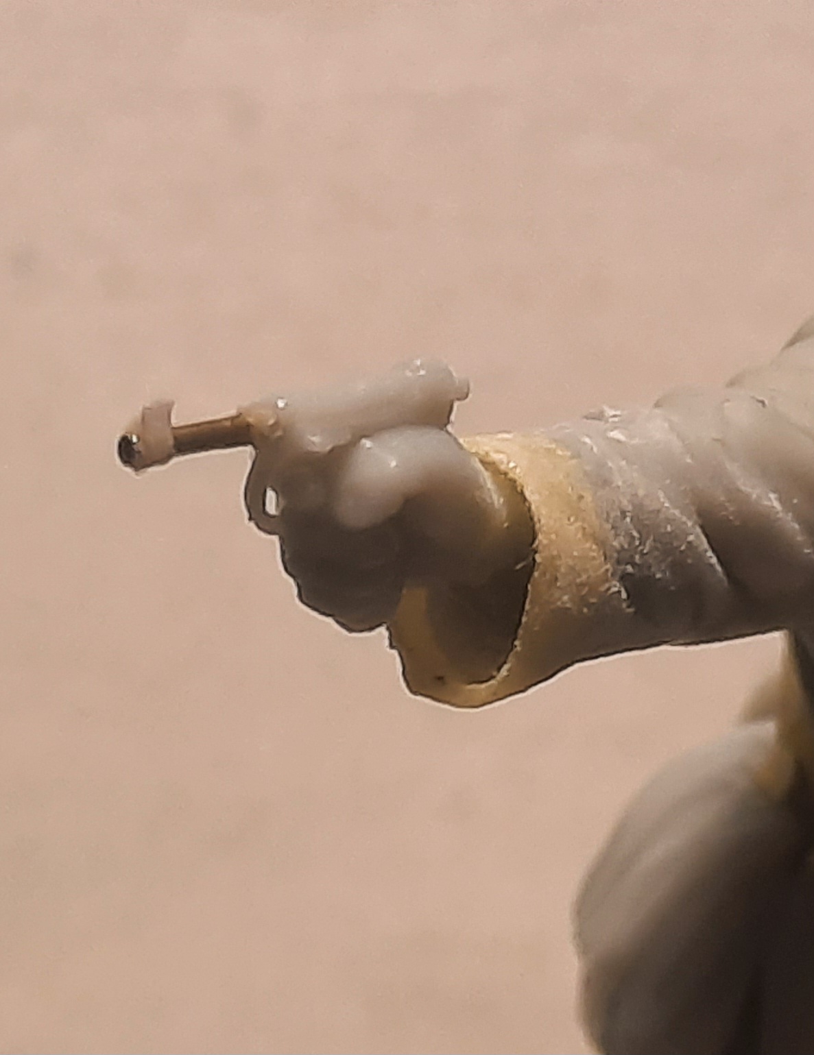

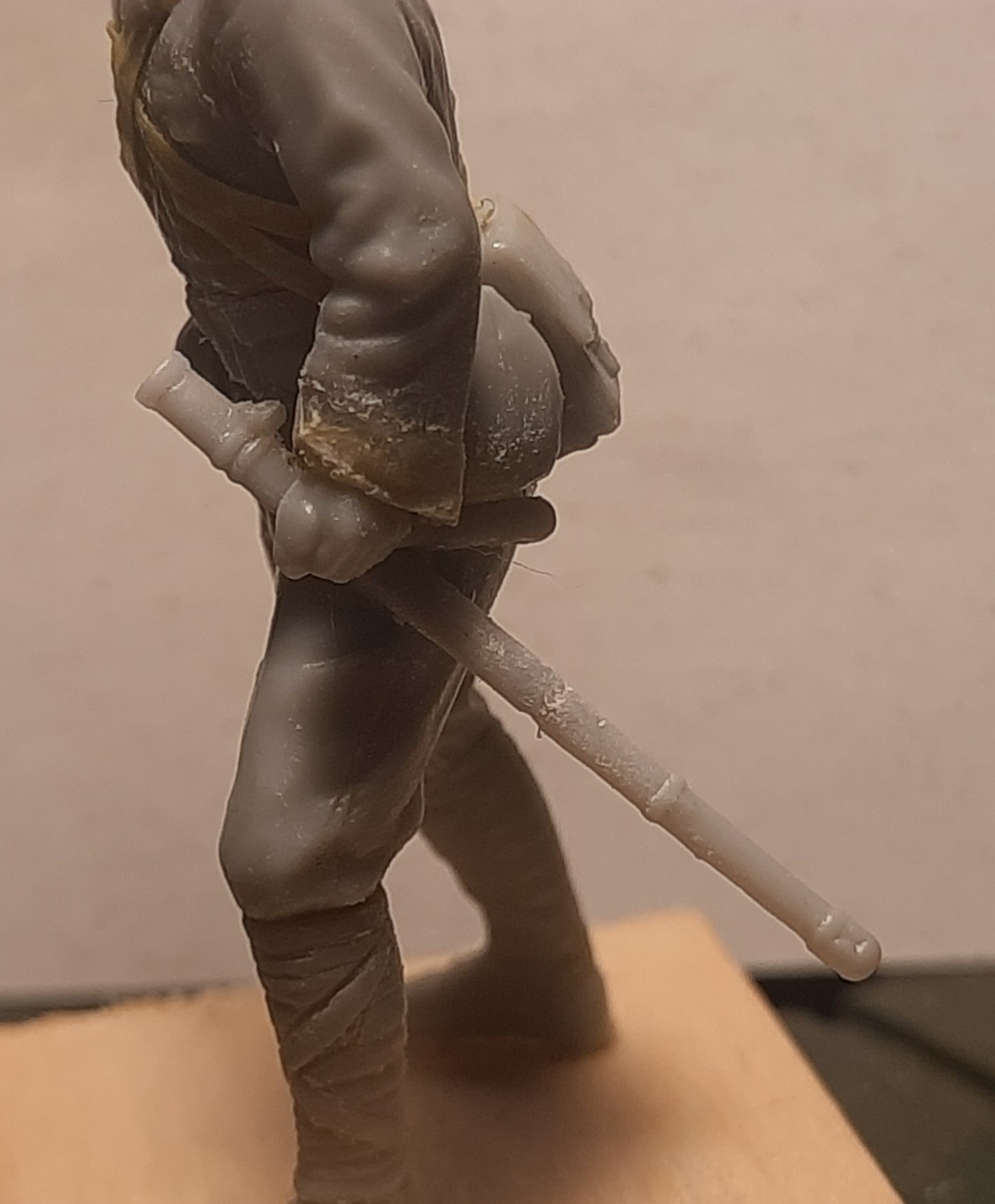

Broke the scabbard and lost the broken end. Built a replacement from a bayonet. It worked but looked more like a US civil war cavalry scabbard rather than for a Katana. Found the broken piece while replacing the officer’s pistol barrel. I had to add a brass rod to make the repair.
Tojo is back in business :smiling_face_with_sunglasses:. Still no head…

Nice save! Starting work a little early our we?:grinning_face:
Successful recovery my friend! Looks good!
The details on these DML figures is there but way too soft. Some of equipment straps get mixed up with folds in the uniforms. Spent about 5 or 6 hrs just on the leggings alone. I have one more set to do. I did get an update on the location of Tojo’s head. Fedex will be dropping off a box of heads sometime next year. That is when a quadruple head transplant surgery will take place. You are correct I am starting early. Trying not to give up any mojo that I started with these troopers.
As scarry as it seems, it is actually one of the easier things to deal with. There are many videos on YouTube so I’ll keep it brief.
Tape either side of the seam so as to minimize damage.
Start with 400 grit sand paper and work your way up to 8000. Then use novus scratch remover to finish it off and it will be beautiful.
A typical canopy takes me maybe 20 minutes to get looking right.
I hope that helps.
