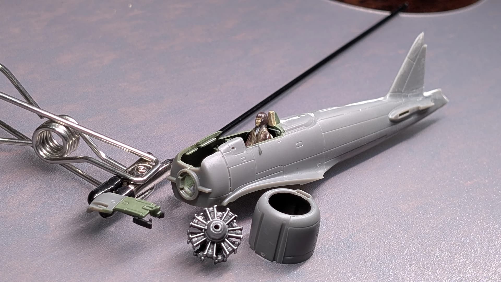

Small update today in the absence of much bench time, using Tamiya Acrylics thinned with Mr Colour Levelling Thinner 400 we’ve:
  • Assembled and Primed the engine and inners of the cowling in XF-1 Flat Black
  • Painted the MG Mounts and Gunsight in XF-71 Cockpit Green (IJN)
  • Painted the Machine Guns in XF-1 Flat Black
A nice detail here was that Airfix had moulded the cocking handles for the MG’s, which protruded back into the cockpit for an almost “Red Baron” sort of aesthetic. This allowed the pilot to manually clear any gun jams.
We’ve also done some cleanup of some runaway Tamiya Extra-Thin Cement and applied some Deluxe Materials Perfect Plastic Putty between two strips of Tamiya masking tape in order to fill over the joint between hull halves. Once the putty had sat for a few minutes, we pulled the tape, which had confined the putty just to the target areas.
Unfortunately we’re a little self-limiting here, as putty needs to set and lacquer-based thinner needs to gas out before I glaze and drybrush with water-based acrylics over the top.

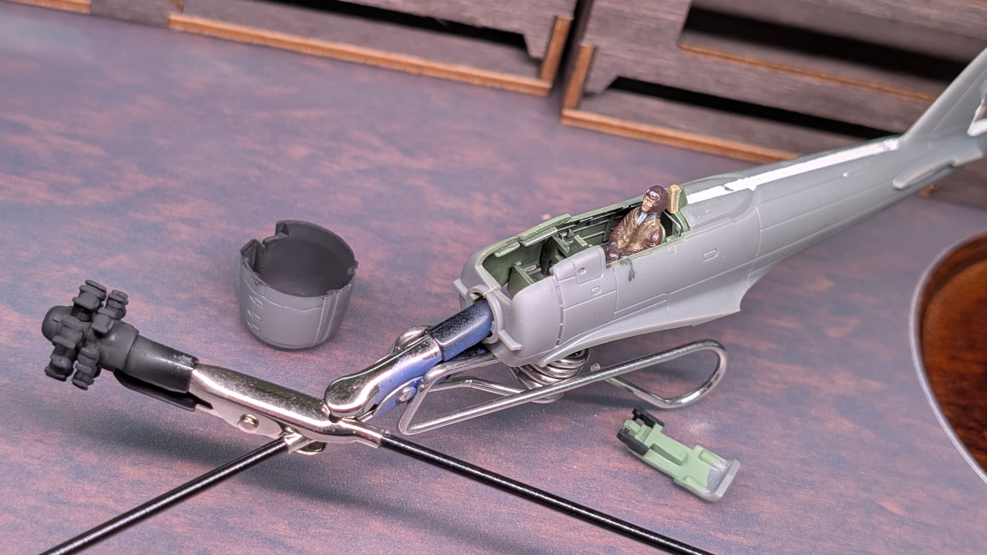

Airfix 1:72 Mitsubishi A6M2b Zero
Another small update, but another couple of tasks that are good to get done, this time using Vallejo Game Colour acrylics:
  • Engine was drybrushed in 72.052 Silver
  • MG Mounts and Gunsight were glazed with a 1:1 mix of 72.030 Goblin Green and 72.051 Black.
Much of the area around the gunsight will be painted over with an anti-glare black, before transitioning back to the nominal hull colour however we wanted to make sure the gunsight and its frame was appropriately painted and shaded first.
We’ve also sanded back our earlier filling, with the residual putty revealing how wide a small misclose between parts can effect the lines of a model

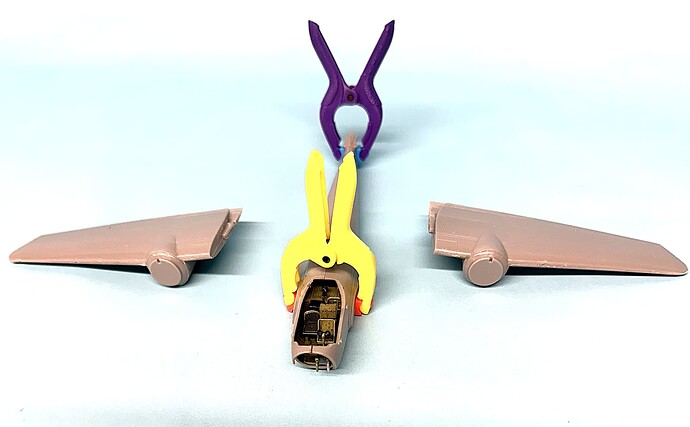

Started work on this Fine Molds kit. I’m terrible at taking pictures but I do hope to get some better shots of the cockpit. The fuselage halves are clamped closed to maintain the cockpit stays put until the glue sets. It’s only attached to the port side for now.
Wings and gear bays are done and put together. They will be attached once I get the fuselage button up and seams corrected, if I have any. I’m not overly enthusiastic about that though. Much of the detail seems rather spartan at best.
The Q1W1, “Lorna” seems to look like a Japanese version of the Ju-88, although it’s a lot smaller aircraft. Still it’s not one you’d see often and I am slowly getting into the build. I hope the decals behave because there are not any aftermarket replacements!!

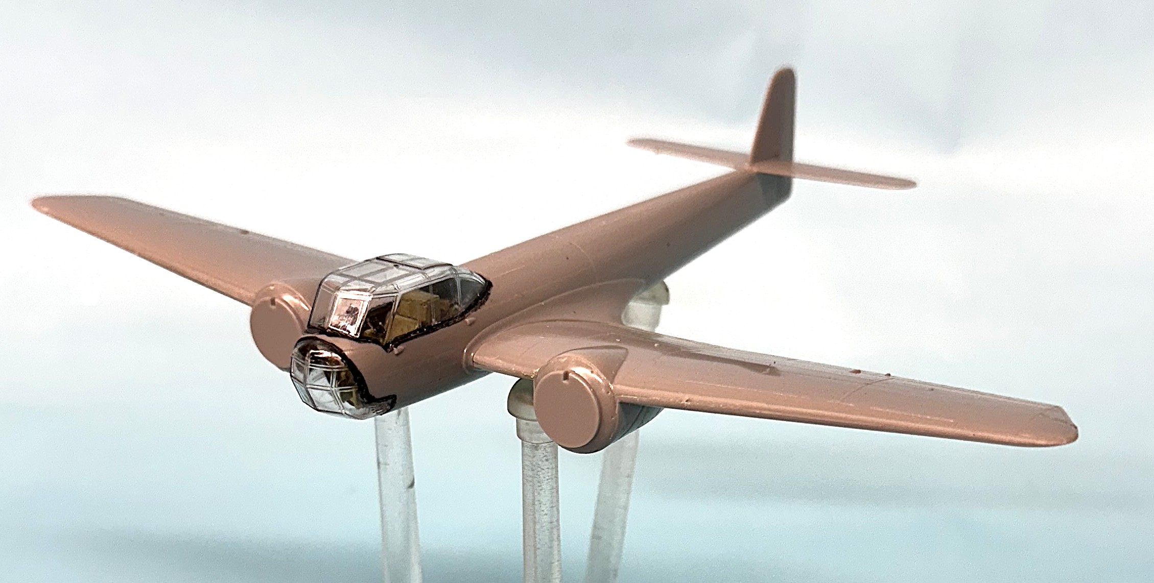

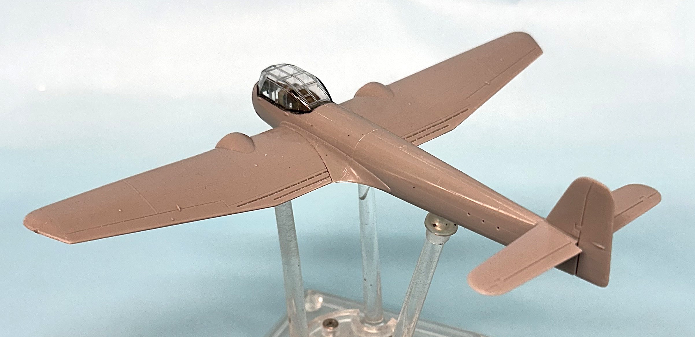

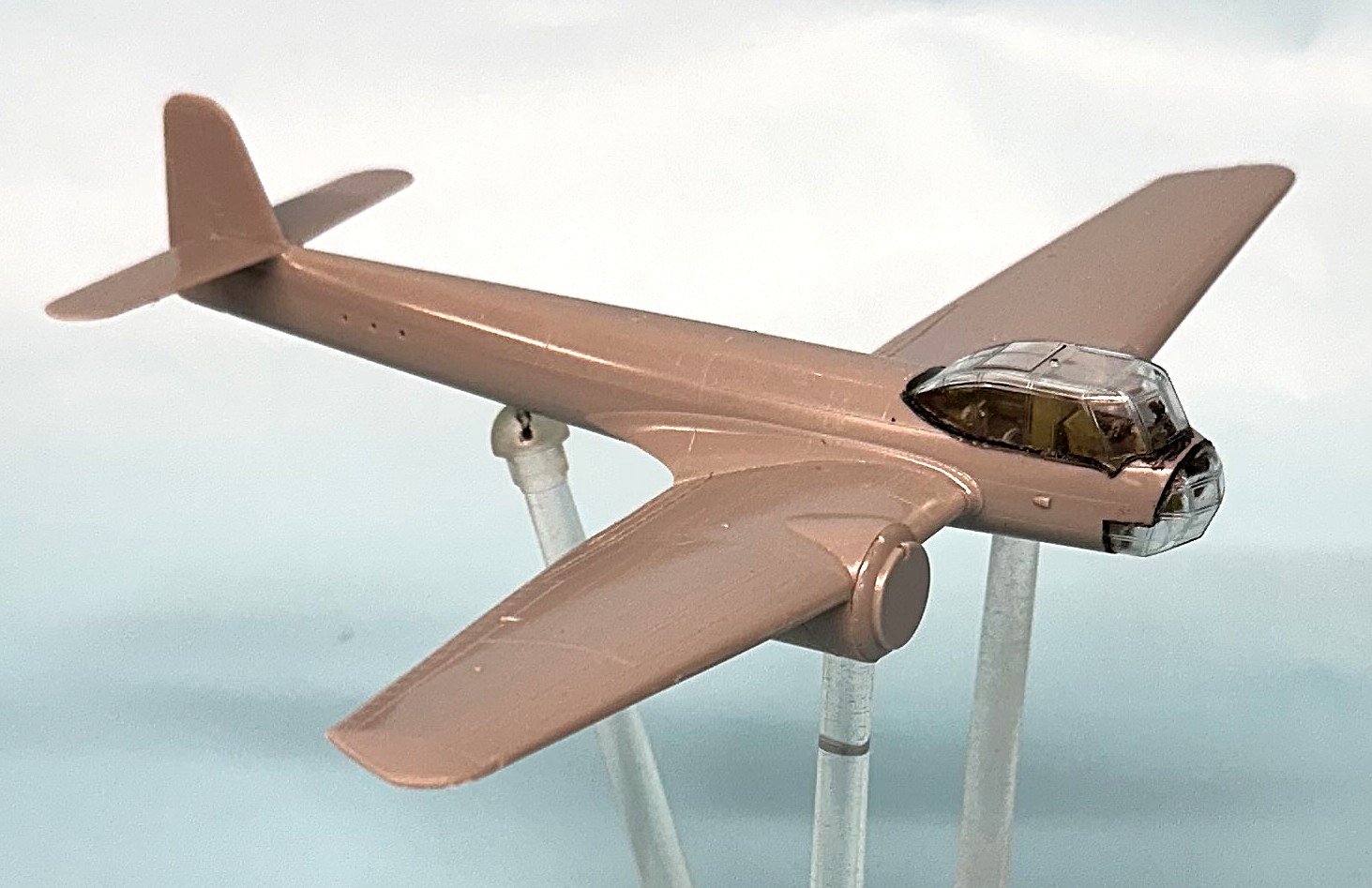

Good progress on the Fine Molds Q1W1,Model 11, ‘Tokai’ (Eastern Sea), Reporting name: ‘Lorna’.
I still have some work to do on the fuselage seams; down the spine and under the belly. Wing root is a bit of a pain in the a…rump too, but then I knew that going in. Neat little model but it is one of the earlier types of Fine Molds kits, circa 1998, and it does have some fit issues. Still, it’s different and it sort of looks like a Japanese version of the Junkers Ju-88 only smaller.
These aircraft were purpose built to hunt American submarines which at the time, were a major problem for Japanese shipping and naval movements. They were an effective ASW aircraft. Fortunately, there weren’t that many built and they were underpowered. This in turn made them slow and easy targets for US Navy aircraft.
This machine will be from the 901st KoKutai and was based in Shanghi China, late summer 1945.
That’s where I am at with this one. Looking at another one too, but I’ll get to that after this one hits the finish line.
