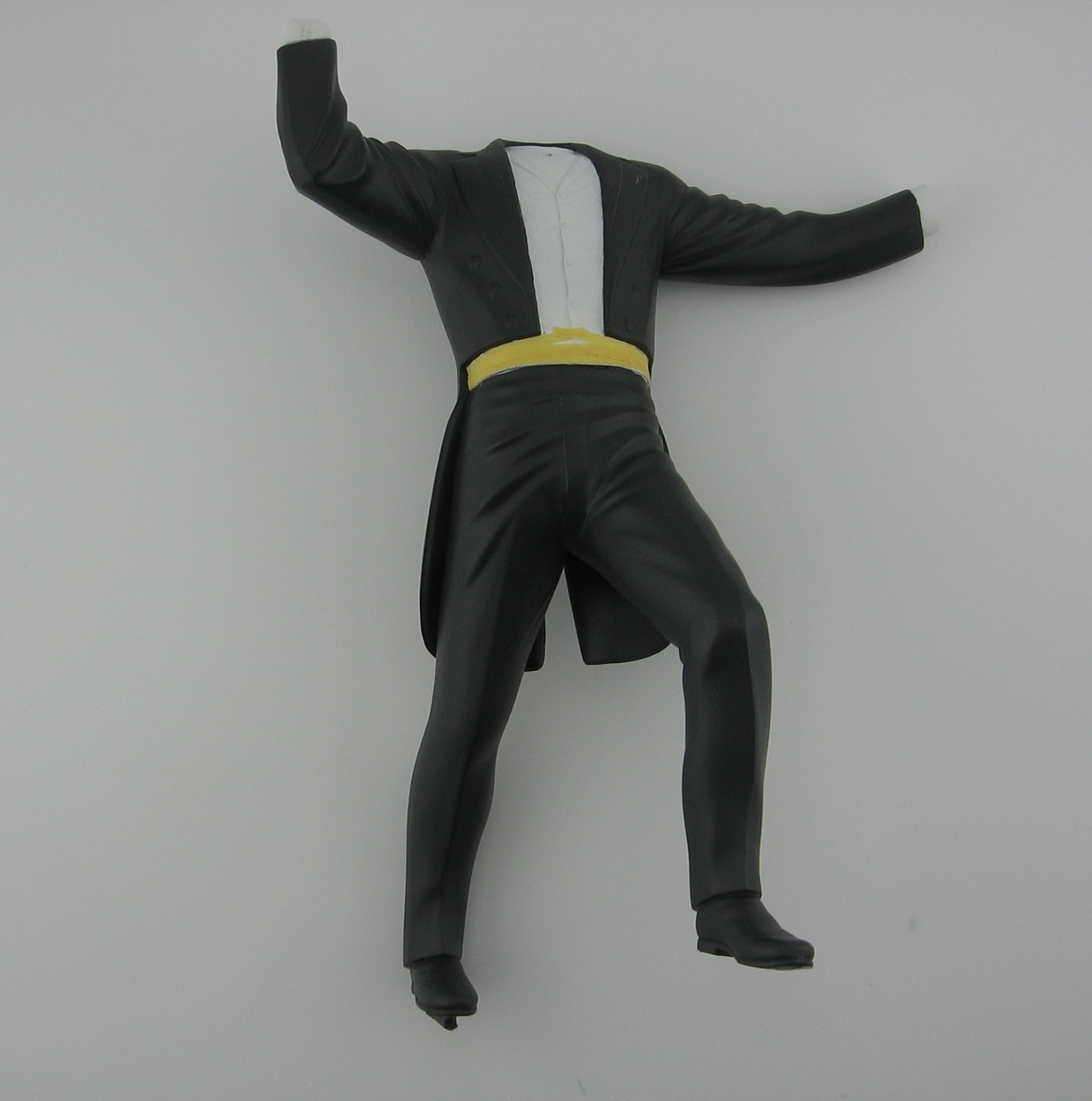

1/8 Atlantis Phantom of The Opera

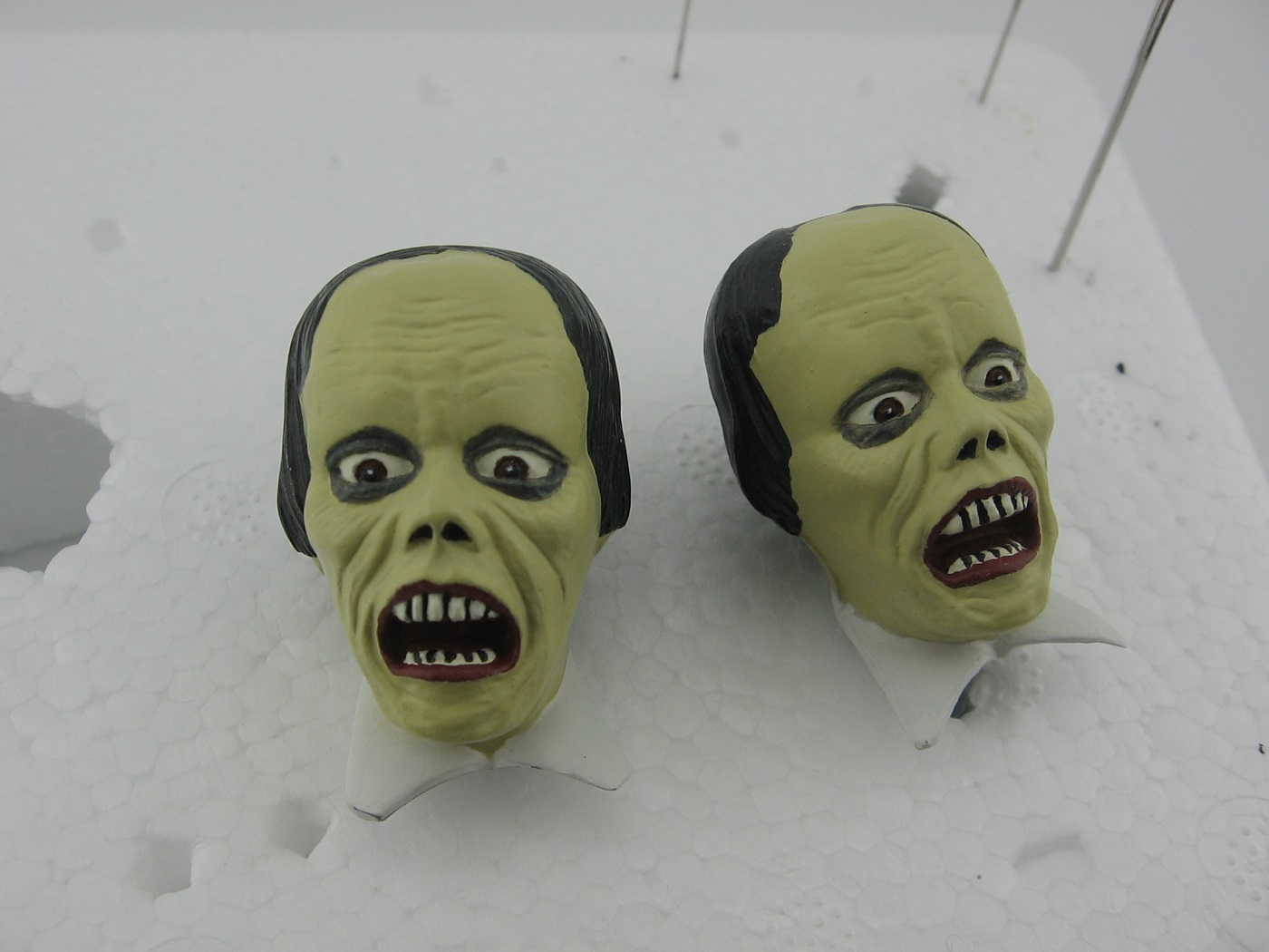

Dry brushed in the raccoon eyes with Vallejo Model Air 71.047 Grey.
Finally satisfied with the catchlights on the head I’ll be using (on the left). Took about eight attempts, I figure.

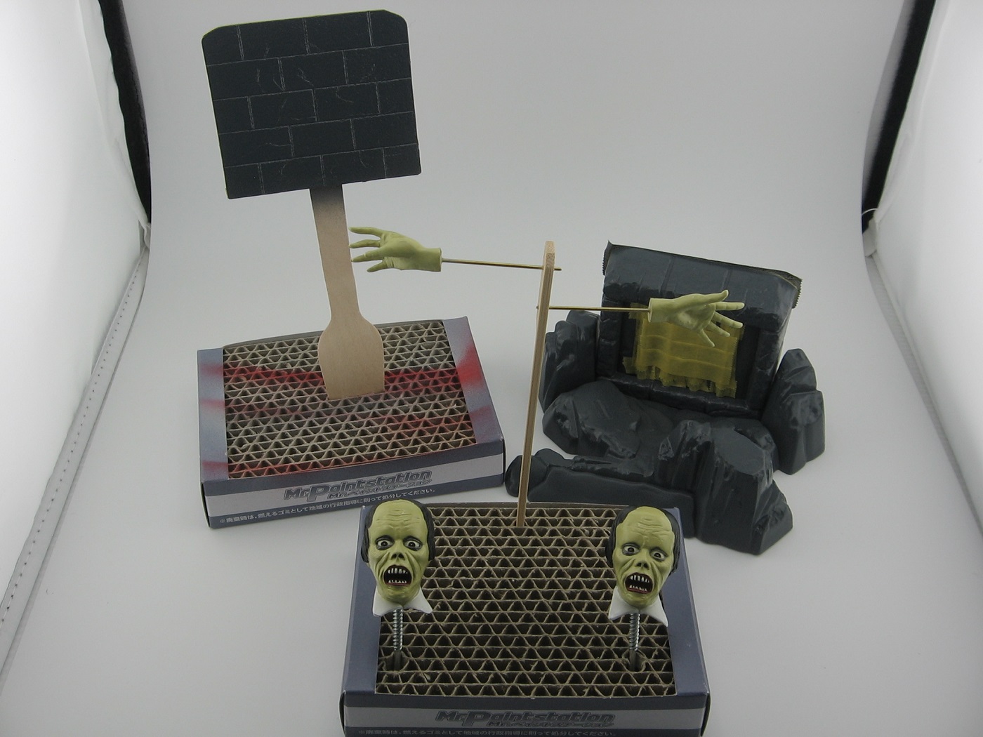

Started masking over the shirt again, in advance of touching up the Panzer Grey suit.
Gloss clear coat applied to these pieces, in advance of applying washes.
Getting there.
I had thought I’d be done by the end of March. Starting to feel the pressure of golf season coming soon, and less bench time, and the need to get my Titanic hull ready for paint (have to do that outside this summer). Might have to put The Phantom on hold for awhile so I can get to that. We’ll see.
Thanks for looking. Suggestions are welcome.

Mark, everything is looking very good. I like how your faces turned out with that color you selected. Yeah, I agree with you about modeling taking a back seat once the warm weather hits. My excuse is the never ending yard work. Even taking a ride on the motorcycle takes a backseat to that chore.
Looking good! Adding the dark circles around the eyes brought the head up to the next level.
I like how everything looks in the last pic. The heads look even better in it.
I sure hope golf season doesn’t end up impeding completion, but I understand if it does. It’s all about priorities. :grin:
Thanks guys. I’m pretty happy with how the heads have turned out, so far. Still have the wash to apply.
Re: completion…. I talked to the wife and apparently the son-in-law has LED work lights. Who knew? Benefit to this is I can perhaps paint my 53” Titanic hull in the garage instead of outside. Painting it outside would require about 7 wind free days. It’s often windy where I live. Hence, worrying about getting the hull prepared. Hard to predict when I’d have a chance to paint it. I mentioned to my wife that I was considering renting work lights and that’s when she stopped me. She knew he had work lights because he helped paint our basement, when we first bought our house, while I was away at work. He had brought the lights over for that. My only other garage concern is dust, but it’s probably doable and, if so, will give me way more breathing room.
Anyway, kind of off topic. Long story, short, I should get the Phantom done soon, in light of this new information.

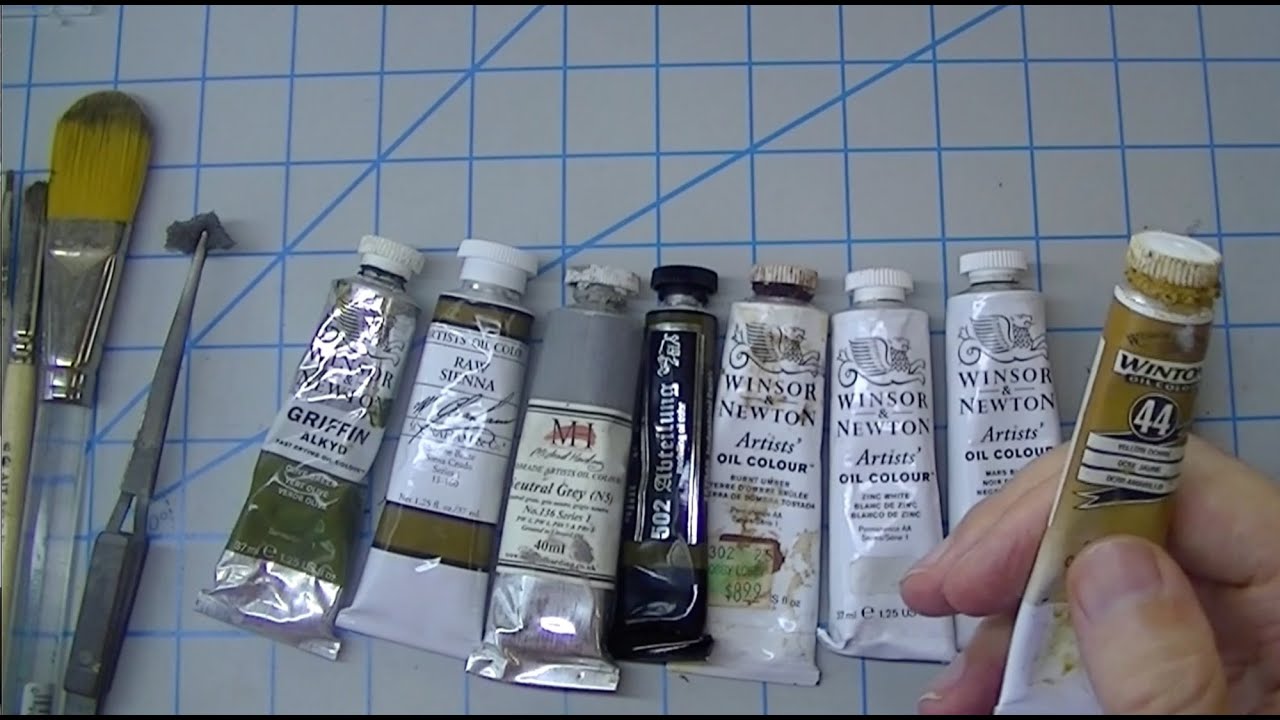

One thing to consider might be artist’s oil paints – they work great for washes over acrylic, and a bunch of other neat effects. You can thin them to whatever consistency you want, it the color flows and blends wonderfully, totally dependent on how much thinner you use, and over an acrylic varnish, you can wipe it completely off and start over if you don’t like the look. There IS a bit of a learning curve to using them but there are lots of tutorials out there.
If you’re at the LHS, they might have some of the Abteilung502 oils, which are made for modelers. Otherwise any art/craft store will have some. Just avoid the cheapest of the cheap, which tend to not have the pigment density we’re after. But a tube of ocher yellow oil paint and a little bottle of odorless mineral spirits would be fun to mess around with, if nothing else. Maybe grab some burnt umber, burnt sienna, white, black, and Payne’s grey if you’re already there…

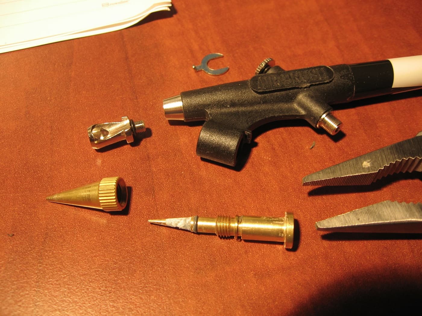

The basic airbrushes that I have been using, thus far, are similar to the Badger 350, but they are in fact not Badger 350s. I have two of them.
They are cheap ass knock off clones. The first started acting up a week or two ago. Intermittent spraying. The second one started doing the same tonight. One issue is, they can’t be taken apart for cleaning. The lower brass portion (where it connects with the jar) is molded into the plastic body of the airbrush. Literally, it can’t be removed. Good luck trying to clean this cheap ass clone. Not going to happen.

I wish I had seen this earlier. I picked up a brush like yours based upon the results you were able to get with it. At first I thought the nozzle was molded in too, but it’s just a tight press fit. You can absolutely back it out and clean it.
Congrats on getting the Badger!
In case you’d like a backup brush here’s what I did to take out the nozzle assembly and clean it.
Pull the retaining ring.
Then unscrew the paint nozzle most of the way.
Patiently push backwards away from the air nozzle. Paint nozzle/tip will eventually pop free. It may take a little more force than you are initially comfortable with, but it will come loose.
Finish unscrewing the paint nozzle and you can pull the paint tip out the bottom and do a full cleaning.
After the initial release it became much easier to remove during subsequent cleanings.
Thank you so much, Johann.
I managed to disassemble the airbrush with pliers, based on your description.
Some modifications to the main body (read: sanding the opening) required to improve ease of removal in the future.

As an aside, I for a while thought the “artist” part of the name was used by we modelers to imply that they’re not, well, “modeler’s oils” but I’ve since learned that there are “artist” grade oil paints and “student” grade oils. They are the same colors, and use the same pigments, but the student grade ones have a lot less pigment and use lots of fillers instead. The first ones I ever bought were “student” grade and they were nearly useless for weathering use. I’ve since grabbed a few tubes of “artist” grade oils, plus the aforementioned Abteilung502s, and they are worlds different. The 502s in particular are nice because they do actually dry, when applied thin, to the touch in a few minutes and thinner-proof after a few days. The student oils I used before – I bet I could still wipe them off that old Tiger I I built a few years back.
I think you’ll have to go to an actual art store to find “artist oils” as I’m not sure if Michael’s or Hobby Lobby will have them, though they do have “student” grade oils. I go to BLICK art materials here in MN.
The big advantage of oils is that you can use them for washes, pin washes, filters, and all kinds of other weathering/shading/toning effects, just by varying how much thinner you use.

Came across this video from Will Pattison this morning – aren’t algorithms great? – and he does a much better, more thorough, and more educated deep dive into the oils than I did. Check it out!
