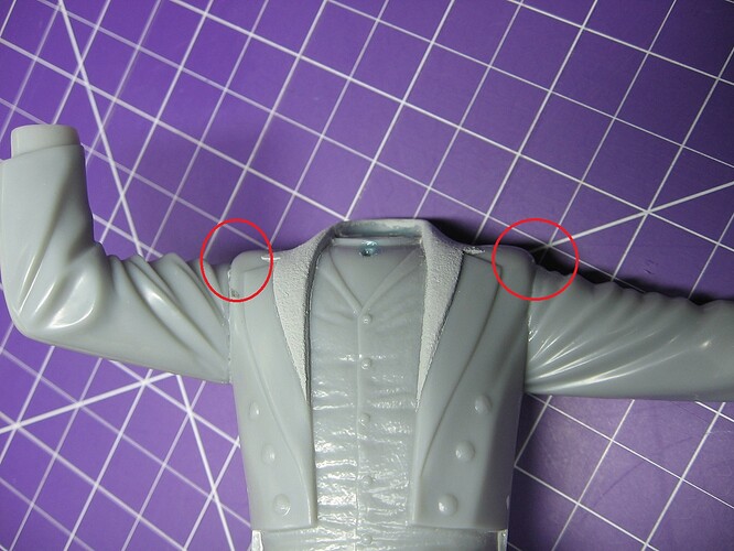

I didn’t like how the shoulders don’t transition into the upper sleeves smoothly. It’s stepped, so to speak.
So I filled the spaces with Milliput Superfine and sanded them down. Here’s the result…

And I’m really surprised how well that shoulder mod worked. Really nice!

I’ll second Tom’s comments on the shoulders and the modifications to the bars Mark. If it’s one area of modeling that I need to try, it’s figures. Your work here is highly inspirational to me. Keep up the good work bud. :+1:
Nicely done with the shoulders as well as the repair on the bars!
