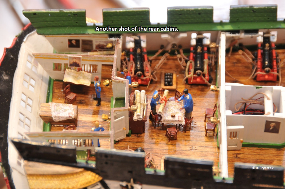

Geez Bob, where’s the inkwell on the Commadores desk?
Holy Smokes that is some detail.
Can you make the deck over the cabin removable? That is too good to hide
I love it. I could never do it, but I love this model ship.
THANKS BOB!

Jim,
Might have overdone it with the inkwell, but you will be able to see it through the windows! My philosophy: Go Big or Go Home!

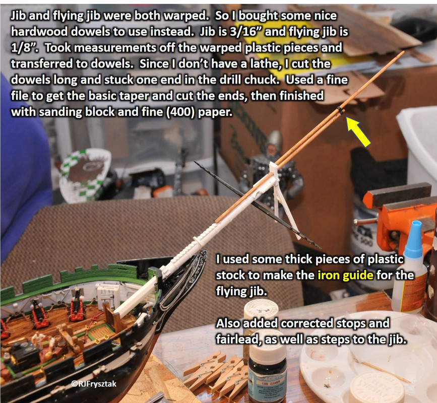

Got tired of tying blocks for guns, so moved on to the bowsprit. both the jib and flying jib plastic pieces were warped - the flying jib looked like a snake. Dolphin strikers also a sore point for most of us as well, as they are quite flimsy and easily broken. I started by doubling up the dolphins by bonding .040 styrene to the back, essentially doubling the thickness. Can barely tell once its painted. Holes were all wrong, so I filled the originals and redrilled the correct number (one short) and in the correct places. Also added the stretcher bar and wrought iron stiffener at the top of the “Y”. Finally, I added the missing block/roller under the iron bar.
Then I moved on to the jibs. Got some hardwood dowels and marked out the areas for sanding and tapering. Described below:
Once I was satisfied with how it all fits together, I stained the jibs and will give a coat or two of polyurethane before assembling. Still need to do some paint touchups on the dolphin striker as well. Also added stairs, blocks and a corrected fairlead with 9 holes for rigging the bowsprit.
I will say that overall EVERYTHING is much stiffer, and will be much stronger for rigging. So I guess it was a good thing the flying jib was so ugly, or I might not have done the extra work.
Bob

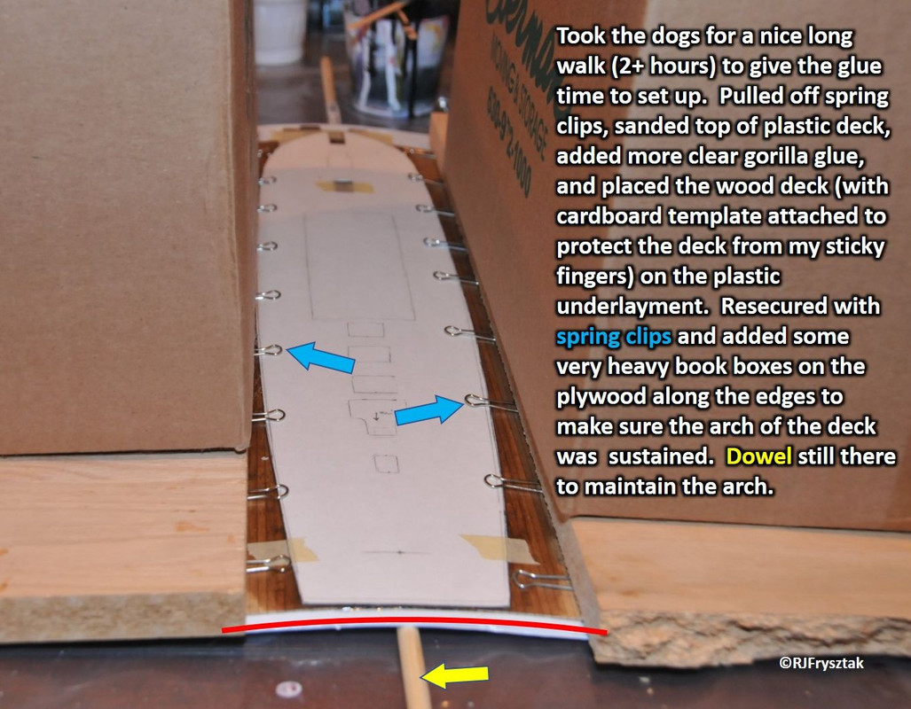

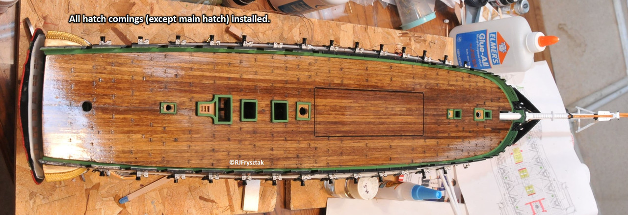

Started on the spar deck last night by getting the boards all glued up and the curve to the “underlayment” for the deck. Using two sheets of .030 glued together with a 1/8" dowel under the bottom to get the curvature. This way I can sand the deck boards flat, stain and varnish, then glue it to the already curved styrene underlayment. Using the crappy plastic one supplied as a template for the cut-outs - with modifications of course. Also using it to gauge where adjustments need to be made so that the spar deck fits correctly. About 5/32" too short, and about 1/8" not wide enough. Since everyone wants me to leave some way to see the gun deck, I am going to go with Force9’s idea of making some cutouts in the spar deck that can be removed (stick an eyebolt in there so I can grab it). One fore around the camboose, one just behind the main mast, and one aft by the captain’s cabin & lounge. Force’s are permanent openings with the beams and knees, but mine will probably only have the main beams.
Bob
Check out Model Monkey (Steve Larsen) on Shapeways.com. He does 3D printing. He has both the 24 and 32 pounders which are really good quality and drillable for fiber optics. He has lots of other cannons in just about every scale possible. Nice guy - just tell him what you need and he can print it up for you.
Glued up the spar deck with a fixed deck pitch or arch. 3 layers to the spar deck:
bottom layers are 2 .030 styrene sheets glued together
Top layer is the wood deck. Process outlined below:
Now I kick back and wait 24 hours.
Bob

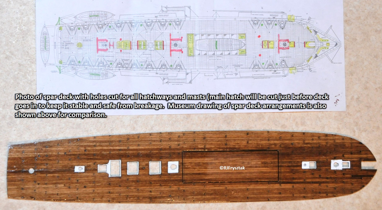

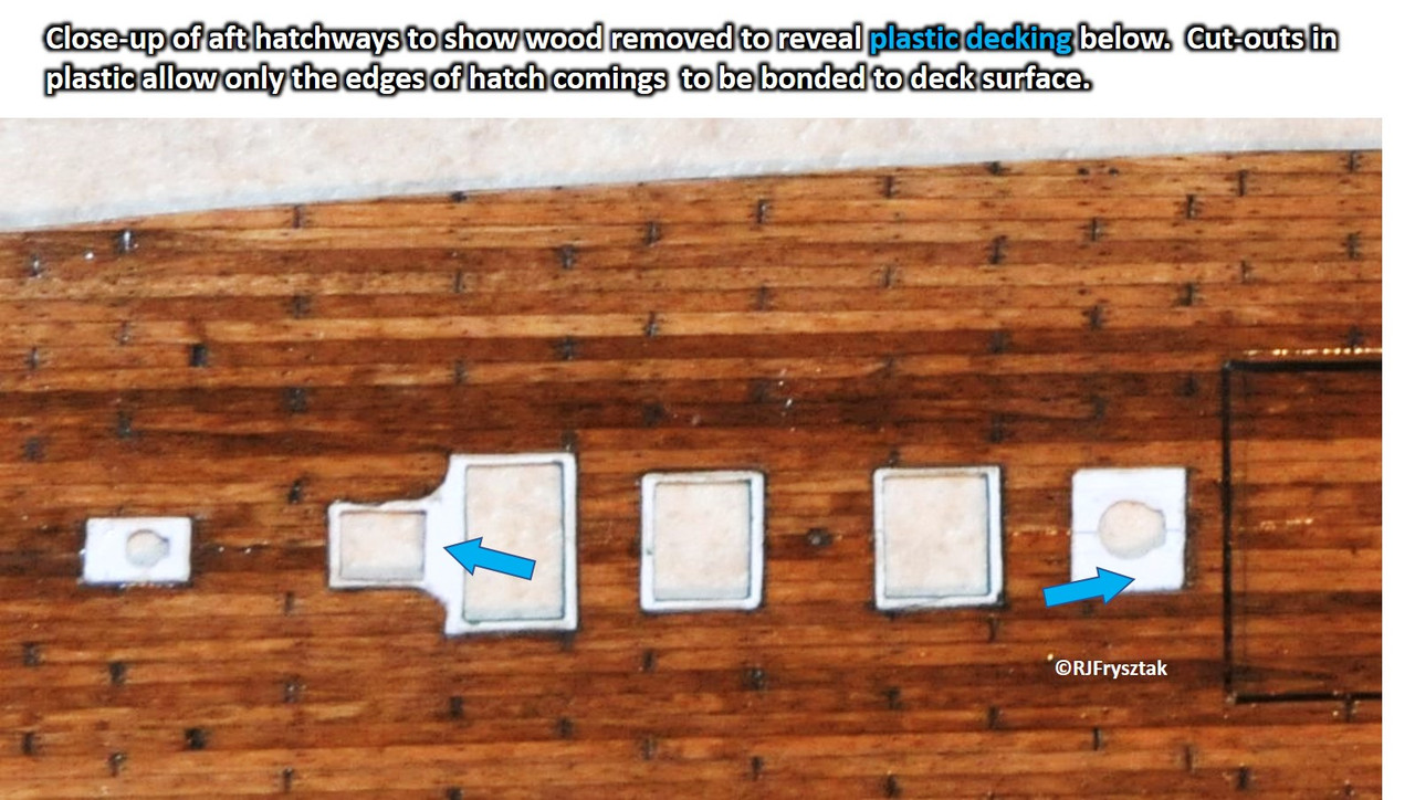

After letting the curve in the spar deck cure for a few days, I marked the deck with the cardboard template I made and started cutting out the holes in the deck for the hatches, masts, capstan, etc.
I start by cutting only through the wood to the correct size for the hatchcoming. When that fits well, I then mark and cut the hole through the plastic portion of the deck. This then leaves space to glue/bond the plastic hatch to the styrene portion of the deck under the wood. I am leaving the very large main hatch until I get all the wiring run for the spar deck. This will hopefully prevent the deck from warping or twisting before it is glued in place. Also checked fit of the masts to make sure they were plumb and level through the decks. All good.
Bob

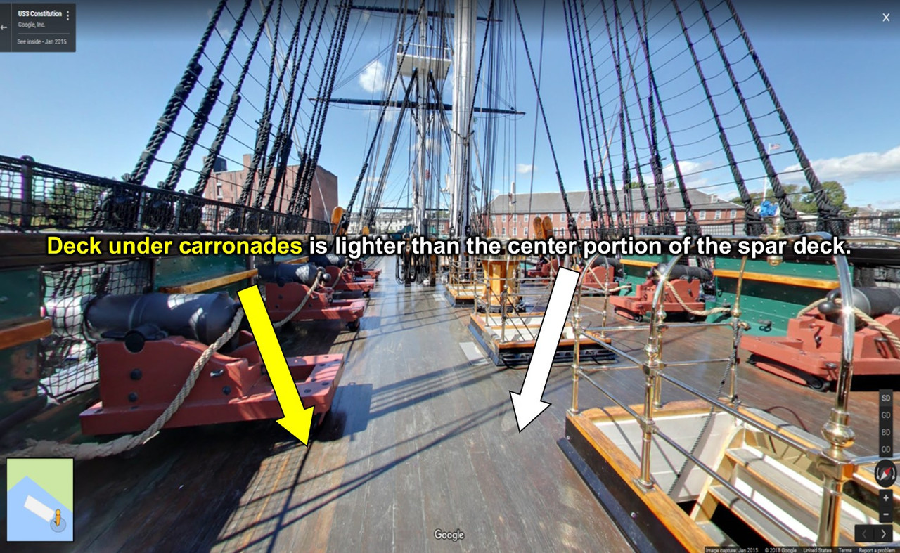

Deck looks great Bob! I know it’s not color correct but I love the dark finish, I likewise went for non color correct on my deck because I think it looks better, you really did a nice job
Dan
Thanks, Dan. I know the photos don’t show it well because of the flash, but I tried to do a darker stain down the middle, and a lighter stain under the carronades. Looks good under natural light. Inspired by the picture below:
Bob

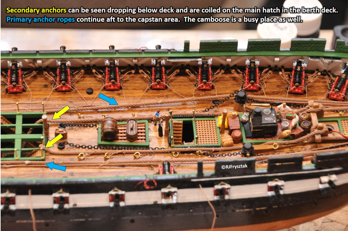

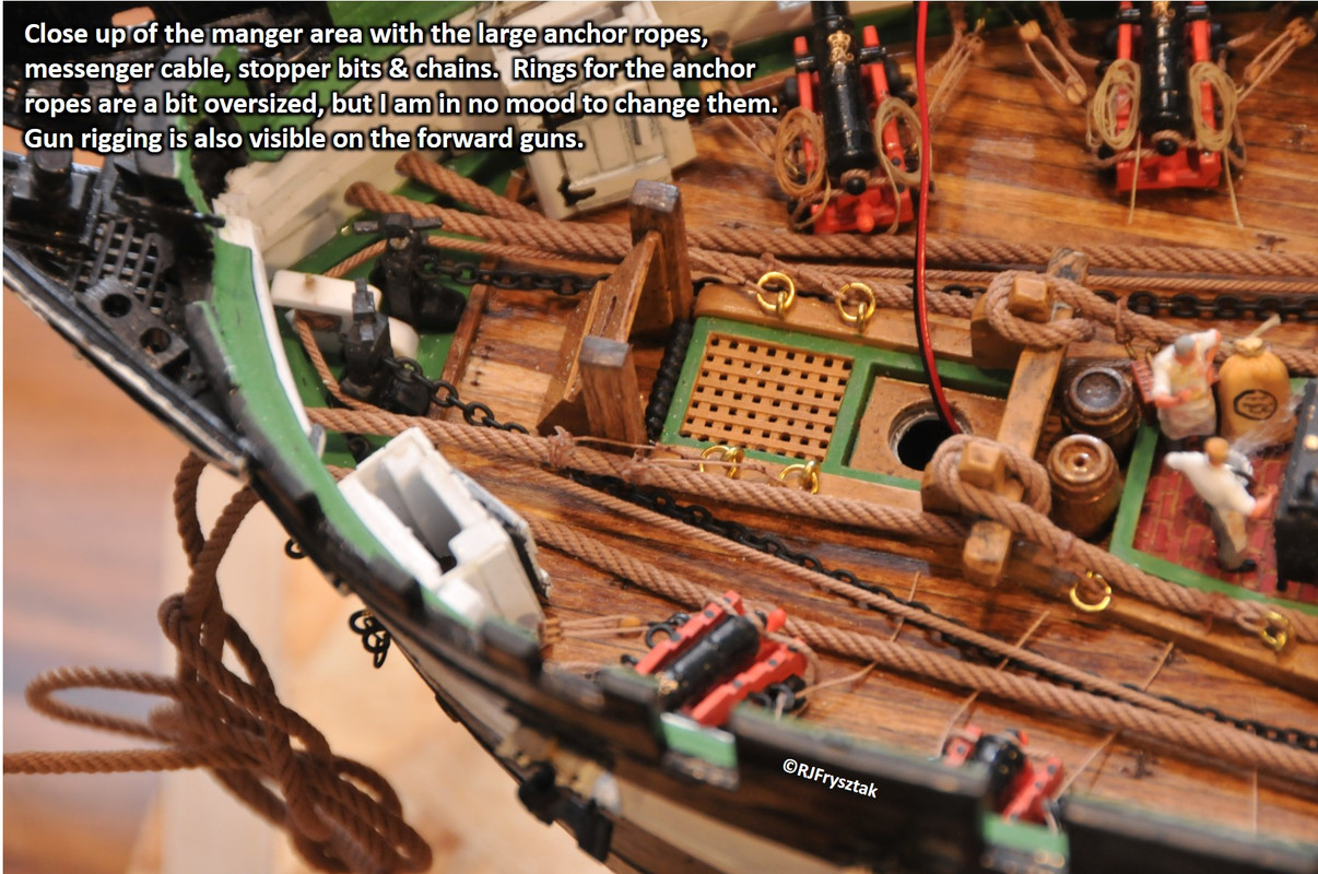

Gundeck is finally completed. All guns rigged, all ropes installed and secured, and crew is painted (drying as I type). Images below.
Bob
