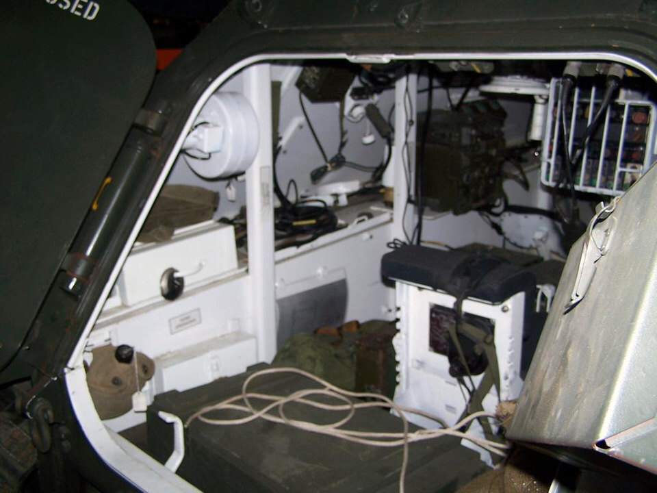

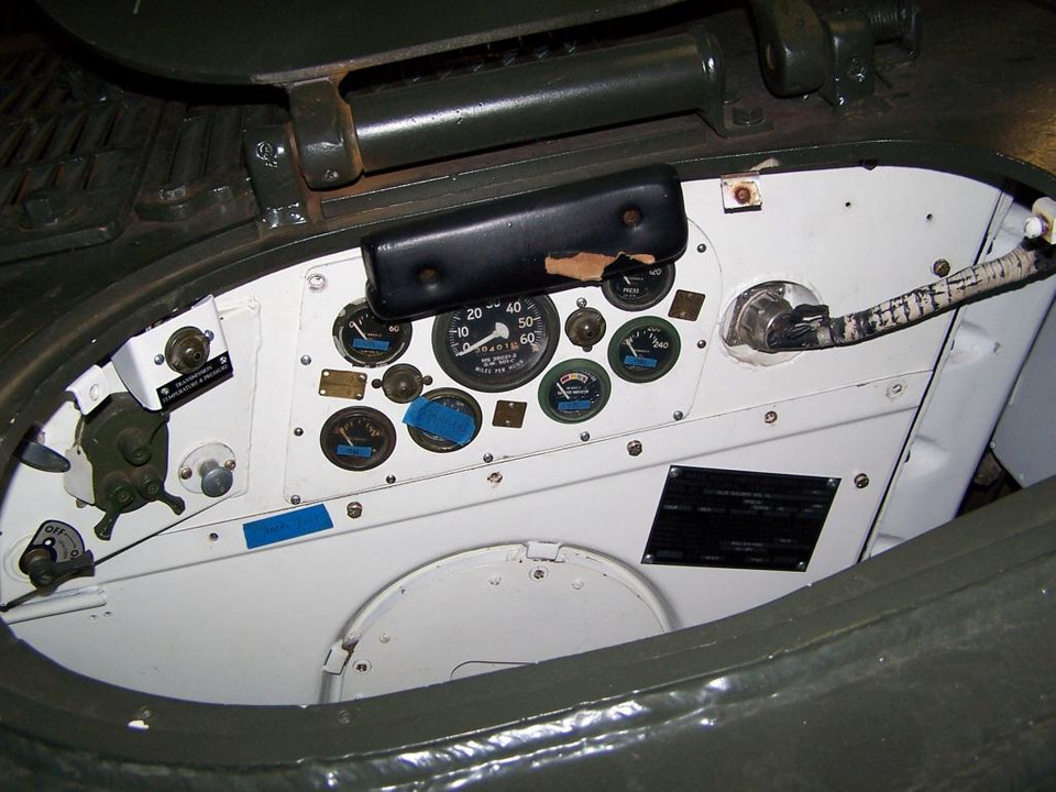

Apologies for my delay in posting these for you.
Drivers Compartment, looking in from the left side
Ammo rack below rear hatch
Looking in rear hatch
Wow those are great pictures! Thank you so much Carlos, your timing is perfect.
Do you think the interior paint is matte finish?
Harold
You’re welcome. I’m glad that you find them useful.
I want to say it was satin or semi gloss. I know it’s completely different, but the M113 family vehicles that I crewed or rode in had the interior in that satin/semi gloss finish.
