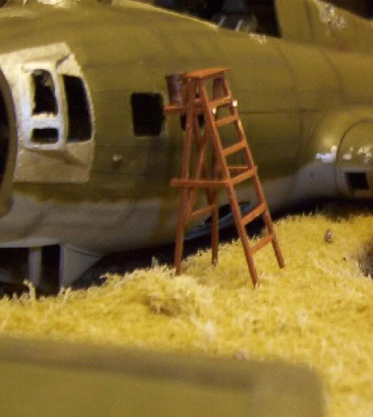

Prieser , teknics , matador , flightpath , dartmoor propaganda , accurate armor , all have kits in this genre good luck finding some of them .The teknics 1/48 B-17 crew just went for $85 us on ebay.Of course scratch built will give the best unique look ,I mean how hard is it to make a ladder?
Nuttin’ to it…

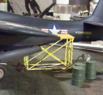

Workstand built from Evergreen strip & rod with the engine stand from Monogram F-80 kit providing the castors:
Excellent do you have the dimensions for the engine removal stand? The big inverted ‘v’ with the chain hoist you know the one -I would like to scratch one for my dio .I have pix but none of the complete item. All the airfield dio stuff available and no one ever did this item Also Esci has a good plastic modern ground support kit ,I just saw one on ebay for $5 .I have boxes full of this stuff from LHS and ebay
