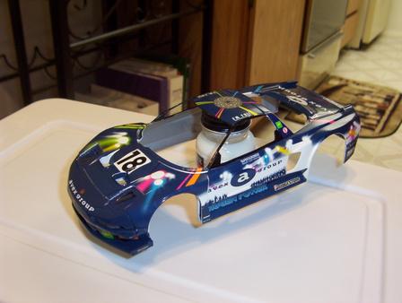

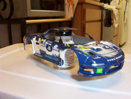

She’s getting there. I’ve been having major troubles with the decals wrinkling, and bubbling up…especially around the fenders…and it seems that in certain spots where I have applied micro-sol the decals have actually bubbled up…it just looks weird. Oh and of course on the hood in front of the windshield two of the decals didn’t match up. I have a spare decal sheet, so I’m just going to have to graff on a piece to match it up. If anyone has any onther ideas on how to fix the decals, please let me know ASAP!!!

Looks great Heath. Sorry about the decals not cooperating though. Don’t have any tips there, still learning myself with cars.

Thanks for the correction!!! And thank you all for the compliments!! The decals are still being touchy, but I have realized (though maybe a bit too late) that the micro-sol is kinda bubbling the decals up. So I’ve been using just the Micro-Set for the later decals, and everything is working great so far. Hopefully I’ll be able to get the other ones to snuggle down, but if they don’t do it in time, I’m just gonna have to clear coat and go with it. FreedomEagle, I’m jealous, I’ve never seen a 1/1 version in real life!! I’ve heard that a few 1/1 vehicles show up for the TamiyaCon, so I’m anxious to see if that’s true!! Either way, I’ll be taking lots of pics!!

Thanks for the infor Niclas, I got the X-3 and have been using it as touch-up. the biggest problems I’ve been having is wrinkling decals, but I figured out that the problem is that the decals are having a bad effect to Micro Sol. As long as I don’t mess with them, they seem to lay down perfectly. Great photos on your site!!! How many clear coats do you put on before you polish??

Micro sol and Micro set are too different products for 2 different things, although they work together. If I have it right apply a little Microsol to the body work where you going to place the decal, this will then make the water on the decal dissapate quicker. Once the decal is in place then apply the Microset, it is this which will get the decal to conform.
The other problem I have found very occassionally is that the Micro products are just too strong, and the decal starts to squanch up if this is the case then I apply only a little and then use a brush dipped in water to smooth everything down.

Ok, my two cents worth :slight_smile: … i did the same kit, and i have problems with the decals reacting with the micro sol, but not the micro set. i would usuall apply a bit of micro set to the area the decal is going on to, an then use the microsol if the decal has to conform to a compound curve. but then i would leave the kit for a couple of days so teh decal could dry thoughly. worked 99% of the time.
