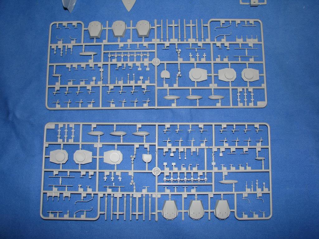

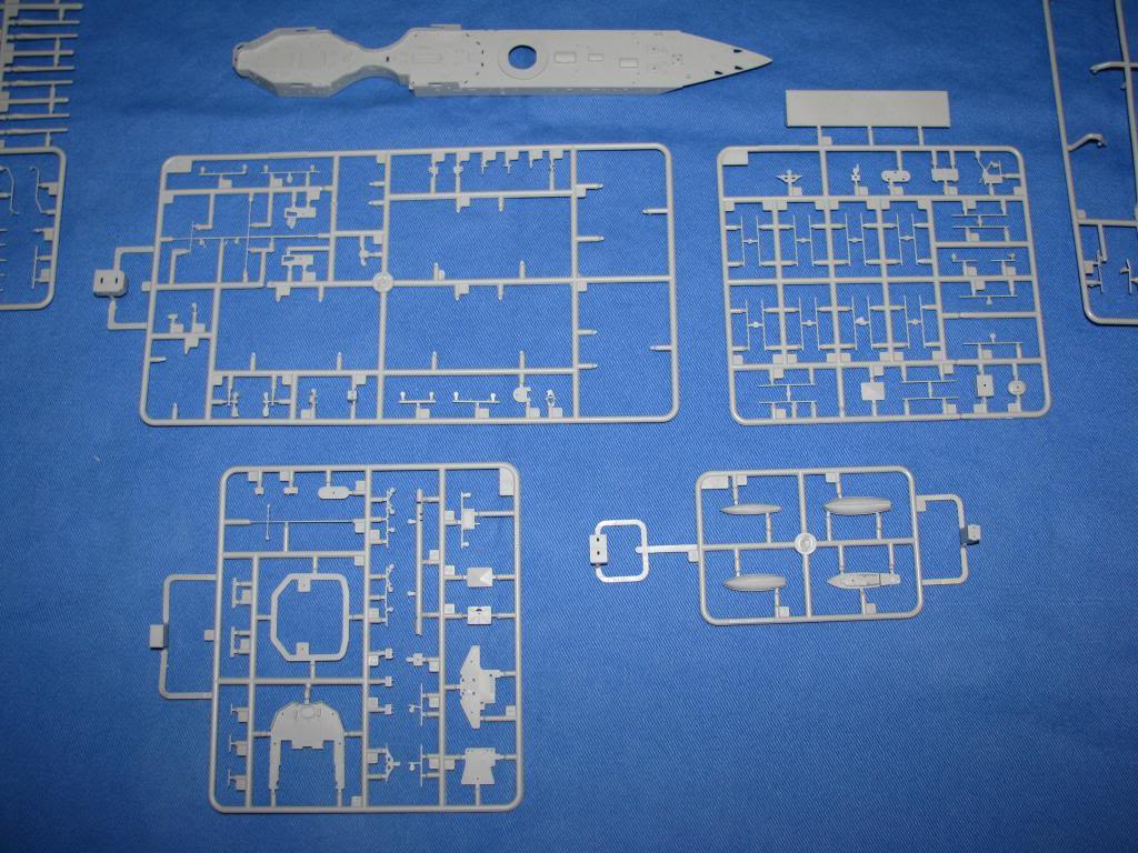

The first set of pictures show the kit, the sprues and the AfterMarket (AM) I will use for this build. I have not decided on whether I will use the ArtWok wooden deck or not. I will probably start by painting the decks and if I cannot get them to look the way I want then I’ll use the deck.
Some of the other AMs I plan on using include Model Master barrels for both the 12" and 6 pdrs along with NorthStar Model resin 6 pdrs with photo etched parts to replace the kit’s 6 pdrs. Brass propellers and Eduard’s photo etch Details and Rails.

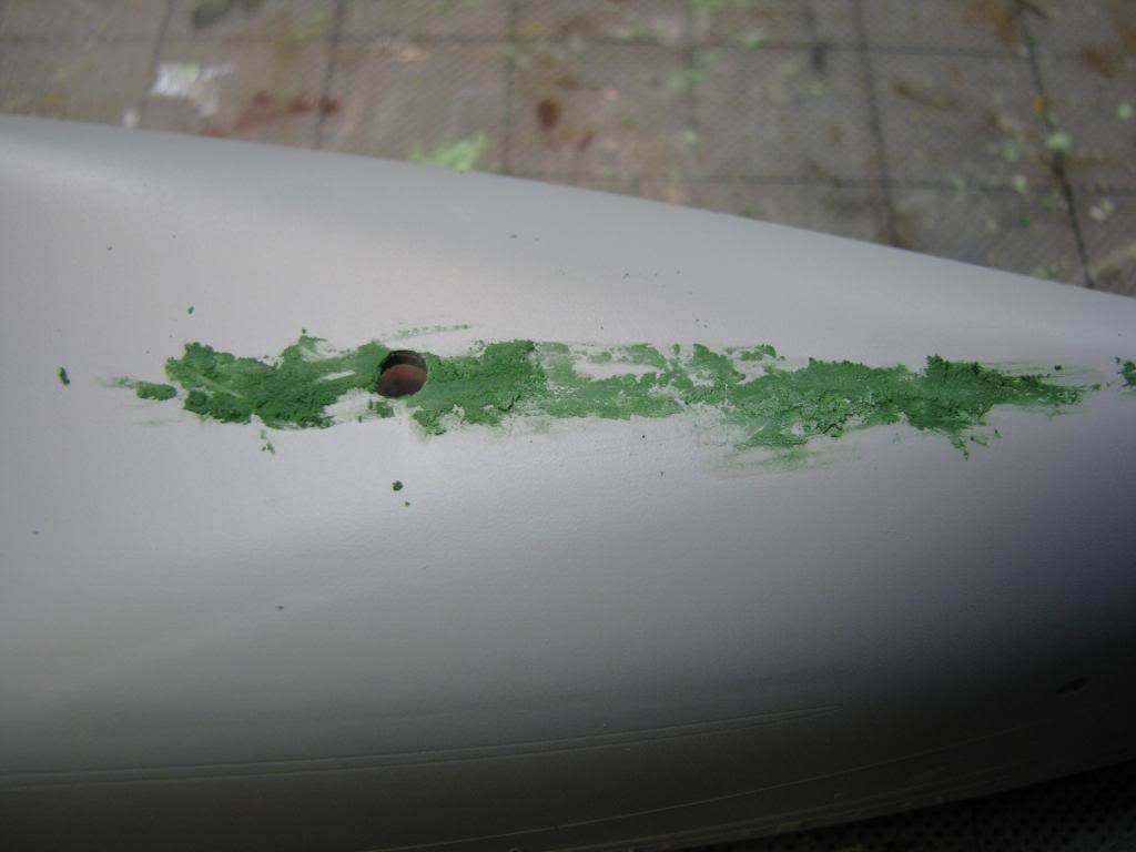

Here are a couple of pics from that fun party today.
Steve

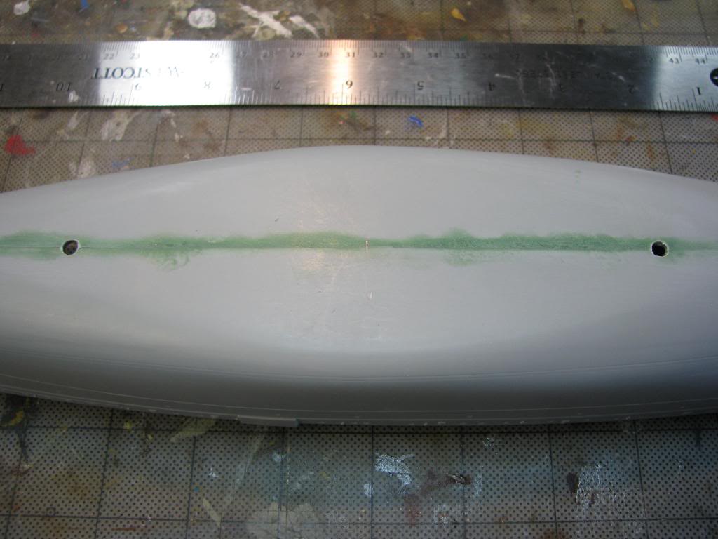

The seam issue went along the whole legnth of the ship as shown.
After about 5 filling and sanding episodes, I go her buttoned up fairly nice. I’ll check again in the morning to see what I missed…
