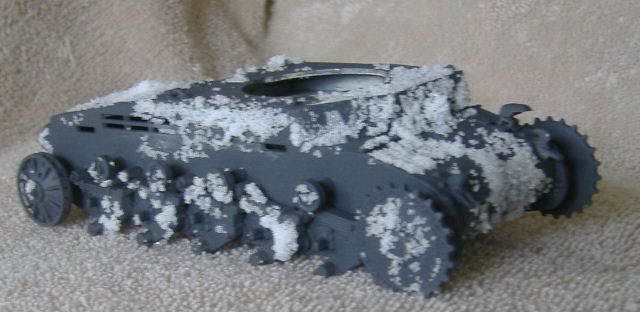

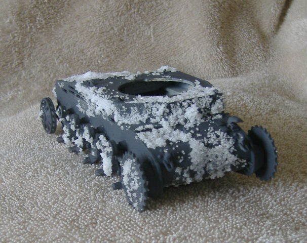

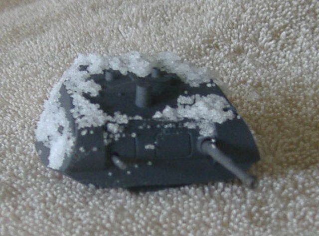

Working on my PzKpw IIC from Alan, panzergrau has been laid down, salt has been HEAVILY applied and is almost dry. I’ll blow off the excess with the airbrush and soon lay down the ModelMaster Afrika Braun '42, and post pics before and after!

http://i38.photobucket.com/albums/e129/brumbar/Toomuchsaltperhaps.jpg
The beauty part of the salt method is that you can go back and “fix it” if, like I may have done, you use too much the first time!
Keep your fingers crossed…

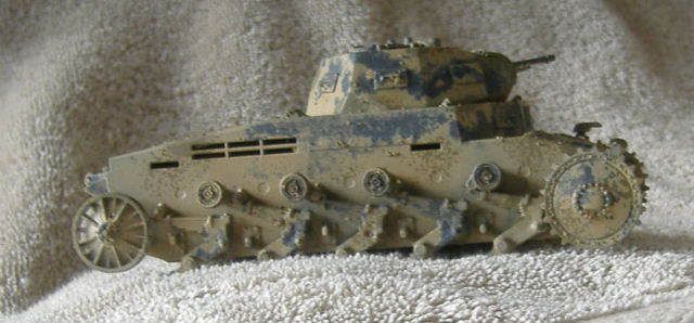

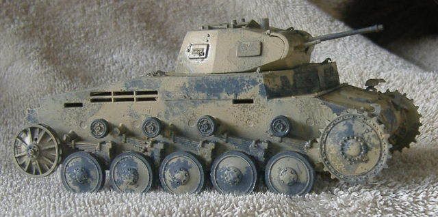

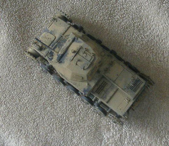

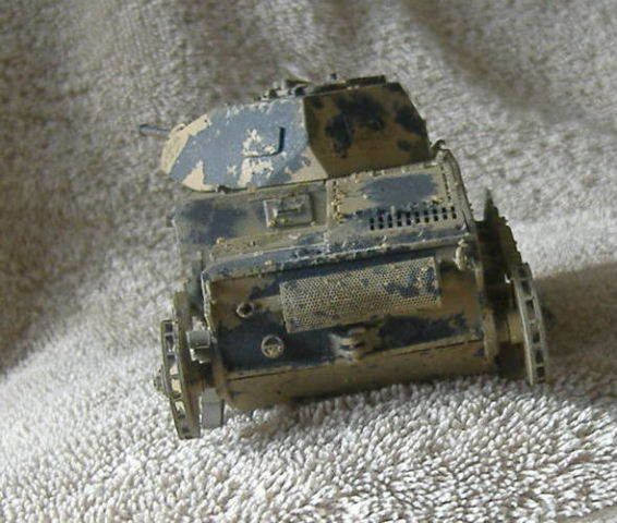

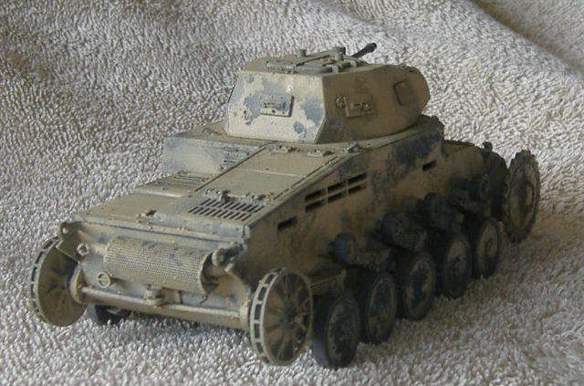

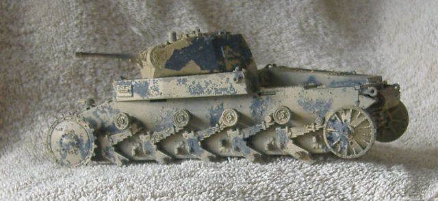

The results are not perfect, though parts came out well, I think. I intend to redo the really bad parts (engine deck and turret, and the box plate is not satisfactory), but over all I’m pleased with the potential this represents.
Let me know what you think:

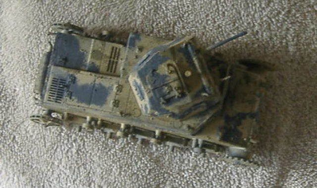

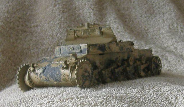

http://i38.photobucket.com/albums/e129/brumbar/PzIIsternafter1.jpg
http://i38.photobucket.com/albums/e129/brumbar/PzIIstarboardafter3.jpg
http://i38.photobucket.com/albums/e129/brumbar/PzIIportafter.jpg
http://i38.photobucket.com/albums/e129/brumbar/PzIIbowafter.jpg
http://i38.photobucket.com/albums/e129/brumbar/PzIIaboveafter.jpg

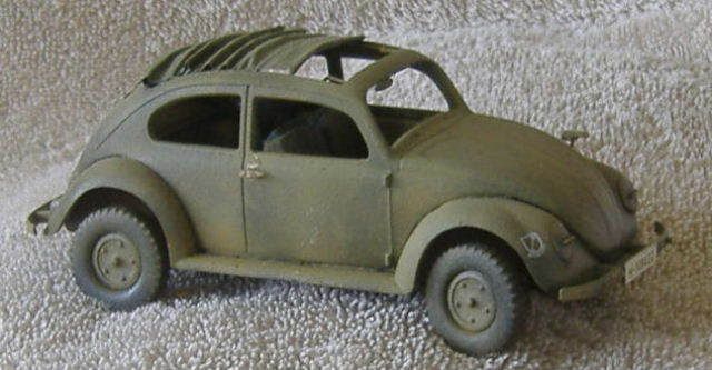

And as an added bonus, here’s my Italerei VW Typ 82, still incomplete after several months!
http://i38.photobucket.com/albums/e129/brumbar/Typ82starboard.jpg
what kind of salt did you use? i like the look you got out of it kind of like it has been to hell and back.
Plain ol Morton’s table salt. I think I shoulda ground it down some, if possible.
And thanks! I’ll rework it some tomorrow.
I think it had a good effect on the final look of the kit but it may have been a little too much salt to begin with. Its just a personal preference though.

I dunno, I’m just going to be honest here, not trying to offend, but what the heck?
Any Panzer with that much chipping would be in the junk yard IMHO. I feel the effect is completely out of scale. I’m sorry, and again, not trying to personally grind you at all, but I think this experiment failed. Respectfully, I would strip this finish and start over. I mean this with all due courtesy, and I don’t mean to be mean spirited at all.
Do a forum search and look at some of the work by Ron Goins (Biffa) and Bill Plunk (wild bill76), these chaps really have the technique down that you are looking for, and hey’ve been kind enough to post full builds showing the step by step (salt free).
regards,
Steve
I agree: too much and out of scale, but it was fun and it can be corrected, so what the hell?
No offense taken; I appreciate the input very much.
No adhesive, Jazza, just water and salt. And where it was really on thick, and had dried an hour or so, it was hard to get off: I had assumed an old toothbrush would be sufficient, but I ended up prying it off with a bamboo shish-ke-bab skewer, using the point for tight spots and the blunt end for the rest.
If one wanted to portray a derilict vehicle then it would be hard to overdo the effect. For a vehicle still in service, IMHO it would not be that beaten up. The effect with salt does have its place, maybe not so much salt with a vehicle still in service.
It is fun to play around and experiment. Thank you for posting your “playing around”. It stirred the waters for me to try out a couple of things on some upcoming projects of mine.

Monday’s progress: some parts repainted, wheels added. Tracks coming along s l o o w l y!
http://i38.photobucket.com/albums/e129/brumbar/PzIIafterwheelsstarboardrear2.jpg
http://i38.photobucket.com/albums/e129/brumbar/PzIIafterwheelsabove.jpg
http://i38.photobucket.com/albums/e129/brumbar/PzIIafterwheelsstarboard.jpg
http://i38.photobucket.com/albums/e129/brumbar/PzIIafterwheelsport.jpg
And BTW, in the North African deserts, in '41 and '42, this kind of sand-blasted look was fairly common. German supply lines had enough trouble bringing food and gasoline, paint was a rather low priority!
Not that I didn’t go overboard.
