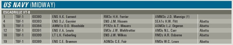

I have a French Magazine with a list of all involved American aircraft, this is what it came up with.
If this list is reliable you should be fine with the number 4! I do not speak French, but as far as I could gather, the first column indicates the aircraft number, the second aircraft type, third is the bureau number, fourth fifth and sixth is the crew. I googled Abattu, which means shot-down.

Thanks! That’s great that I can put crew to the designation. Also good for anyone else building a TBF-1.

That list is spot on. The only survivor was Ens. Earnest and his radioman Ferrier; both wounded. The turret gunner, Manning was KIA. the rest of the Midway detachment were all shot down. So, VT-8, suffered the most casualties of any carrier based, or land based Navy squadron.
VT-8, launched fifteen TBD-1’s against the Japanese and all fifteen aircraft were shot down, with Ens. Gay being the only survivor. Twenty-Nine men lost their lives. VT-8 also launched six TBF-1’s from Midway. These were some of the TBD’s replacement aircraft, and five of the six also were shot down. The TBF carried a crew of three,so fifteen more dead, PLUS the gunner from T-8-1. Forty-Five VT-8 aircrew were Killed in Action within the space of two hours. And that’s not including those who perished from VT-3, and VT-6. Those were the other two carrier based Torpedo Squadrons who were pretty much destroyed at Midway.
The list provided by ancoron109 is spot on with the numbers of the aircraft that flew from Midway and the aircrews who manned them.

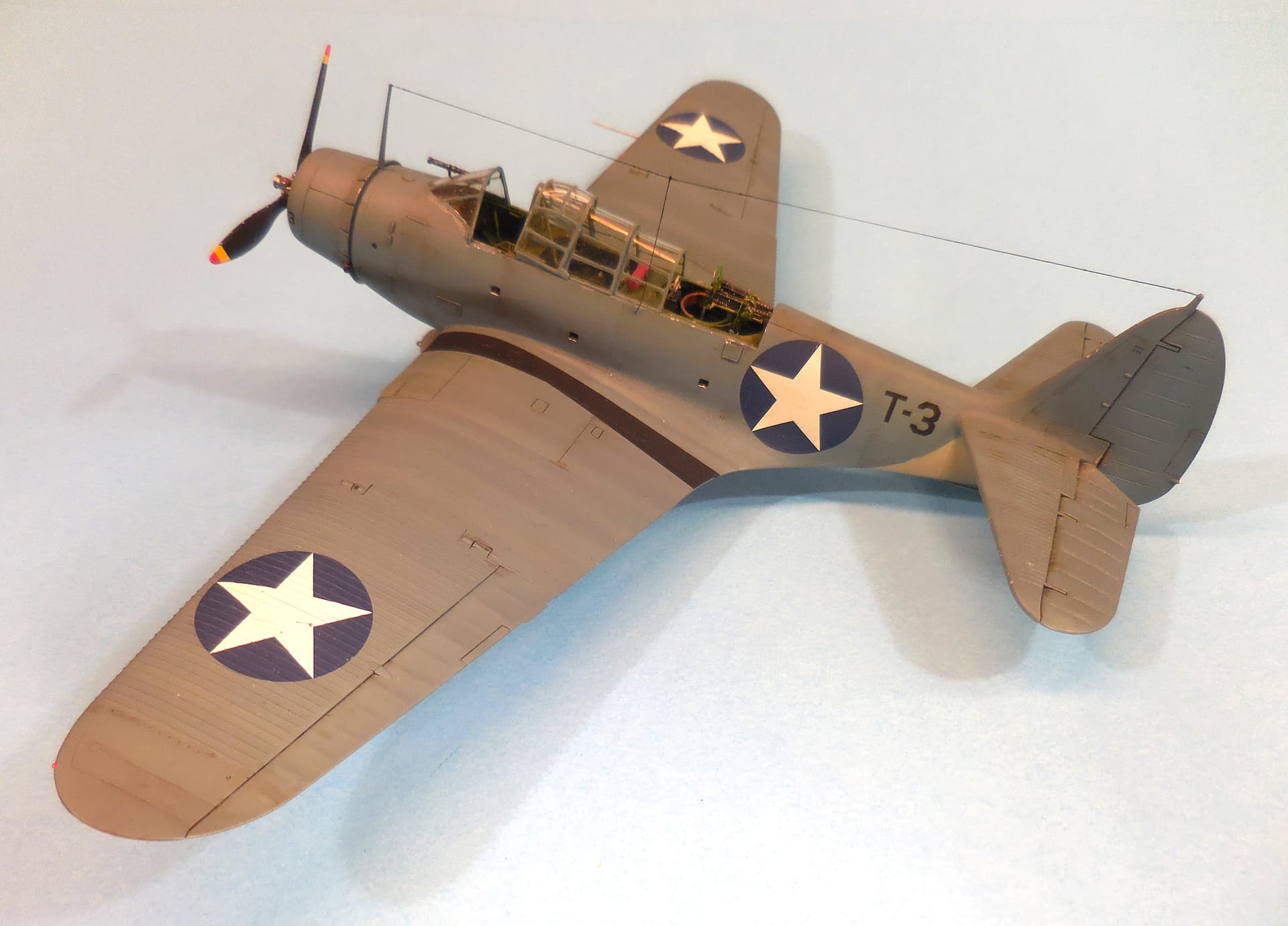

Here’s another interesting tidbit. TBD-1’s aboard Hornet had parts of their aircraft numbers painted out. “T-3” was crewed by Ens. William R. Evans and Ross E. Bibb Arm3C, VT-8 at Midway.
This is a picture of the Great Wall kit I built several years back. Up until April 1942, the national markings would have been smaller and had a red dot in the center. The rudder also would have carried red and white stripes. The fuselage marking would have been farther aft and the side code would have read, “8-T-3”, in black. When the orders came through to remove all red from our aircraft, for obvious reasons, they also reapplied the national marking much larger, painted out center of the star, the rudder stripes and removed the “8” squadron identifier from the side number. This left only the “T” for the plane’s mission and “3” the plane in squadron number, which was moved further aft to accommodate the enlarged star. This was done on carrier based VT-8 aircraft. Also, VT-8 and VT-6 TBD’s had up gunned the rear MG position to having two .30 MG’s. I am not sure if VT-3 had done the same yet. I’ll poke through a couple of my references books and try to get the answer for that
Now look at pictures of the Midway based TBF’s. They did have all the red removed from their aircraft and they also had the enlarged national insignia, but, they also carried their full side numbers, ""8-T-1, 8-T-4, etc
Both the overall Squadron Cdr of VT-8, CDR. John Waldron, and the Midway detachment Cdr, Lt. Langdon Fieberling, both flew aircraft number 16 from their respective bases. Waldron, T-16 off Hornet and Fieberling, 8-T-16 from Midway. Both were KIA. Anyone building a TBF needs to have the side number read; “8-T- xx”.
I hope I didn’t confuse you guys, it took me a few minutes to re read and make sure the info is correct.
