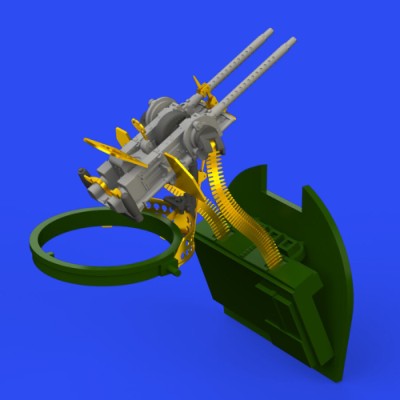

I’ll second that about the rear gun position having been upgraded to twin 30s. Soon after the TBD squadron reached Midway, they borrowed the extra guns from the SBD squadron in addition to re-marking their aircraft.
Gary
That’s an interesting bit of history! I’d love to know how people are handling the conversion from the single rear gun to the twin-gun configuration on their models. Is there an aftermarket option available, or is this something that requires a little scratchbuilding?
Eduard does a nice one

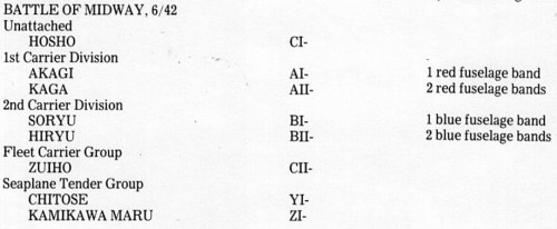

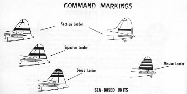

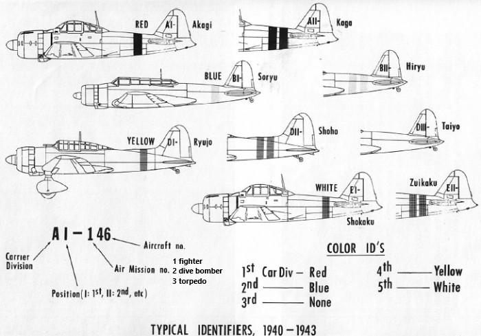

For everyone who is considering about building a Japanese aircraft, like me when I finished the TBD-1, a short excurse into the sea based marking system.

Haven’t found a 1/48th scale twin 30 for any TBDs that only have the single gun (yet), but here’s a 1/32nd scale that you can use to scratch up something if you need too.
Gary
https://www.eduard.com/eduard/brassin/aircraft/1-48/sbd-5-twin-machine-gun-1-48.html?utm_source=chatgpt.com
Found it!
The Eduard set 648712 …
… is designed for the SBD-5, I am sure it fits to the TBD-1 and SBD-3 as well.
Well, that’s good to hear, because I just bought one! Apparently, I got the last one Sprue Brothers had in stock. I figured with this group build coming up, I’d better grab it before somebody else did. :grinning_face_with_smiling_eyes:
I’ll be building the Accurate Miniatures 1/48 SBD-3, and I found a build review where someone used this exact Eduard set on the same kit, so at least we know it’s been done successfully.
The one thing I’m still investigating is whether the ammunition feed and mounting arrangement are correct for a Midway-era SBD-3. But I’m perfectly willing to make a few modifications if necessary.
For $15.54, I figured it was worth taking the chance!
i am prety sure the ammo can and feed shoot remained the same though out the series.
Our posts were almost simulanious - you were 1/10 second faster :joy:
Luckily for me the GWH TBD-1 kit provides the twin oob.

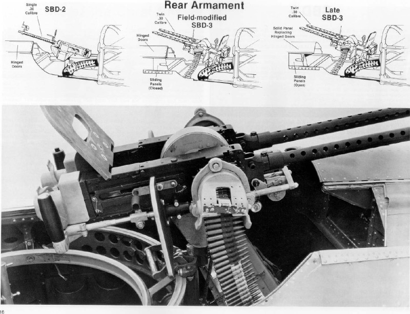

That MG mount should work on both the TBD and the SBD, for those that need to correct the rear MG position.
SAM: The twin mount .030 weapons found on the SBD-3, were belt fed from a large ammo bin located on the gunner’s rear bulkhead. The single weapon was fed through ammo cans, ALSO stored along that same rear bulkhead.
I do NOT know if Marine SBD-2’s were converted over to the twin .030’s or still had the single mount. I suspect the later.

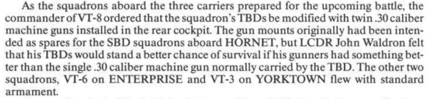

TBD’s of both VT-8 and VT-6, had both been converted over to the twin .030 mount via field modification. I still have not found anything confirming VT-3 had also converted, and were still carrying the single weapon. I’m still looking but I have not found anything concrete on VT-3.

A real treasure trove of information on the aerial recognition stripes carried on Japanese aircraft throughout the early Pacific War. This was the system in place at the time of the Midway battle.
I think we’re in good shape then. The Eduard twin-gun set I bought appears to include the guns, mount and feed-related parts, so it looks like we already have everything we need for the SBD-3 rear gun setup.
Thanks for helping me sort through it!
I have this information from Squadon series Aircraft in Action, #1097, the TBD Devastator issue. No idea about the accuracy, but usually they are.

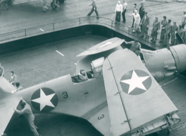

I also found a photo quoted 6-T-3 prior to the Midway launch - definitely with the single gun.
