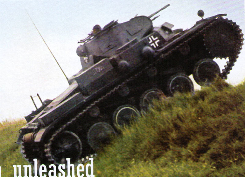

As to the question on the air recognition flag/emblem, it’s hard to get top-down shots showing it but they were used. I don’t know that I would say they were used on “all” vehicles as there’s also a lot of photo evidence of red cloth Nazi flags being used for the same purpose. I did find a color photo that shows, at an angle, the presence of such a white panel, from Panzerwaffe Vol 2: The Campaigns in the West 1940 by Mark Healy (posted for discussion purposes only).
Good point about the jack bill, and ye, any jack, as long as it can take the weight, is better than no jack.
I have seen that photo and i few others but i wsn’t sure. I thought maybe it could have been a trick of the light due to the angle of that part of the vehcile. But your pic is a lot clearer than the one i have and shows it clearer than any otehrs.
