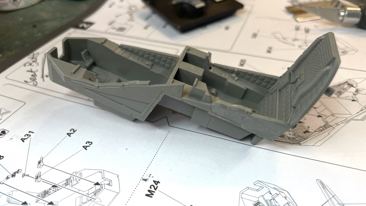

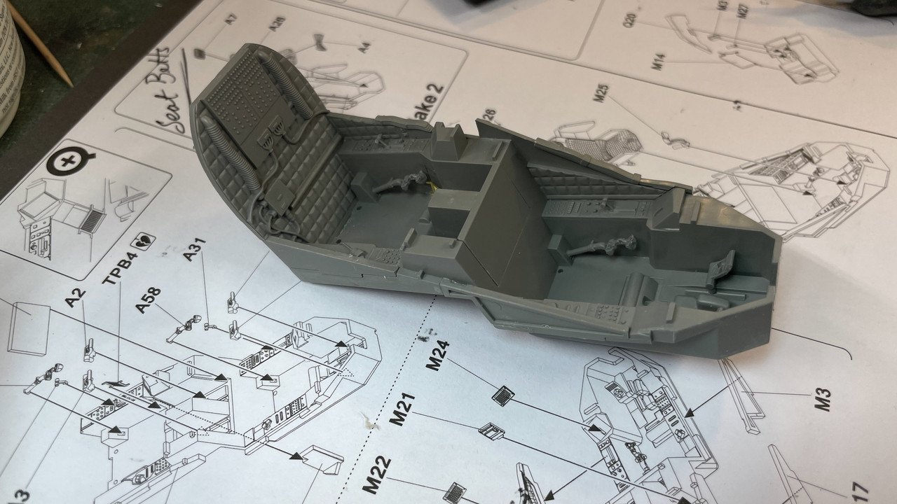

The first step has you building up the tub.
The gunner’s (front) rudder pedals are out in the open and easy to put in now. The pilot’s pedals are going to be shielded by the center bulkhead. Therefore, hold off putting in the bulkhead until you get the pedals installed. It’s easy to want to put that structural piece in first, but resist it.
Part M20 goes on the outside of the tub, but the instructions were difficult to determine this. After fussing with it inside, I did some lateral thinking and said to myself, “Where else could this go?”

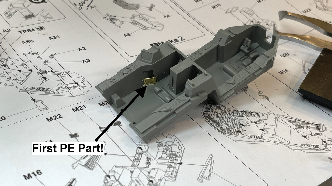

The 2nd part was the first piece of PE of many. There’s quite a lot of PE in this model; four frets including one for the blade fold project. After advice from Brian Bunger, the propietor of one of the best hobby shops in the USA; Scale Reproductions, Inc., I apply PE using Gel CA. It stays where you put it. You can apply tiny amounts. And it cures slowly so you can actually move the PE around to position it without it kicking halfway through. When you get the part where you want it, a small brush with a small amount of accelerator and it kicks. This was a kick plate for a vent, I’m assuming.

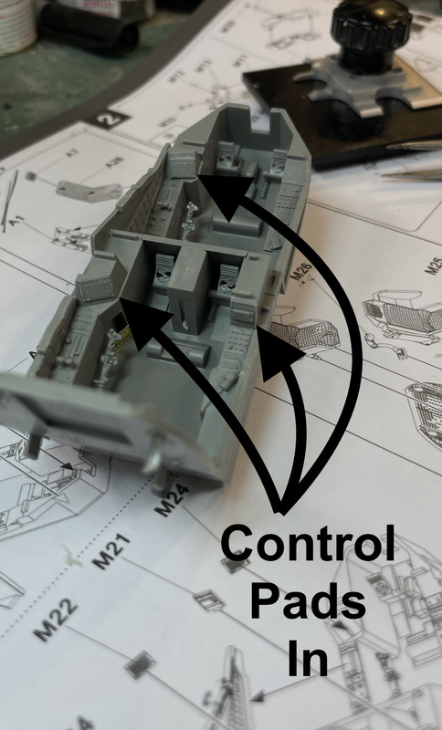

Three key pads go in next. These had distinct mounting features and you can’t mix them up. The kit has screen decals, but no other buttons. These will be hand painted. While there are keys on these details, their relief seems shallow so making them distinct won’t be easy for me.

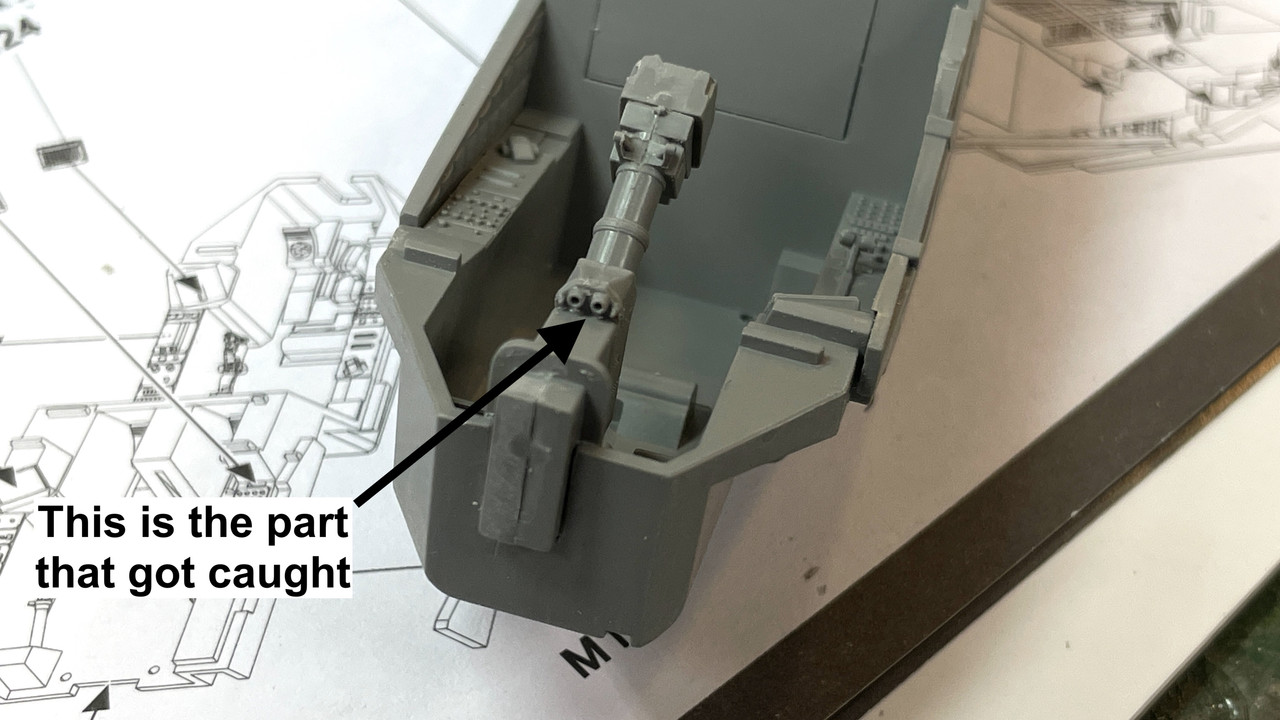

I work on models with high and tiny parts count with my “parts catcher”. It’s a piece of cloth stapled to the underside of my work table, draped over my lap and then clothes pinned to my shirt. This doesn’t catch everything, but parts that drop straight down are caught. I have two walls on my work table on the back and right sides to block flying parts that head in that direction. There’s still open sky and other ways for parts to enter the quantum rift, but I’ve mitigated some of the avenues.
Here’s the drape.
And here’s a part that it caught (among others).
And here’s where that part goes.
I don’t know what that part is. It faces under the control panel and won’t be seen.

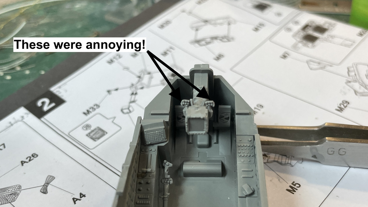

Two more parts went onto the gunner’s console: His trigger controls. They’re identical and were a pain in the butt. Sometimes little stuff can drive you nuts.

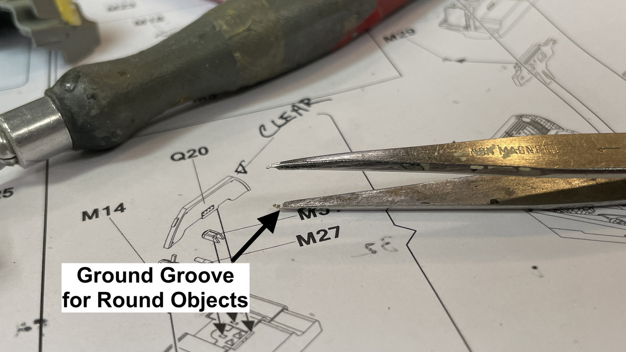

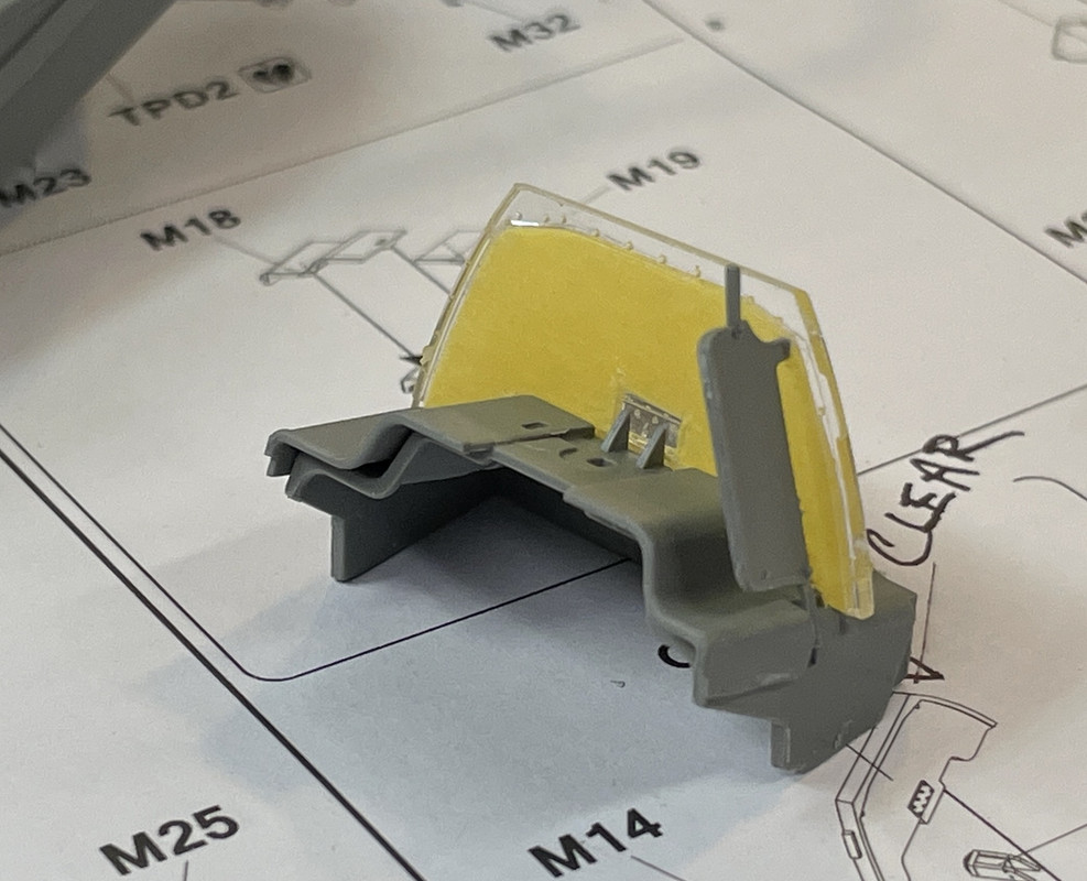

Last thing I did required another decision. There is a transparent armor glass shield between pilot and gunner’s compartments. The instructions have it going on now, but that would be a problem with painting. But there is a plastic wing attached that should go on now for better gluing reasons. I chose to mask the glass now and install it. I can then paint the tub without worrying about it. This assembly also will go on as a subassembly after tub painting.

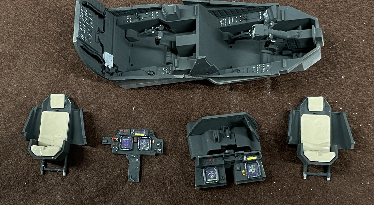

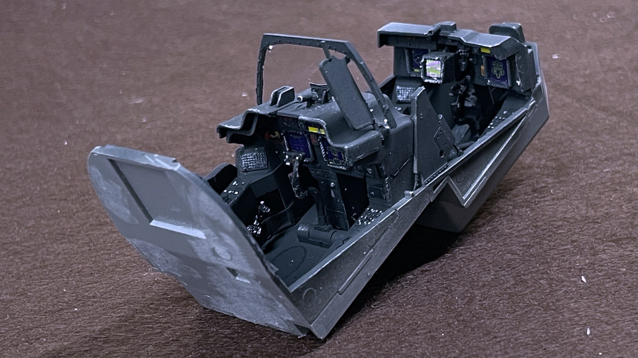

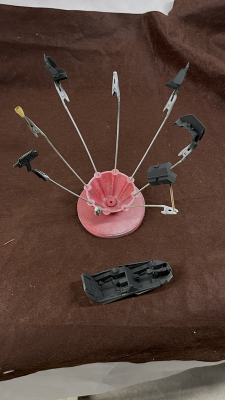

Finished the tub as far as I could go without painting stuff. My decisions to keep it open for access for airbrushing and detail work seems to be correct. I was having trouble with my various tweezers holding small round objects so I took another pair and made a small mod with a diamond burr and the Dremel. The group grips nicely and the parts don’t go “Sproing!” all over the shop.
I put the parts on my Ed Tackett designed parts holder and shot them with NATO black. I painted the tub holding it in my hand.
While this was all drying I drilled the openings in the fuselage sides based on the instructions for this particular iteration of Apache. The sides had a few sprue attachments that needed snipping and cleaning. I test fit the fuse sides together to get an idea of how they mated. They mated well!
Two drills were called out: .7mm and 1.0mm. I used the English equivalent of them and drilled them out and lightly deburred the outside hole. One of the holes had to be drilled at the junction of the two hull sides. I hand-held the sides and drilled the hole successfully.

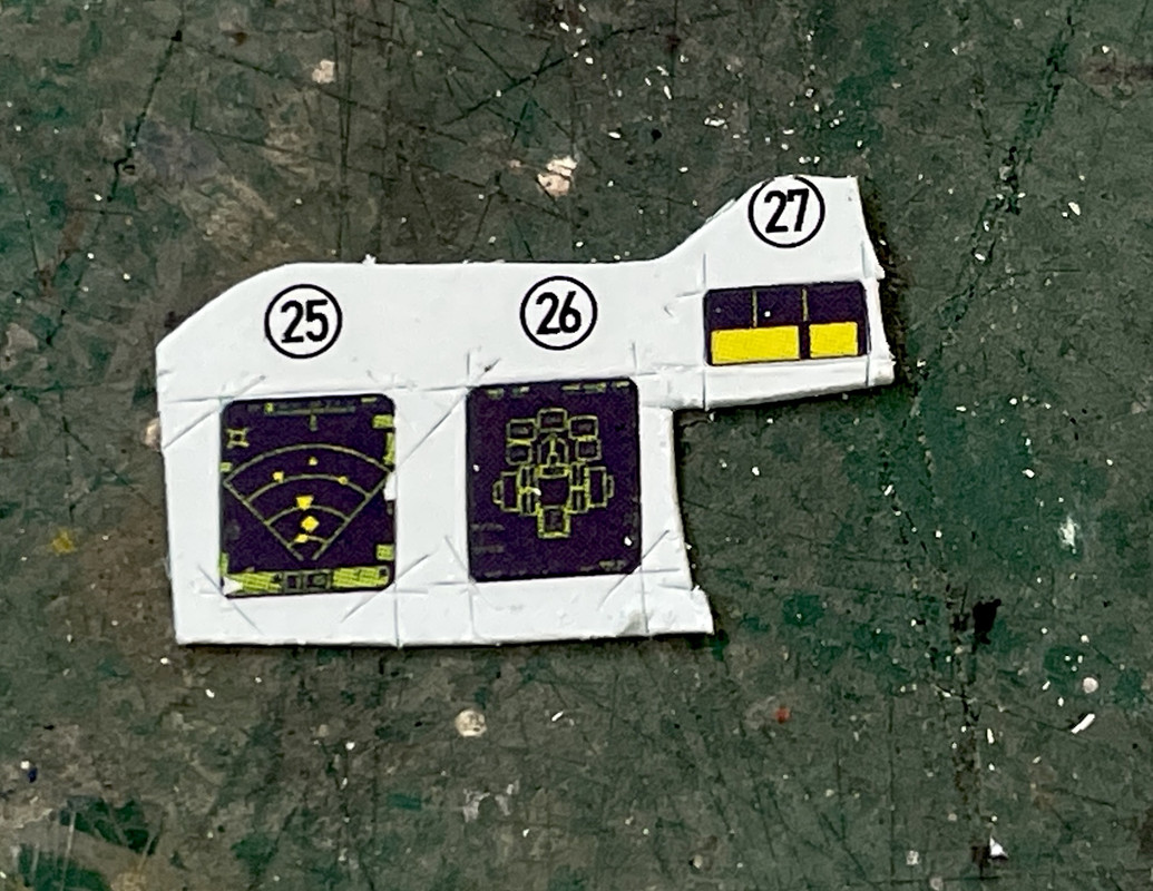

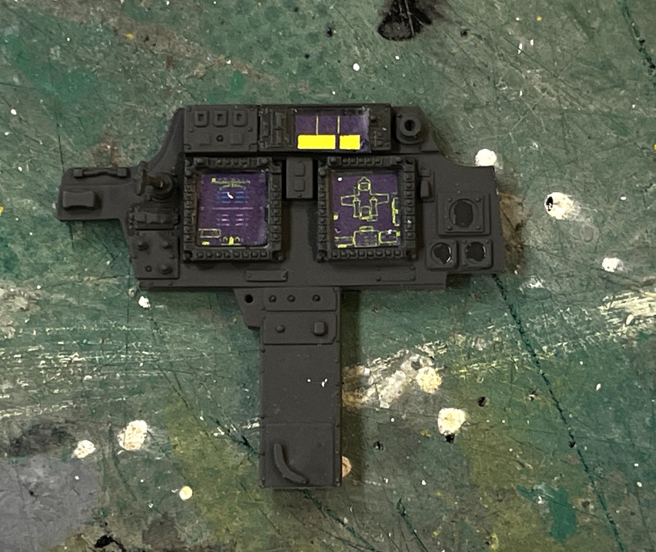

After viewing the videos and reading reviews it was quite clear that decals would be a problem. I chose to use the screen decals for the instrutment panels. To ensure the thick carrier film was not a problem, I used the #11 blade to slice through the film to separte the colored part of the decal right at it’s demarcation line. I didn’t cut all the way through the decal paper since you need something to hold onto.
This let the decal sit nice and tight against the screen boundary. I used Tamiya clear as a base coat for the decals and then, after application, Microscale Microlsol. They did settle down nicely.
I’m not gloss coating the screeens. They are not glossy in real life. After decal application I started the detail painting. The panels ARE NOT colorful. There is very little color other than matte black and light gray. I painted the knobs Tamiya sky gray, and the tiny toggles just a touch of Molotow chrome. The dots are so tiny you can’t tell what color they are. If fudged the three steam gauges to the right of the pilot’s rt hand screen.

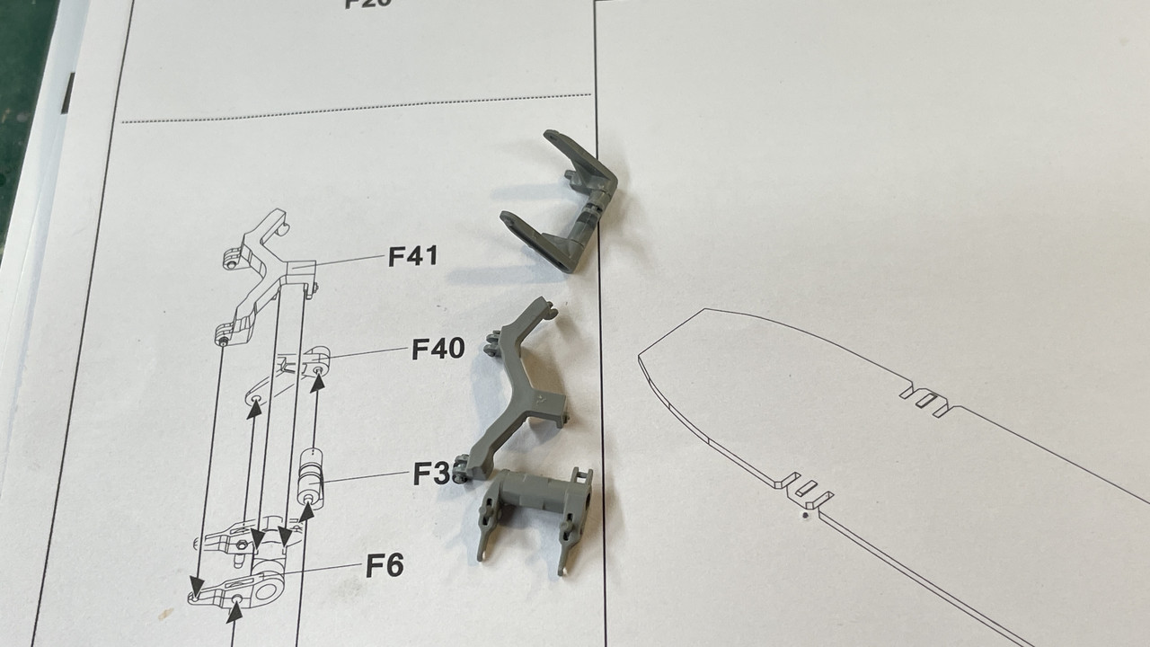

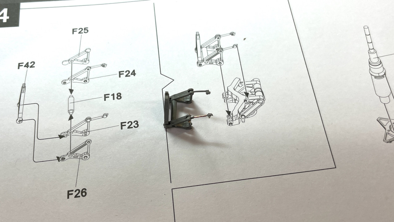

While that was all drying I started on the complicated and very delicate rotor head. I already broke one of the very fine extensions on one of the parts. I don’t actually know when it broke. One minute it was there and the next gone. Much of the rotor is completely hidden by the fuselage fairing so I don’t know if it’s critical to replace it with wire. I have the skills to duplicate that portion of the part. I’m just not sure it will be worth the effort.
The instructions for this portion are difficult to interpret and I trial fit it together multiple times before I understood just how it went together. The cylindrical part’s spindle is slightly oversized for the hole and in attempting to push them together was probably what broke that tiny rod. I should just open up the hole with the properly sized drill. I did attempt to slightly reduce the size of the pin.
As I was starting to get frustrated and it was dinner time, it was a good time to quit before I broke anything more. I’ll tackle it again tomorrow and probably will re-make some of the tinier rods out of metal. Styrene doesn’t work for everything!
I did drill that tight pin hole larger so it would no longer be a press fit. It was a #54 drill. I then made a metal connecting rod to replace the missing one. I first had to cut out the remains of the existing rod to leave an open clevis to accept my homemade part. To make these kinds of things, I take the phos-bronze or brass wire and crush an end flat in the powerful jaws of a Vise Grip. My vise grip was my dad’s and is probably 60 years old. They don’t wear out. I squish it in the jaws while tightening the screw until it gets as thin as I want it. I turn it over, clamp in different places on the on the jaws so the piece is flattened evenly. Since this piece needed a round end with a little bit of thickness, I added some solder on both side. Final shaping was done holding the shaft in a needle nose and filed both in thickness and width. I rounded the end.
I used a scratch awl to make a fine center punch mark and used the 0.022" carbide drill to create the pin hole. The other end, after capturing the length for the existing one, had the same treatments and then a piece of rod soldered in to simulate the pin on that end.
I had to drill the bracket with the same drill to accept the pin. I first cut off the fake pin’s nub and filed it flat so it would accept another center punch mark for an accurate drilling. I had to further reduce the radius of my rod’s end so the two holes would align and accept the real pin.
Putting that vertical lever on was a challenge and the glue joints of the cross pin kept breaking loose. I finaly got it together and decided to let in cure fully before finishing the assembly tomorrow (or wednesday). My younger (19 year old) grandson and I are installing a new garbage disposal. Depending on how long that takes will determine how much shop time I’ll get.
Waiting in the wings is another part of this complex set of swinging levers and frames that provide the cyclic and collective inputs to the swash plate on the rotor shaft. Helicopter mechanics are something else! This drawing, like others, is misleading. The leftmost arrow descending down from part F41, does NOT interact on that pin on F39. It falls way wide of it. I’m assuming that arrow just shows the direction the part must be assembled. I’ve read complaints about the instructions and they’re not wrong.

With a fresh start I tackled this ridiculously complex and fragile rotor head. I had just played guitar for about a half hour. I’m very out of practice and pledged this weekend that I’m going to start playing again to build up my strength and callouses. I was inspired after seeing an old Austin City Limits show featuring Stevie Ray Vaugh (RIP) at his last appearance in 1989. Why am I telling you all this? Because the exercise and being a little low on blood sugar left me with very shaky hands and I was about to finally assemble the lever bracket assembly I started yesterday.
I have a ton of images today, and a lot of dialog since this was one heckuva session, so strap in… And paraphrasing the words of Obi Wan Kanobi remarking on the Tatooine Cantina, “things could be a little rough”!
After trimming the homemade link a scosh more I was able to get is all together. I ended up drilling more 0.022" holes and pinning the final connection instead of relying on the tiny plastic protrusions. It’s now a reasonably stable assembly.

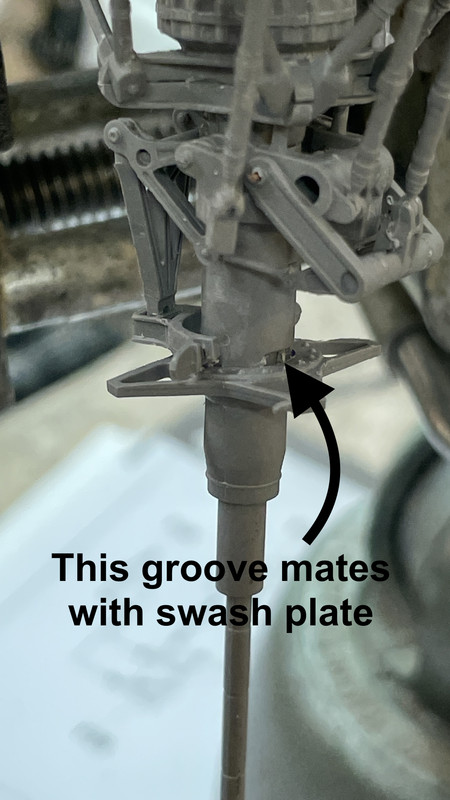

The mast then slipped in between and glued into the base with a key to align it. BEFORE PUTTING IT IN PLACE YOU MUST PUT PART #F52 ONTO THE MAST. This part is supposed to be NOT GLUED. That’s a real challenge as you’re suppose to install swashplate parts below it and they must be glued.
Just underneath the rotating connection plate (possibly for the collective pitch) went a two-part swash plate (term??) with two frail links that tie into the lever assembly installed earlier. The swash plate without the pins goes in first and engages another lever in this assembly. This was a horror, but not the worst horror. You are supposed to glue it in place WITHOUT gluing that collective plate above it. My first attempt with liquid cement did just that…glued it! I was able to spin it enough to break the not-complete-bond and get it moving.
There is a lug on the i.d. of these two shells that is supposed to engage in a similarly shaped slot in the main shaft. They are different sizes so you can’t mix up what goes on which side. As I fussed with getting the rest of this in place, it kept breaking loose… over and over and over…

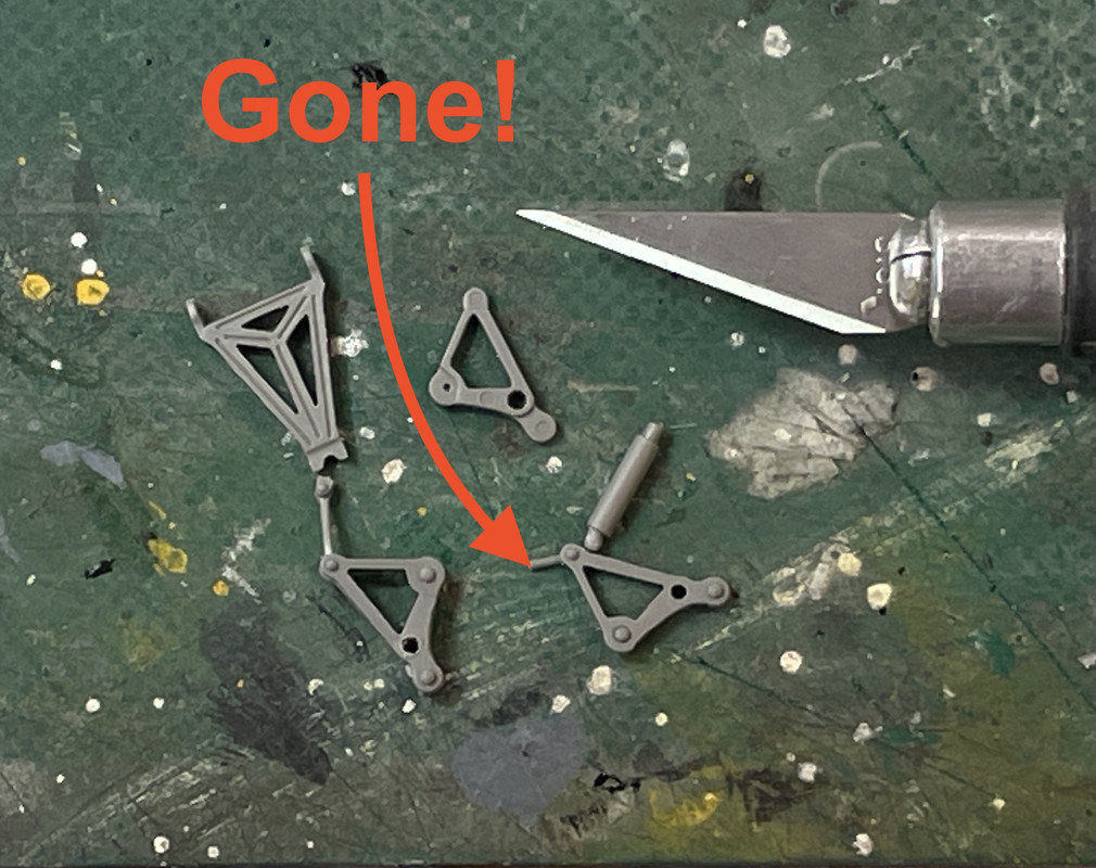

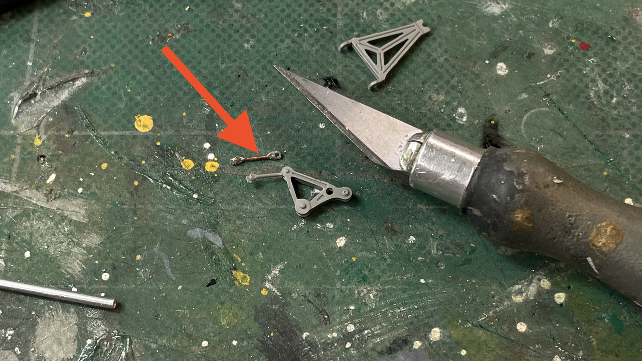

Then came the real horror show. The last one was just a “coming attraction”. In addition to putting the second shell in place into its rectangular slot, you must also captivate two tiny connecting links.
Attempt #1: I glued the two links into the pins on the non-attached shell and tried to manipulate it into position while catching the lower end of these links into another clevis on the lever mechansim. Not only didn’t it work, knocking the previously installed shell off, but it ended up breaking one of the links in half. I then crafted a replacement matching the length and design of the two ends: one enclosed and one with an open slot.
Attempt #2: Same scenario except this time one plastic and one metal link fell off.
Attempt #3: Plastic link #2 gave out. Getting a bit scary now, isn’t it?

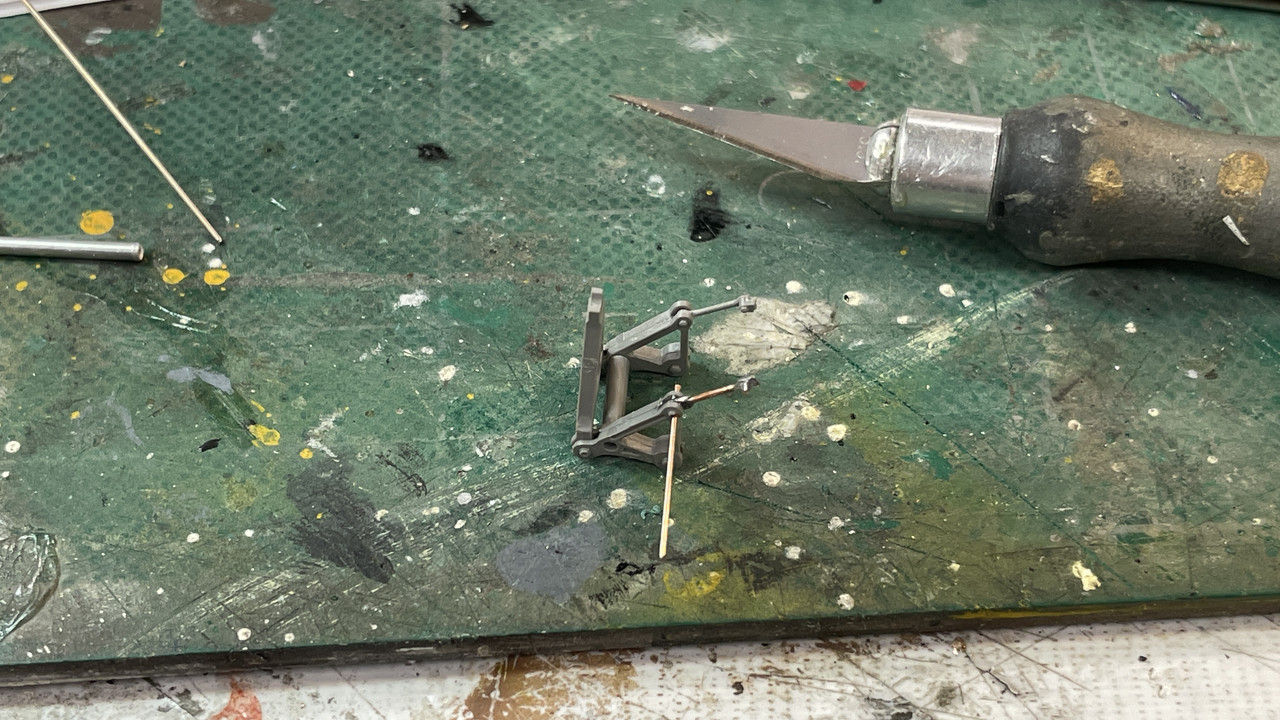

With my vast experience making metallic links, I quickly crafted another the same length as the first one.
I then made a couple of changes so I wasn’t doing the same thing over and over again expecting a different outcome. Hey! I’m obsessed! I’m not crazy!
I also removed the rectangular lug on the one shell that I was having trouble installing since the lug was not fully entering the mating slot and was preventing the two shells from meeting properly.
Here’s the slot that wasn’t working.
Problem solved! This shows the short pins which I subsequently abandoned.

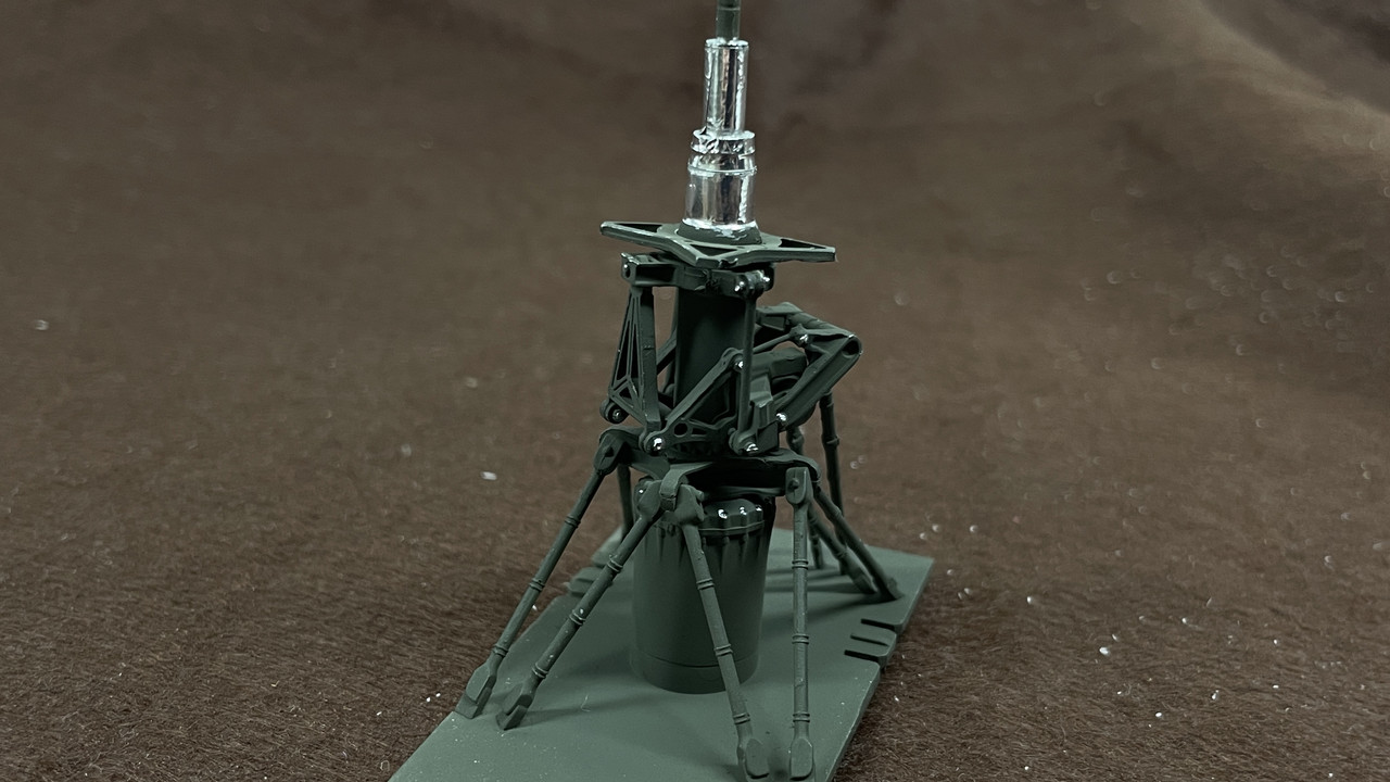

I also realized that attempting to hang the links on those tiny plastic pins and expecting it all to hold together as I kept manipulating the parts simply wasn’t woring. I drilled the plastic pins out of the one shell and fully drilled out the dimple ont the other. I originally cut the metallic pins correct length, but this was just as hard to assemble as with the plastic pins. I wised up and used long pieces of 0.022" phos-bronze that I could thread through both shells and then guide them together.
Once I got all these mods in operation, I was finally able to bring all the parts together. I brought then into engagement gradually, making sure that the links were engaging their correct clevises in the lever block.
Once I got the two halves positioned, I was able to swing the links up into engagement without worrying about all the parts falling into my parts catcher.
Here’s the reverse view showing the lnks into their respective locations. You really have to master the skill of drilling tiny holes in akward places to do this work. BTW: my hands steadied out after a snack and some Gummi Bears.
And here’s the fully assembled lower control end of the main mast. There’s another crisis waiting around the corner. That upper rotating part has two little ears with slots to receive other links. Both of these ears have one half broken away and will need to be replaced. I believe I can either form it with Bondic UV curing resin or make it out of PE fret material. Either way, I’ll get it fixed.
That last bit took well over an hour to resolve. I can see why some folks are just leaving all this stuff off the model since it’s out of the sight line. I also can imagine that a lot of modelers just don’t have the experience making these small jewelery-like parts. If I had it my way, I’d replace all the plastic links with metal. I believe when Neil on videos got to this step, he wrestled with it all off camera. Granted, my metal links are a bit simpler in design than the kit’s, but when painted, no one will notice. I had to do this a lot of the Seahawk too for the same reason. If I had a swiss-type lathe that can turn tiny long parts, I’d machine them all.

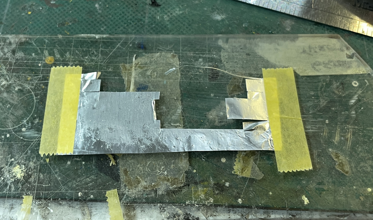

After airbrushing the rotor head and deck Tamiya Olive Drab, I prepared some thin aluminum foil to finish the steel portion of the rotor shaft. I have some German Aluminum foil that’s very thin. That roll is over 20 years old and came back with us when we repatriated back from our German sojourn in 2002. It’s thinner than standards Reynolds. I didn’t have bright polished Bare Metal Foil. I do have the matte aluminum, but didn’t want to use it in this application.
To make the foil adhesive, I coated it with old standby Microscale Foil Adhesive.
I actually measured the different areas area with a dividers and made each strip long enough to overlap the ends with reasonable extra. I then picked out all the shafts and pivots with Molotow decanted chrome with a very fine detail brush. I buy eyeliner brushes from Amazon to do this. They are very cheap, about $8.00 for 100 of them. They’re impervious to solvents and when they don’t work well anymore I throw them away. I like how this turned out. As I noted, the metal links do not look out of place now that they’re painted.

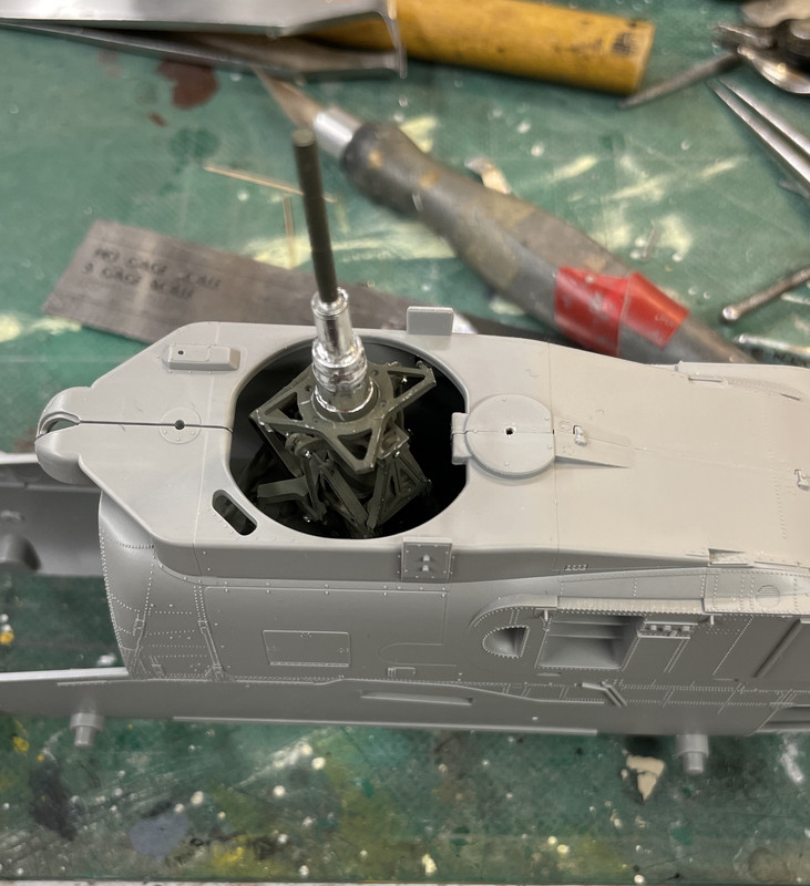

I tried this assembly into the fuselage. The piece keys into the side with very positve lugs, and the cockpit locates well too. As you can see, you can’t see much!
A lot has to happen before I button up the fuselage, but it was worth checking. I also did the final treatment to the cockpit and glued it together. I did very light weathering on the edges, rudder pedals and gloss coated the screens. I had trouble getting the masking tape off the lower edges of the armor glass dividing panel and scratched the clear styrene. I brushed a coat of Future on it to hide the scratches. I also put a wash on the seat cushions. I know there are aftermarket items that could even notch the cockpit up a level, but frankly, it’s seems sufficient out of the box.

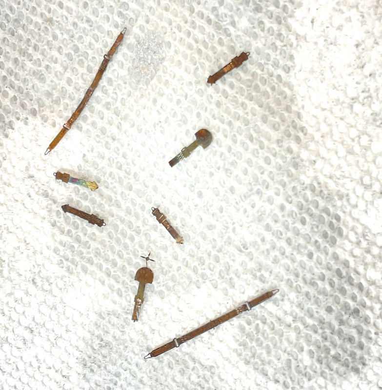

Then came the kit’s PE seat belts. There are no instructions on their use. I first treated them in vinegar to micro-etch the surface to accept paint. I then treated them with JAX brass brown treatment which also chemically treats the surface.
I then hand painted them neutral gray. Photos show that these belts can be gray.
I have no idea just how they’re going on, and I’m not a big fan of PE seat belts since they can have a mind of their own. I supposed I could have annealed them beforehand so they would be soft enough to conform to any shape I want, but I didn’t. Wish me luck. I’ll molotow the hardware after bending.

First the metal rod substitution.
The male pin was on the top of 1/2 of the drum. I filed what was left of it level with the surround surface, made a center punch mark with an awl and then drilled it all the way through and out the other side so the rod would be properly aligned.
The bottom had a female divot which was supposed to be captured by the pin in the bottom bracket. It was very dubious. With the metal, it ain’t go’n anywhere.
The lens on the top optical unit had two side bumps that were to key into respective divots on the two plastic shells. The instructions, which I didn’t read as thoroughly as I should, showed the plastic lens being attached to one side and then captivated by the other. I glued them together first thinking the lens went in from the front as the other two, and left the bunps on, only to find that I couldn’t pass the lens through the opening because the bumps got in the way. I filed them off and spent way too much time positioning the lens in the opening. It kept flipping or dropping inside. Persistence won the day. I used Testor’s Canopy Cement to hold all the glazing.
For the telescopic optics. I painted the chamber flat black. When dry went over the lens areas with Dull Coat to seal the black. Then applied Molotow Chrome and let this dry.
I added clear green and a mixture of clear red and blue to the two lenses. That ended the session.
The glazing for this one goes on next. I’m deciding on how to mask them. I’m vascilating between liquid mask or trimmed Tamiya tape. I’ve had mixed results using either method. Should have painted the insdie of the larger opening flat black. Didn’t realize you could peer into that space.
Mask problem solved. The pre-cut mask set I bought HAS masks for all the optics lenses. As Mark Knopfler said in a song, “You might get lucky sometimes.”

So I’m finally back in the shop and got some Apache work done.
The mask set (AllScale from Czech Republic) is very precise. There are masks for the interior and exterior of all glazing. The interior frame has rounded corners reflected in these masks.
And the outside masks have squared-off corners. There was just some tiny trimming needed on a few edges with a brand new #11.
I airbrushed the interior frame with NATO black. I was able to remove the masks on the side glass, but left it on for the roof glazing until I got more detailing done on it. This is a model for a friend and not going to be a contest entrant. Therefore; I’m going easy on the detailing. To that end, I’m leaving off a lot of the doodads inside the cabin roof, and I’m not opening the doors. The model is much more secure with the doors in the closed position. With them closed, the roof is hard to view and therefore, I’m leaving stuff out.
