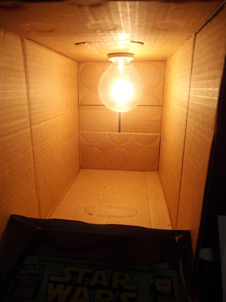

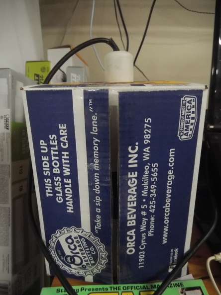

Testing #2 is a bit more involved, but can be done with some common household items.
When I first started using acrylics I had issues with peeling etc no matter how long I let it stand. Turns out the temperature was too low and the humidity too high. Quick solution was creating a dry box.
I built one out of a small cardboard box, an old 60w incandescent lamp, and used an old meat thermometer to check the temp.
Basically you just need an enclosed space where you can hit about 110F. It drives out the moisture and helps the paint harden.
If you don’t have an incandescent light bulb cutting a hole and sticking in a hairdryer at low heat can work too. After priming put it in the drybox for about 15-20 min at a minimum. I started with a very excessive 12 hours and found the paint came out extremely hard and resistant to scratches. I’ve never had a problem with paint lifting after that.
(EDIT: I’ve never run a hair dryer for 12 hours and wouldn’t recommend it for safety reasons. My initial test was with the incandescent bulb. I’d suggest trying 15-20min if using a hair dryer. Then let it stand for a few hours to let it finish any curing.)
I hope at least one of these helps. Good luck!

So, I wasn’t able to find a source for incandescent light bulbs and had to go the hair dryer route. Would have preferred the bulbs for noise reasons. But whatever.
Used a plastic container for the box and a goodwill blow dryer.

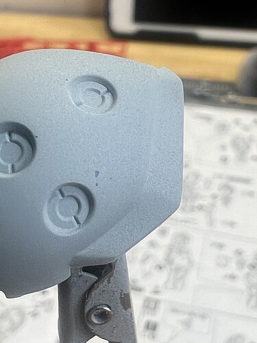

Cleaned off the previous paint job with purple power. Interestingly enough, that didn’t pull all of the paint off. So I washed the half painted parts with dawn just to get them flake free and then started to wipe with alcohol. Which DID take the rest of the Lacquer primer off. Weird, but again whatever.
Got them paint free washed them again with dawn. Dried them, wiped them down with alcohol again, just to be sure. I have oily hands no matter what. Used gloves.
Then primed them and immediately put them in my hotbox for 2 hours running and an overnight rest.
Then, cause why not, I tested with blue painters tape and BAM!!! GREAT RESULTS!!! Thank you again. You have saved my love of this hobby.
As you can see in the last image, I did get a small speck of pull off. But I consider this trivial as I will be sanding and priming again anyway.
Thinking of letting the pieces run longer than 2 hours as well. Just to see if that improves things.

That’s great, success ! Might have been dust specks under the little flecks that lifted off. Remember too, blue painters tape is a brutal test ! It’s just my standard in test shoots I perform.
