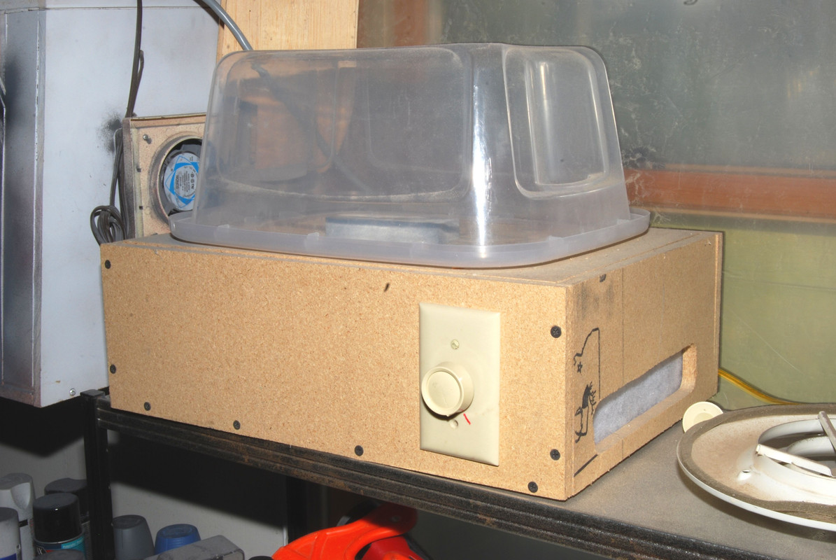

Be sure you get a dehydrator that has a temperature setting. I know people who did get a cheap control-less one and melted their models. I built a cheapy using a 60 watt incondescent bulb and a light dimmer, and have a spare thermometer in the box. I run it at about 110 F.

The dimmer to control the incandescant bulb is brilliant, I’d wondered how you controlled the temp, which you probably explained but I forgot.
Great to know the temp you use. 110 degrees, got it. [Y]
