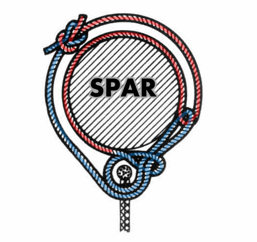

This image was edited from another image. Shows how to tie the roband.
roband
