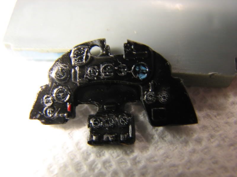

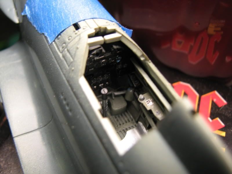

Here are some photo’s of my progress on the 21st Century kit. I have added scratch builts accessories for the cockpit as well as added some instrument dial decals to add to the IP.
