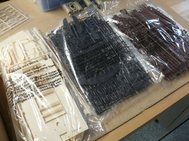

The kit came packaged much better than I remember back in the day… The parts all seem undamaged on initial inspection.
Some obvious flash and some parts that should be refashioned from Styrene, but still an impressive box of plastic. Certainly one of the best price/quantity ratios out there!

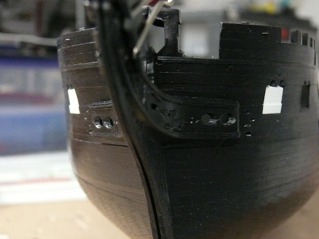

Might as well jump right in and start with the Bridle Ports:
I’ll put in a bit of backing behind the ports to give a surface for the styrene sheet that will fill the gap.
Next I’ll insert some sheet carefully shaped to fit the openings to eliminate the ports.
Then I need to lay on a very thin strip to continue the run of the upper wale line.
Later I’ll come back in with some filler and use a heavy grit (80) sandpaper to add some grain. I’ve experimented a bit with this and it seems to work reasonably well on my test pieces.

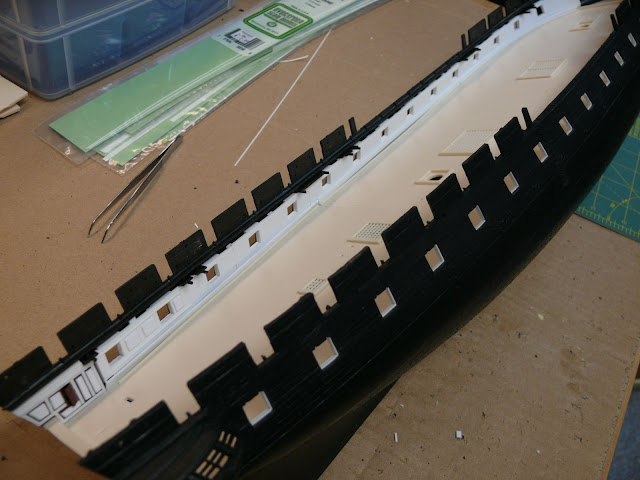

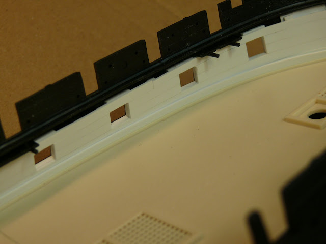

I’ve been building up the gun deck bulwarks:
Gun ports are lined with .080 x.156" Evergreen strip
Bulwarks are planked with .040 x .156" Evergreen strip

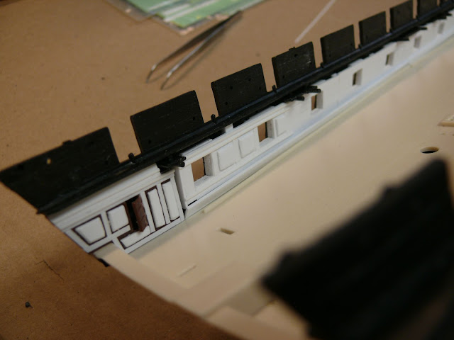

I’ve got the port side bulwarks mostly complete - I’ll add a ledge/shelf strip across the top and a few touch ups with a file are needed, but otherwise I’m pleased with the progress:
You’ll notice I’ve panelled the captain’s quarters up to the mizzen mast. I think that is more accurate than what the kit has laid out.
The candle in the background is not to set the mood… The dog managed to find a dead fish on the shoreline and reeked to high heaven… After a thorough bath in the garage washtub (the DOG - not me!), I needed to light the scented candle (orange flavored, I think) to overlay on the stench before proceeding to my project.
Not particularly glamorous, but it will seem satisfying when all is completed.

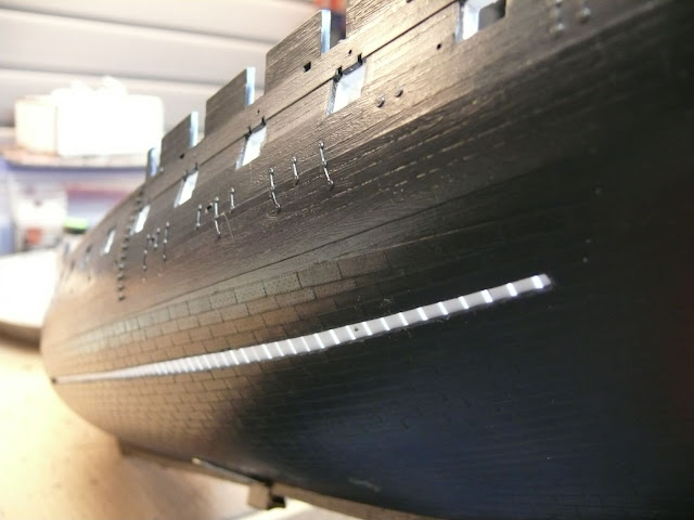

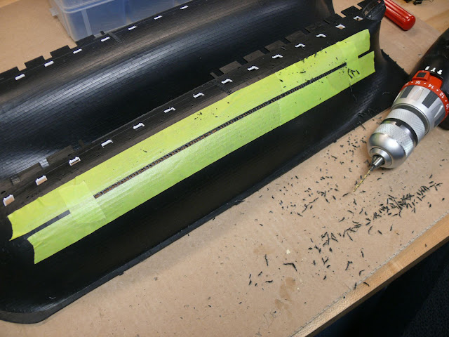

Continuing along the theme of Old Ironsides
As usual, I’ve gone crazy with the hobby knife and peeled back a bit of the lower hull - this time to reveal the stout framing of an American Heavy Frigate.
Karl Heinz Marquardt presents a “classic” frame layout in his AOTS book - double frames between the gun ports with single frames spaced apart in between. Commander Tyrone Martin states in his writings that Joshua Humphries specified closely spaced frames - about two inches separation. This historic photo from her 1875 refit would seem to agree. We see the frames exposed after the outer planking has been stripped away:
It is surmised that Constitution did, in fact, have the diagonal riders fitted originally and they were removed in an earlier restoration. Her waist was also filled in and her spar deck bulwarks built up during an earlier refit which was supposed to stiffen her and introduce longitudinal strength - a thought shared by Lt. John Lord when he supervised the 1927- 1934 refit.
In reality, all this did was introduce about 16 tons of unneeded stress on her keel (all of which was removed in her very recent refit).
I’ve gone ahead and used the 1875 photo as guidance and spaced my frames accordingly:
Russ over at MSW confirms that the 1875 photo should be accurate. Research confirms that the keel on Old Ironsides is original as well as most of the futtocks and flooring. This would dictate the spacing of the frames for the life of the ship - even if the contours of the upper framing changed over the years.
The placement of my gash is not arbitrary - it is actually symbolic. Captain Dacres testified in his court martial after the battle that “on the larboard side of the Guerrière there were about thirty shot which had taken effect about five sheets of copper down…” This was most likely the result of Constitution’s initial broadside which Captain Hull had held back until his ship was directly alongside his opponent at half-pistol shot range. The blast fairly rocked Guerriere and sent “washtubs” of blood pouring down her hatches according to an eyewitness. The damage below the waterline ultimately sealed her fate. The prize crew couldn’t stem the flow and Hull ordered her blown up the next morning.
My representation here should give folks an idea of just how much damage the Guerriere absorbed from the outset of the fight.
