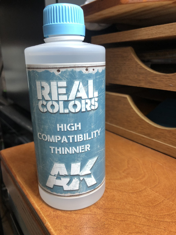

I like AK Real Color High Compatibility thinner…it doesn’t have a strong oder. I usually thin 3-4:1 thinner to AK Real Color paints. If you like to “roll your own” colors, Tamiya is a great choice in paints as well.
