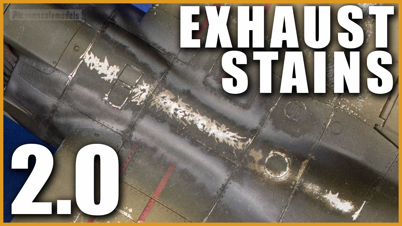

Thanks, I still haven’t tried anything yet cause life is in the way. Anyone know of a video out there for using pastels for exhaust on a dark aircraft?
Didn’t watch it all the way through, but grabbed this pic from it.

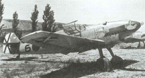

I found these taken during or just after the Spanish civil war. Gives a bit of an idea about the exhaust stains on early Me109s.

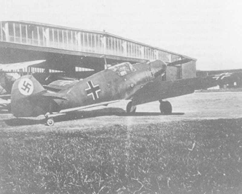

This one looks to be similar in colour to yours.
Big thing to bear in mind is that the planes were probably not as busy operationally at this time, so less wear and tear, more maintenance equals overall cleaner plane (usually).

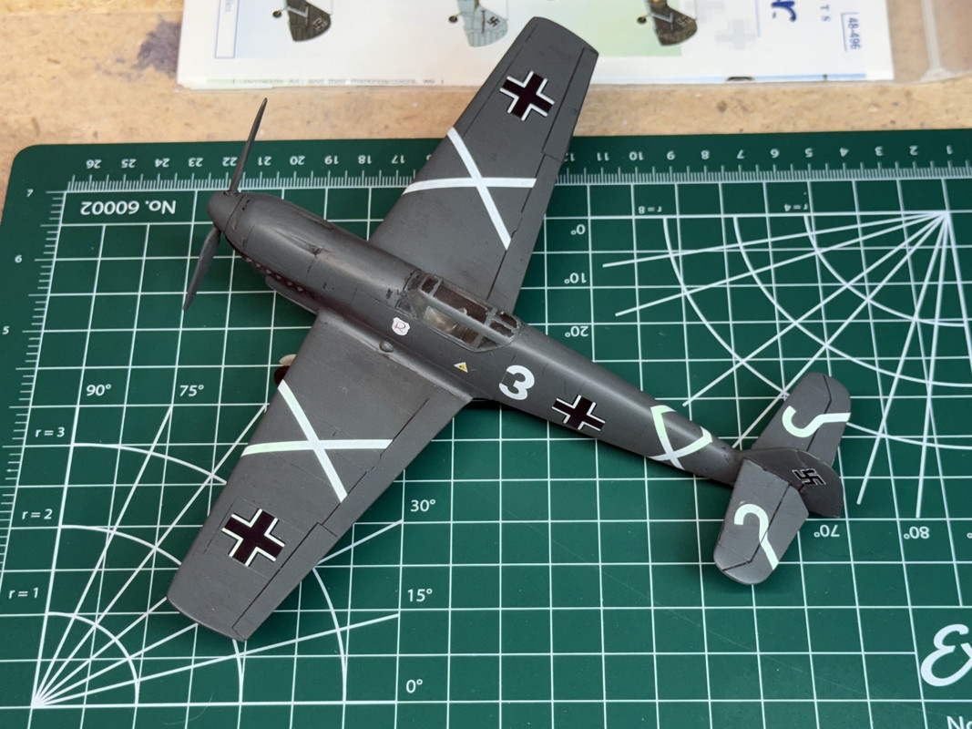

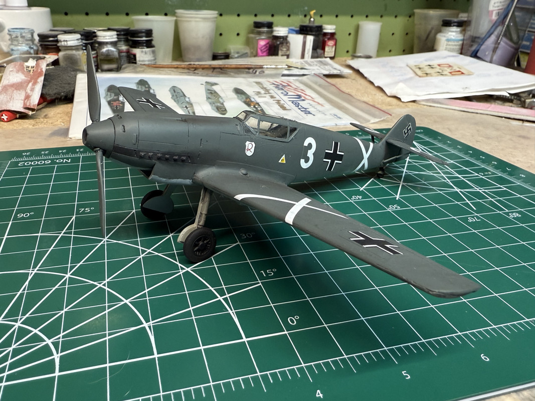

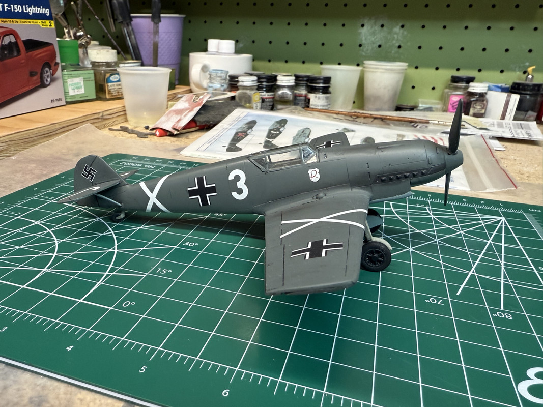

I went subtle.
Nothing at all wrong with that. Looks good.
self-high-five-high-five1
The subtle works very well with the overall cleanliness of the rest of the aircraft. If you had a heavier weathering finish the exhaust would naturally also be more intense.
Subtle is usually good,you can always increase gradually if your not satisfied.
Those exhaust stains look great, @68GT. I think you took the right approach.
And that early 109 is really sharp overall. Condor colors, yeah?
My next early 109 is going to be Condor for sure.
@68GT Love it! Subtle is generally the best answer to questions about weathering.
