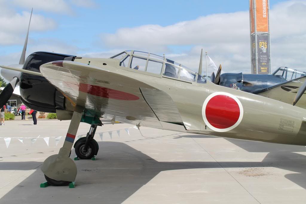

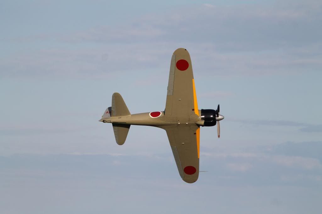

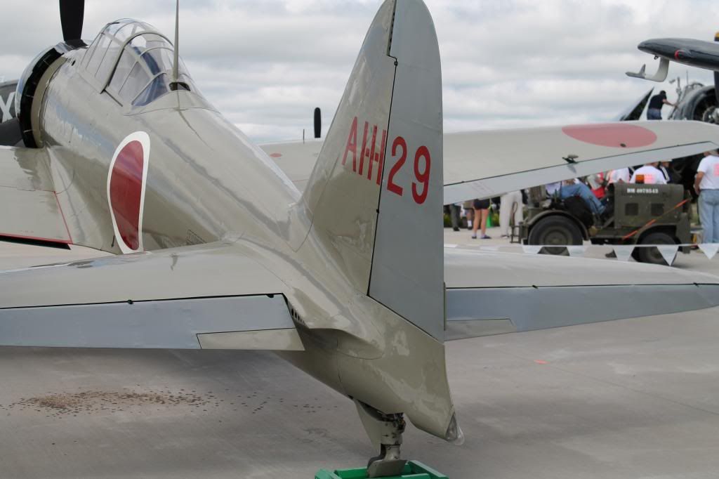

I’ve done a lot of looking around. I see a lot of white aircraft, then a few with the brownish color that a lot of people think is right but cant figure out the exact shade. I’m doing a Val for the Pearl Harbor GB, Which color and I better off going with for the fuselage?
This Zero was at EAA this year and has the brownish color I’m talking about.

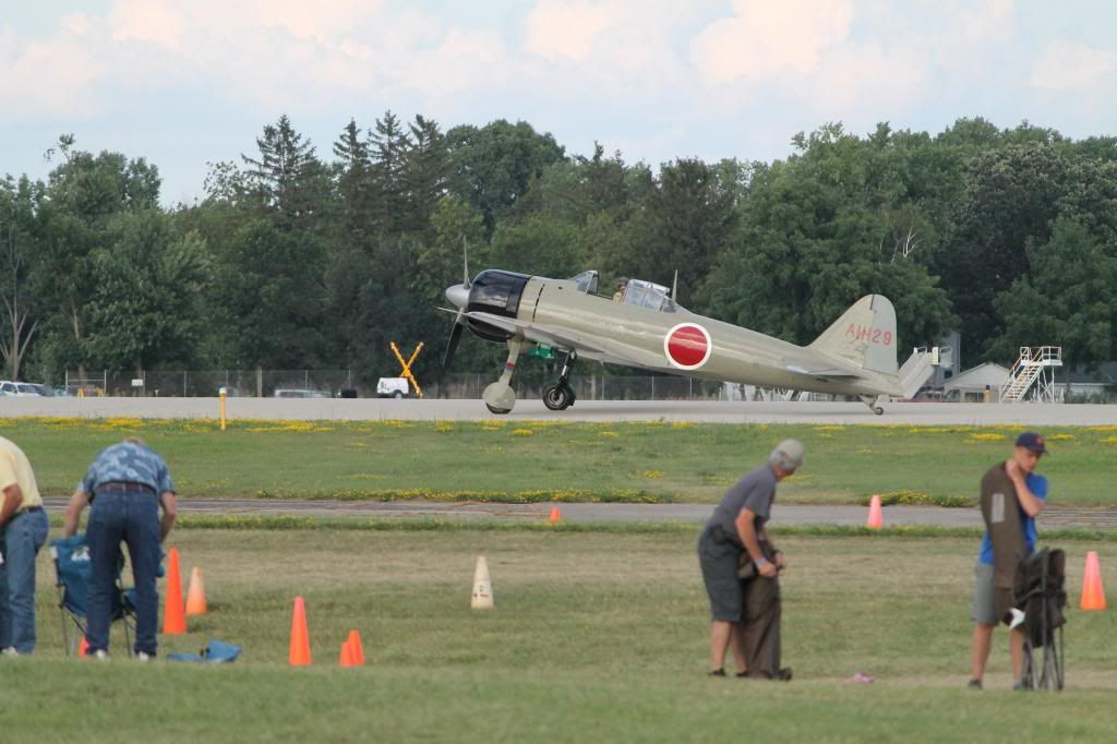

The last picture was taken during the evening which is why it looks a bit darker.
I’m doing a 1/48 scale one of the same time period, and I’ve come across about 3 different colors, tamiya XF-14, XF-76 and I think it is Tamiya INJ gray or something like that. I’m going to use the XF-14 I believe that is the closest to the Pearl Harbor Zero color.

Pearl Harbor Zeros were a grey/green. Tamiya’s XF-76 is pretty close. Gunze also makes this color in the Mr. Color lacquer line. I also have a mix using MM enamels if you’re interested. I believe this brown color idea came from people hypothesizing that this grey/green was overcoated with a clear lacquer, which over time started to fade into a brown/caramel color. How they came up with this idea idk? Probably by looking at color photos of wrecked relics, which show a6m2s and 3s heavily weathered with paint missing/fading, and by confusing the color of oxidized aluminum skin with this brown color.

The color you are refering to on early Japanese subjects is called “Ame-Hiro”. From what I understand, its was so named because it resembled a candy that was popular in Japan at the time, a brownish carmel like color. As Nathan said, Tamiya XF-76 is perfect for this color and its what I use to simulate Ame-Hiro. To my eye, the color on that restored zero seems a bit too brown but who really knows for sure anyways. Good luck…

This doesn’t look very much like “Ame-Hiro”
www.tamiyausa.com/…/acrylic-mini-xf-76-gray-green-81776
Maybe it looks different in person?
Yes, looks different in person. This color was grey/green. I have that pic of a sheetmetal skin in Osprey’s book modeling the Zero, where Brian Crinner matches model master colors to the pic. I can scan and upload it tomorrow.
