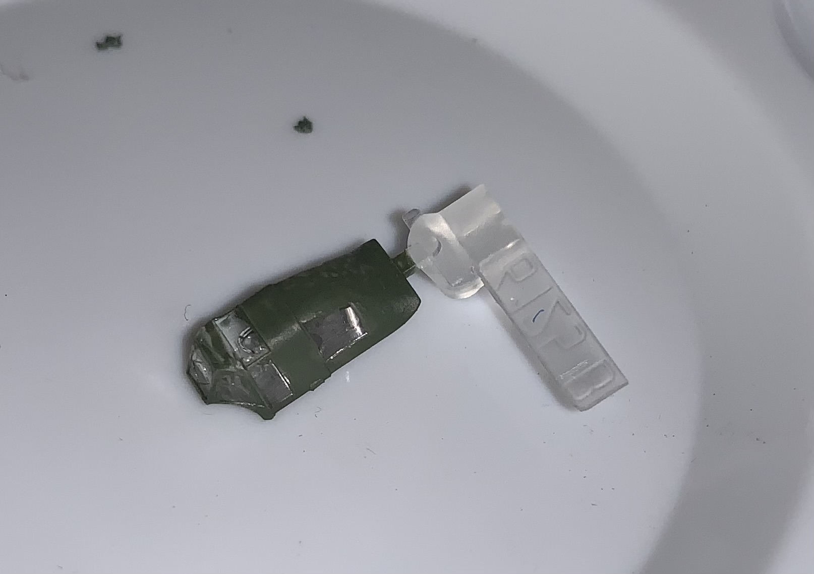

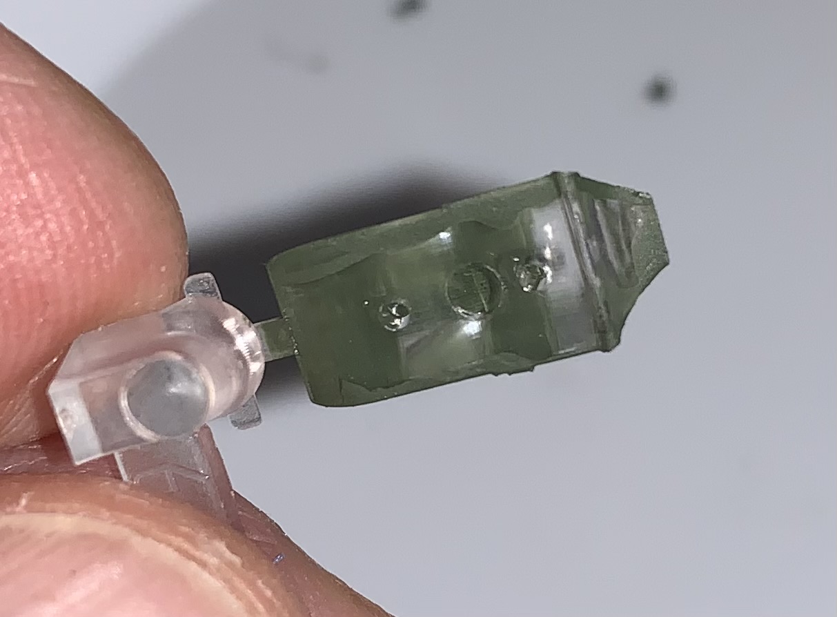

How to paint window or canopy frames on clear plastic moldings?
Working on a few 1/144 aircraft with canopies. Using Vallejo acrylics
Painting the frames would be hard enough as is, but what paint to use?
Ideally they should be primed for good adhesion of the paint. So mask and prime, and then topcoating?
Or maybe go to an enamel, which might have superior adhesion to unprimed plastic?

Okay. I’m going to strip the acrylic paint off with IPA, and spray the canopy with Tamiya clear gloss coat. Then brush either enamel or acrylic frame details. I am assuming that the coat will act as a base for the paint to adhere to. We’ll see. :thinking:
If you plan carefully so as not to place the tape over already-done parts, you could use Dymo tape or scribing tape and a Fineliner pen. At that scale, I bet black would probably be indistinguishable from dark green. The durability wouldn’t be very good, but then, how much handling will these get?
Very little handling. Black or green, no significant difference.
