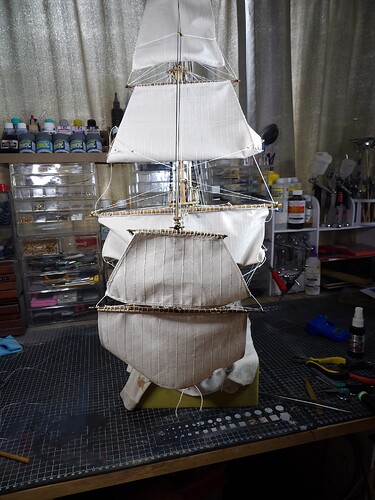

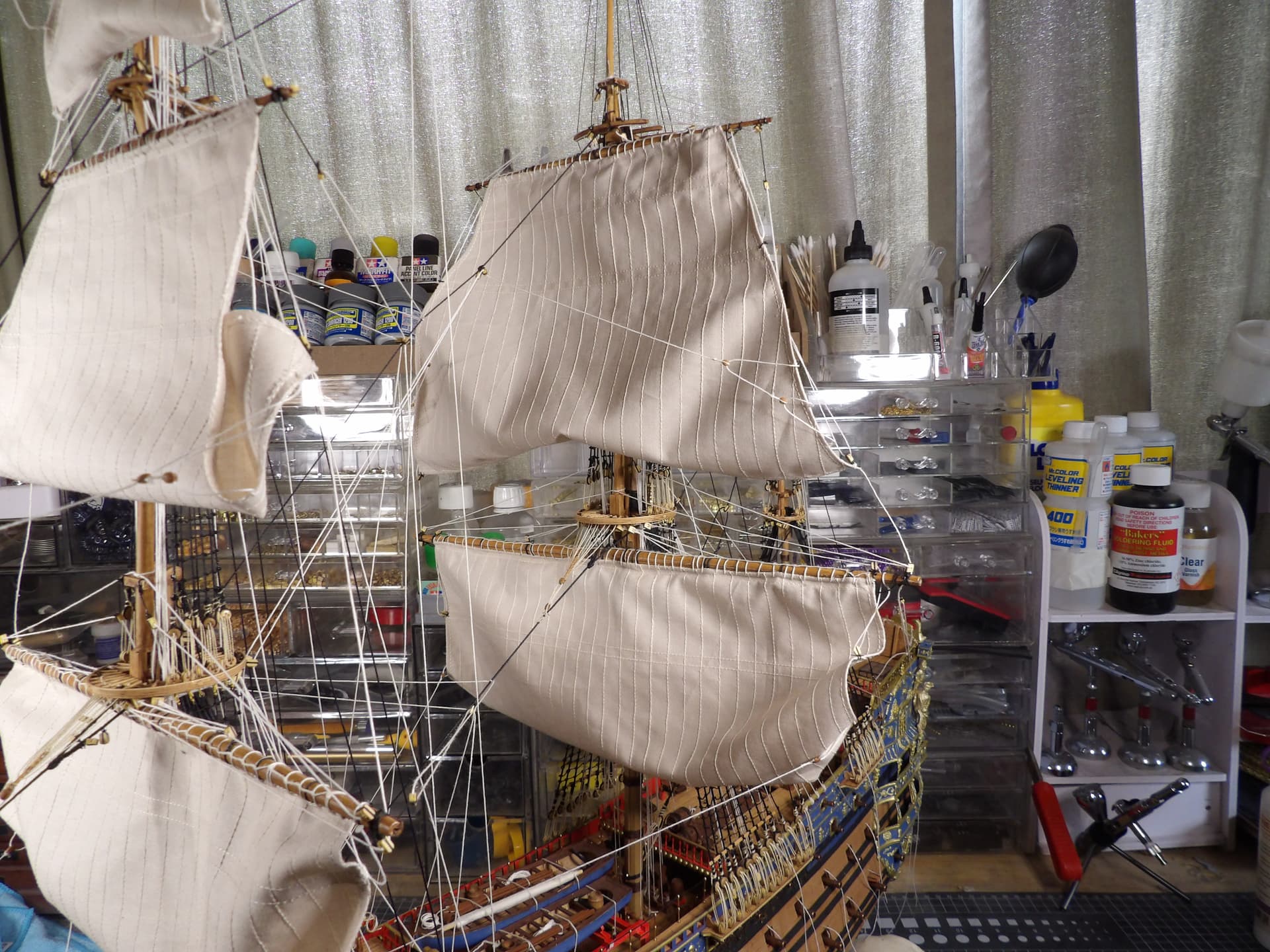

the topgallant yard and sail are on . but not before i broke the bowsprit mast , this plastic is so brittle .but some 1mm brass rod drilled into it , seems to be holding .
Bowsprits are the bane of every ship modeler. As is old, brittle plastic.
Looking great.
Bob
cheers bob .

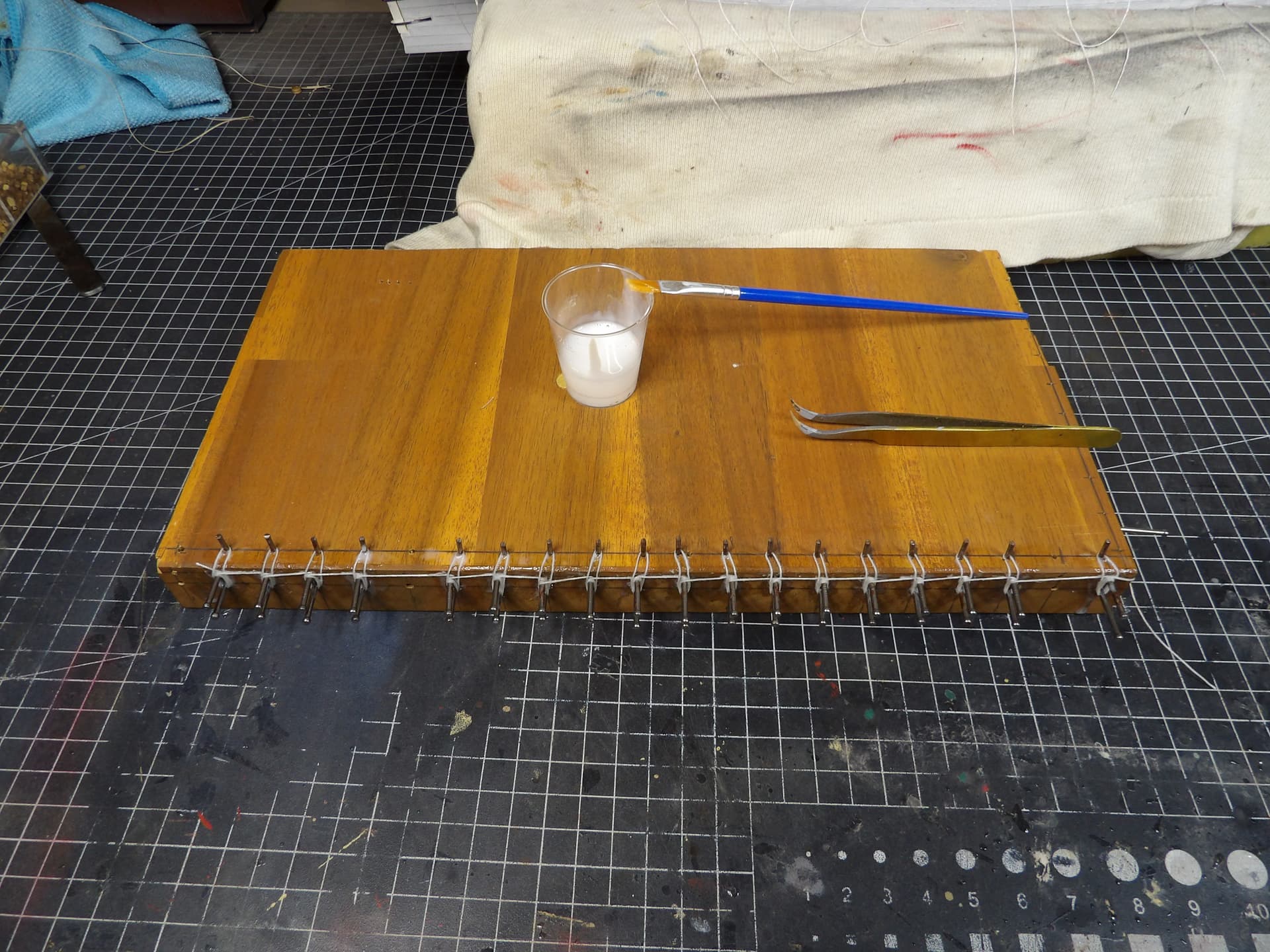

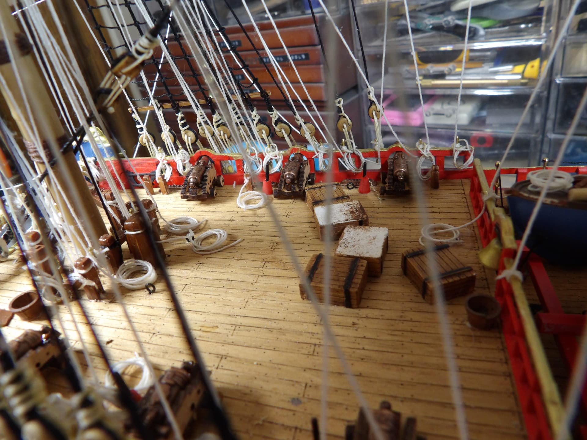

now for the hanks , I’m using a technique I got from this guy on u-tube .
https://i.postimg.cc/L8vW90vv/100-0881.jpg

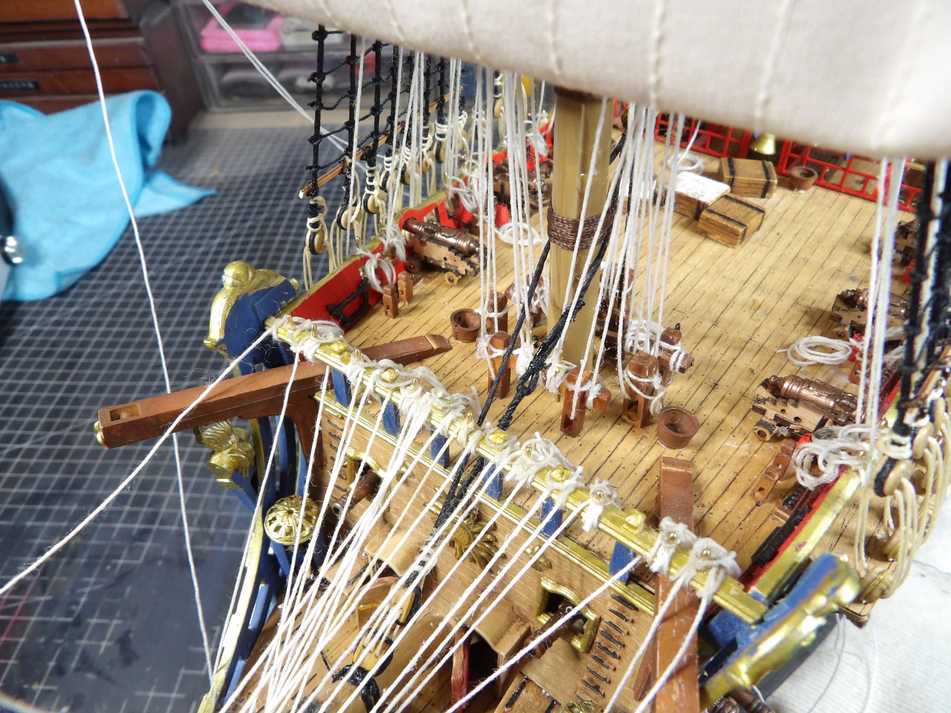

got some hanks on , still heaps to do .

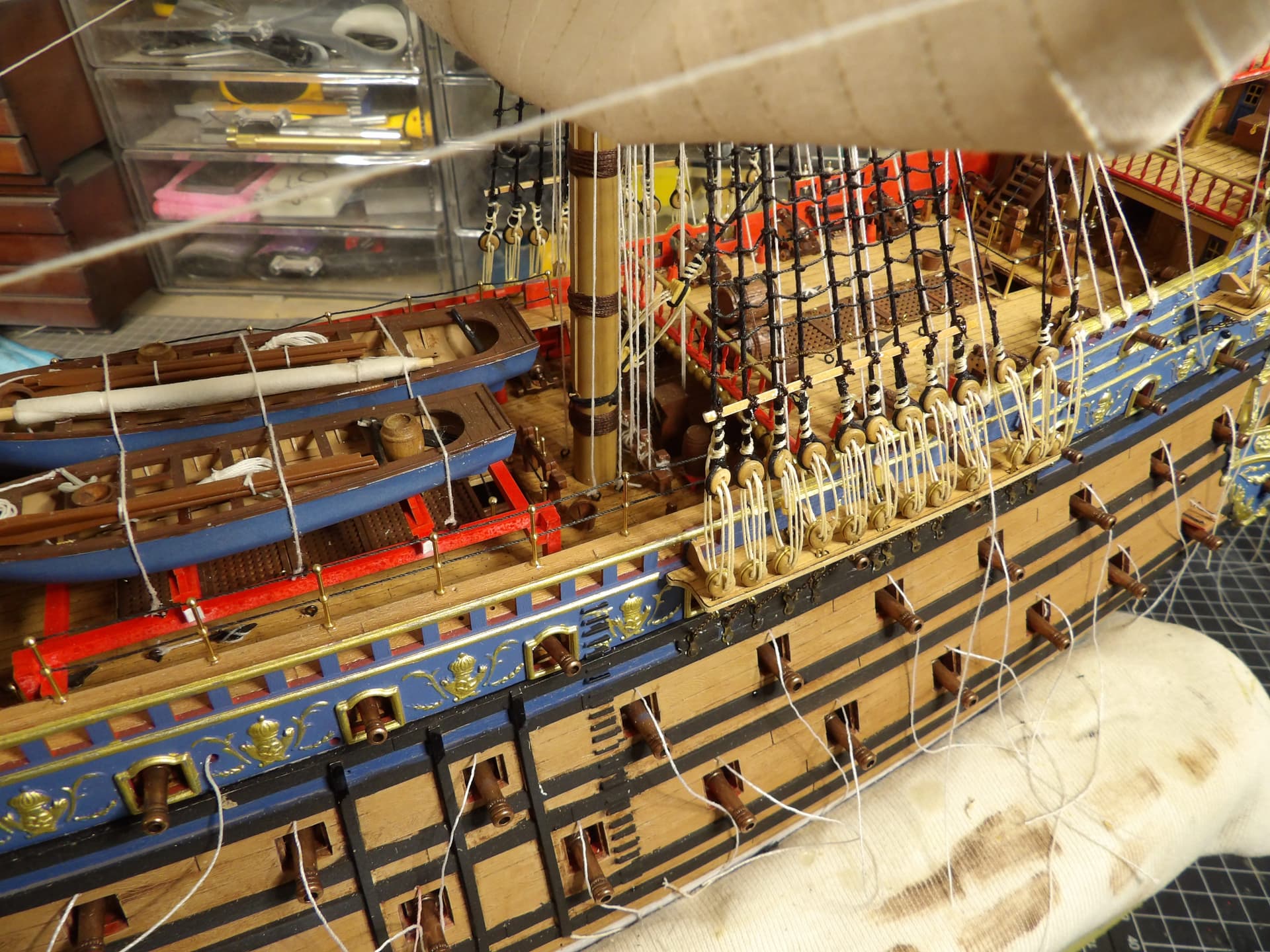

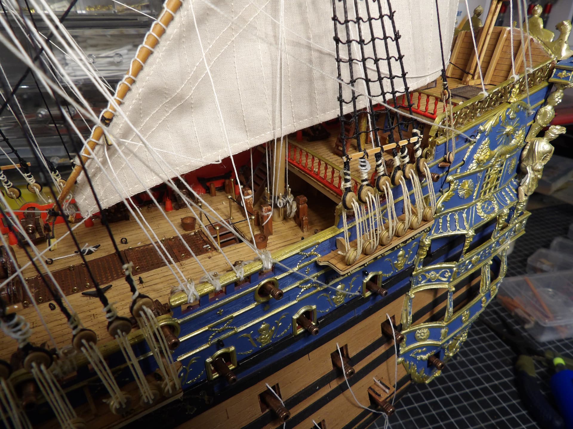

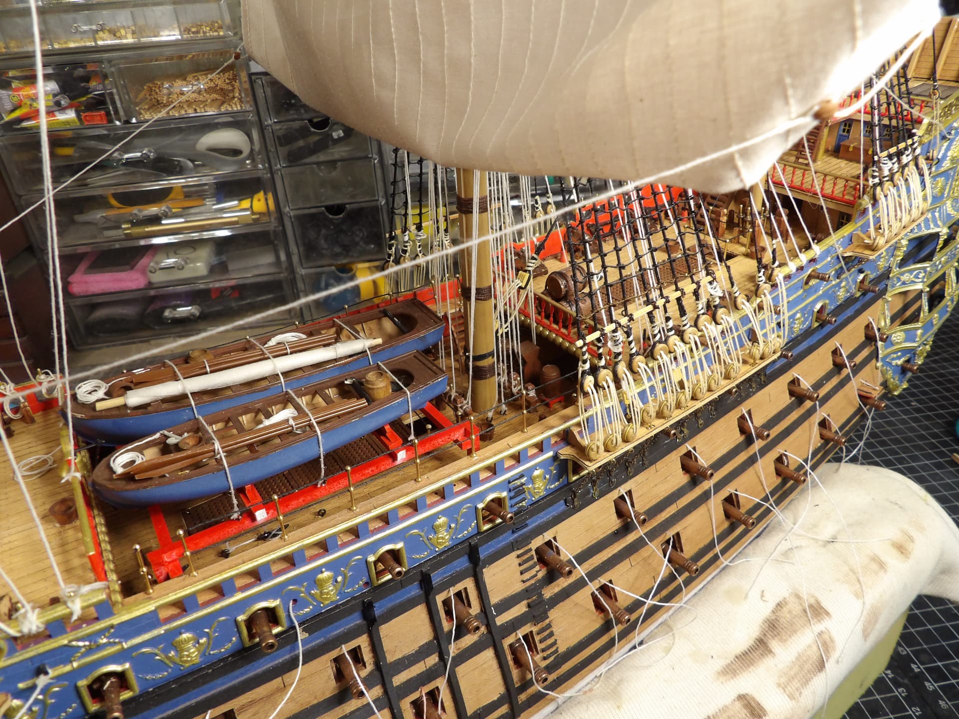

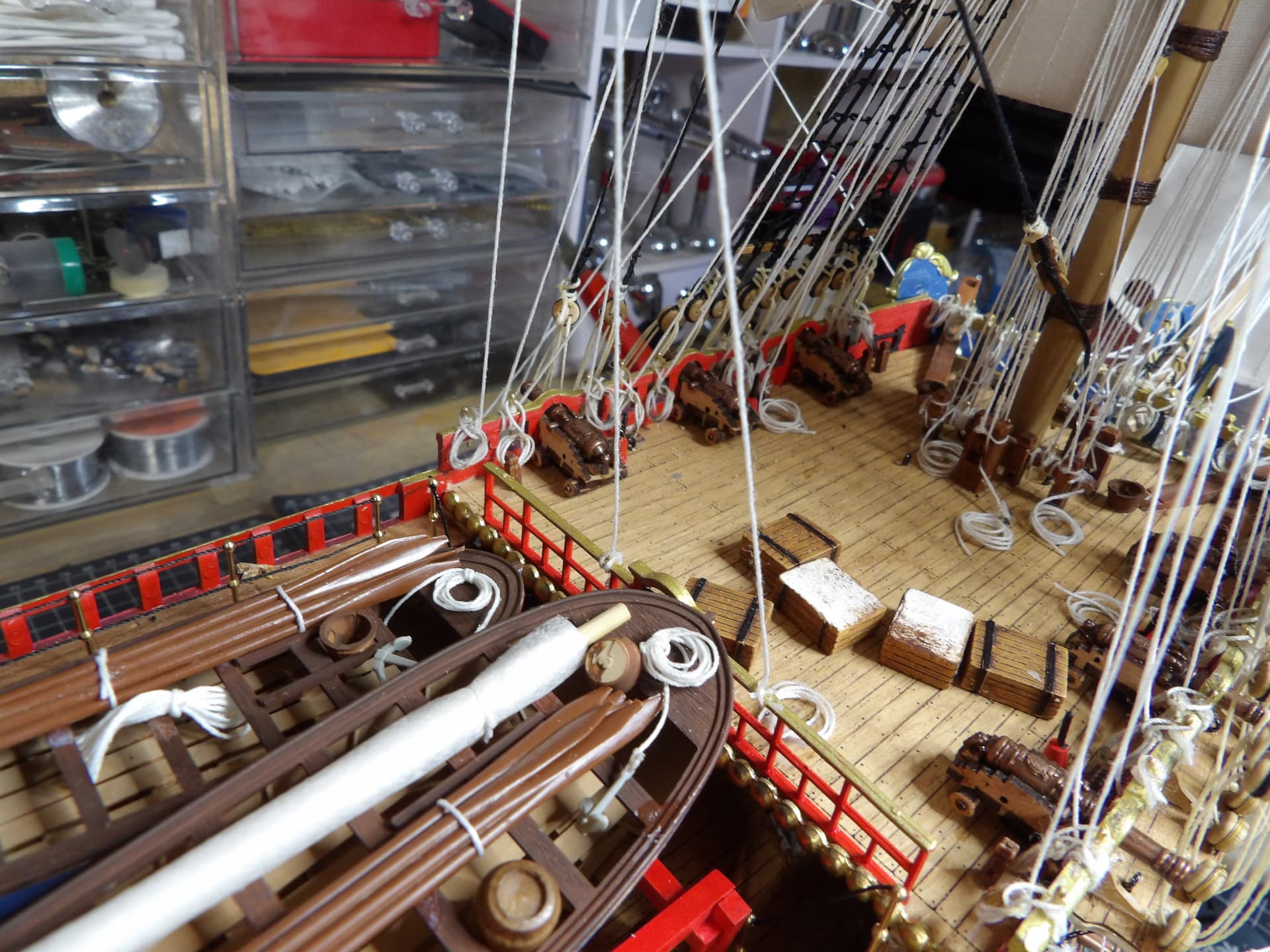

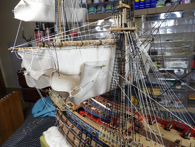

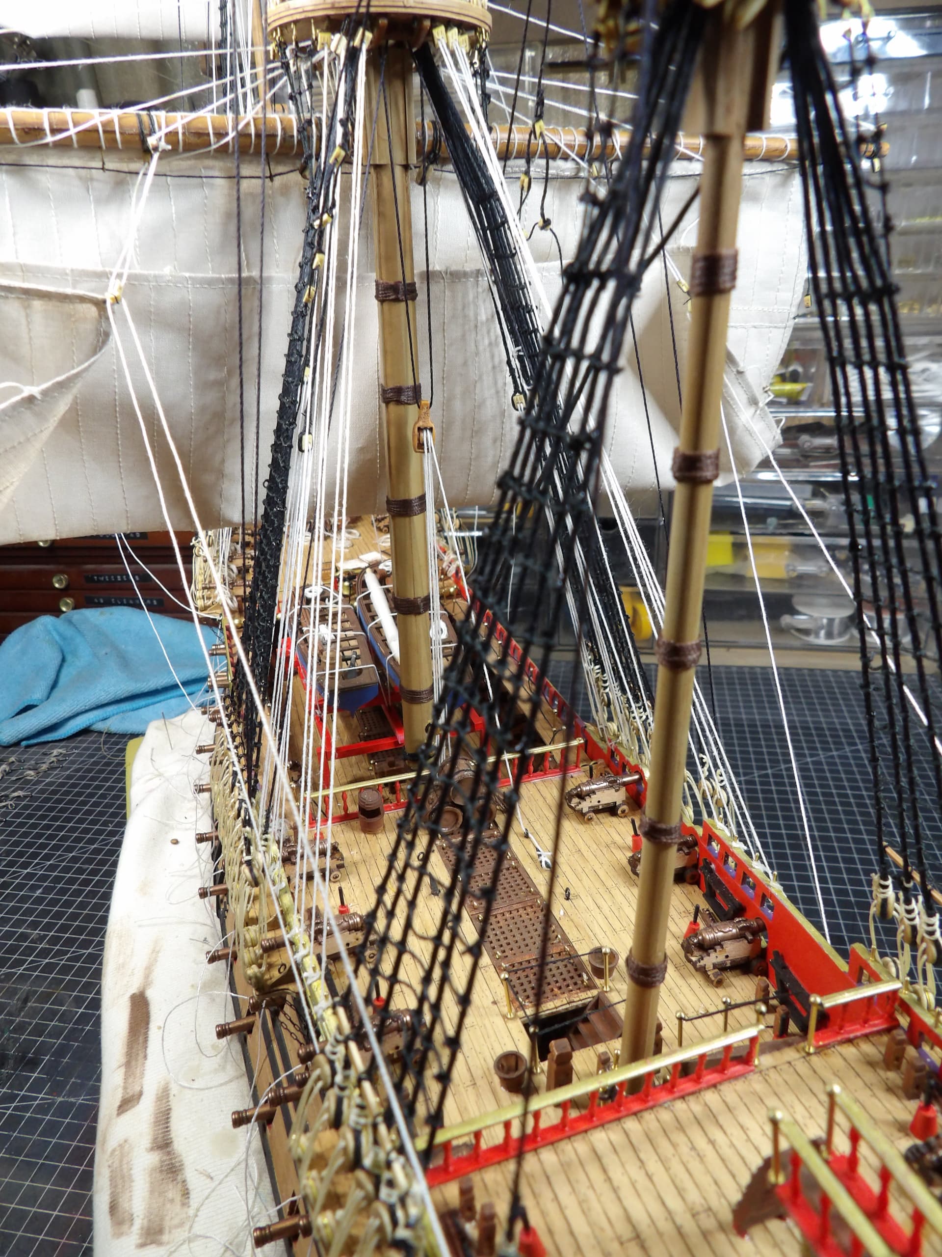

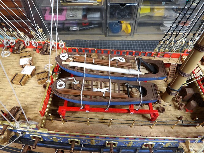

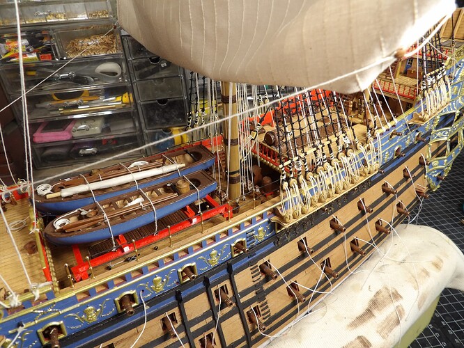

the ships boats are tied in .

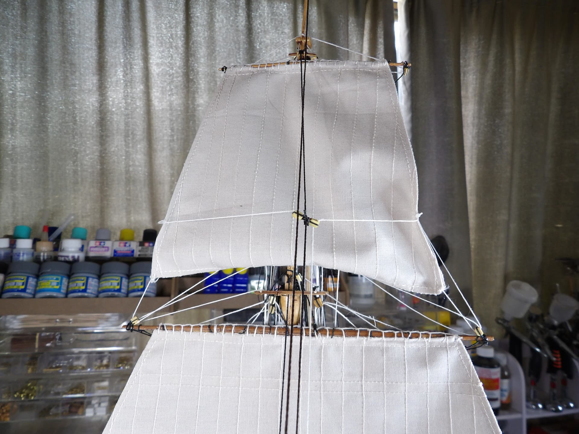

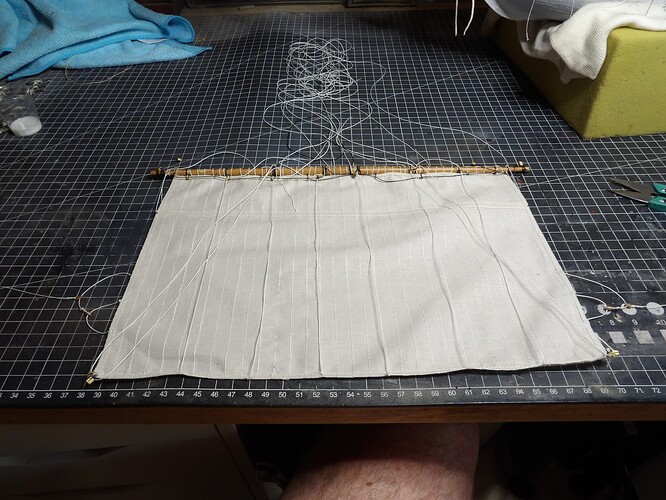

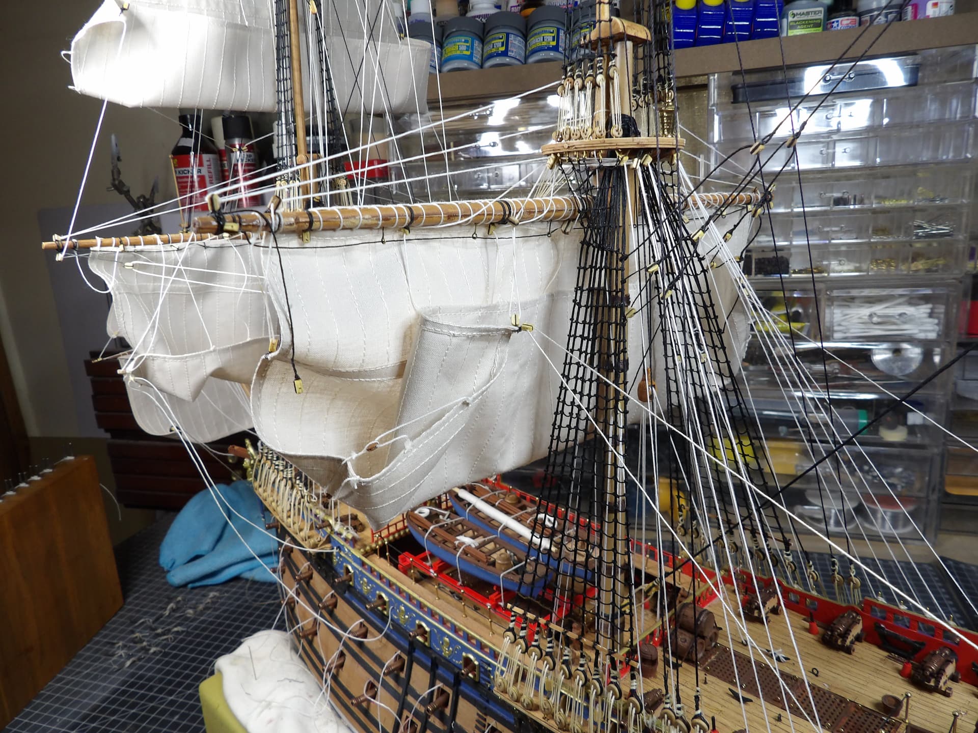

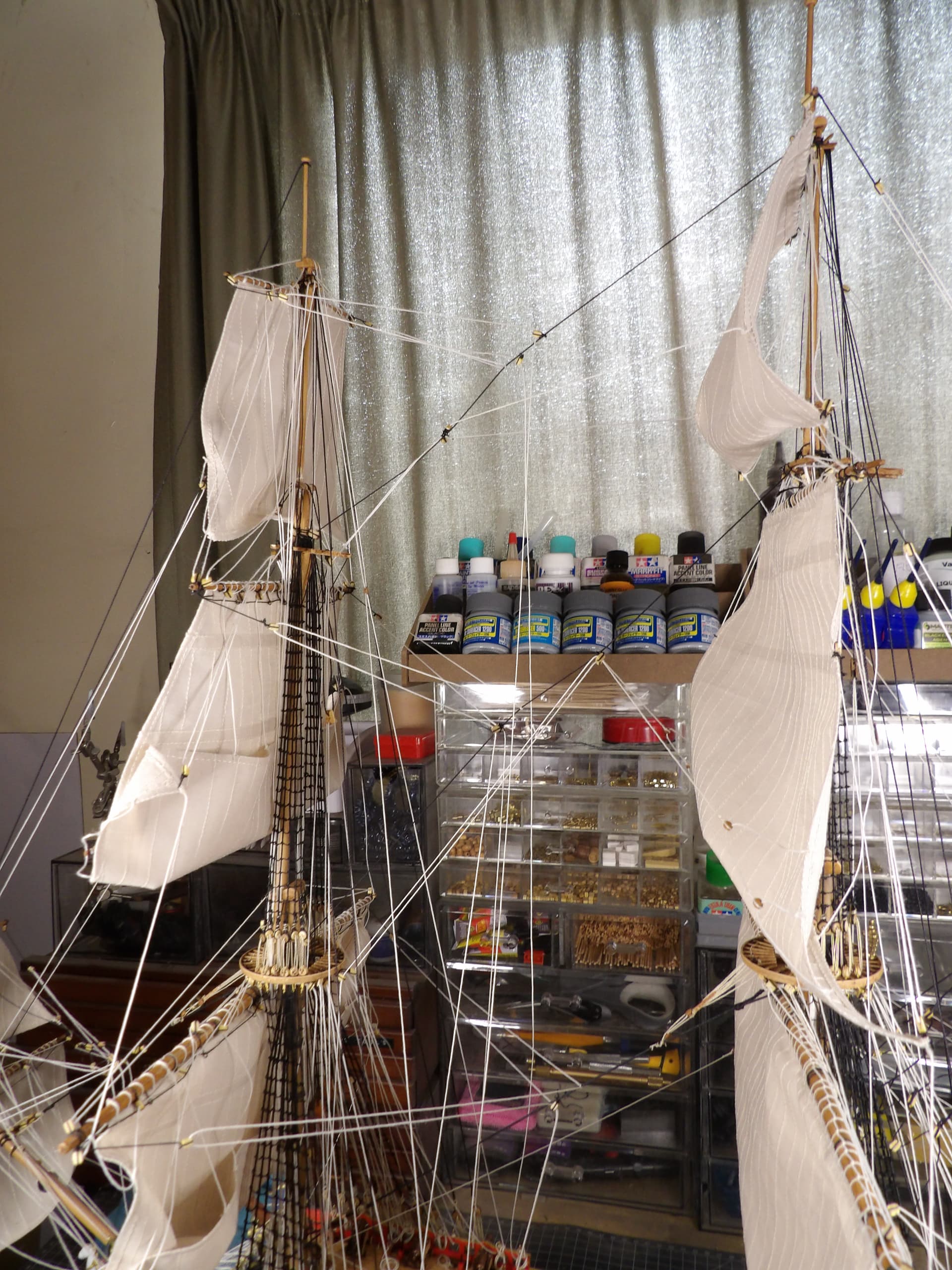

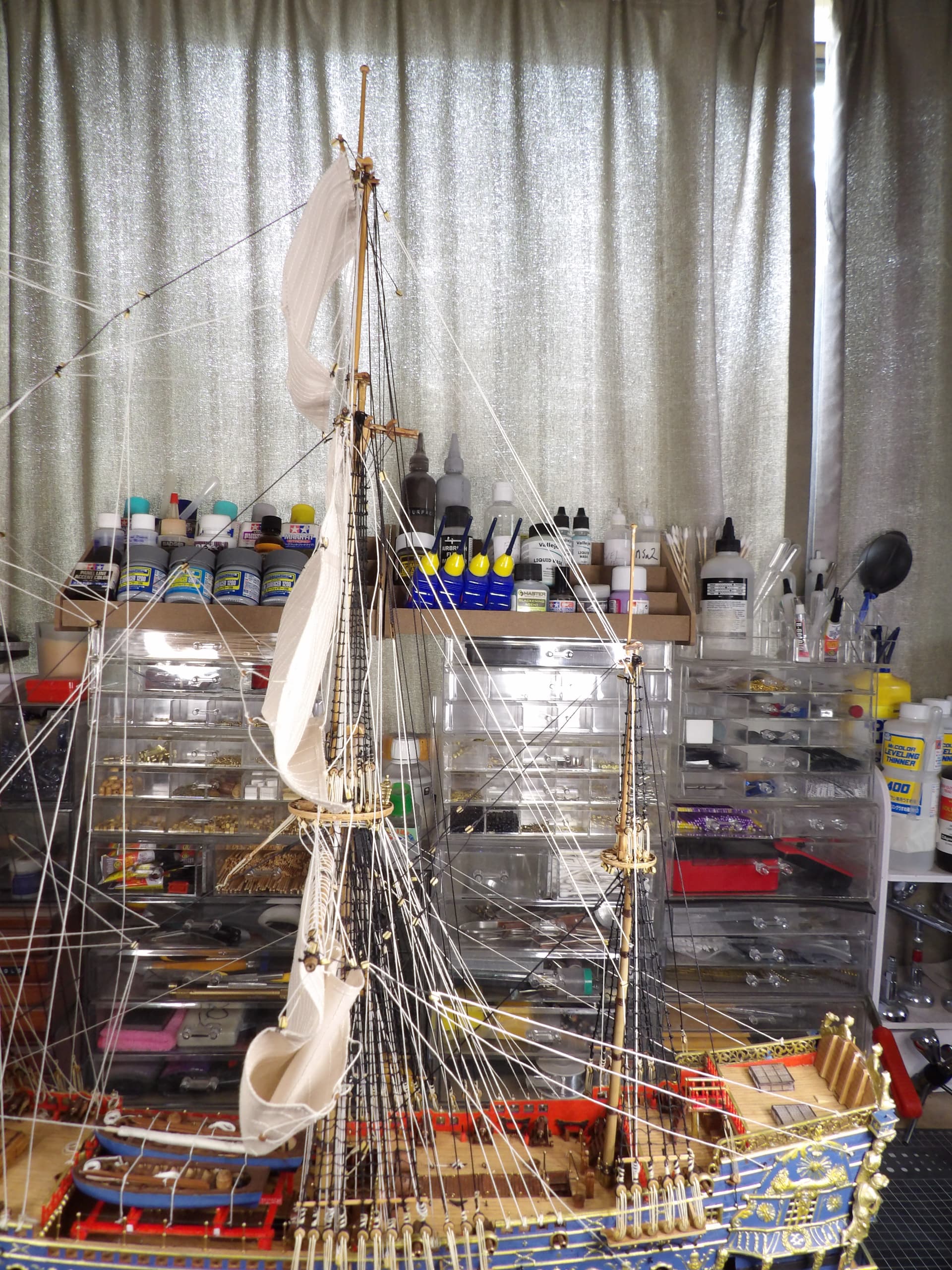

the main mast yard and sail are ready to go on
the main mast yard and sail are on .

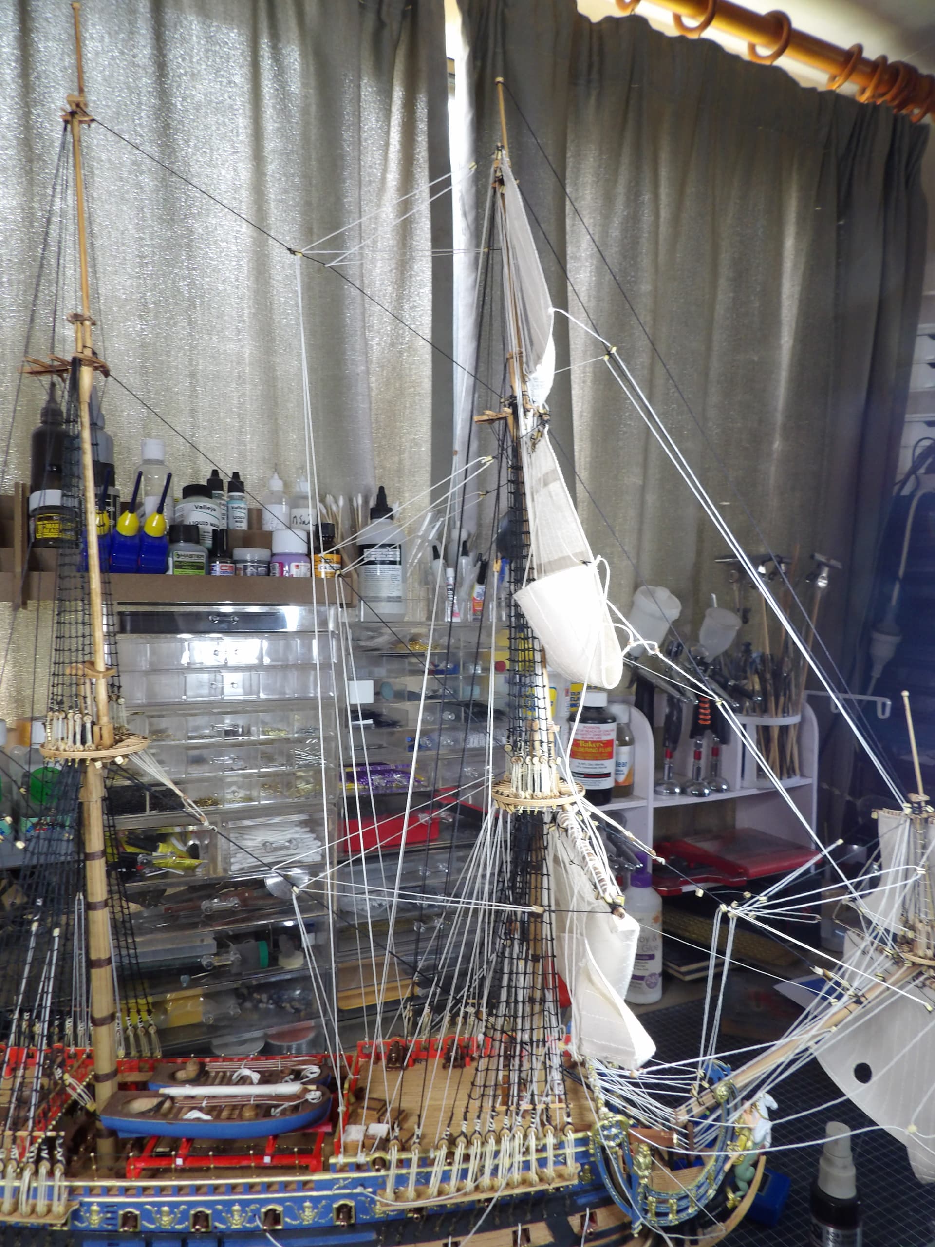

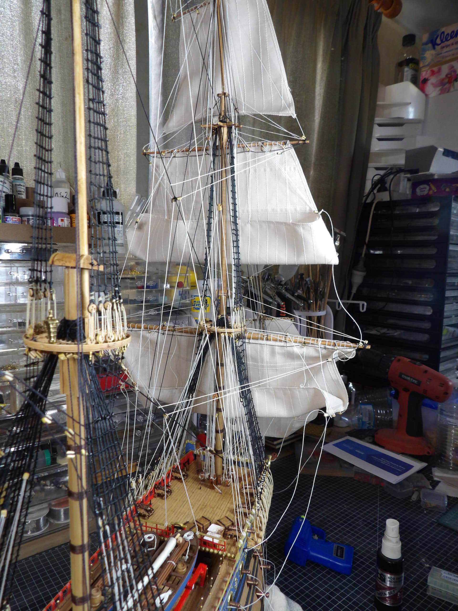

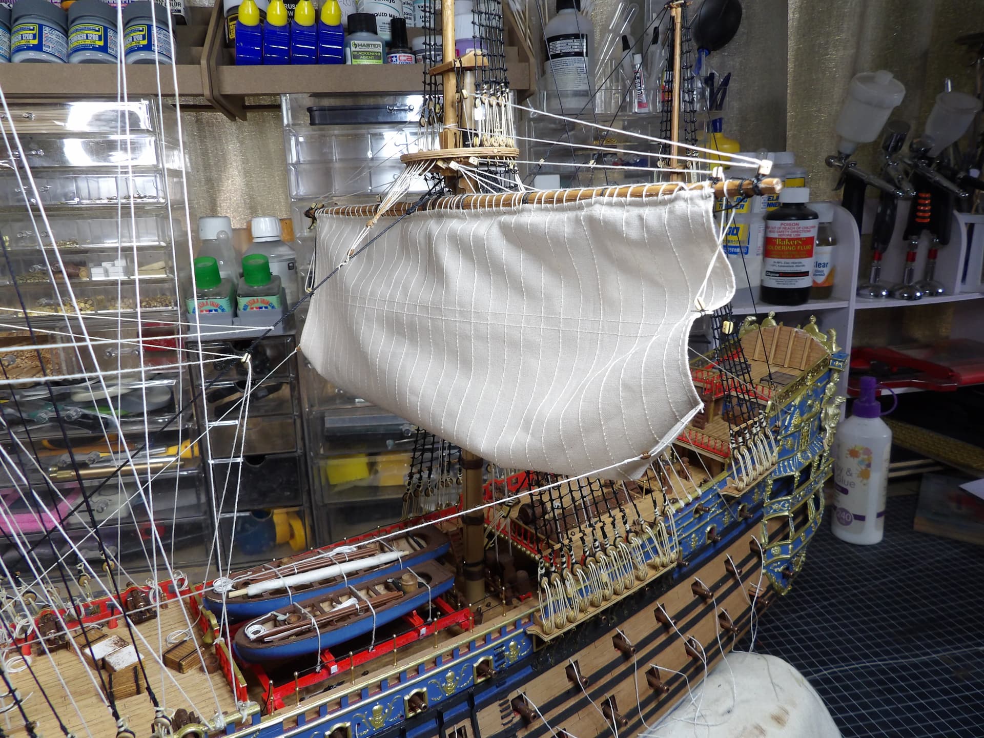

the main mast top sail and yard are ready to go on .

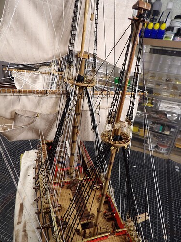

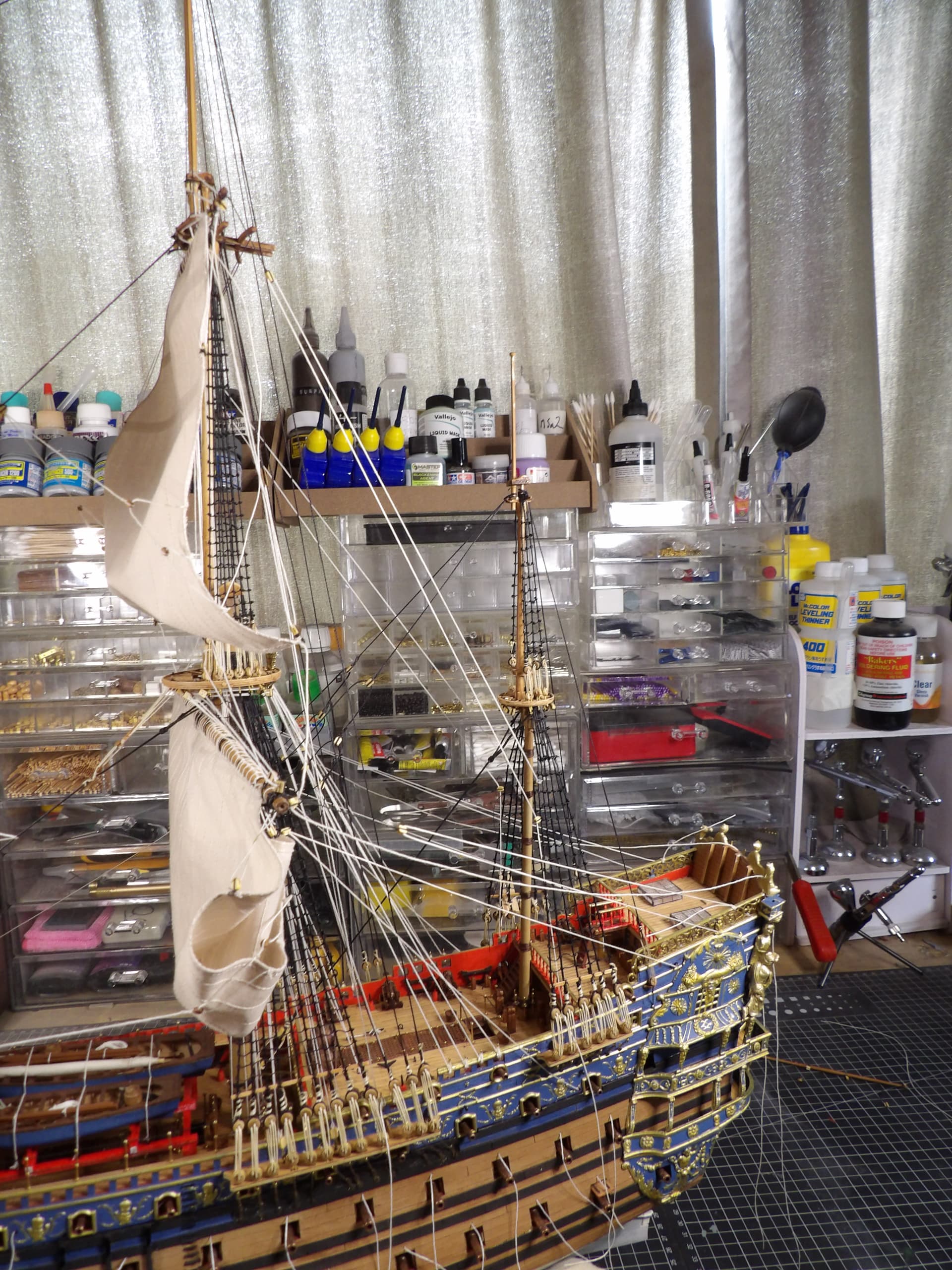

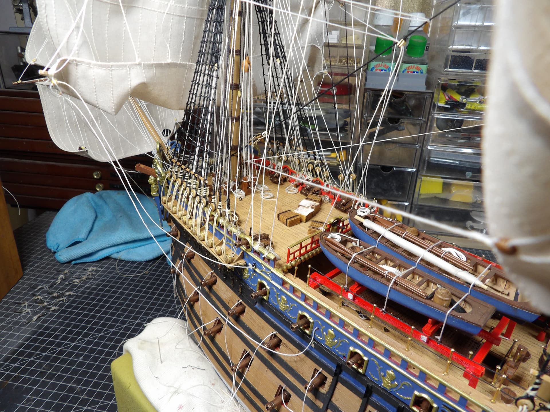

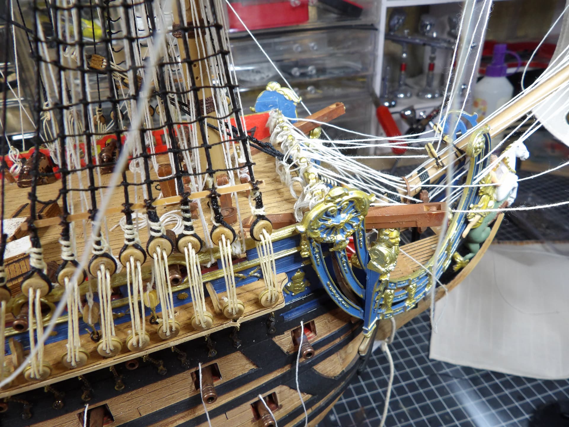

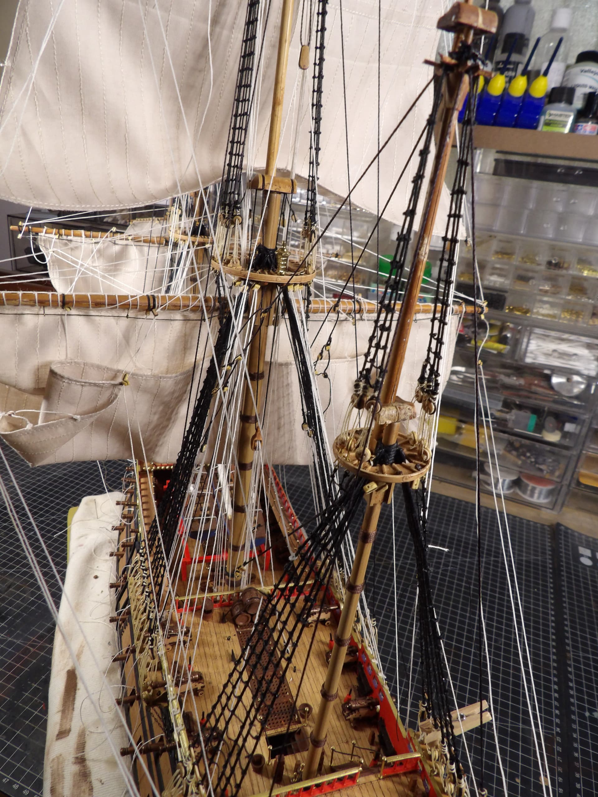

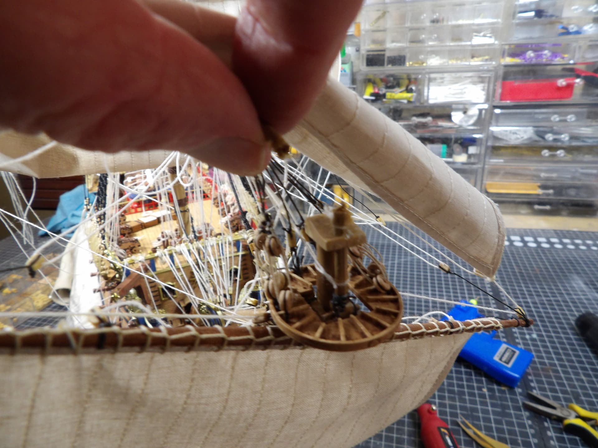

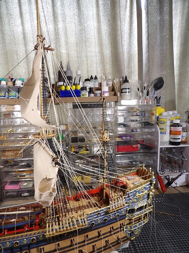

nearly lost it , broke the %^$% bowsprit mast again , talk about brittle , had to walk away , some very deep breathing , a lot of swearing later , managed to get a piece of .8mm brass rod in it .
you can see the break in this photo
anyway got the main mast top sail and yard on .
Tie a bright red ribbon or piece of yarn around the bowsprit mast. I have done this in the past and haven’t broken a bowsprit yet (knock on wood!). I also do it during transport for the same reason.
Hope that helps.
Bob

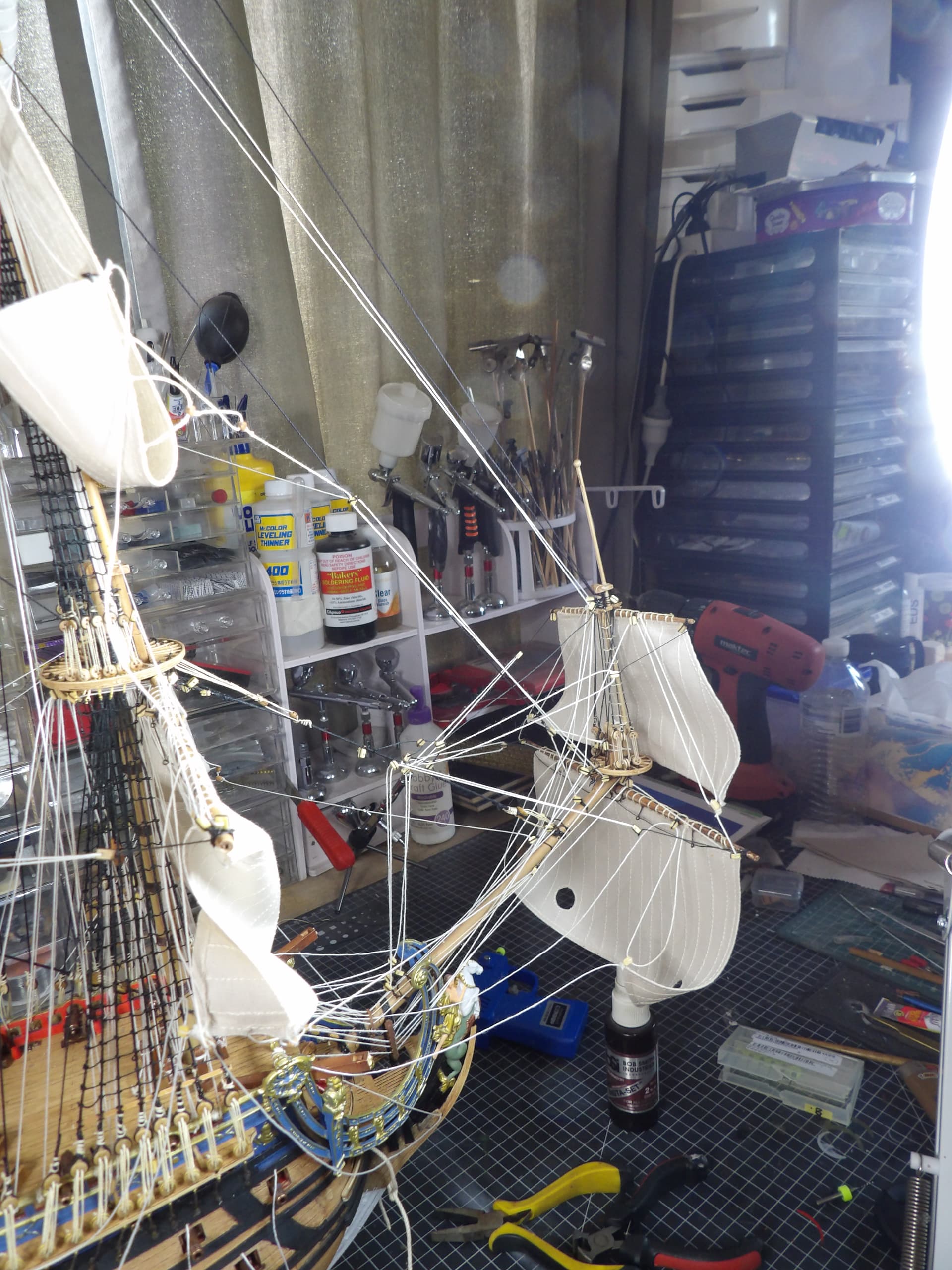

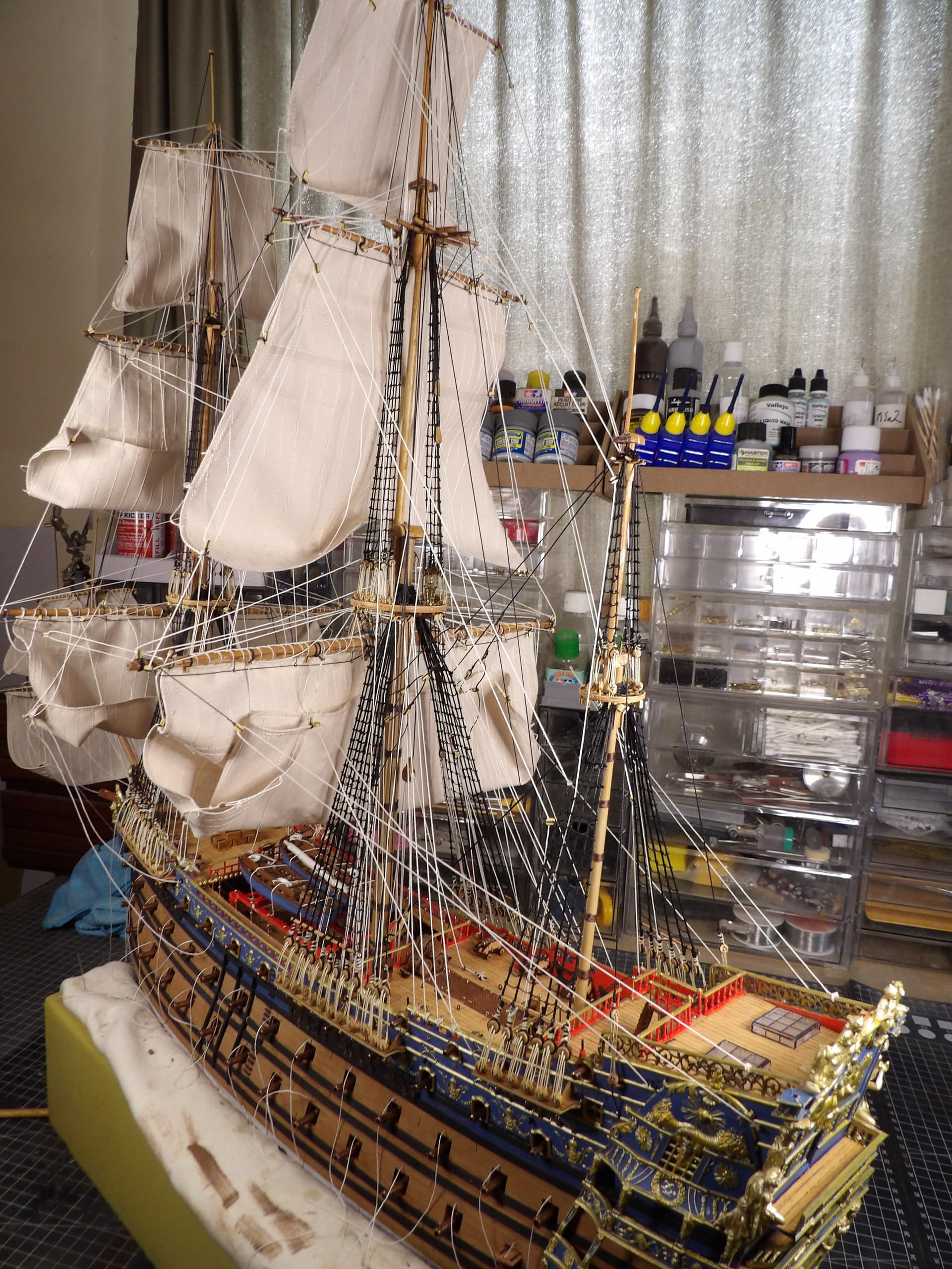

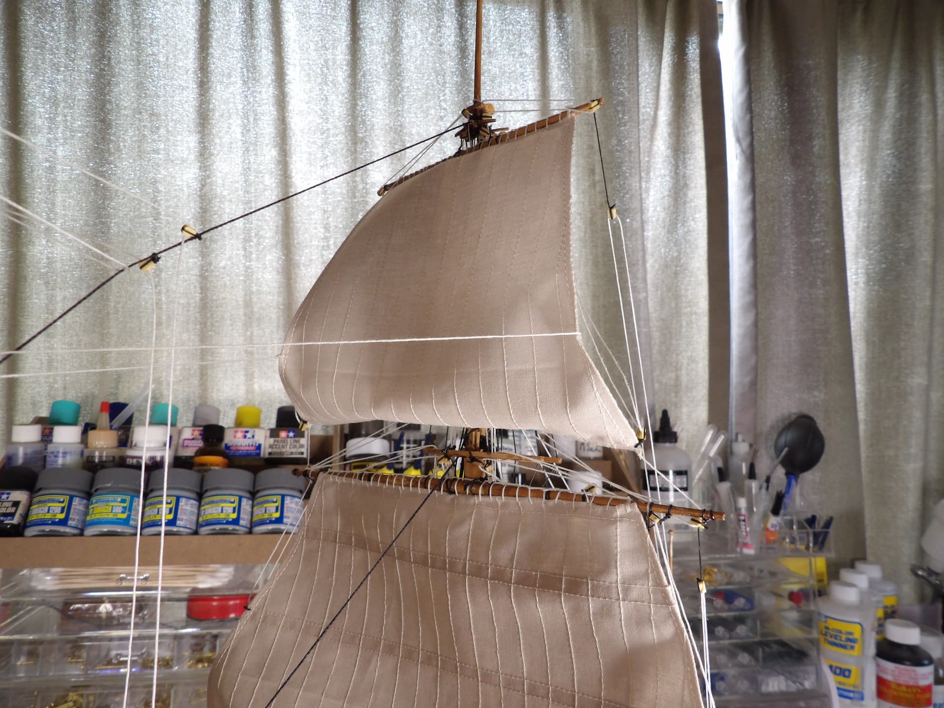

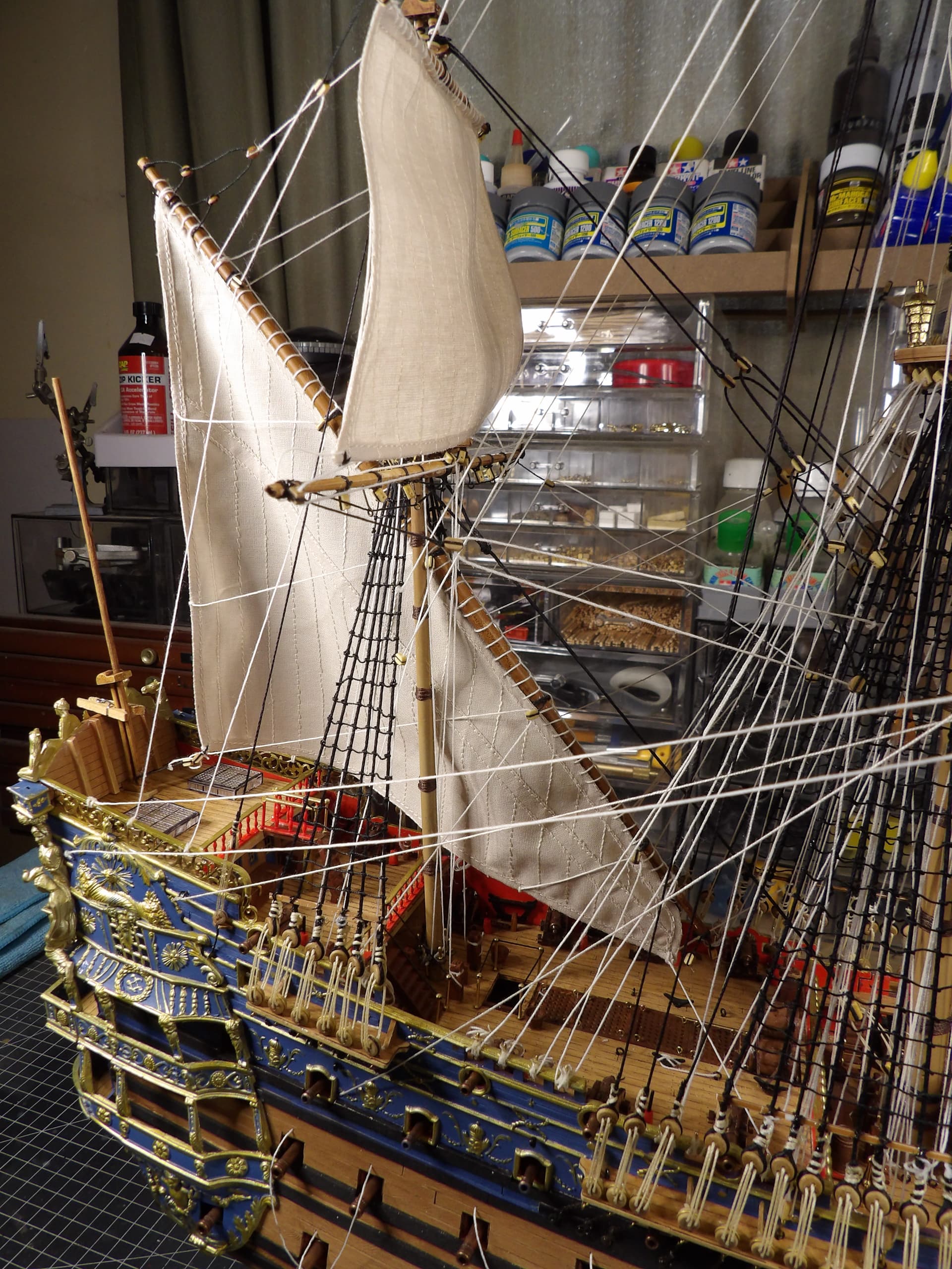

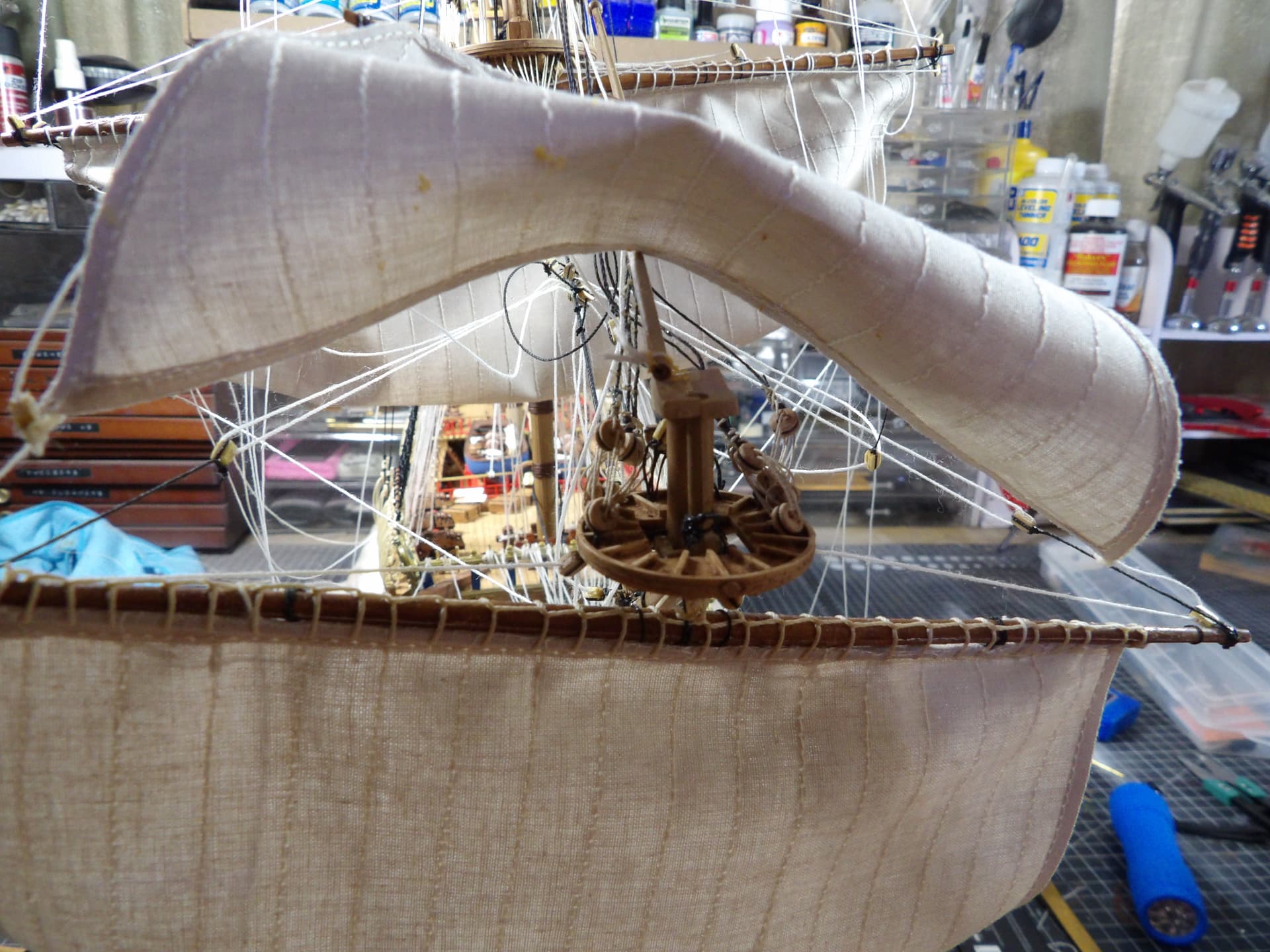

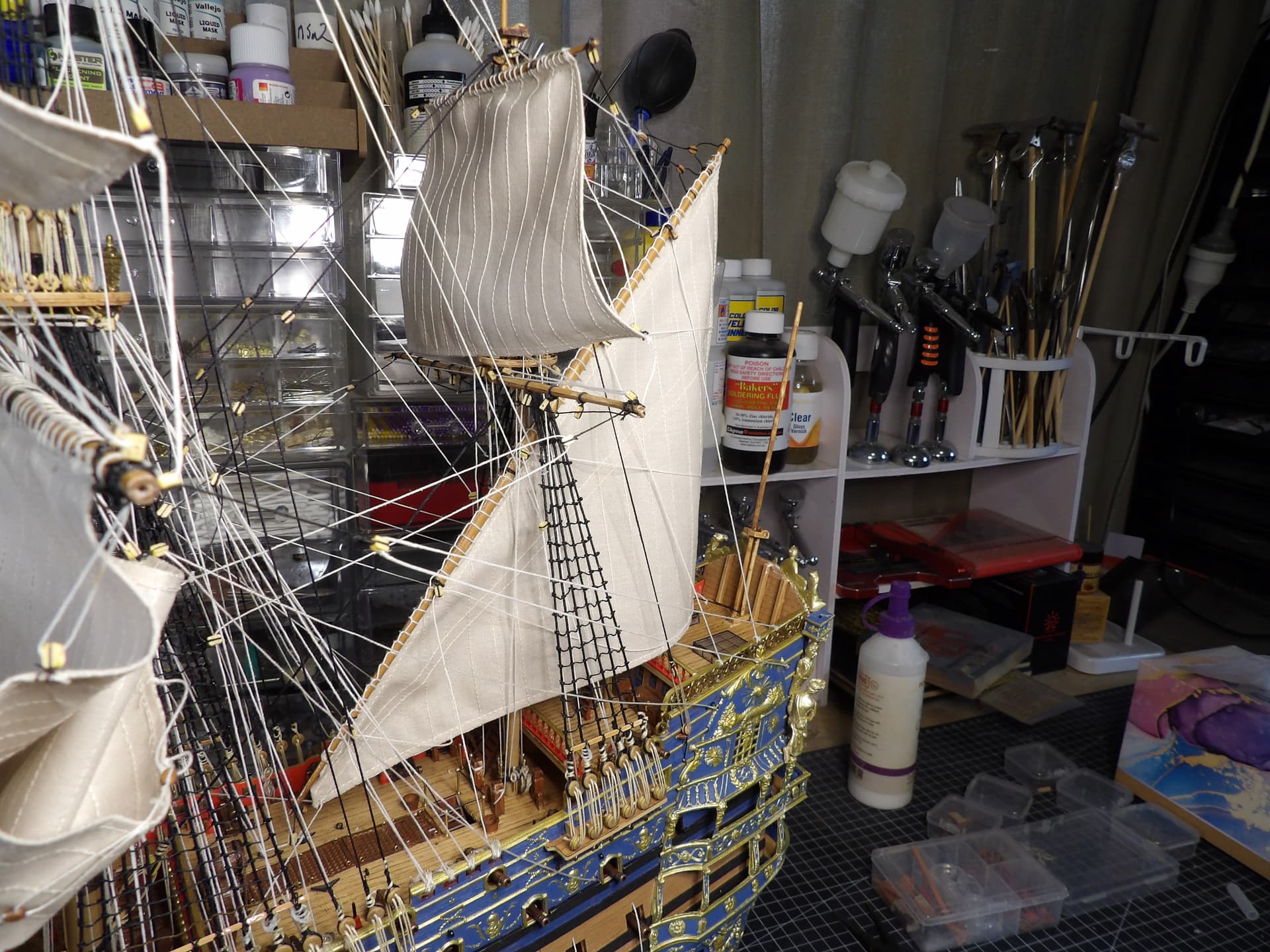

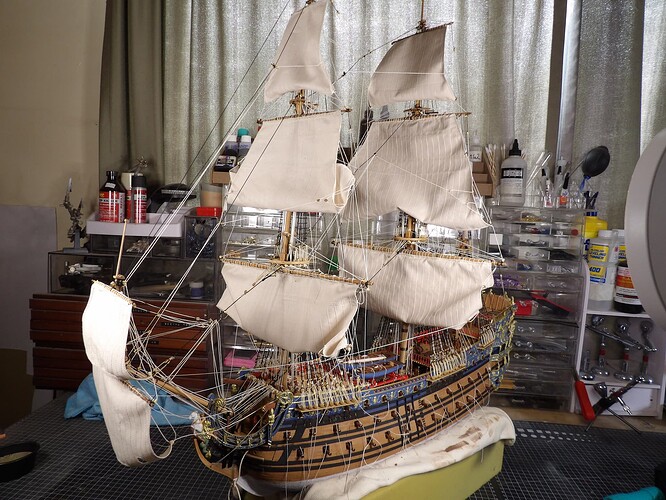

the top gallant yard and sail are on .

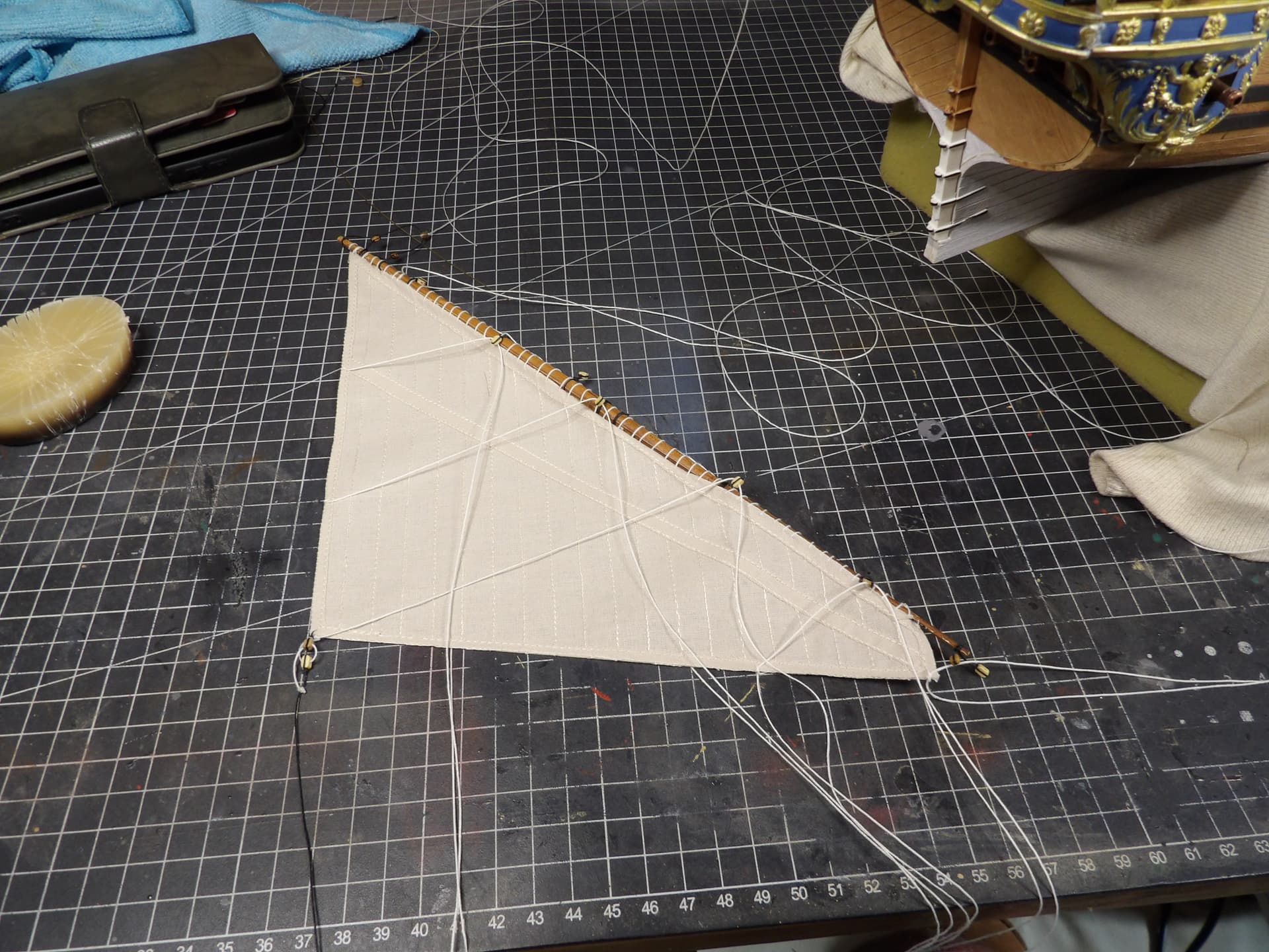

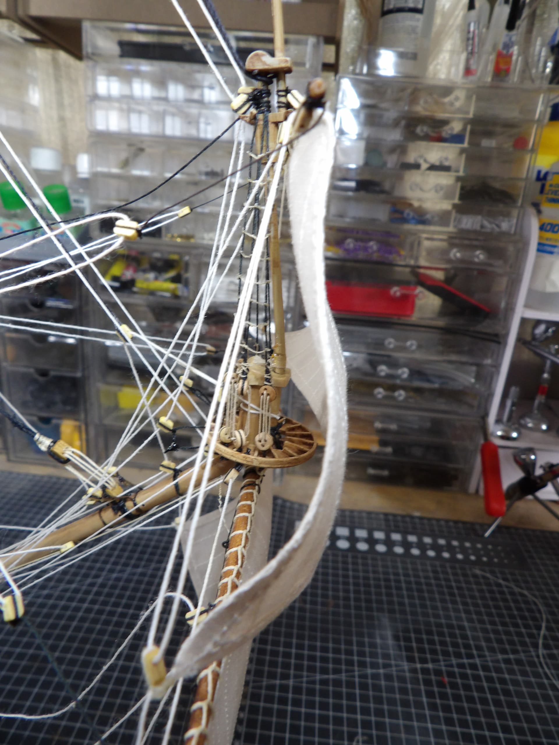

now for the fun one the lanteen sail .

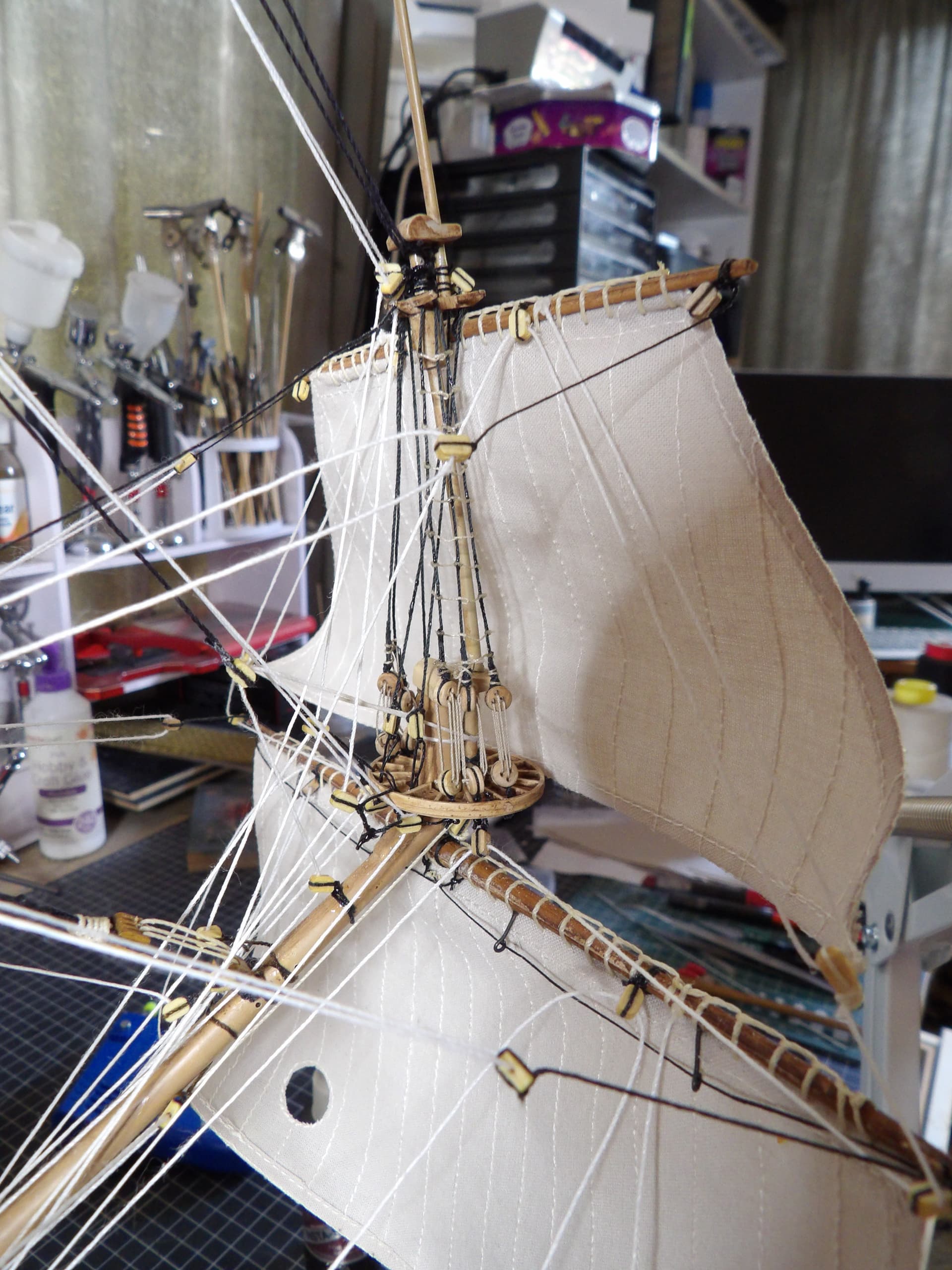

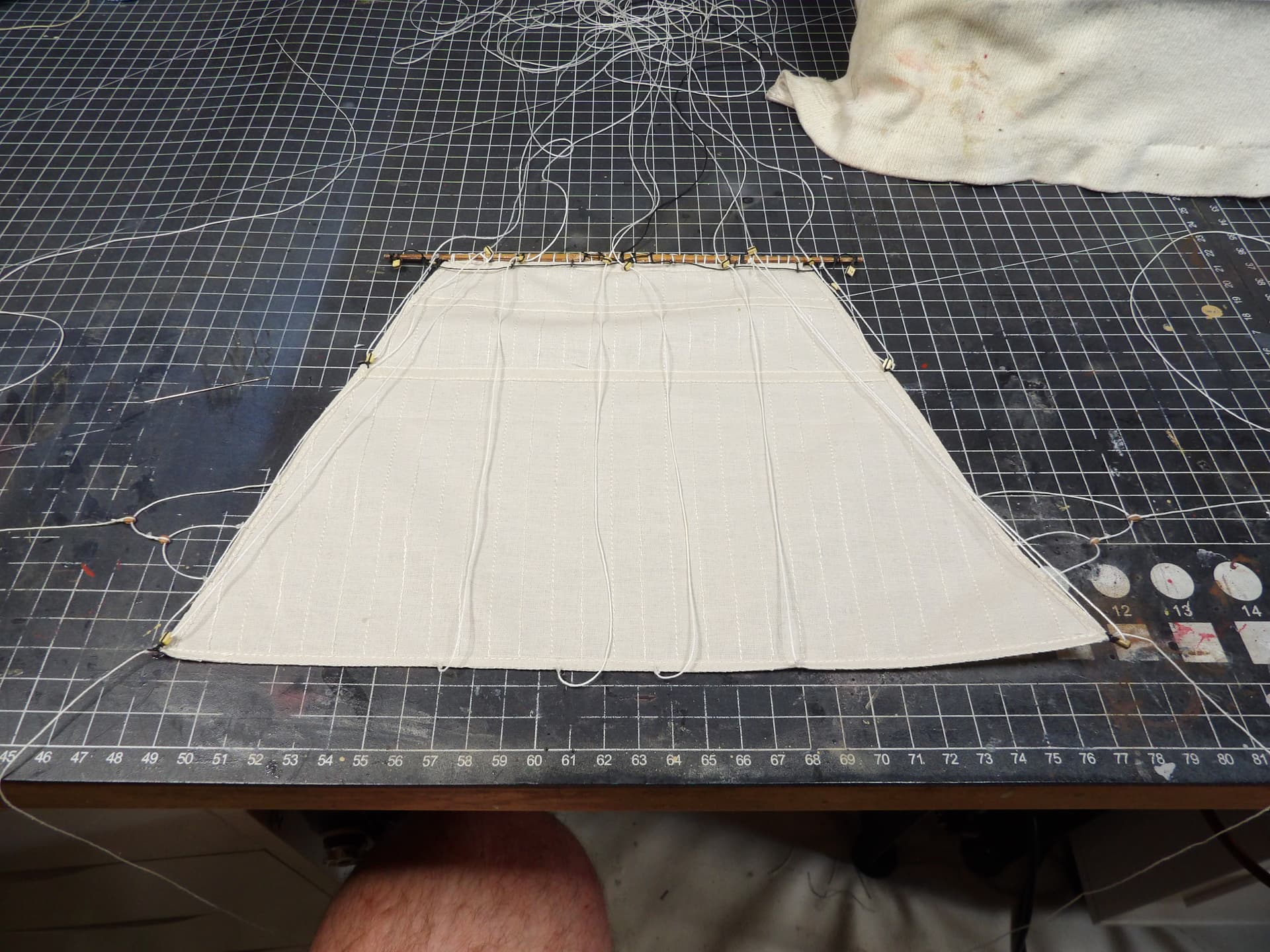

the lanteen sail rigged and ready to go on .

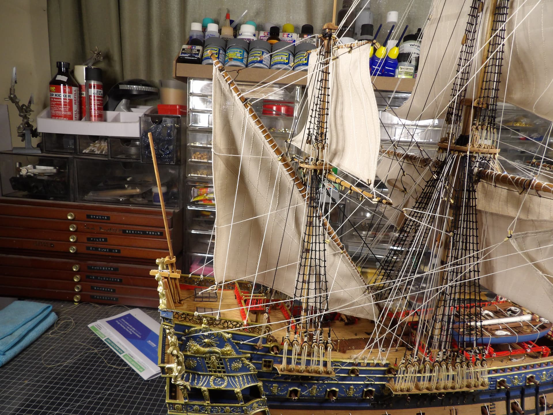

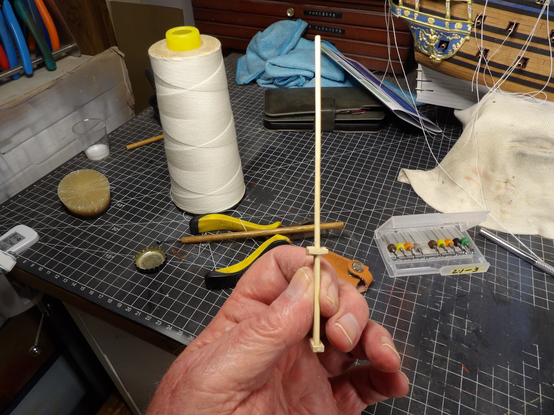

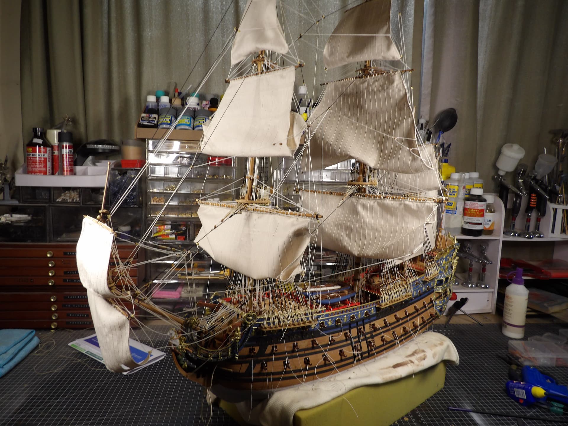

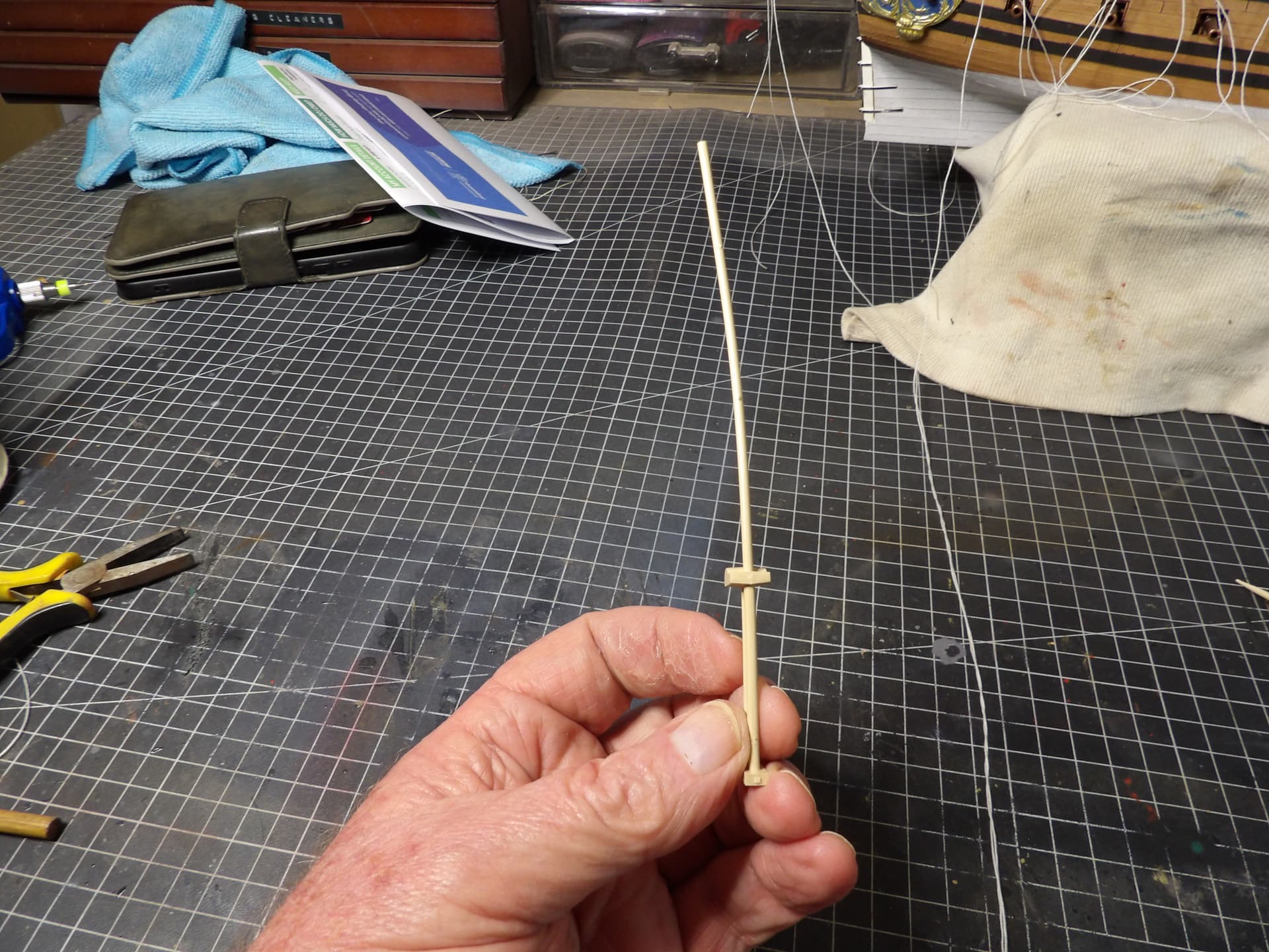

the flag pole wasn’t much good .
so I replaced it with a kebab stick .

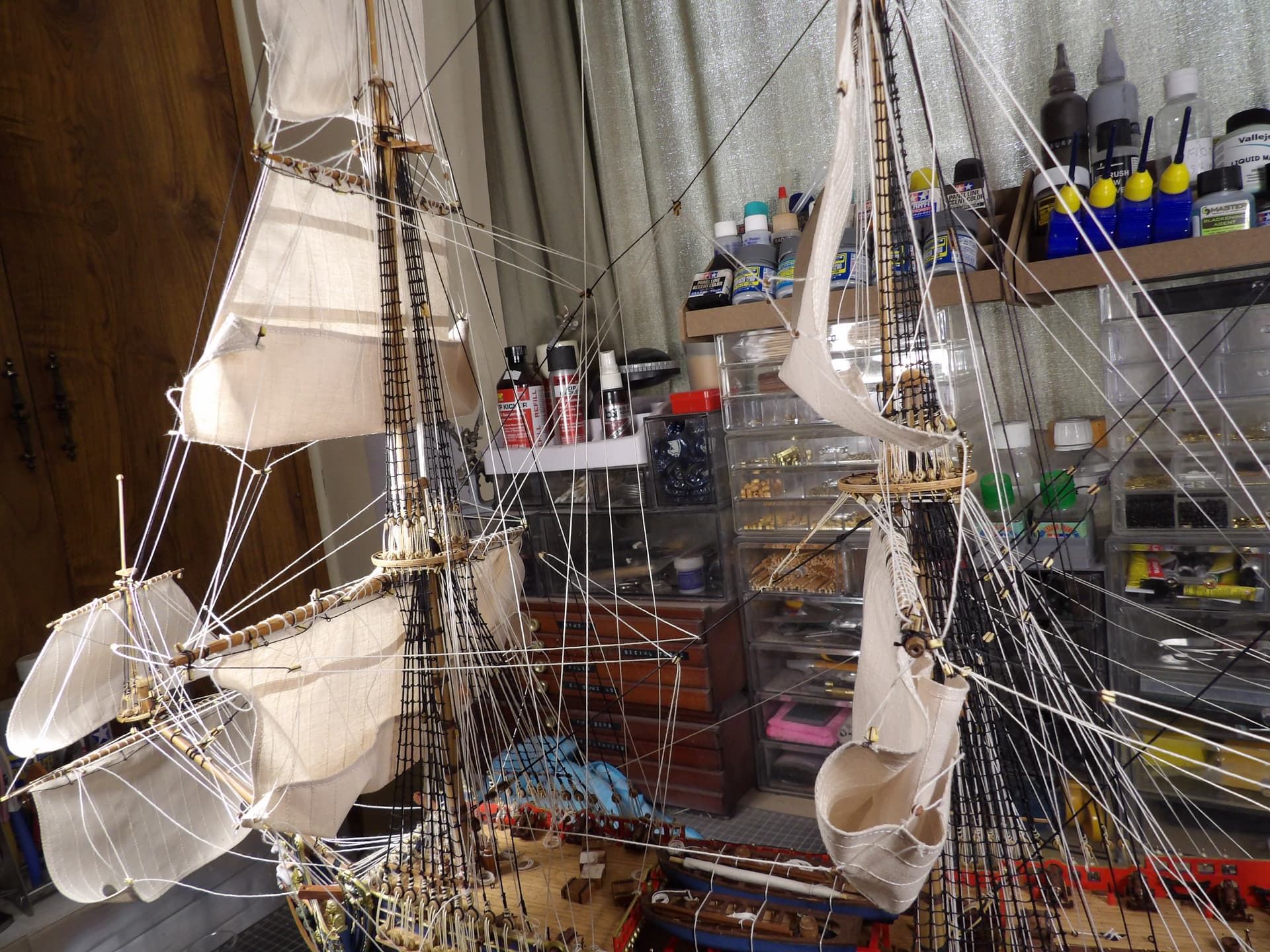

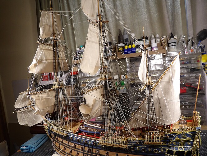

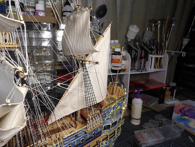

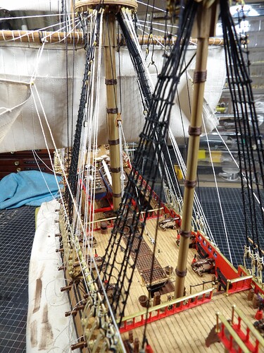

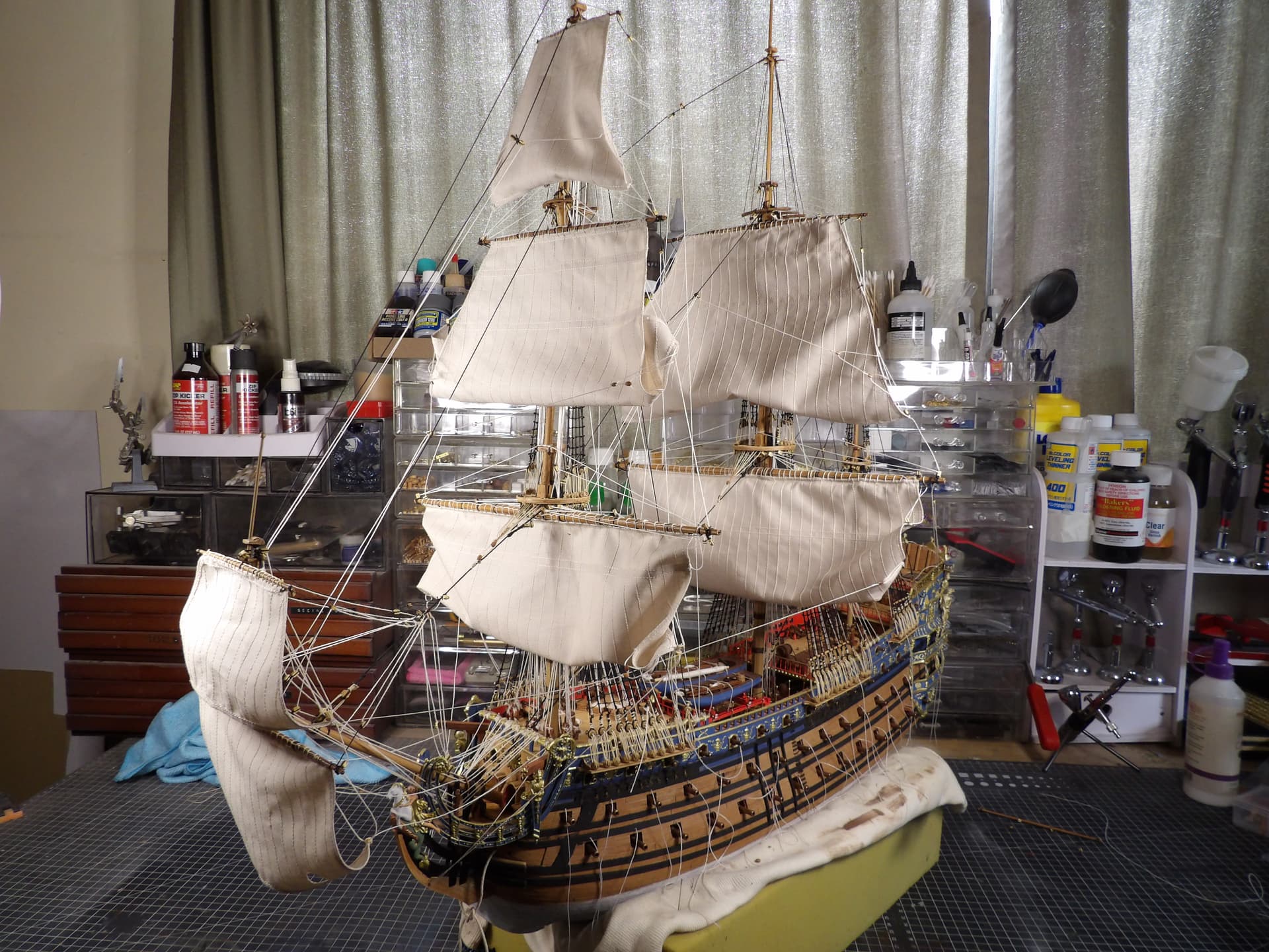

well , all the sails are now on
Good choice - I imagine that bamboo is much stronger than the styrene.

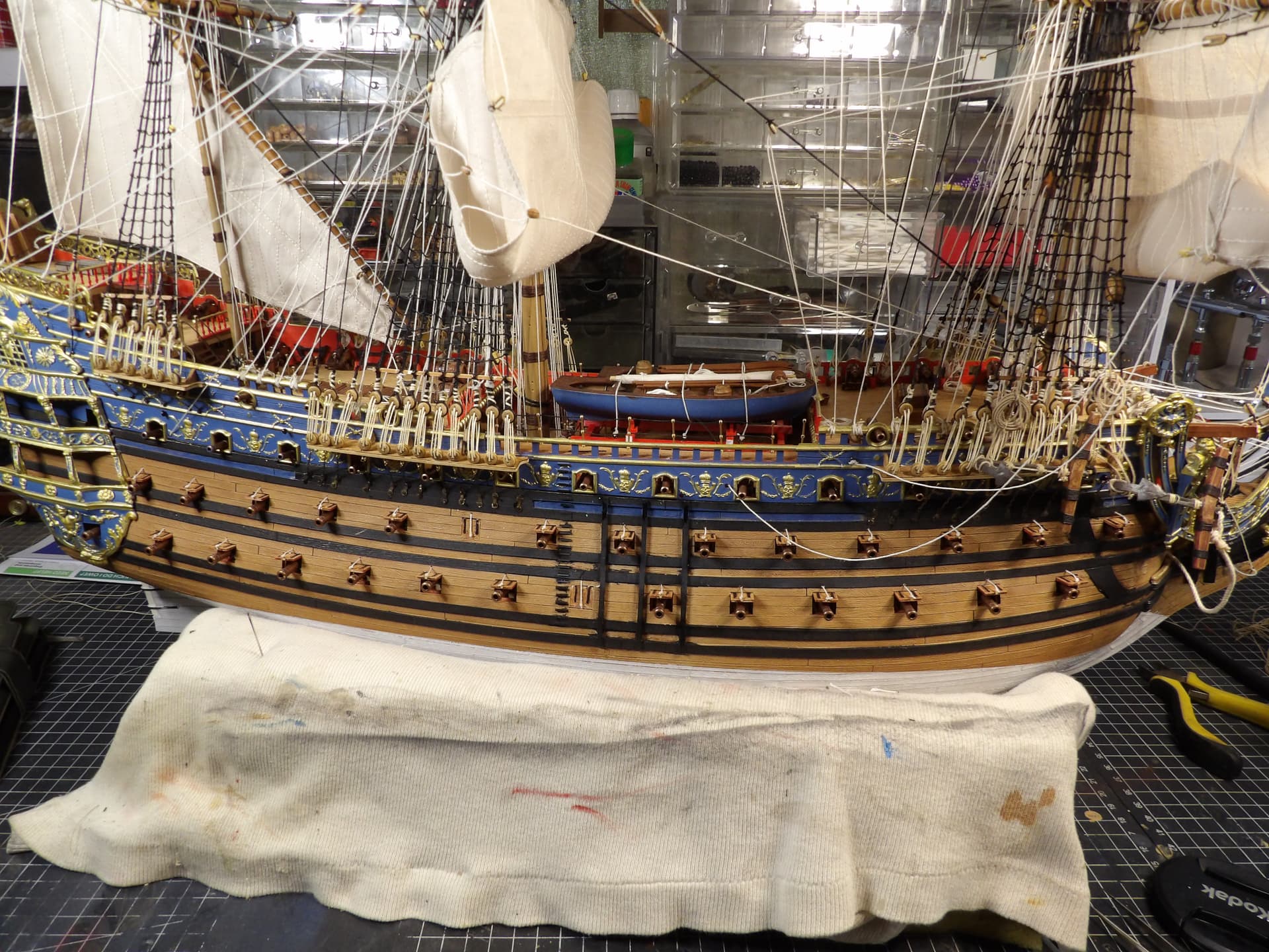

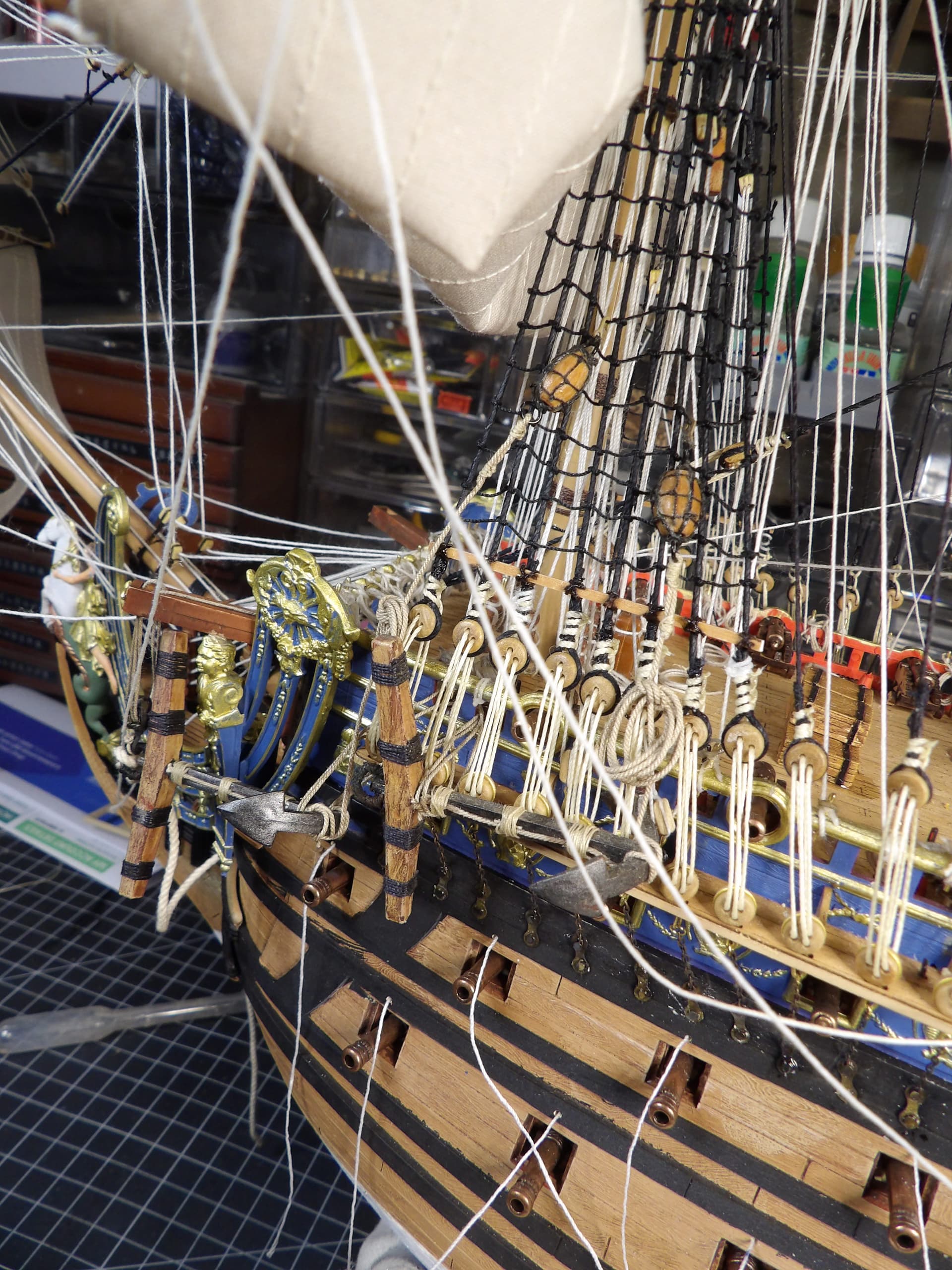

started on the anchors .

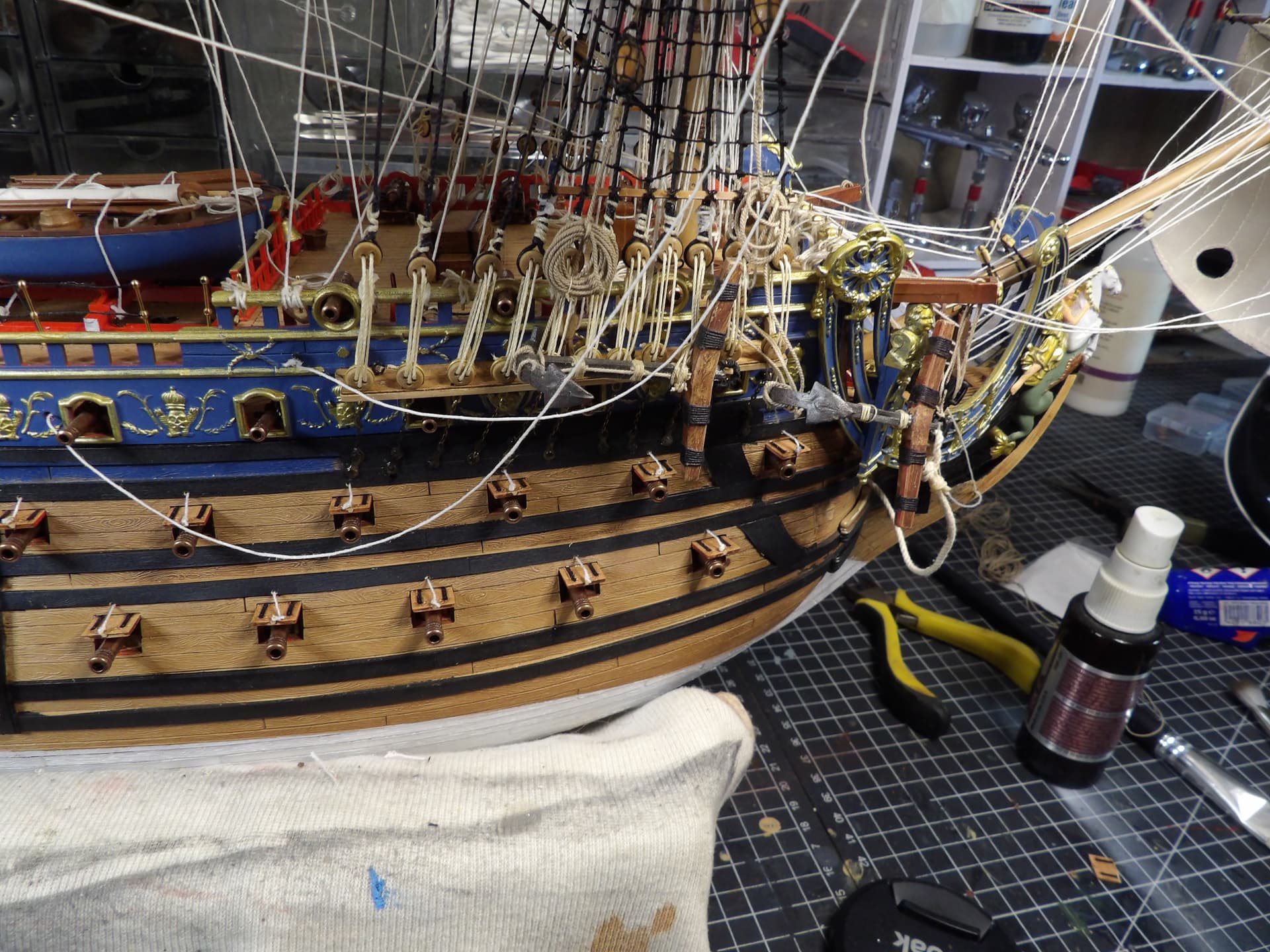

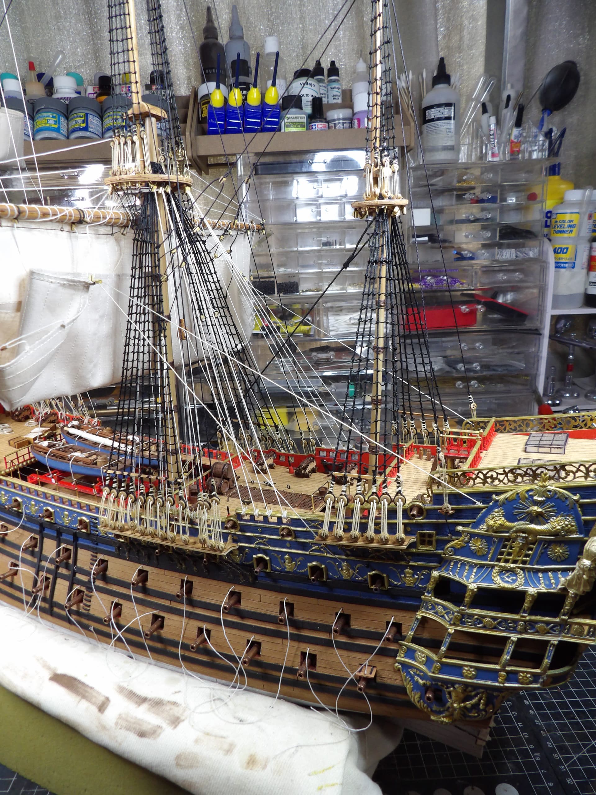

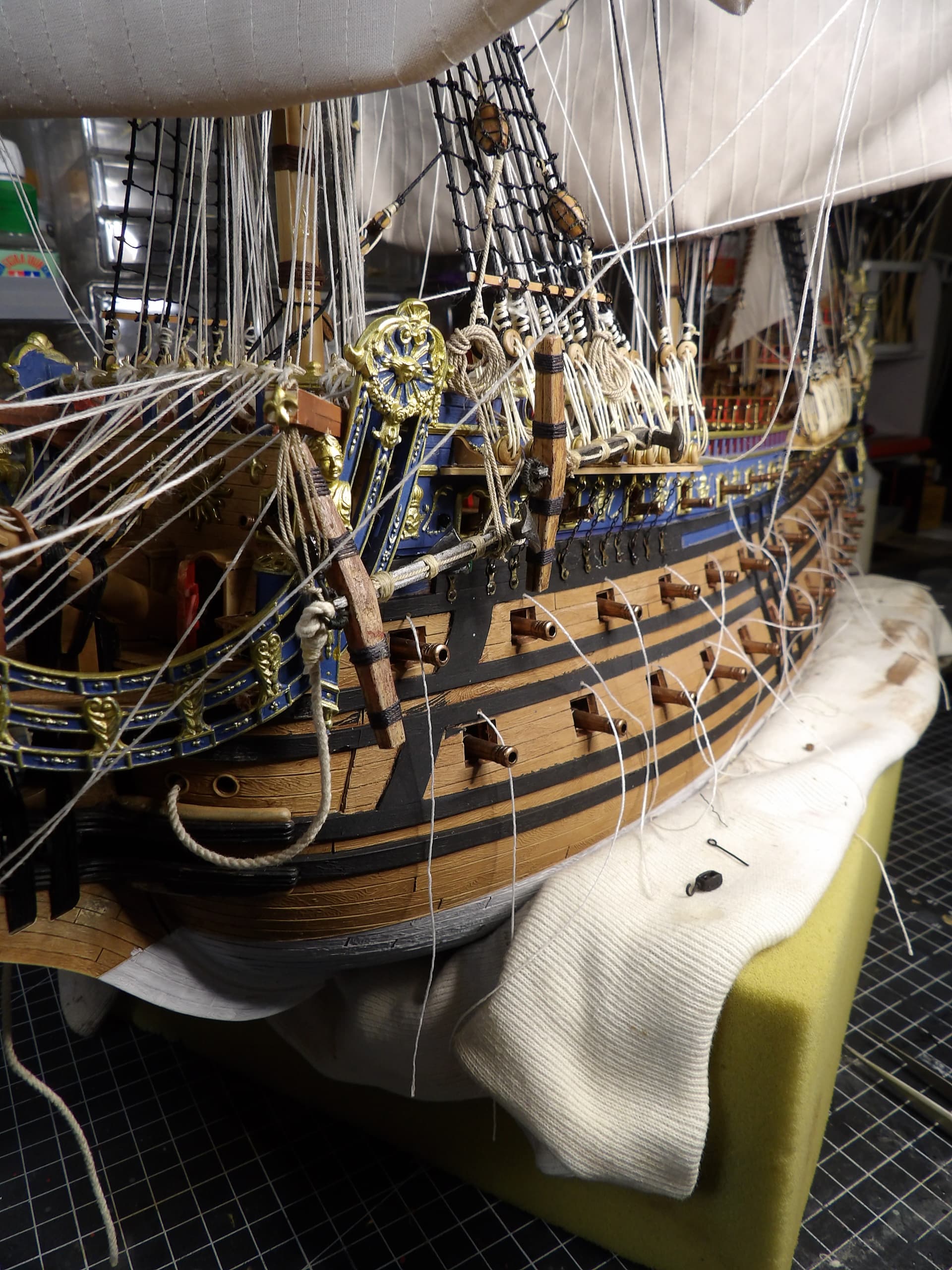

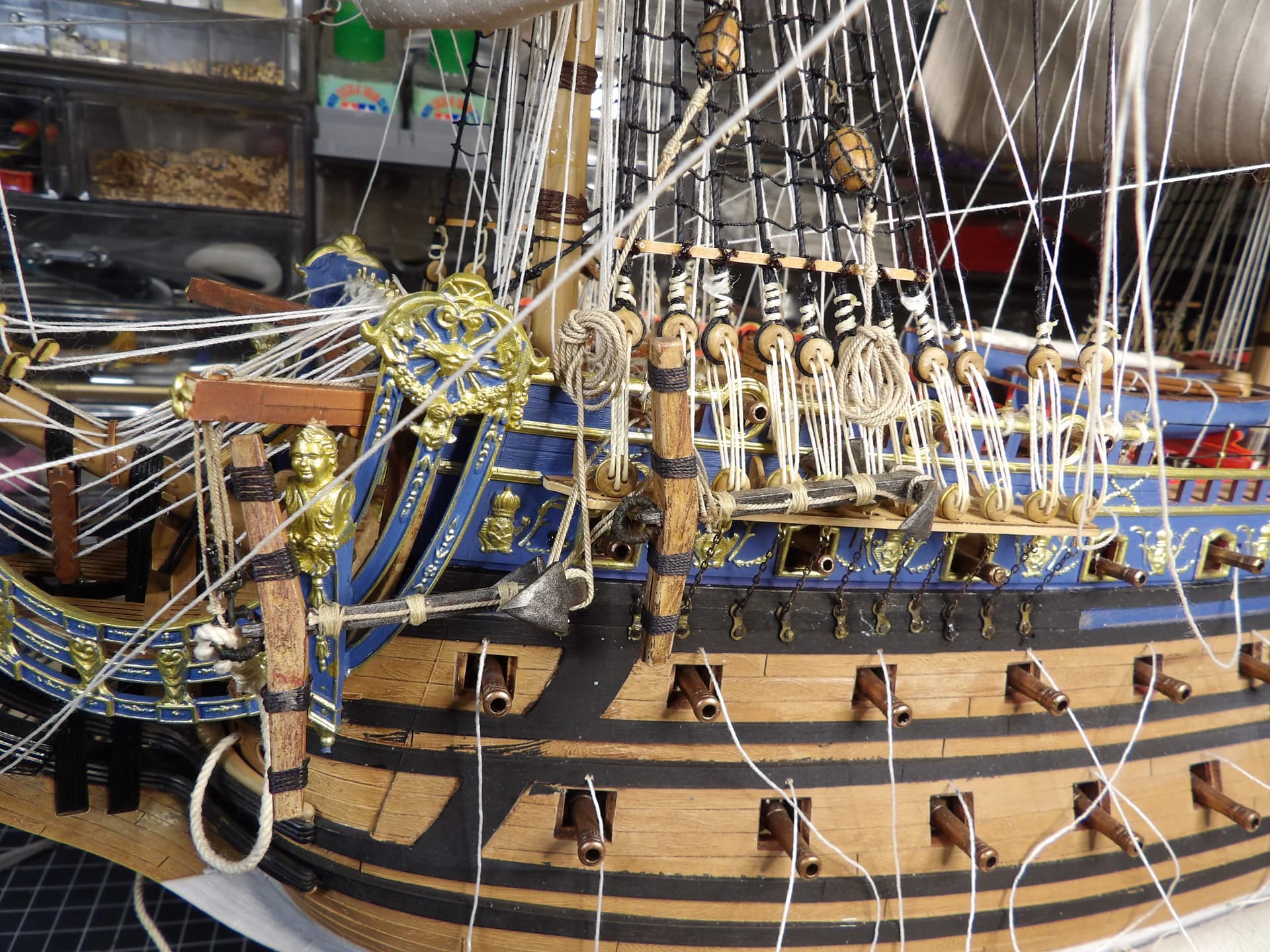

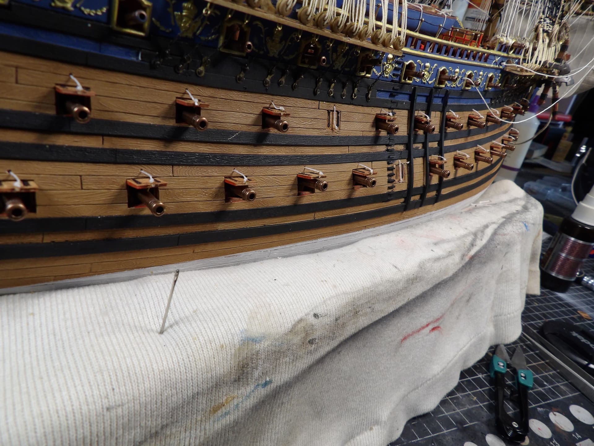

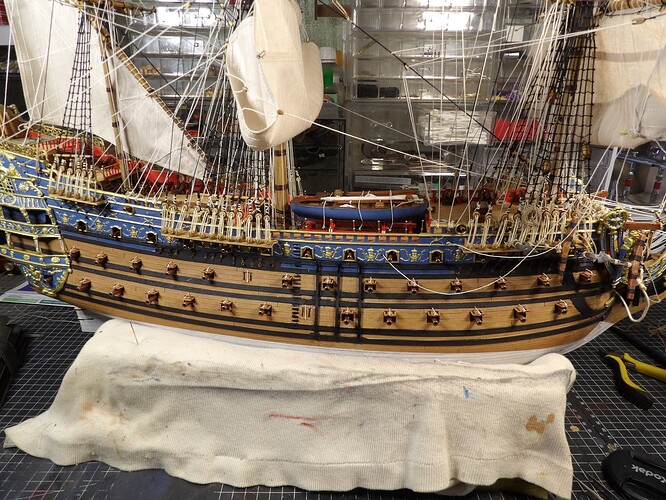

the starboard side anchors and gun port doors are on .
