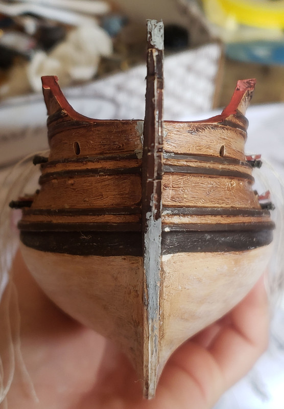

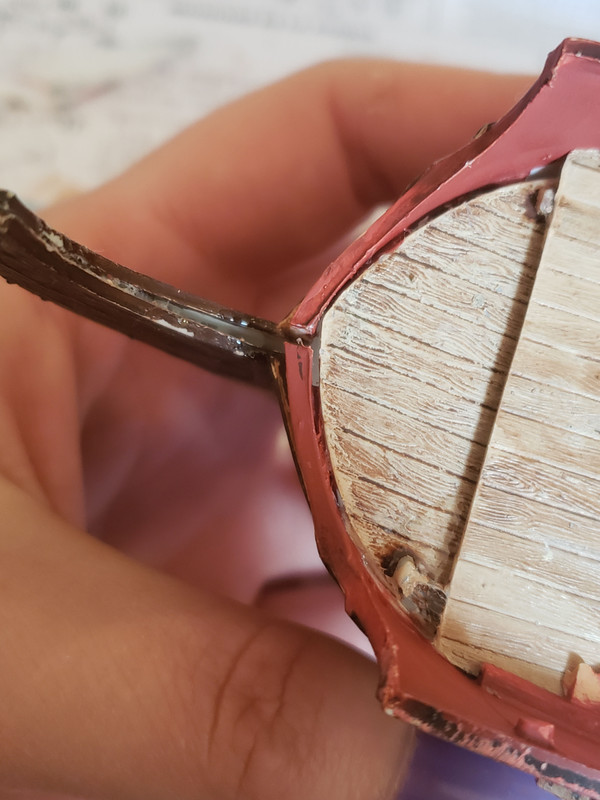

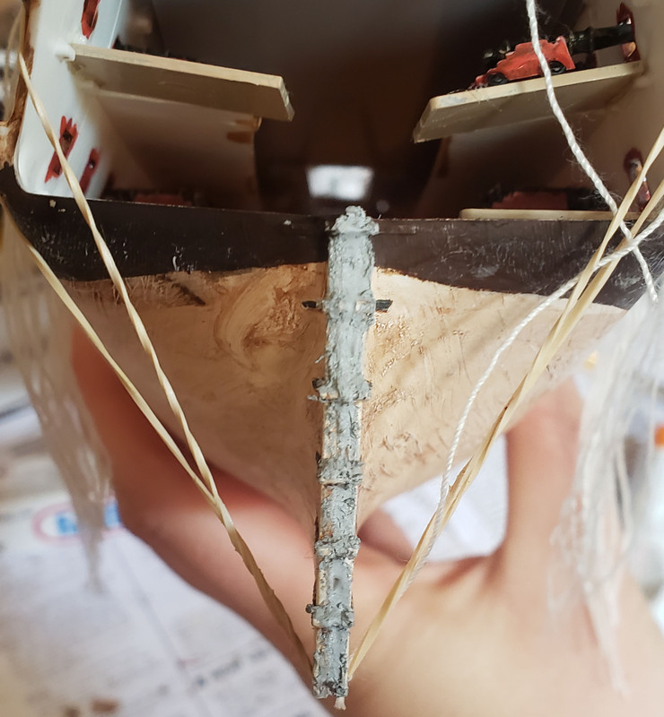

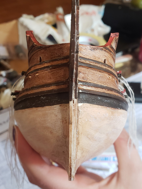

Hull assembly is done, but I ran into some trouble with gaps. Not sure if it’s my issue or Heller’s, but they’re certainly there!
I put some putty in the gaps to help close them up!
So gaps taken care of, they were later filed down and painted over, look convincing enough now!

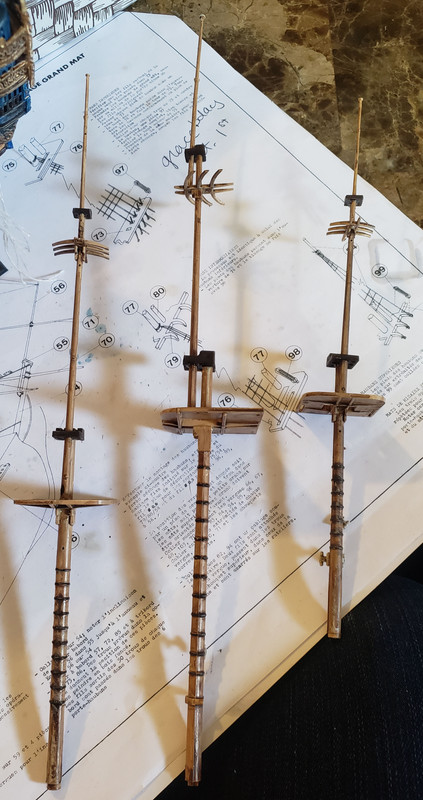

So after that I started assembling the masts, which went easily enough. Although I will note the very top part of the mizzenmast did not fit into the cap piece (I’m sorry, I know no terminology at all, it’s the upper dark brown part that attaches the two parts of the masts together) and had to be shaved down significantly to fit.

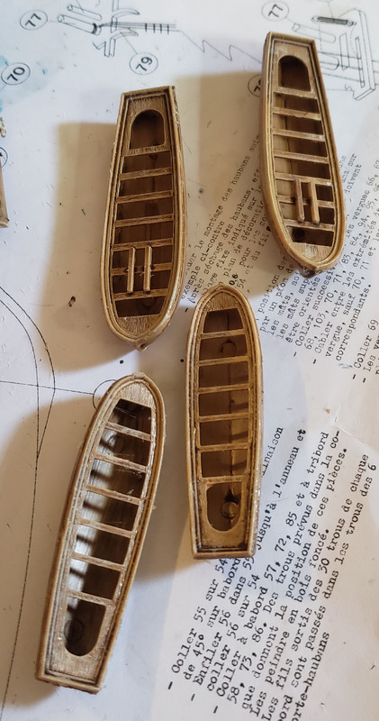

Boats were also glued together.

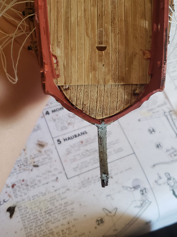

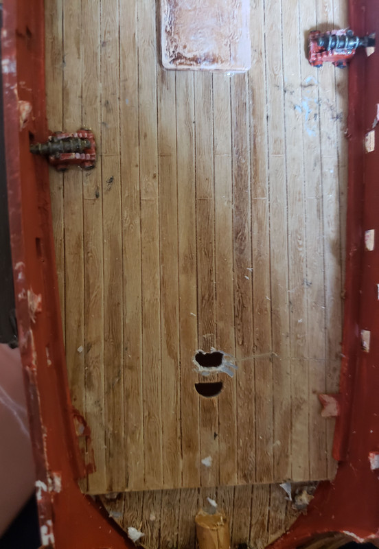

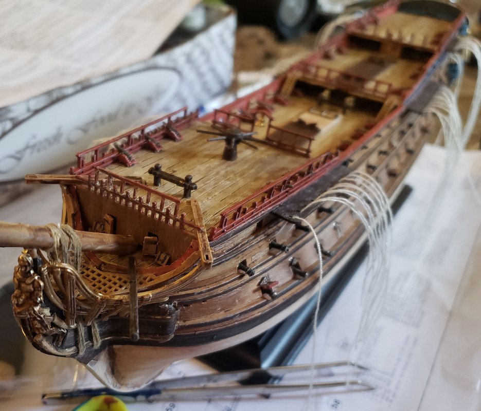

NOW I ran into the big problem. I was dry fitting the masts and while the mainmast and mizzenmast fit just fine, the holes in the top and bottom decks for the foremast do not align. I was trying to figure out if that is my mistake or if it’s just the way the model is; I think it might just be the model, because the other two masts line up perfectly.
Sooooo I came to the decision that I’d have to remove the upper fore deck. Uuuuugh!
I scratched out the area where the hole for the mast should actually be, significantly farther back than the molded one.
Once removed, I lined up the deck in the proper position and fitted the mast into the top and bottom decks. Aaaaah so crooked! So I thought I’d move the top deck up and see if aligning the holes in the bottom and top decks would work (at this point I’m still trying to avoid making a new hole)
Nope, that doesn’t work! Then nothing else in the forecastle fits at all. So it looks like I’ll be making a new hole.
Okay, there it is, all finished! I’ve dry fitted it and it seems to work just fine, so hopefully it’ll remain that way when I rebuild the whole thing.

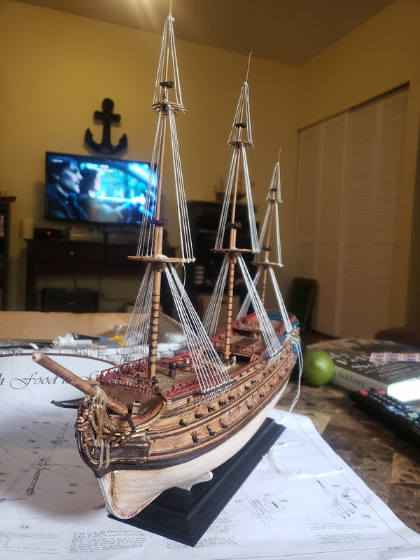

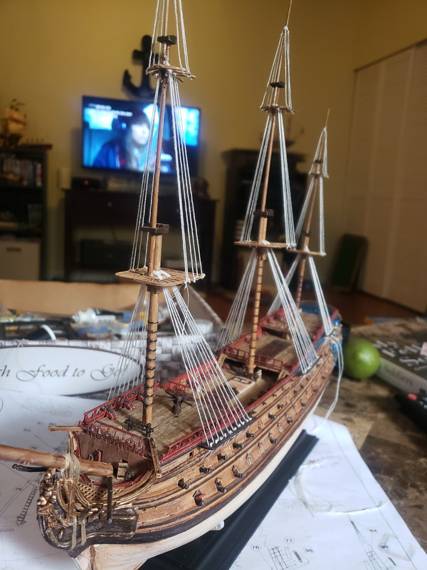

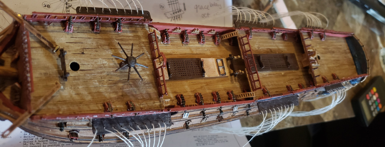

Hey everybody, I’ve run into a question I have for you guys!

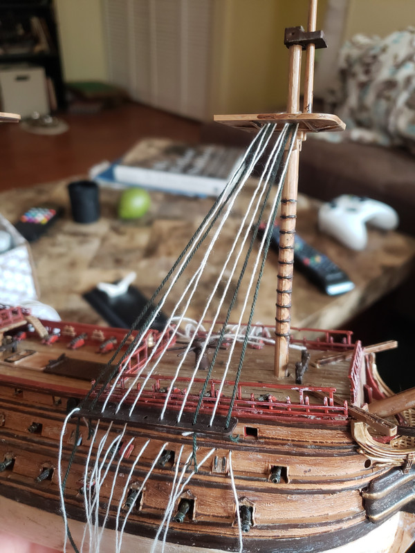

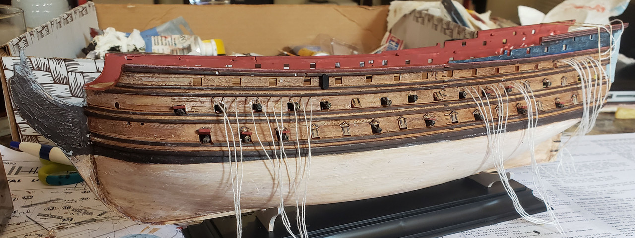

I’ve started on rigging the shrouds, and I’m uncertain of the thickness I should be using. I was wondering what you guys thought, if the white thread looks better or if the green thread does (all will be black later).
I’m thinking the green might be a liiiiiittle too thick, but I’m worried the white may be too thin! I’d really appreciate your input; thanks so much!
I’ve found that thinner is usually better. It is getting harder these days to find thin thread (employee at Michaels said sewing getting to be less common hobby). Usually one can find thread sizes for lower shrouds okay, but stuff for lighter rigging is tougher.
I find so many finished models that have too thick rigging, I find that ones with thinner rigging look better. Also, it looks like you plan to paint rigging.
One can make black lines look thinner by painting them with a dark gray rather than pure black. With long, thin lines, the contrast strongly affects our perception of size. Medium gray would look thinnest, pure white and pure black would look largest.
I agree, the white is closer. But, it’s hard to tell because the ship is such a small scale.

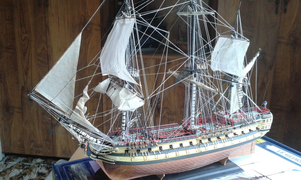

I agree with both don and G , the smaller thread would look better , this is a pic of my la glorieux , it’s a slightly larger model than your’s 1/150 , I think I used .45mm for themain rigging and .20mm for the ratlines .
and dk
DK grey look’s more realistic than black , as don said .
I must say, pretty impressive for a first time. Love the oil wash and dry brush used. You have done a lot in a short period of time, keep up the good work.

Great work on this kit. I have built it and as you have found out, it requires a lot of pre-filling, cutting, sanding, and fitting again of the rear galleries and much of the deck furnishings.
Those masts and spars bend real easy. I chose to use the ratline jig on this kit because its was a tit for tat trying to get the shrouds taunt without the masts bending. Then when it came time to set the standing rigging, it was a mess, so I used the jig and tied up my pre-made ratlines after the standing rigging was done and the masts secured. I also built the Pheonix and had the same problem. Also, as mentioned, use small diameter thread. I used a lot of coat thread on this kit because it was not so flexible.
I have a few more of these Heller kits in the stash and swore that in the future, the masts and spars will be made from wood.

Seems like plenty of people have offered suggestions for your shroud thickness, and I would tend to agree, though if I could add two extra notes:
-For the lower shrouds, either of those line sizes seem fine to me.
-For the upper shrouds, I think you might consider going with something even thinner than either. Once you get up there, the thickness of shrouds will become obviously oversized, and also the tension it will take to keep thicker line tight could cause issues with upper mast bending…just my 0.02

Thank you, I’ll be going for the thinner white thread! And thanks for the info on the painting, I hadn’t thought of that and will definitely be doing it!
Thank you! And your glorieux looks beautiful! Also, I was curious if you would be able to direct me how to access the thread you linked about the french rigging. I’ve tried to sign up to for the site a couple times and they haven’t sent me an activation code so I can’t get onto the site!
Thank you! But as much as I’d love to take the compliment, this isn’t my first ship haha. I’ve done maybe five or six prior to this one, just haven’t posted them. I did a couple when I was maybe 10 too, but I don’t count those ones; they were exactly the disaster you’d expect from a 10 year old trying to have any kind of patience haha!
Thank you! And yes, certainly! Unfortunately all the shrouds are done at this point, oh well, I know better for next time now haha! But for sure the masts are pretty flimsy. I tried to correct as much as I could with the shrouds, but viewing the ship from the front the masts don’t line up perfectly by any means!
Thanks for the tips! Unfortunately all the shrounds are done already, but I think I’ll be mixing your suggestion and Don’s suggestion- painting the upper shrouds a different color to give the illusion that they’re thinner.
