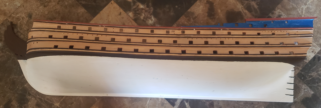

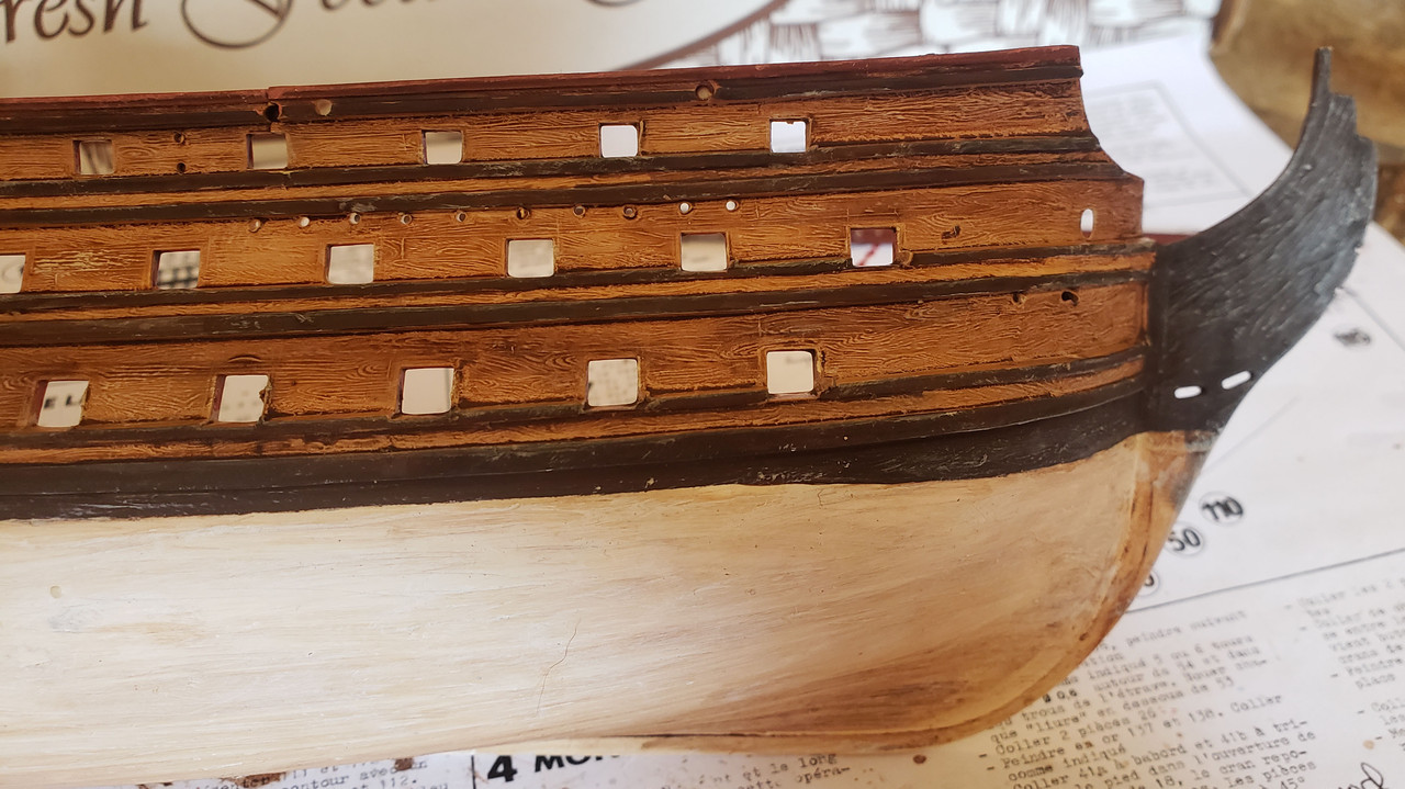

Good morning everybody! My name is Cathy, this is my first time ever posting here. I’ve browsed through some of the topics here and figured I might make a log of my progress on the Heller Royal Louis. This is the most extensive ship I’ve built and I might find myself needing some help once it really gets going! I’m not at all educated on rigging or anything, I know very little terminology or what is correct/incorrect, so I might need some advice when the time comes, if its not too much of a bother.

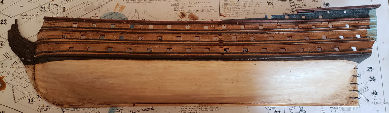

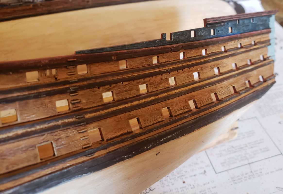

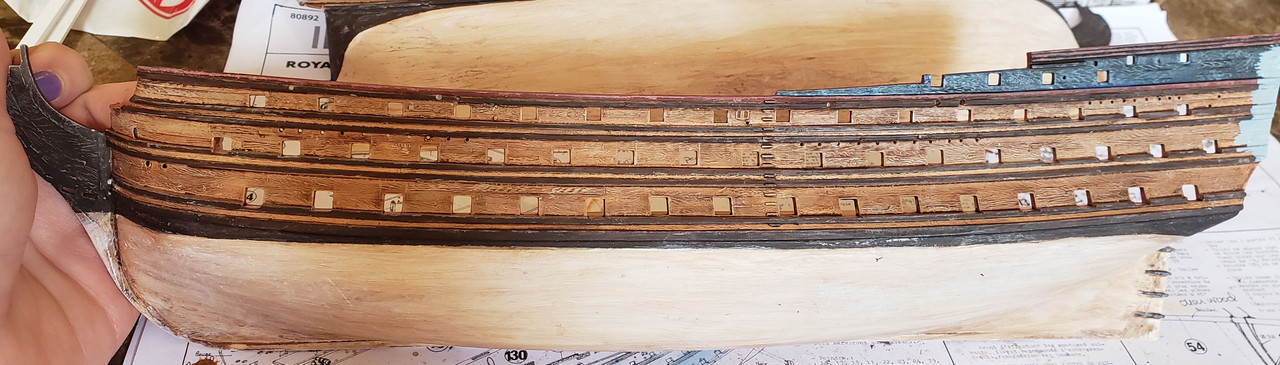

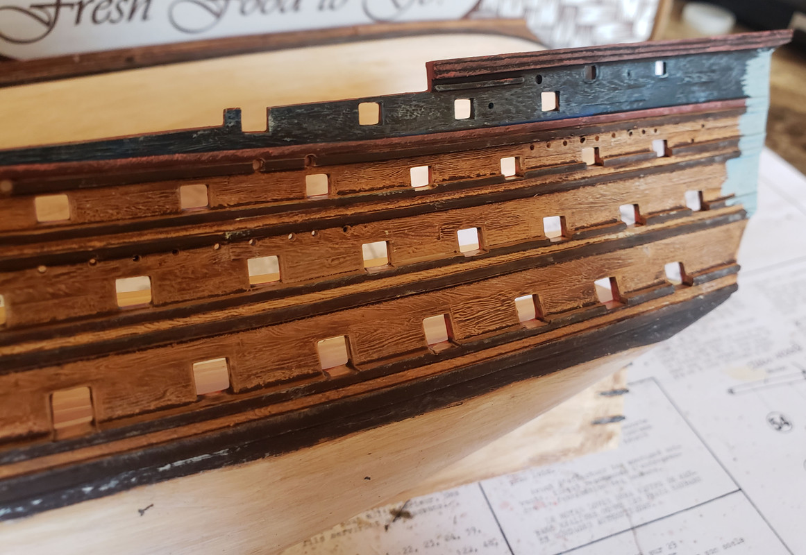

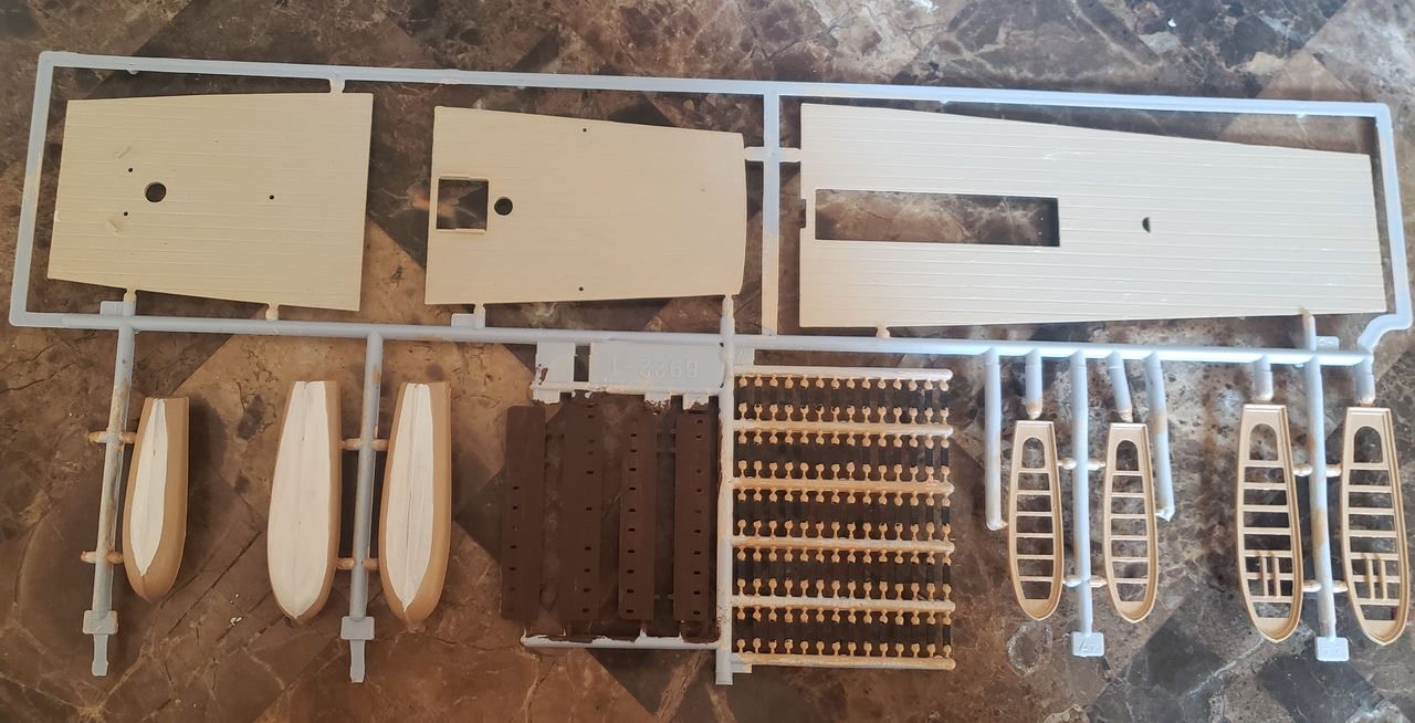

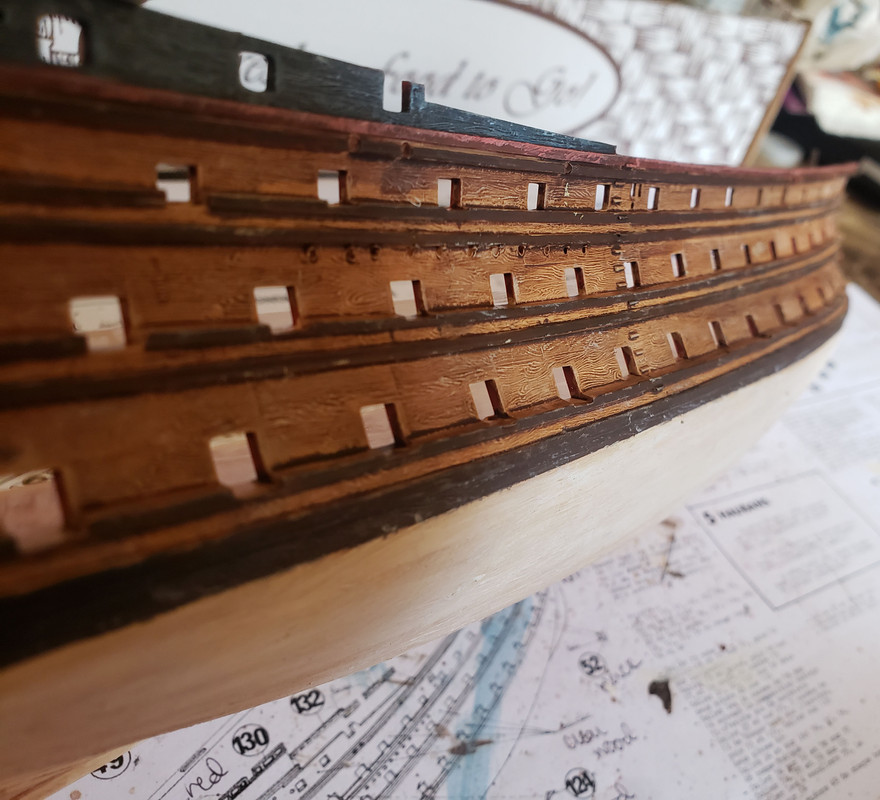

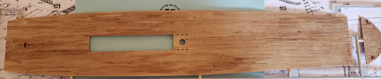

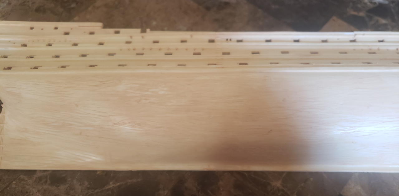

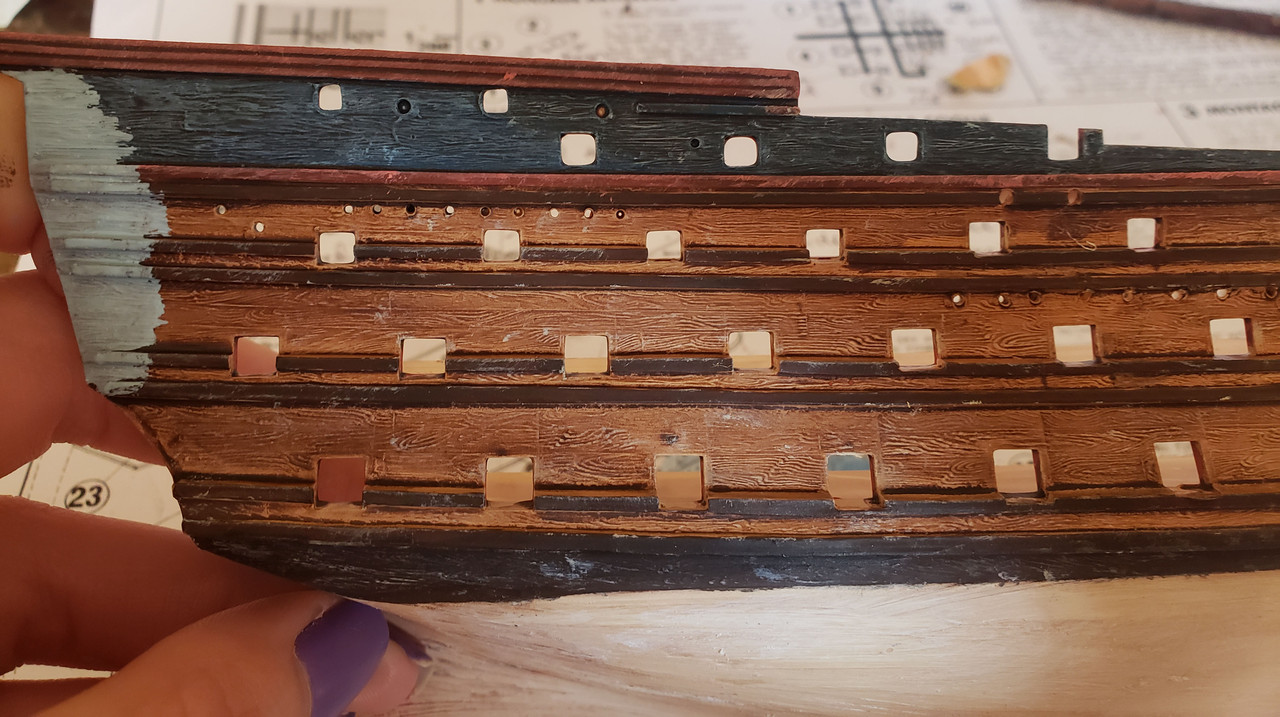

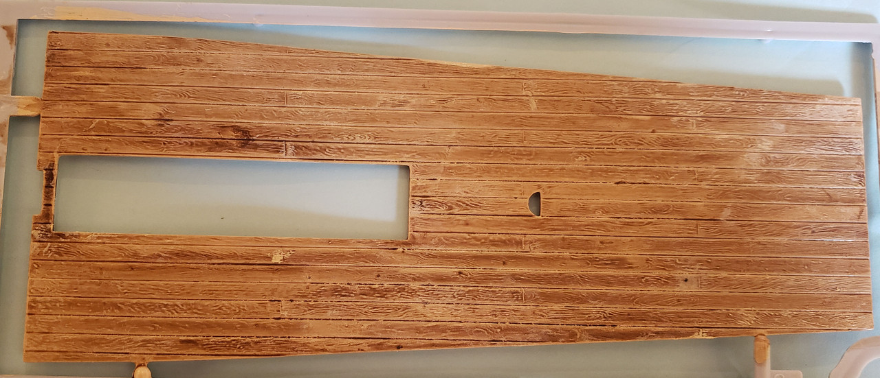

I don’t have anything really exciting yet, I’ve just primed the parts so far and gotten started on painting the cannons. Unfortunately the hull did not have the wood grain in the mold, so I decided to etch in the wood grain. I guess it came out okay, I wish it had just been molded into the hull, but it is what it is!
I’ll update some more when more painting gets done. Thanks for looking, I can’t wait to be a part of the community here!
Looking good so far. Those 1:200 Heller sailing vessels are nice kits.
Thanks! And yeah, except for the wood grain thing I’ve been impressed so far!

P.S. Great idea for the grain effect on the lower hull. Heller has a few kits where the wood grain is missing. With the early molding techniques I can understand why they left it off the very bottom of some hulls but I think they could have added it to the lower sides on this kit.

And thank you! The grain I etched in isn’t as detailed as the molded grain and it’s definitely out of scale, but hopefully it won’t be too noticeable from a distance!

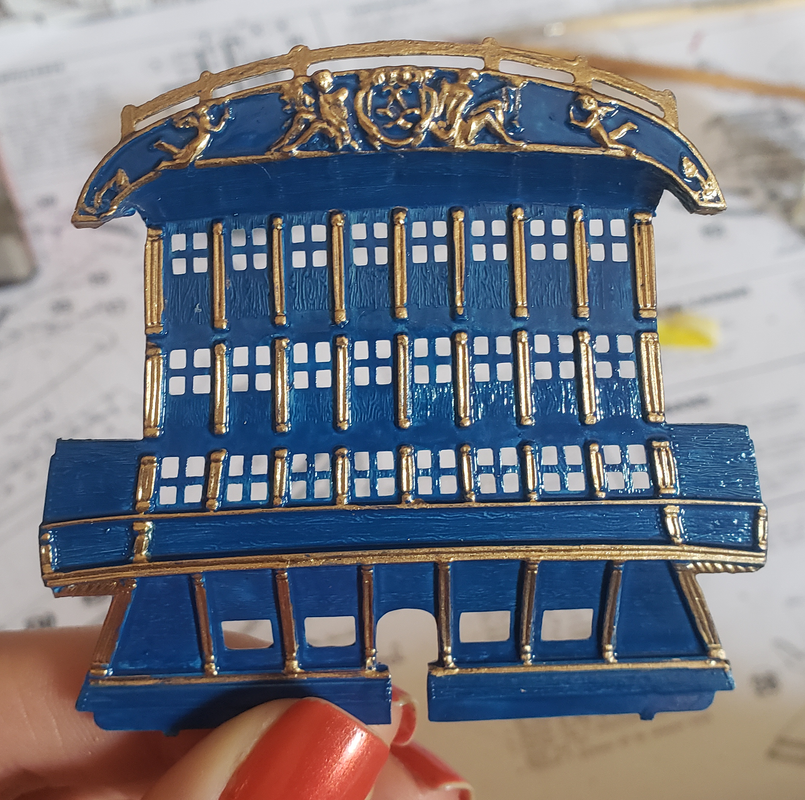

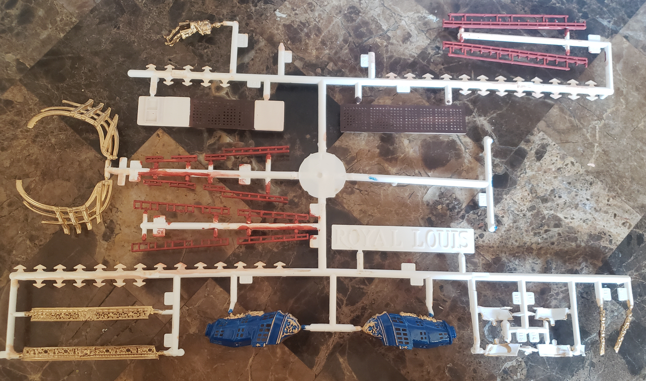

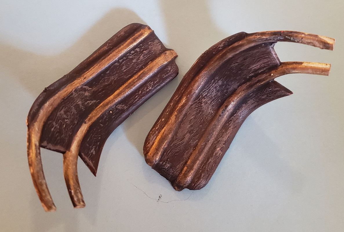

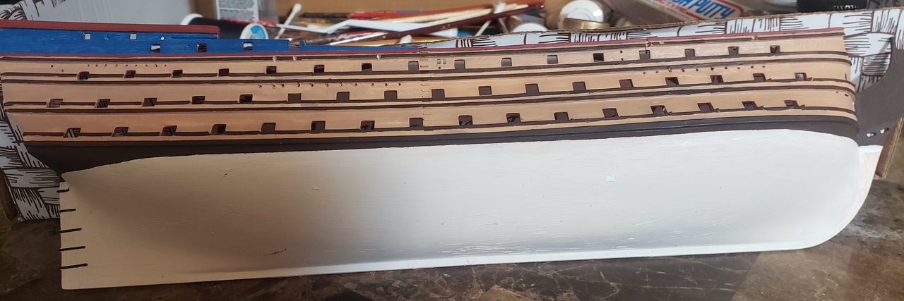

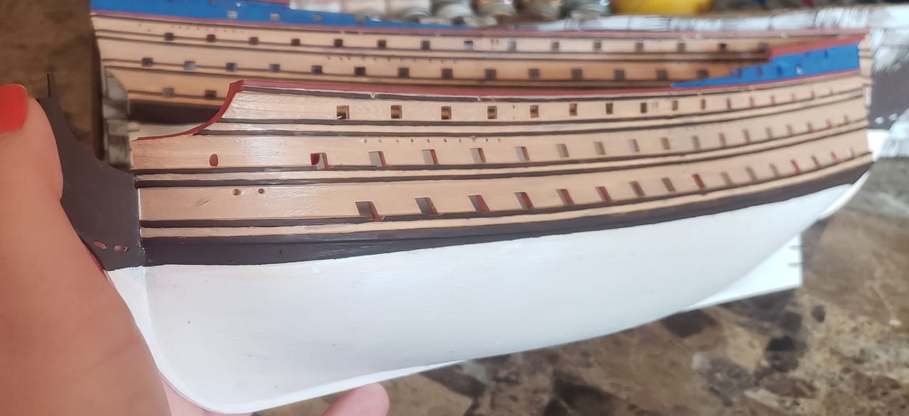

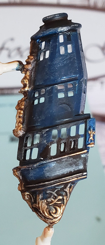

Thanks everyone for the kind words! I’ve made some progress over the past couple of days, all the painting is finished.

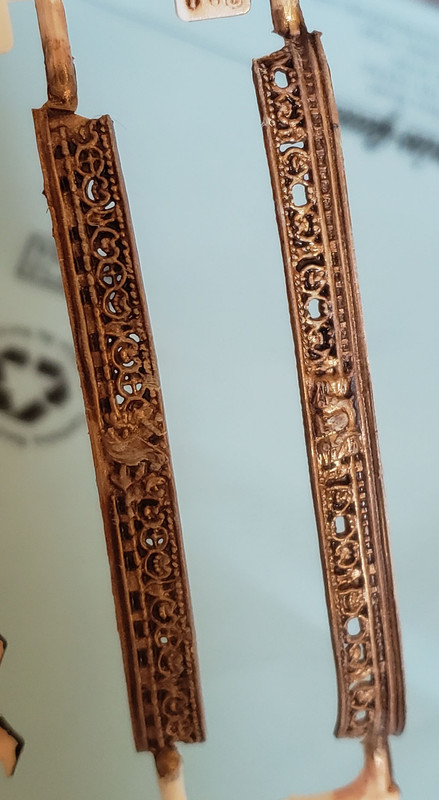

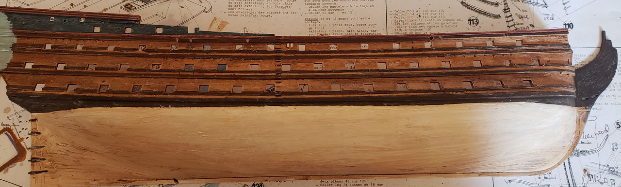

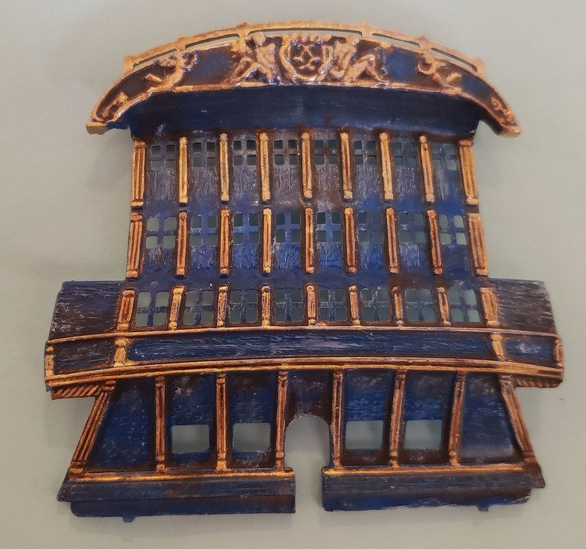

So the base painting is all done! I might go back in with the gold on the transom and fix it up a bit. The next step is the weathering (the most stressful for me, but also my favorite!)
I’m not too crazy about the colors of the ship, but hopefully they’ll come together a bit better once they’re weathered. Thanks for looking, hope everybody has a great weekend!
Impressive!
I especially like the painting on the hull…
Much of the time, I count on weathering to help blend the paint scheme, and sort of bring it all together…it usually does the trick! What type of weathering will you use?
Dave
Thank you!! And yeah that’s exactly what I’m hoping for! I usually do a pretty diluted oil wash and then drybrush with the oils.
I fmemory serves, the vessle was a flagship, so there would have been a lot of effort to eep her pretty clean. Not pristine, per se, but pretty clean. Water line, and hull bottom could be a bit grungy, though.

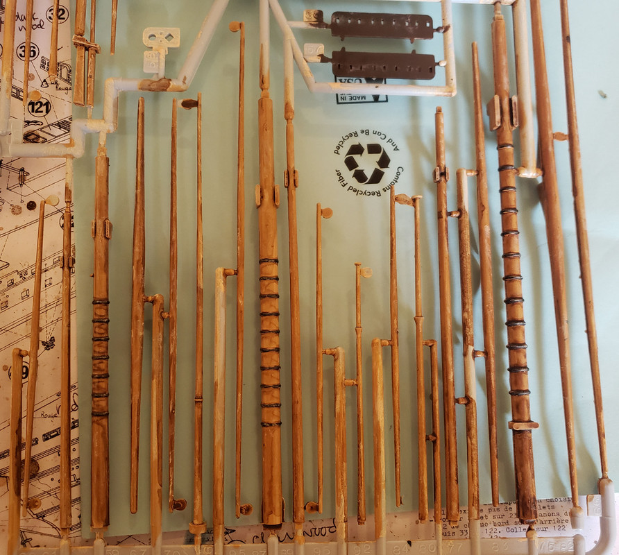

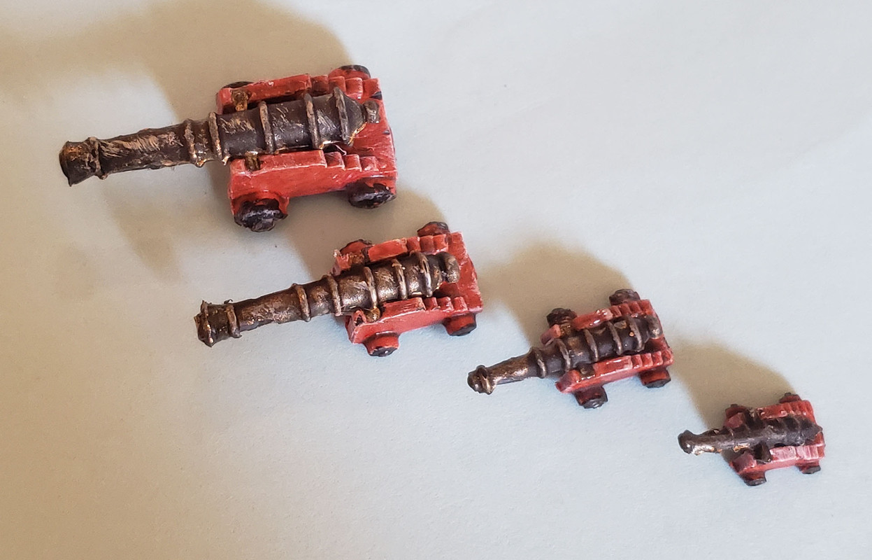

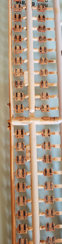

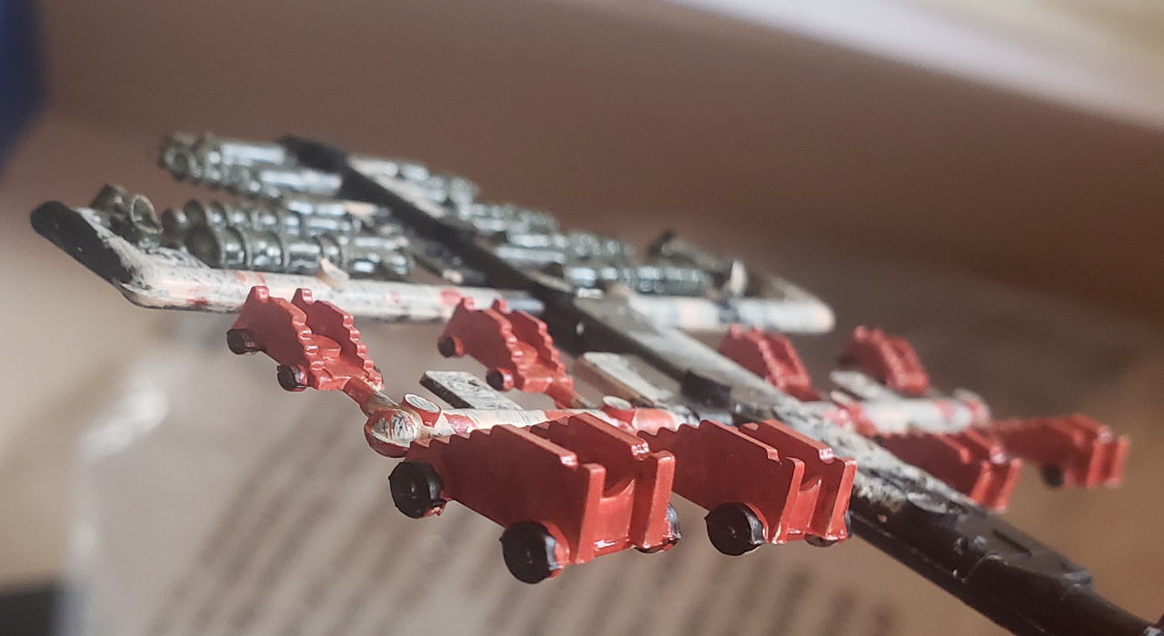

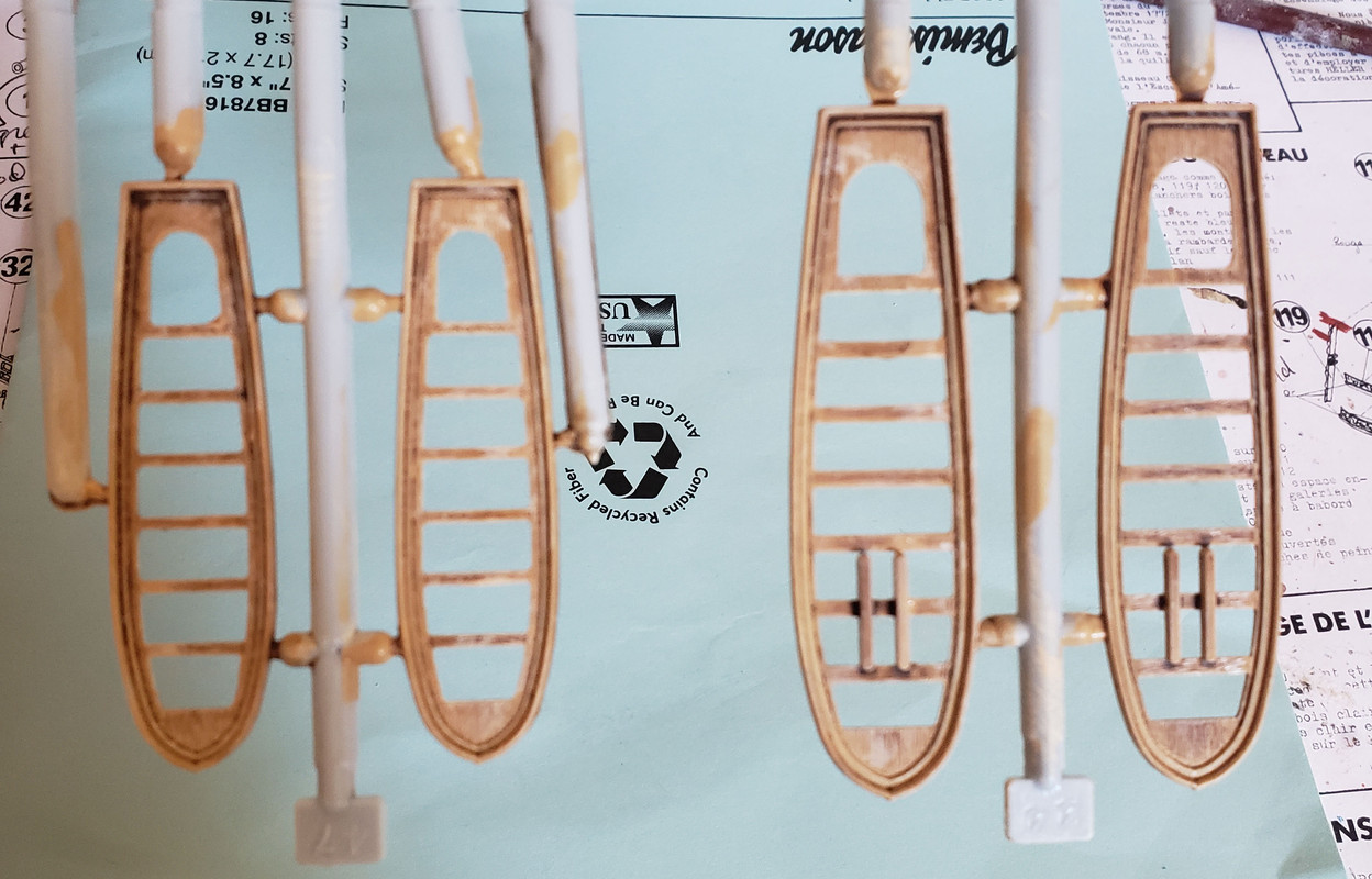

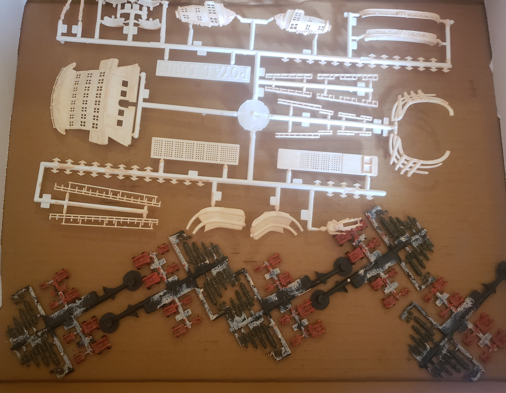

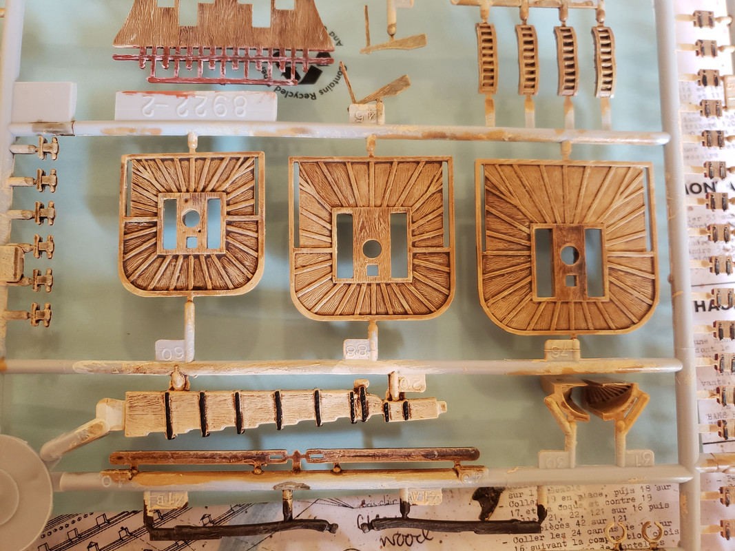

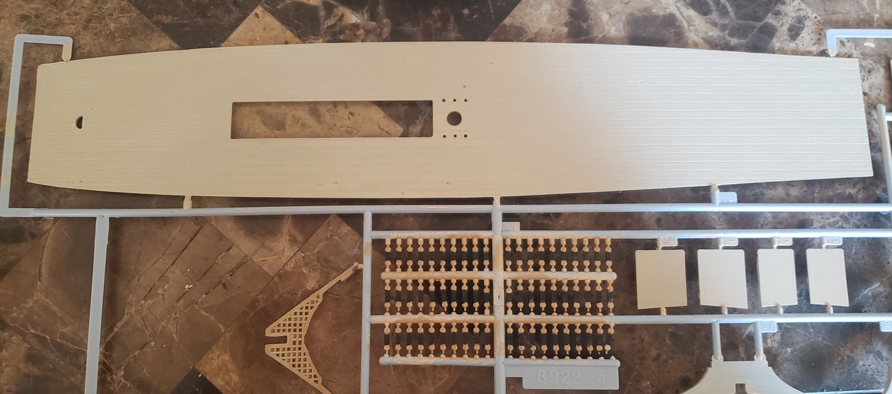

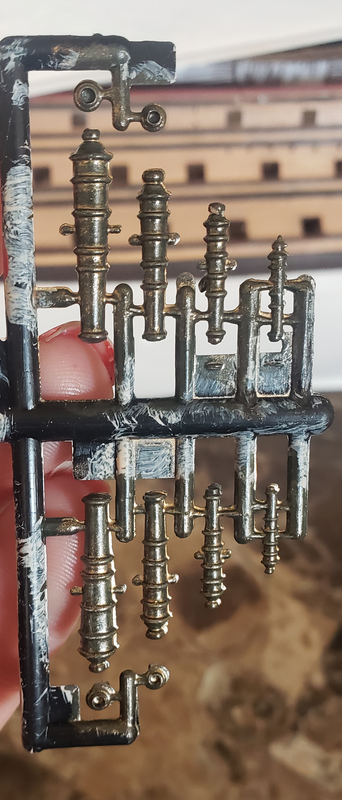

Alrighty, have another update! All the weathering is done, and cannons have been assembled (phew, that was tiresome)
Some of the pictures came out a little yellow, but I think they do the job well enough.
Cannons all finished up!
Time to get started on assembly now! I think it might take me a bit longer than I’m used to; the instructions are hard to follow and I think leave a little to be desired!

Wood tones and graining look very good. Nice work! EJ
