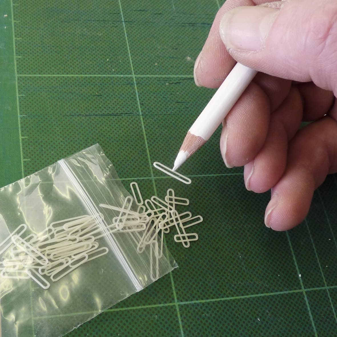

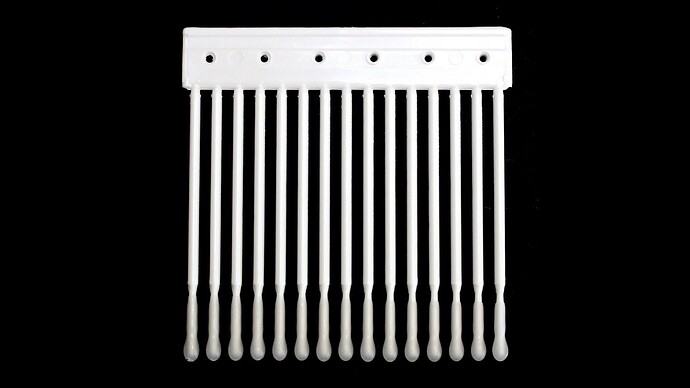

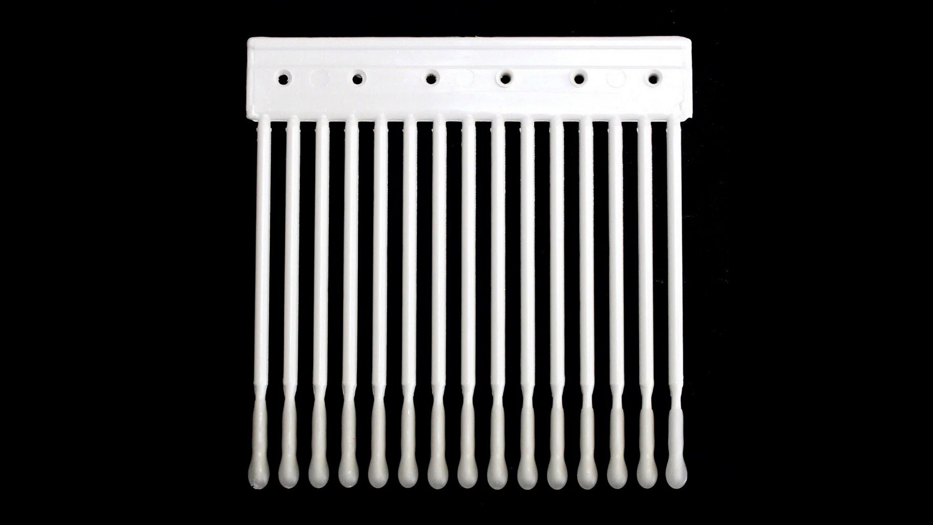

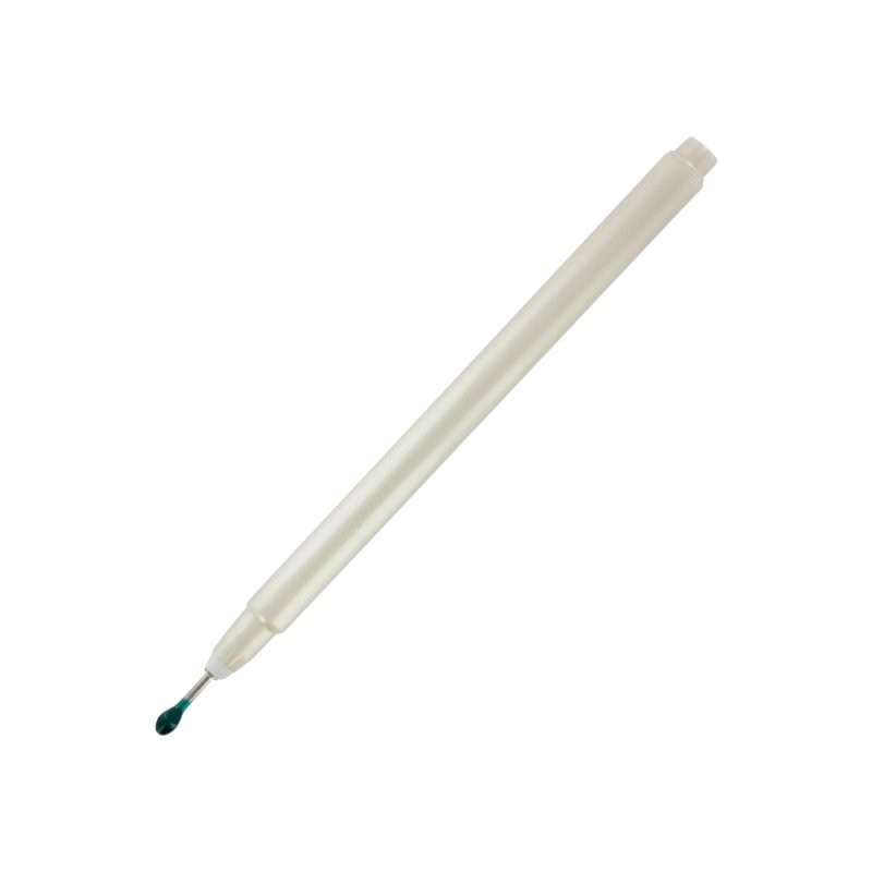

Concerning the sticky “sticks”, here are some examples and links you may try to acquire them:
or you may use this:
which you can find a bit anywhere online. It seems little, but it goes a long way since once a little dab is applied to, say, a blunt toothpick or dull pencil and used, one can then replace it in the original box ready to be used again.
28g seems indeed a very small amount but as I said, one only uses a very tiny amount of it at any time.
If you have more parts to pick up and paint, or simply place on a model, just prepare a few toothpicks with that material applied in droplets rounded between your fingers and then stick the other end in plasticine or any other holder to have them all ready,
Remember this is not a glue and therefore it might happen that the tiny parts may detach itself from it. If that happens, just apply a little bit more of the Tacky Wax and press the part firmly on it. And as stated before, once finished, even if stained with some paint, the material is still usable and therefore just put it back in its container ready for use the next time.
Remember to always firmly close the lid on the tiny container in order to maintain the tacky consistency of the wax.
I hope this will be of some help to you.
