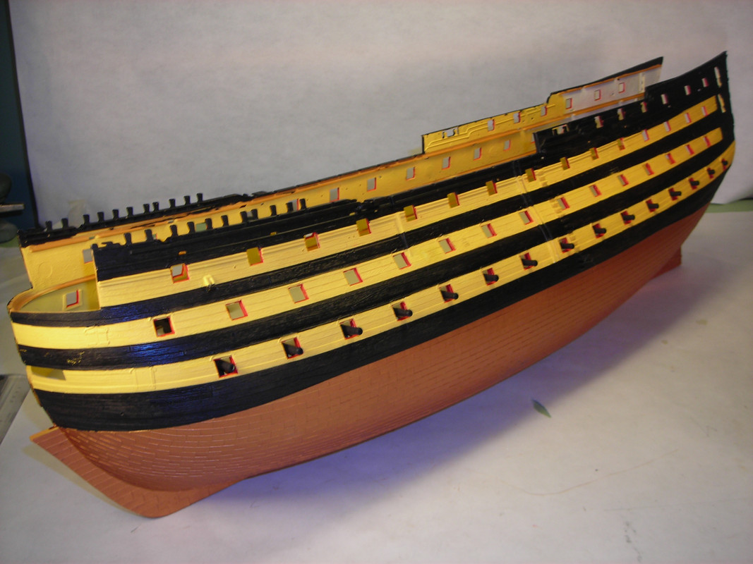

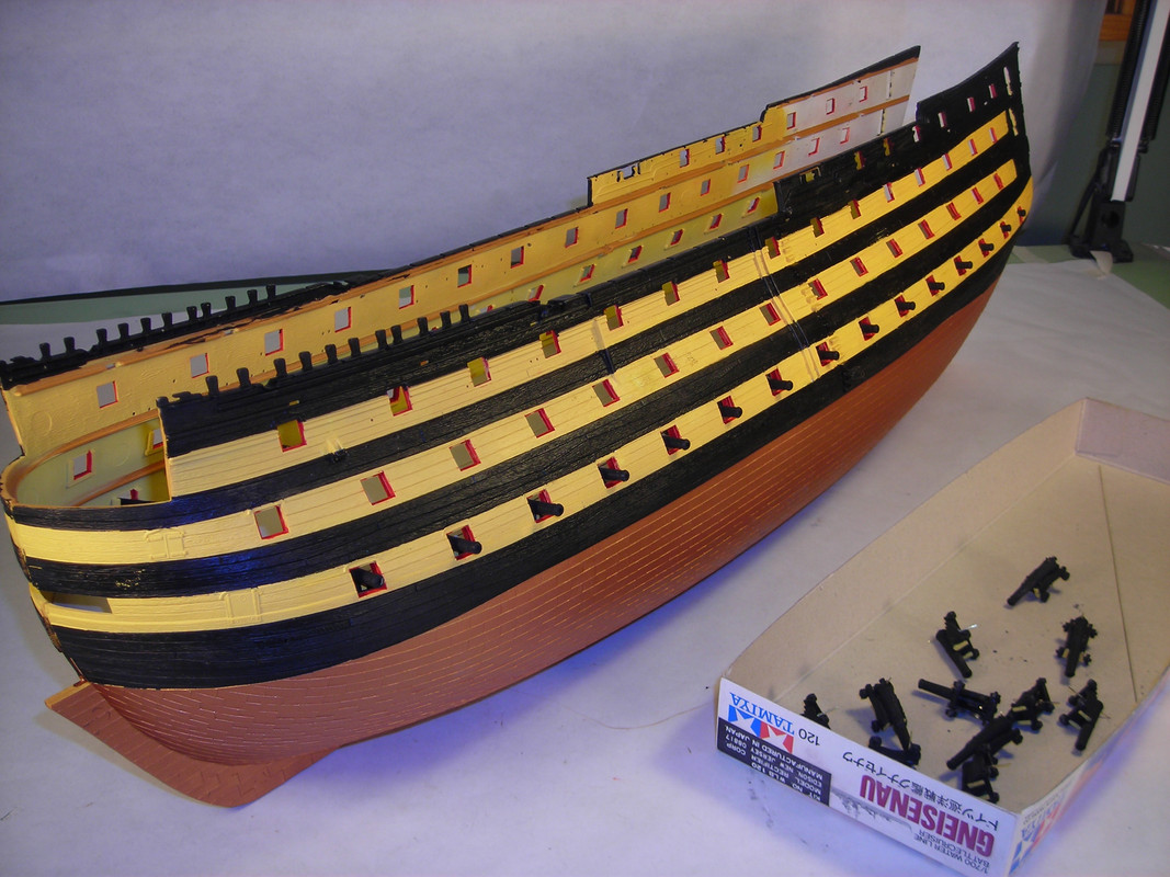

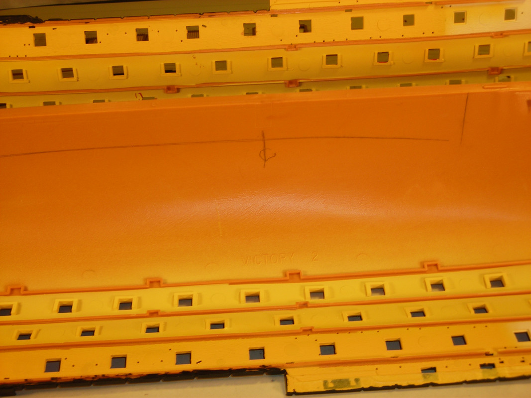

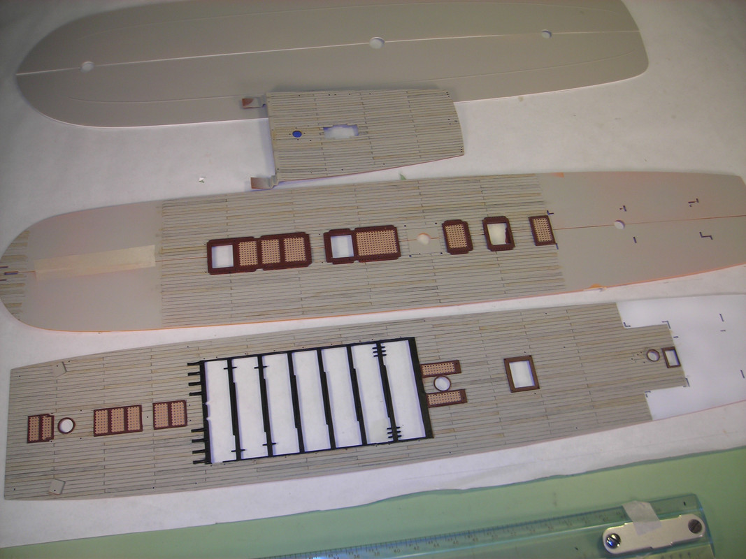

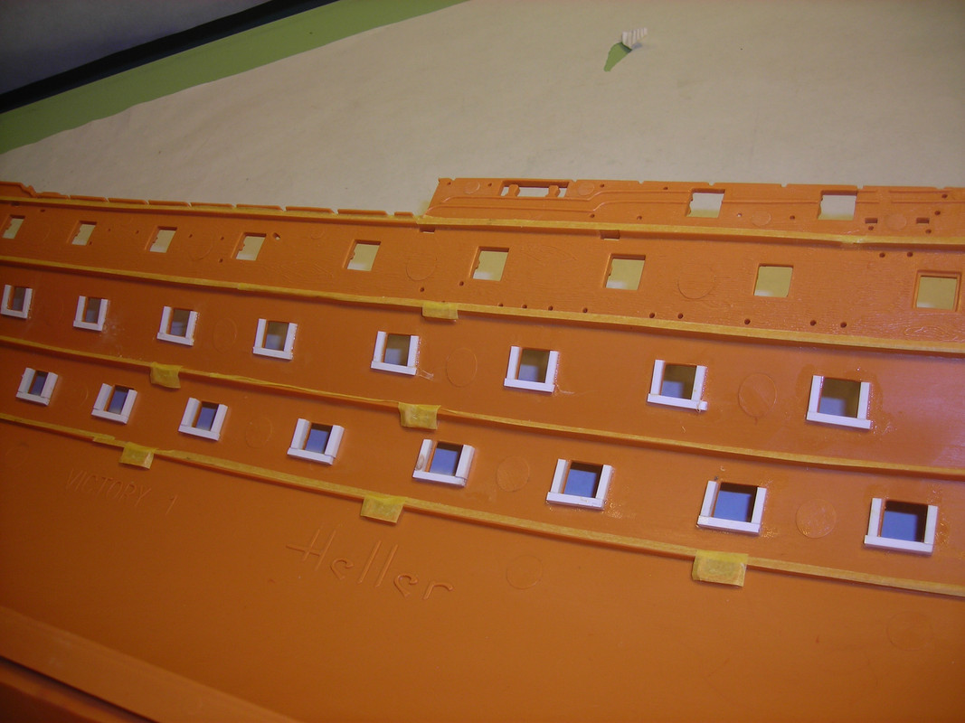

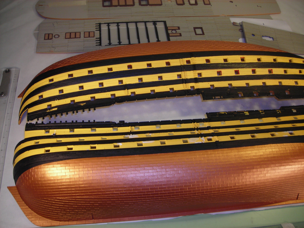

I started it in late October & it is going well. I masked all the glue ledges for the decks like I always do so the decks will glue to bare plastic. I decided to again paint my own deck like I have before. The wood decks are nice, but I think a gray painted deck is much more like the real Victory. Here are some first pictures. Nino, Jim , told me how toreset my camera just like he runs my computer for me.

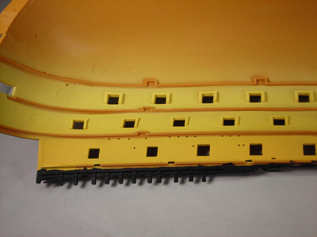

Masked ledges & thickened gunports.

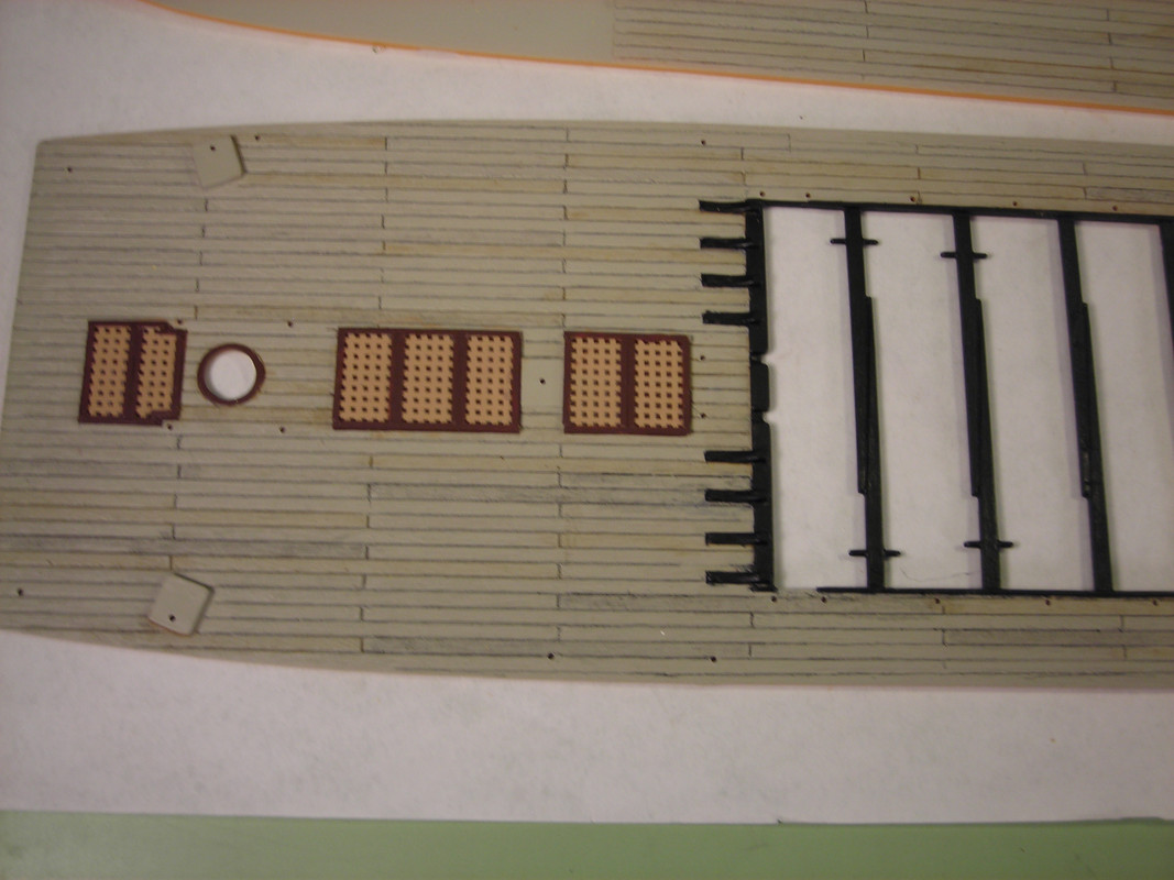

Tamiya Deck Tan, gray, with sharp pencil joints , than 1 coat of Dulcoat / gloss & then individual wash of very thin black & raw umber.

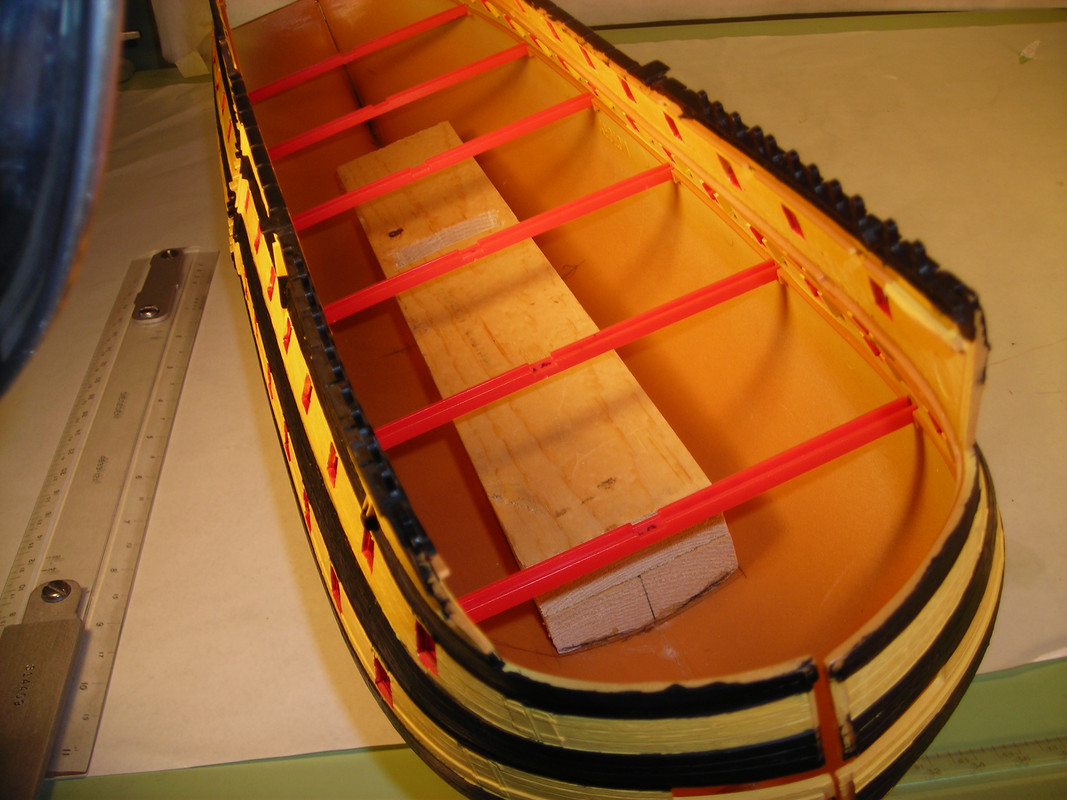

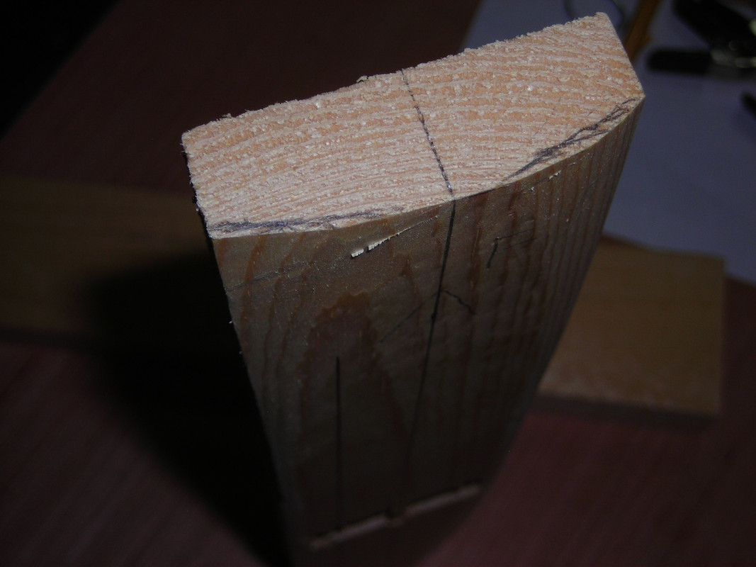

The last 2 pictures are of the 1x3 x12" 2 pieces I will glue in the hull bottom to screw into for my base. This is a big model & very easy to work on ( I haven’t rigged it yet),lots of parts, but nice to work on. I am ready to start cannons.

To both Steve’s , Mine does not even come close to what you both build. I have had trouble with getting my black hull stripe right. After I mask I always put a coat of clear gloss to seal them. I had to put 2 coats on the second one because the first on bled some.I have to go back & clean them both up. Everything else has worked fine.

fright (robert) & Flint ( My TV Pirate hero) Thanks for all the nice words. They make me feel good. Flint, I am not doing anywhere near the job you are. I always try to do as neat and clean a job as I can. I do sand, file & clean everything & I always wash with rubbing alcohol on all the model parts. It is quicker & I like it better than soap & water. I does dry way quicker.
I am using all Tamiya acrylic paint as I have had a lot of trouble with MM peeling under masking tape. It is good if you don’t have to mask. They also have some real good colors.

I have had some trouble with my masking over the yellow sides to paint the black. After I masked & burnished the tape, I put 1 coat of clear glosscoat to seal it after I painted & striped the first side it had bled a little. I put a second sealer coat on the other side & it was fine. You never know do you. Now I will glue it together & do cannons for a month. Thanks again.

Beautiful job on the decks using the the deck tan, pencils and wash to add the shading. You are giving Scale Decks some competition.

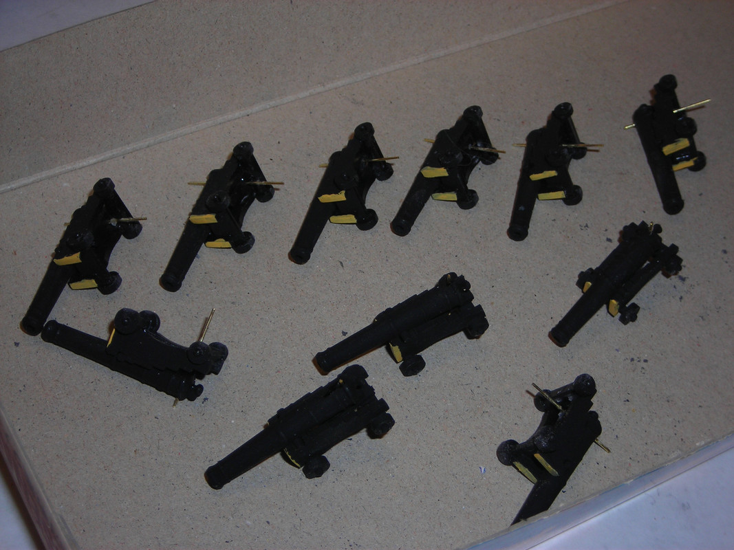

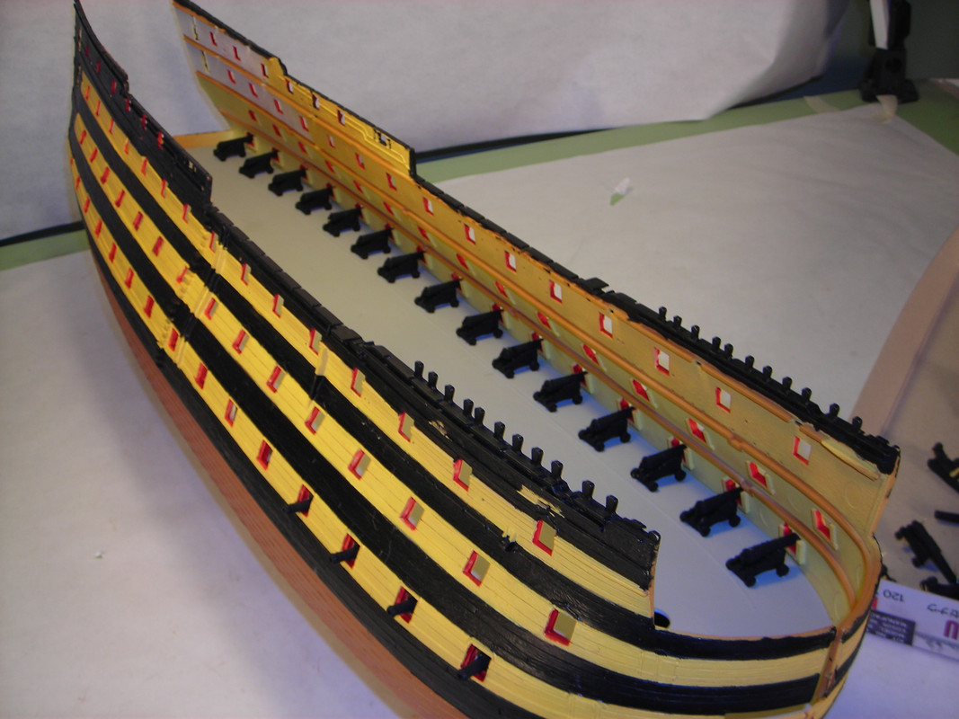

Jim, the only reason I have pictures on here is because of you, both for the camera & computer. I drove Mary 200 miles(round trip) to the hospital in Greenville SC for her final 2 tests. I worked on the Victory all day yesterday & glued the hull together & put the 2 big 1x3’s in & put the lower deck in. Then I seperated the cannons for size & will glue them today, part of them . There are 104 cannons with 7 pieces to each one. 728 pieces.
Mark, I haven’t done any window painting yet, Cannons first.
Mark, I will do my windows in yellow, along with the whole back. Then I will use glosscote over it to seal it & then,except for the large areas I will use Tempera black. When that is comletely covered & dry I will use damp Qtips to clean it off. & then seal the Tempera with dull/gloss cote mix.
I used Tempera red on all the gunports & will seal them with dullcote & touch up with a red marker. Beats trying to do it with red paint.

It really helps to make up a jig for all of those gun carriages. And a tackle box with a LOT of little compartments.
Bill, I just got your note on a jig. I looked close at it & am going down right now to finish seperating cannon parts, build a jig & put parts in a plastic tray box. I have a lot of boxes from my model RR stuff. Thanks, Gene

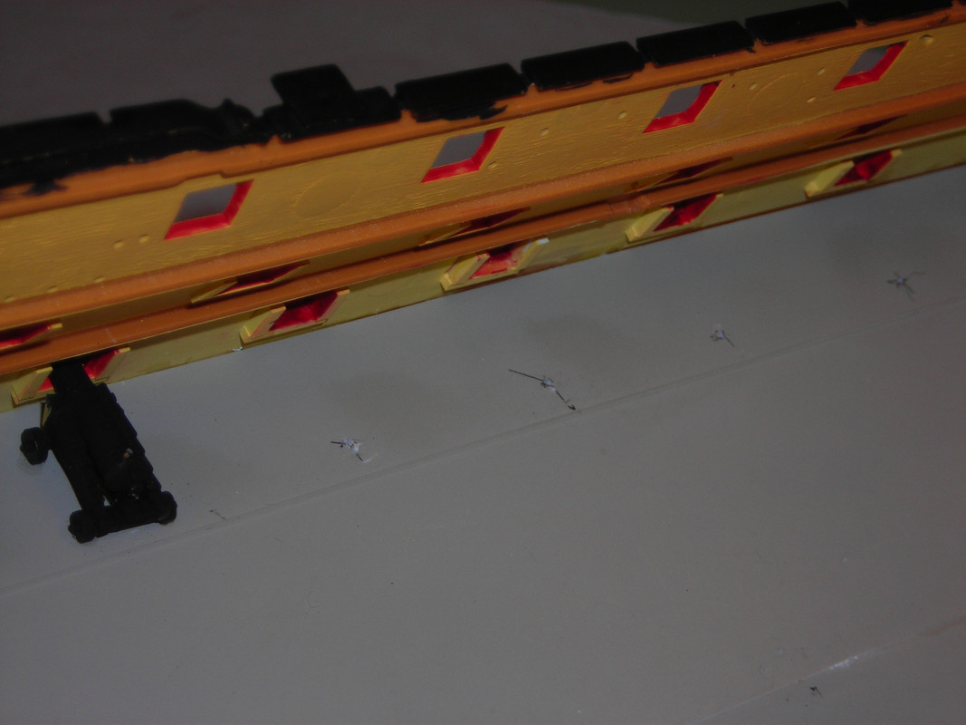

I just took new pictures of the hull together & thr first deck in with 30 cannons glued & wired in I drilled to the rear of the cannon & put a .020 brass wire in & drilled the deck in a premarked spot with a larger bit so I could find the hole easier. Then I flatened the wheels & used 560 white glue on the wheels & CA glue on the wire.
I only painted the front of the cannon yellow as that is all you can see.
