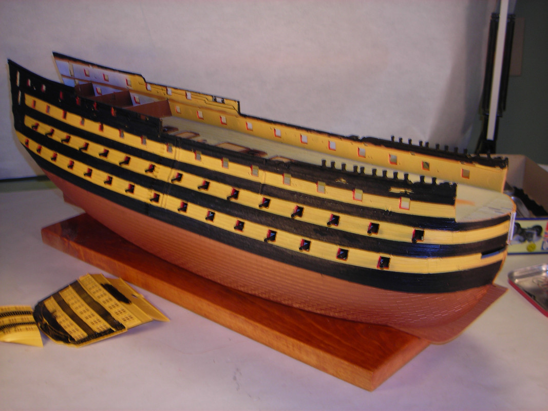

Thanks GM, but I already did it & cut a little off a couple beams & then glued them back on & fooled with it forever. Which one was bad? I had to take a single edge blade & scrape about 1/32 off the right side & front curve. The decks are a tough fit in all cases, but they fit good. I buy single edge blades at Lowes for $8 a hundred. I use a lot of them.
I put glued beams under the next deck because it is a tight fit & I wanted the center line to have a good fit because it shows. I have already prefit it. I have the cannons for the 2nd low deck ready to paint & again I will paint yellow just the front of the carriage.
dafi, Thanks & you are one of the really great ship model builders. Your work is perfect & inspiring . Makes me want to do better. Maybe I inspire others to know they can build models up to 100 years old. That is my aim. Right now I am working on 90.
warshipguy, I thank you everytime I sit down to work on this Victory. It has been the most fun of all my ships. I have 60 cannons glued & wired in now & am going to put the second from top deck in today. Now I can have a lot of fun with all the finished cannons & deck details.

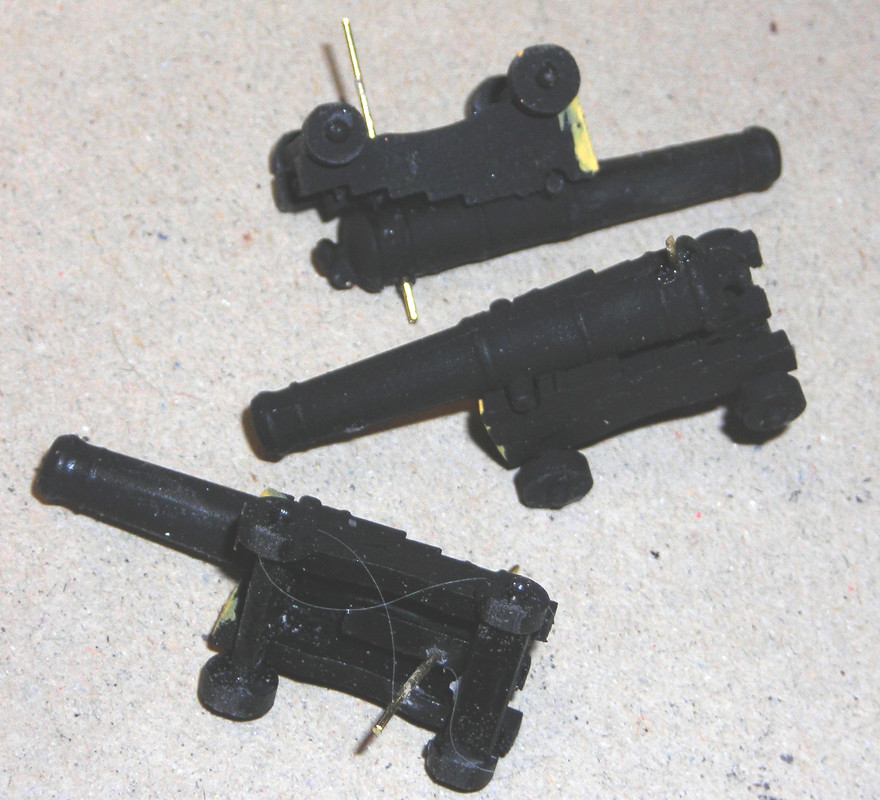

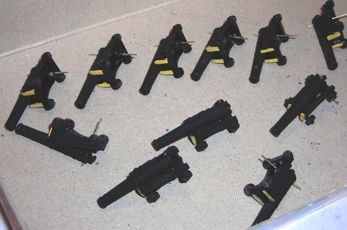

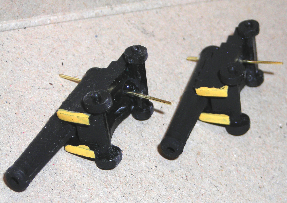

On the finished cannons, I will wire them from the bottom with only a hole up from the bottom. The wire has worked great & It will reall hold them in better.My pictures were dark & I will try to make them lighter.
Nino edited the cannon picture so I will run them again, a lot more clear.
For anyone wanting a firm glueing on your cannon this is woth doing. I just drilled thru from the top on the hidden cannons & painted the barrel black & yellow front only as that is all you see. For the detailed cannons I will drill up from the bottom thru the wedge & into the bottom only of the cannon & the wire won’t show.It only take a short time to make sure your cannons don’t break loose in a fixed place. I put 560 white glue on all 4 flattened wheels & CA glue on the wire. I also drilled a larger hole in the deck that was easier to find.

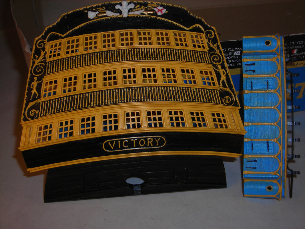

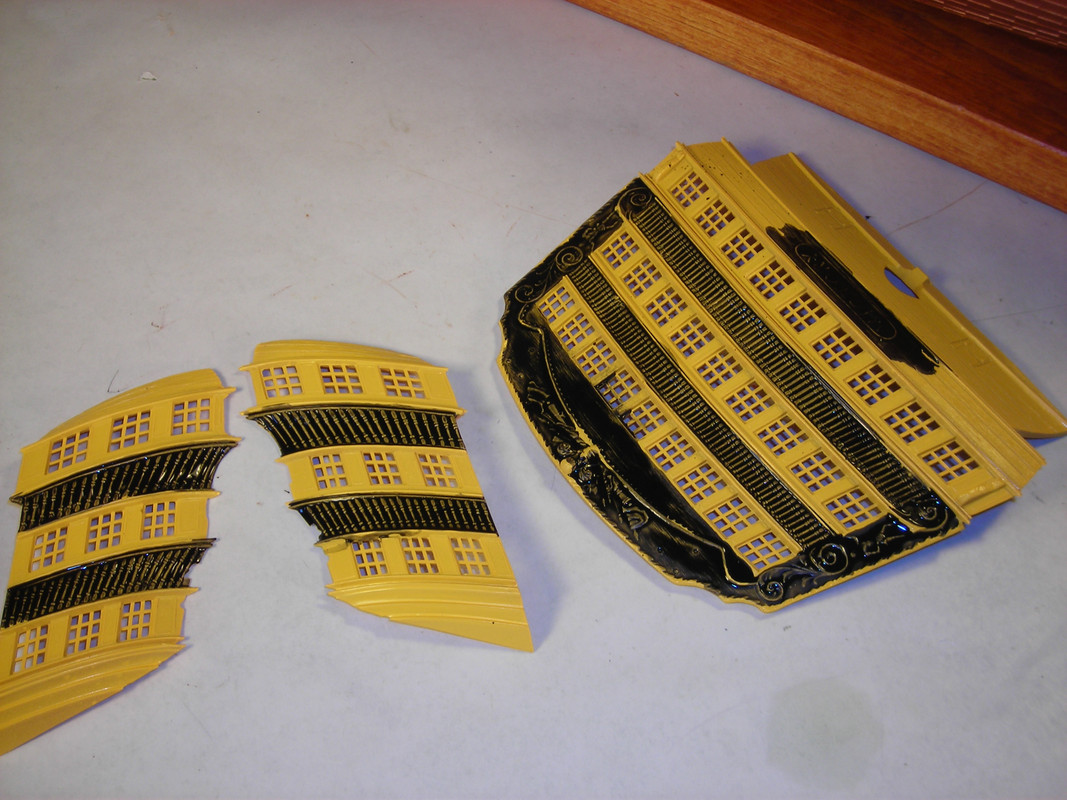

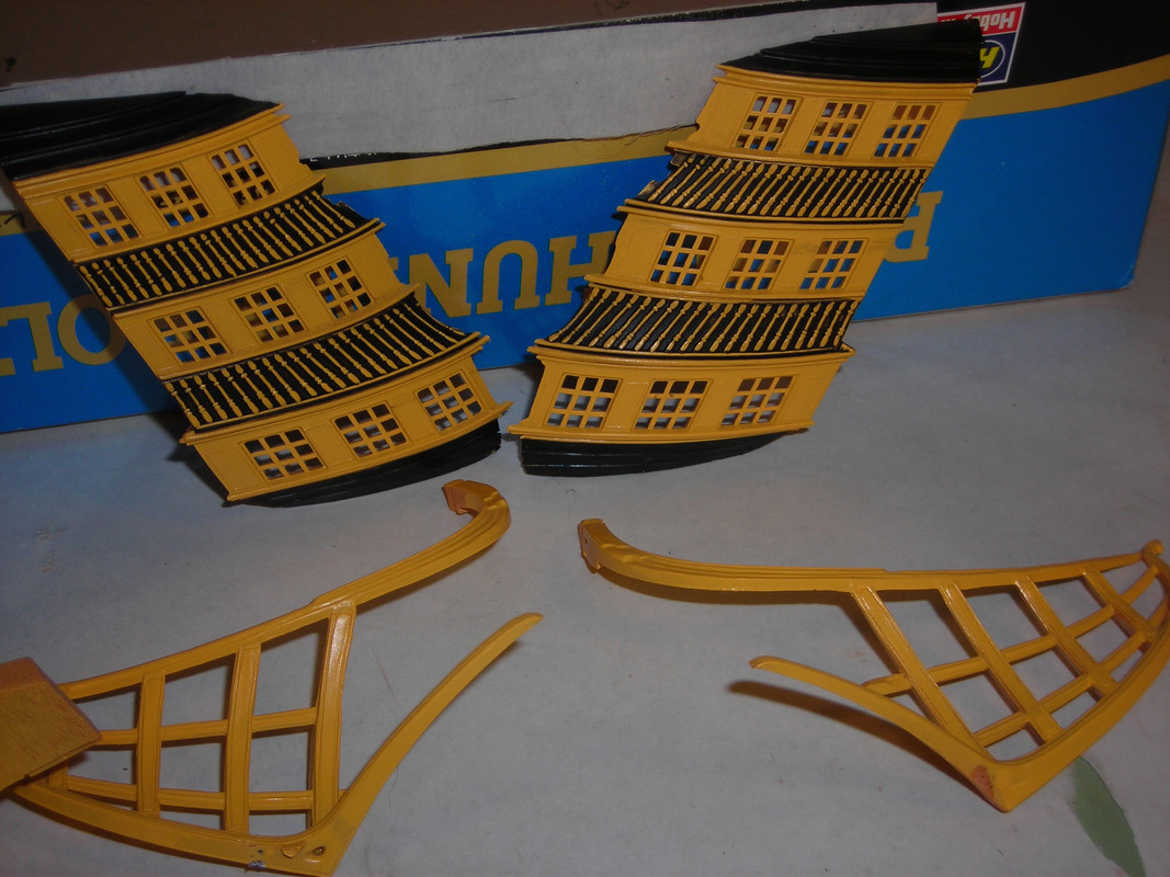

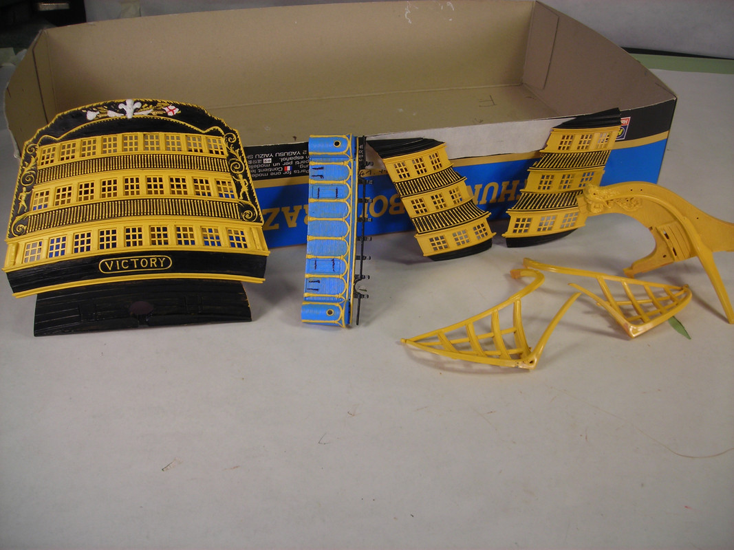

Here are my latest Victory pictures. I had a lot of fun doing this & it turned out real well. These are my Tamiya mix yellow painted rear window sections. I sprayed MM clear Gloss over the yellow to before I put the Tempera water based paint on them. When it was good & dry I wiped it off with a damp Qtip & soft damp rag. The first picture is before & the second is after with a mix of dullcoat & gloss over to seal the Tempera. I used Tamiya black over the bigger parts.
I have all my guns painted & am now drilling them for the piece of wire Iuse to fasten them to the deck. Anything I can never get to I want to stay put.
I still have touch up & I will cut black decals to finsh the window sections. With my shaky right hand I need all the help I can get & decals & Tempera are a big help.
On the blue arched front section I used a Tamiya mixed blue for the archs & my shaky hand to wield the fine paint brush. On the small places I could not paint , I mixed a Tempera blue to match my Tamiya. I painted the top blue parts with that & then wiped them off with damp Qtips again & sealed it with a lacquer spray. Worked real good & I outsmarted the shaky hand. Spooks me because I will be 88 next month. I still love building models & this gift from warshipguy has been a real winner. Thanks Bill.

Robert & Steve, thats the advantage of using Tempera the way I do. It does all the close work. I did do the blue arch’s by hand, the large easy ones on the bottom. The small ones I did with blobbing Tempera on them & wiping it off. You have to play with it a bit & touch up, but it is super. When I wiped off those little yellow thing with a million black places between it amazed me how the Qtip took just the right amount off.
I used Tempera on all my subs to blacken the limber holes & other detail. I even mixed up a rust mixtue & did that too. The nice thing about it is if you don’t like it wash or wipe it right off. That is untill you dull or gloss it. If I could teach my stupid left hand to do something as it doesn’t shake, but it is too dumb.
On the blue archs in front, I used a mixed Tamiya on the bottom & mixed some Tempera on the top to do the hard parts.I don’t like to use Tempera in a large area. It has never given me trouble in small areas.

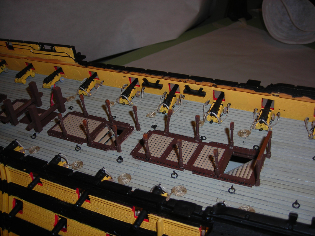

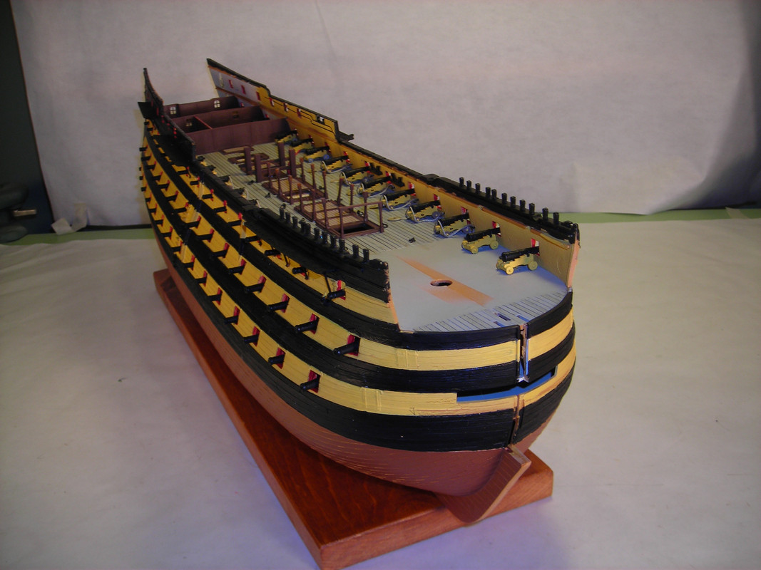

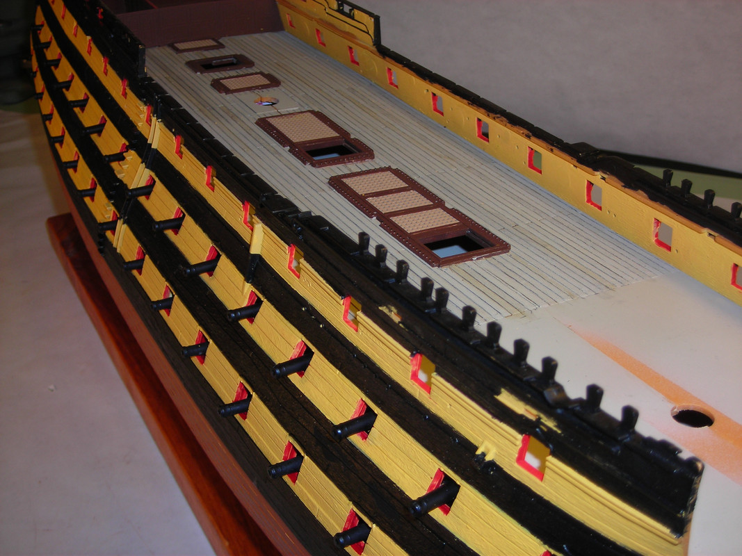

I am up to the top deck & now I will put more timeon small details. I didn’t do the 2nd deck guns with all the rigging because they are hard to see with the boats on top. Here are a few pictures.
I am just putting a semi gloss finish on the cannons. I have to drill them all fot the glue down wire & paint the wheels.

Nice rigging on the Cannon. I think I can duplicate it once I get a good sized Warship with sails underway. Your pictures will make it easy for me to COPY… my version of the Highest form of Flattery.
