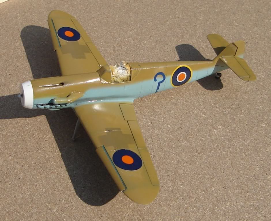

OK, slight messup here!
I put the decals on as per normal , just water no microset.
Brushed on some Microsol and nothing hapened atall within 30 min or so. I brushed on some more, again nothing except the future next to the one wing roundal has become soft and desolved ARGGG!!!
You can see it just next to the roundal. Also the carrierfilm is still clearly visable and very far from being desolved :frowning:
I will have to see if I can repair the future, but looking at this project I am getting very dissheatred now, almost everything seems to be going wrong with it !
My freehand ? also looks like the dog’s breakfast.
I tried a few other decals from different kits ,some old, some new and they didn’t really react to the sol as I expected. Some very faint shrivling arround the edge of one and nothing on orhets, even after 2-3 aplications. The carrierfilm is still there and the decals do not really conform any better to pannel detail than when aplied without it.

Your mileage may vary. Some decals respond well to MicroSol, some don’t. Some, like the older Italeri decals seem totally inert. MicroSol doesn’t usually go off -I have a bottle which dates back to the early 80’s which still works ok.
If you are getting a whitish haze on the Futured areas, another hit with Future will fix it. :slight_smile:
If you work with a lot of Japanese-made kits, you may wish to look at the Gunze products, Mr Mark Softer and Mr Mark Setter. Mr Mark Softer seems a little stronger than MicroSol and Mr Mark Setter contains a mild adhesive which helps to suck the decals down, especially with difficult decals which have insufficient glue (Think Airfix/Heller). Mr Mark Setter can also be used directly on flat painted surfaces to prevent silvering without the need of a gloss coat. (however, it does leave a glossy area where it’s been applied, which will need to be flat-coated afterwards).
Contrary(ish) to Phils statement, I recently replaced an old bottle of micro-sol, just as a test, I used both bottles on different decals (same sheet, same model) and noticed a small difference between the two. The old one still worked, but not as good as the new one.
On decals that are on a completely flat surface with no detail/panel line, (such as that wing roundel), I wouldn’t even bother with micro-sol. I haven;t ever seen carrier film “disappear”…micro-sol just softens the decal, allowing it to snuggle down over detail and/or into panel lines…unless the decals are from Academy or Tamiya…not much help for those! I’ve soaked some decals at least a dozen times, and they still needed help, by sliding a finger nail over them, to push them down into a panel line. Most of the decals I have used don’t really wrinkle up much at all. I worry about the one that wrinkle a lot…many time, a wrinkle or two stays[:(].

Sounds like the Future was not fully cured. I only use Solvaset. This stuff melts down any decal.
It might be the case with the future, I have not used it before and t was about 24 hours old in medium temps.
I am still tearning how to use all these wierd and wonderfull stuff LOL!
I have tried to brush on some future to the wingtip and will just press on with this build and see it as a learning experience.
Theuns
It seems that I might have just been able to salvage the situation - barely!
The eaten away area and other decals I brushed future onto and left to dry.
Then I sanded with some 2000 paper and then brushed on future leaving it to level out.
It looks like the problem with the future atleast has been rectified for now.
I will post pix on the 109 GB thread this week.
Next time I will leave the future atleast 3 days before doing any decaling with microsolLOL!
Theuns
That was probably not enough time for curing. As I posted before, I wait at least 2 says if not more just to be safe.
Most likely the problem yes. It felt cured to the toutch so I assumed it was OK.
Does future become more “resistant” /harder as it cures more? I would have thought that if it is dry it has reached max “hardness” This is all new to me.
Theuns
Yes, the more you let it cure the harder and more resistant to solvets it will become. The only things that will dissolve cured Future is Future itself or ammonia. Laquer thinner may attack it too.
