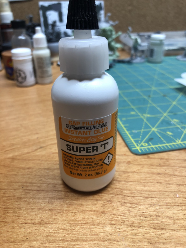

I was trying to glue an arm to the torso of a resin figure using my newly open bottle of CA.I might as well spit on it for all good the glue did,it does a good job of sticking my fingers together or to a part.
So,I couldn’t locate an old thread on good super glue types that you find effective.What brands and types do you recommend for effectiveness and longevity in the bottle
Thanks
