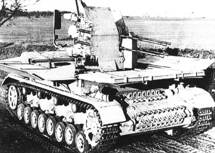

Photo’s of that version are limited, but then so are photo’s of the 3.7cm version. These are the most well known ones that appear in most books.
As far as I know the upper part is the same as the 3.7cm gun. But this version was only on the older hull, with the 4 top rollers.

There is yet another Pz IV Flak version, the Ostwind II. That never left the drawing board, but I would like to add that to complete the Pz IV Flak collection.
Tony & Bish: FYI - the Moebelwagen with the Vierling gun was a one-of - it never went into production and was dismantled and rebuilt with the 3,7cm gun.
