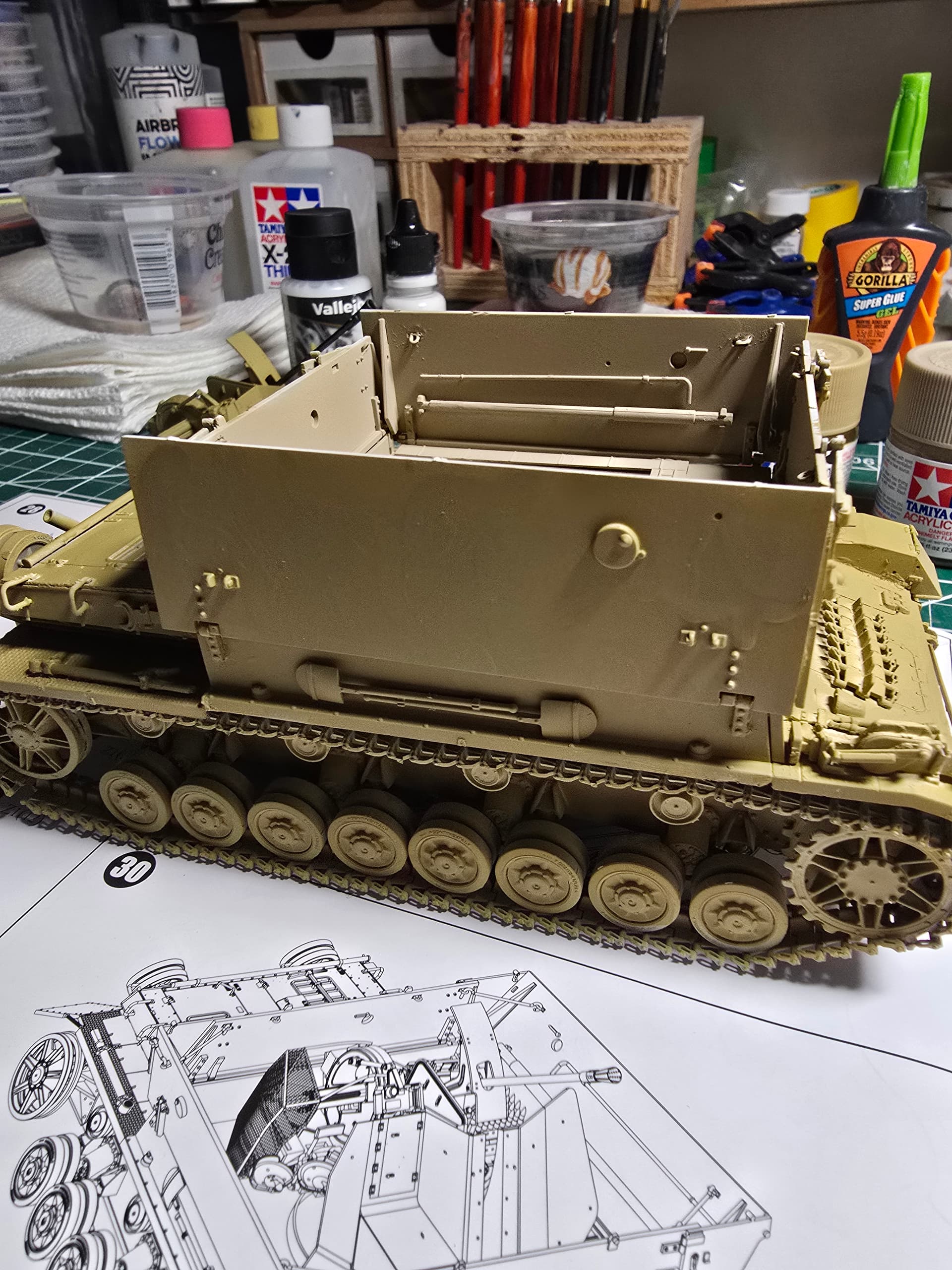

I need help and advise on how to get the camouflage close to what is on the box. I had some advice to start with dark colors first. So i repainted the model. I’m not good with camouflage, i rarely try to do it. Any help will be greatly appreciated.

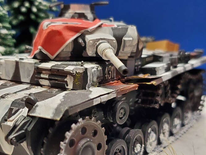

When I did this winter white wash on a GREY Pz III in 1941. I went with rough white washed stripes as would have been applied in the field to break up the tank silhouette.
