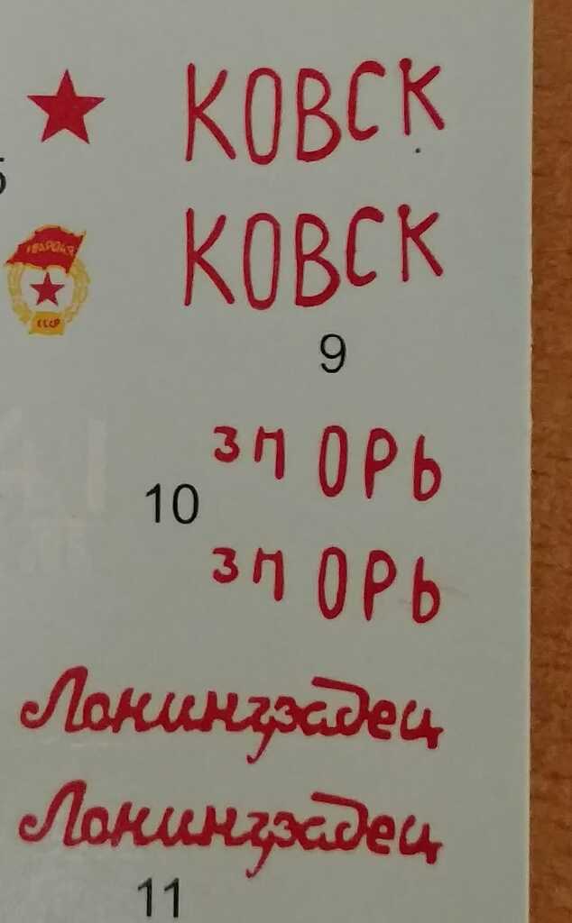

Unfortunately the Trumpeter kits don’t offer too much provenance of the vehicle being represented by the model, but some eagle-eyed operators found this photo of a T-34/76 lost in a minefield in the Battle of Kursk (July 1943).
From the same forum, it was also suggested that the inscription on the turret wrapped around it, rather than being symmetrical unit markings like you’d expect from other nations of the era. Best guess is that it might say something like “For Gorky’s suffering” - “За горьковск ие страдания”
We may… and I stress may… look to handpaint the turret to represent the original intent out of respect for the original occupants of this vehicle, but not at the expense of achieving our core goals that will allow us to move onto the next project with confidence of outcome

We may … and I stress may … look to handpaint the turret to represent the original intent out of respect for the original occupants of this vehicle, but not at the expense of achieving our core goals that will allow us to move onto the next project with confidence of outcome
With a little help from good-ol’ Grok to create what the wraparound text would look like, I am emboldened to do this the hard way…
Alternatively has anyone had success printing your own decals? Seems like a thing
