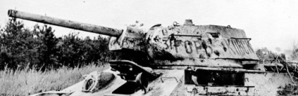

One of the sidesquests associated with this project was to come up with a more realistic turret inscription than what’s provided in the kit - Inspired by the below photograph, the “За горь ковск” inscription has been mass-produced by Trumpeter across a range of Soviet kits but incorrectly interpreted as symmetrical unit markings. According to some Russian-speakers on another forum, the inscription doesn’t make sense on its own so it’s more likely that this was an inscription on the turret made by the crew which wrapped the full circumference - This is what we want to replicate, preferably via custom decal

The vehicle that this tank is based off is believed to have been knocked out during Operation Kutuzov, which was the Soviet counter-attack after the German assault on Kursk, Operation Citadel, had stalled in mid-July 1943. Being a Russian summer, a heavy application of mud doesn’t feel appropriate for the time or place in this case.
