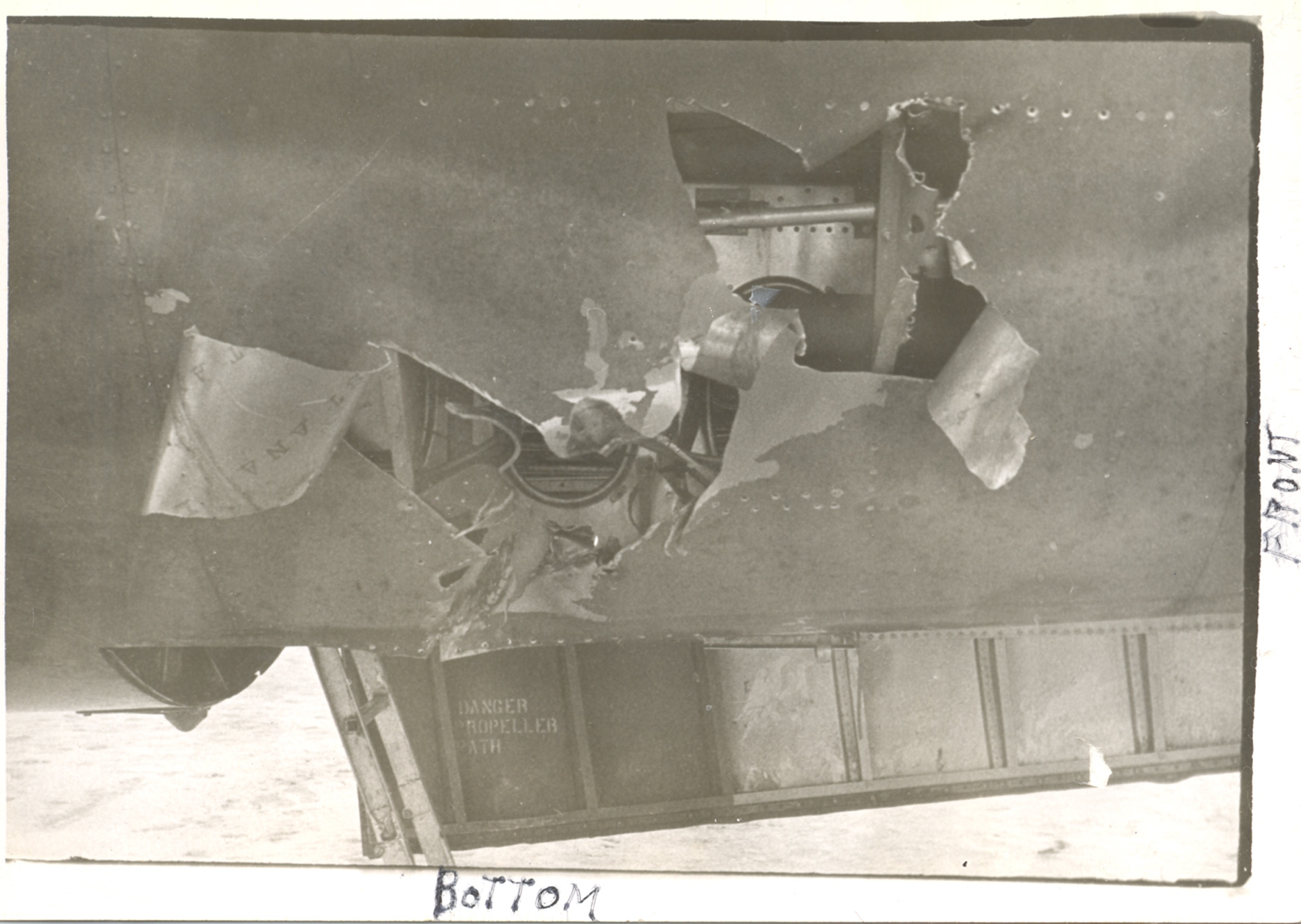

Yes, and the interior of the USAF Museum’s Marauder is Interior Green, which from my research on B-26s shows was way off base.
And just like the MAPS original B-26 which has the interior slathered in Interior Green, when they were in NMF as it shows in this photo of flak damage on a mission to Kiska in 1942:
http://www.nps.gov/media/photo/gallery.htm?id=BC6A54C6-1DD8-B71C-07F587380CF50D7C http://www.nps.gov/common/uploads/photogallery/akr/park/aleu/BC6AE8AE-1DD8-B71C-07C796332FECF7FB/BC6AE8AE-1DD8-B71C-07C796332FECF7FB.jpg A better link, I hope. The photo shows the original ALCOA ink stamping on the aluminum sheeting on the interior. And Stik, notice the red paint on the gear door showing the propeller safety zone as you did on your B-26B.
Great photo there… I guess my main point is not to rely on museum aircraft for accurate historical reference. Unless it is somewher like the Smithsonian where aircraft are either preserved “as is” when they were received such as Flak Bait or X-1 Glamorous Glennis, or are meticulously restored back to original colors as closely as possible. I have noticed that the USAF Museum does not always adhere to those standards. It will often restore an aircraft into the guise of another.
The AF has changed to a preservation mode from a “restoration” mode as seen with their newest examples like the SR-71 where the cockpit shows all the real world use scrapes and scratches in the original paint. The B-24D has the cockpit sprayed in interior green but then they stopped as the Bombay and beyond is in original yellow zinc chromate.
