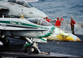

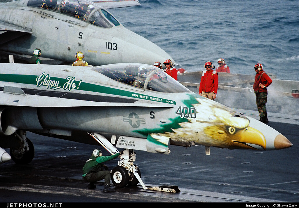

The VFA-195 CAG bird had similar artwork to what you are describing.
That’s what I immediately thought of. This Monogram boxing comes with the decals.
You can see the distortion:
