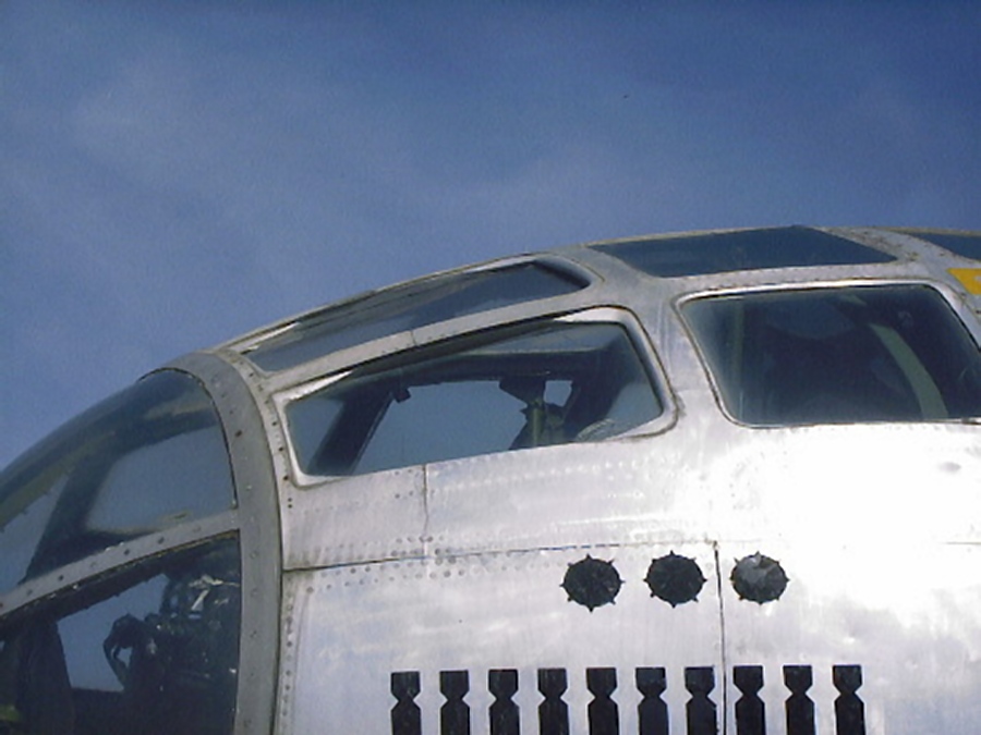

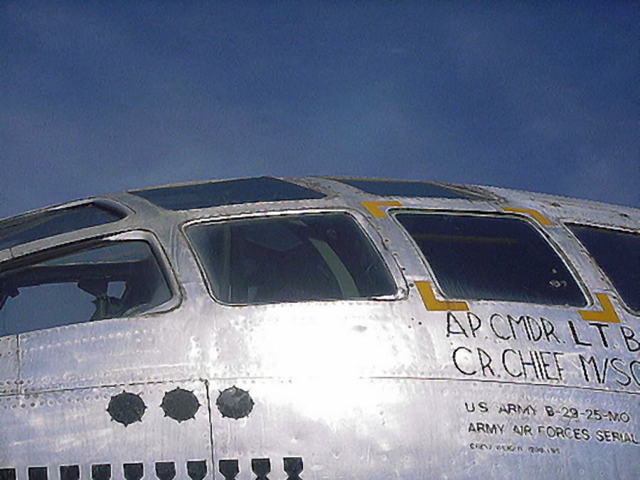

Here are some photos, the cockpit areas are of the B-29 at Travis AFB, to show the sealant, and the flat panes in many of the frames. The other photo is a color photo of B-29’s in WW II, I believe, which has nice tonality in the metal skin.
John: thanks for the photos, they are helpful. The color photo of the 4 aircraft in flight is uncanny; it is the same group that my friend served in (9th Bombardment Group), with the circle X on the tail. From the tail numbers it looks like these were 5th Squadron, while he was in 1st Squadron. The photos help a lot.

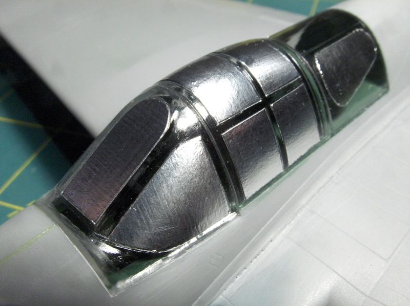

one of my favorite masks for that type of "glass’ is Bare Metal Foil. A bit more expensive but it’s thinness allows the shape of the frame to show through very well making it easy to cut the excess away with a new #11 blade.
thanks, this is perfect. Just what I was looking for.
