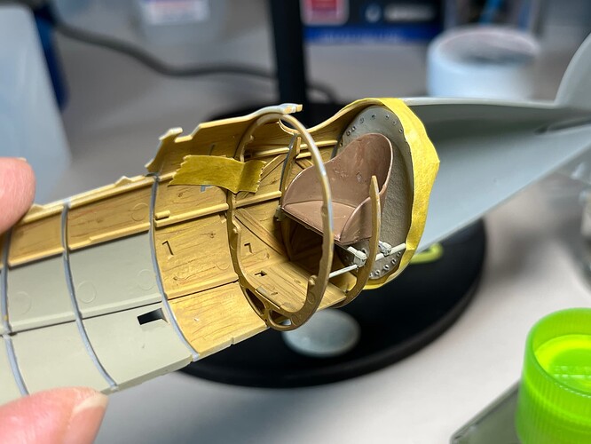

Getting started… pausing for a break to locate page 5 of the instructions. My kit is secondhand and did not come with the instructions. I have been able to find them online, but the PDF file I downloaded omitted page 5 (found it on the WNW website, though).
Previous builders have indicated that the fit of pieces within the fuselage is so exact that even a layer of paint will make a difference. I’m trying to manage that with some masking before I start applying paint. The page 5 that I am missing from the instructions gives guidance for the interior painting.

That’s a good start, Molly. The masking is a pain but it will help. The interiors on these kits are fabulous. And very different from, say, a Mustang where “everything” is green. The WW1 birds seemed to have everything left in it’s native material color. Makes for a lot of variety…

Today’s progress - added an orange-yellow-tinted clear coat to the fuselage interior, applied a clear coat to some small pieces, applied tiny decals and placed the cockpit inside the fuselage to test the fit.
It was a little tense in the Flugzeugwerke today. No fewer than four times I dropped a tiny piece on the floor (carpet monster) but was really, really lucky and found each one. I had to walk away from it for a while after one of those fumbles so I could restore my patience. I may have said a few bad words.
I meant to add some Tamiya panel line accents, but forgot. I can still do this when I go back to it since I have more to do inside the fuselage.
Testing fit before applying yellow-orange clear coat:
After the yellow-orange clear coat. I was happy with this.
Applying some decals on the smaller parts
Pilot’s seat and other parts of the cockpit in place in the fuselage, testing for fit. It’s snug, but I think it will be okay.

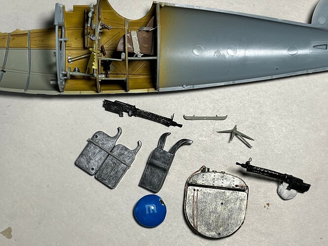

Today’s progress -
“Step 1” is the completion of the cockpit, shown in place here.
Starting on some details for Step 2 and the Spandau machine guns. The machine gun parts are so fragile and were very fiddly. Pity the poor pilot who will try to shoot straight from these! Also shown are containers for empty cartridge belts, fuel tank (with some added detail suggested by one builder), foot pedal and mount with M&M for scale.
