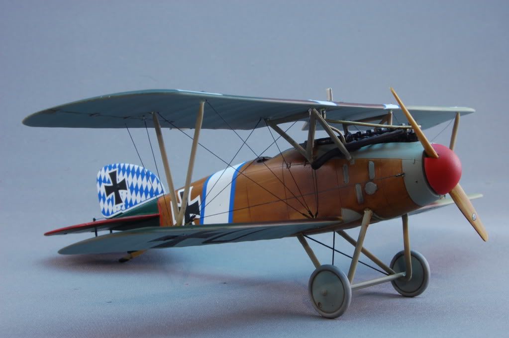

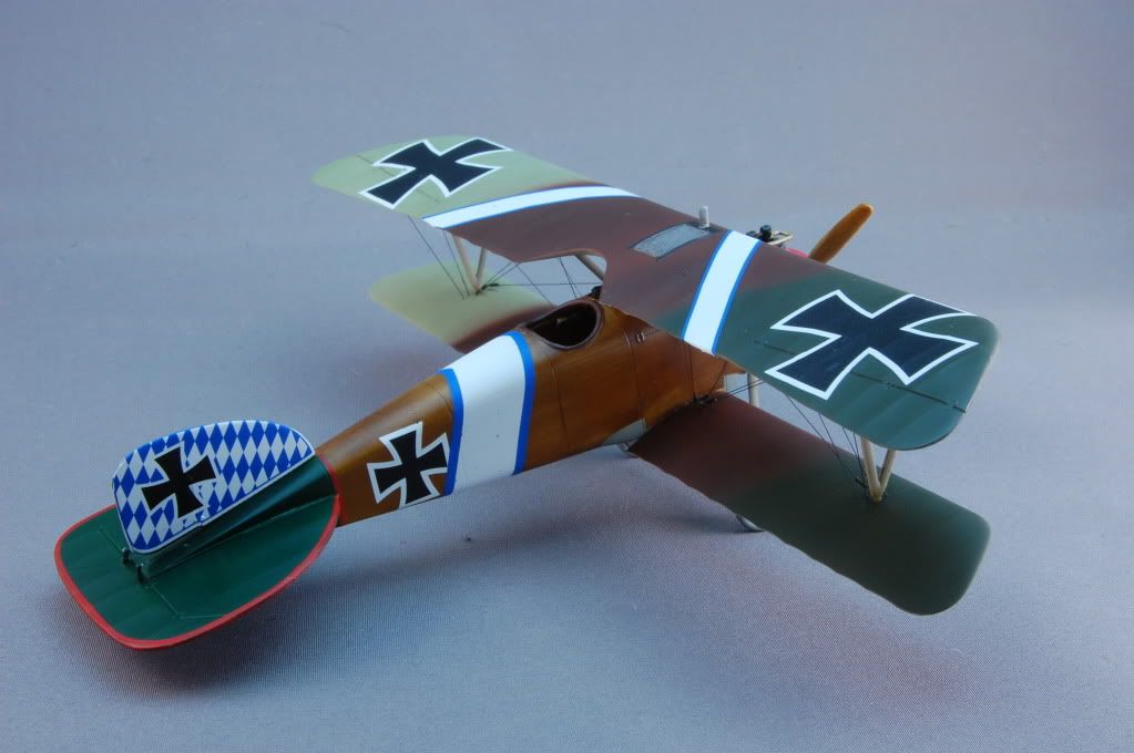

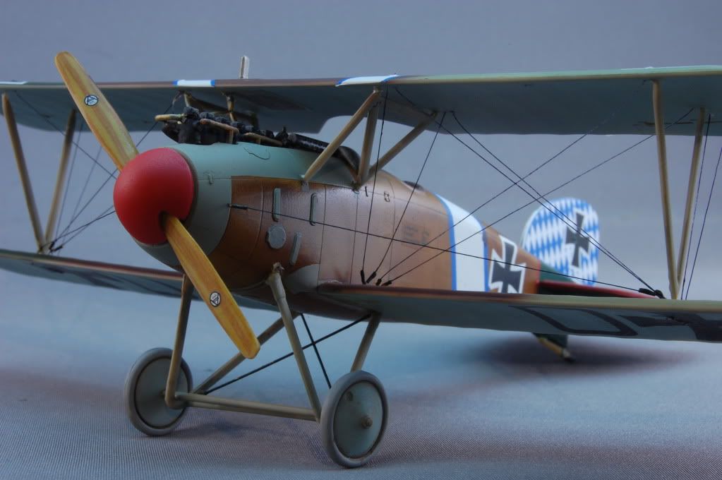

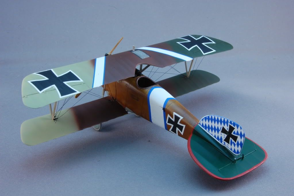

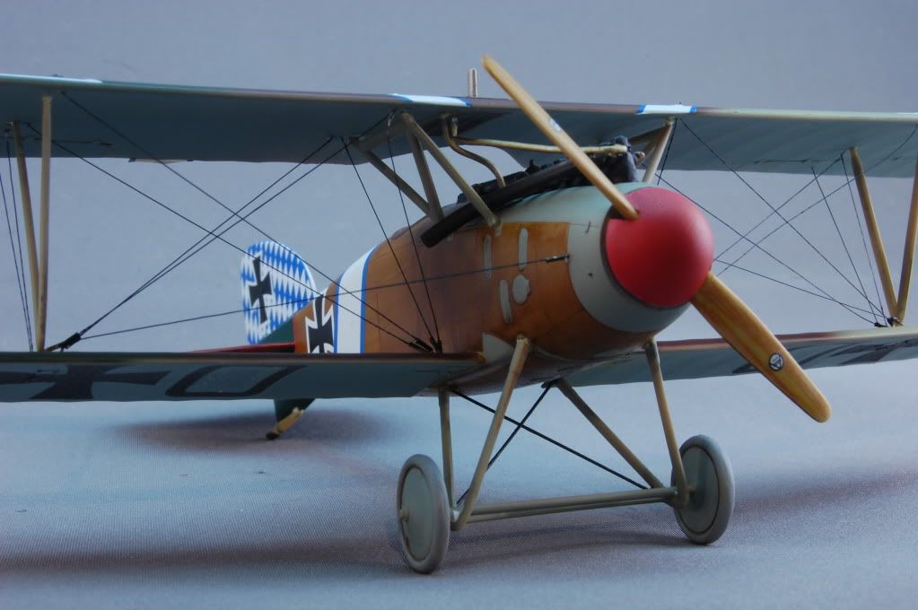

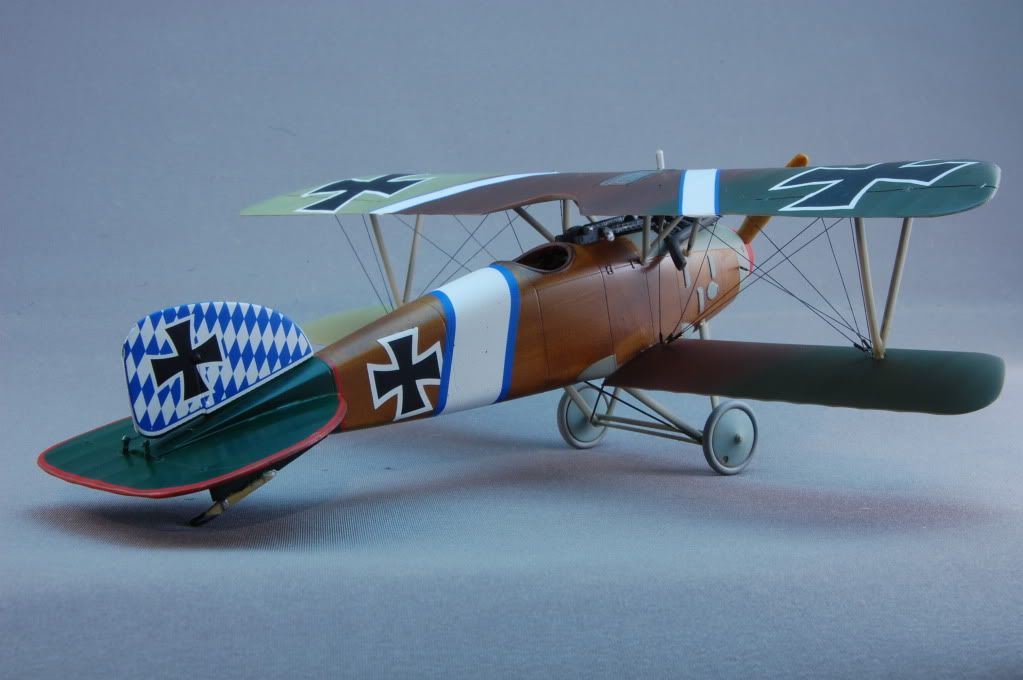

Here’s a few pics of my second bi-plane build. It’s the Eduard 1/48 scale Albatros D.III Weekend Edition. I used the kit decals to model a Jasta 5 bird from 1917. The decals work beautifully, but stick very well! Too well, as I screwed up the fuselage band. Luckily, it’s under the fuselage, so it doesn’t show up. If you use Eduard’s decals, use plenty of water on the surface of the model, and get it as close to possible to the exact location before sliding it off of it’s backing paper!
I painted it with a combination of Tamiya, and Pollyscale paints. I also used burnt umber oil paint to replicate the wood grain on the fuselage. It’s a bit too dark for an Albatros, but I think it looks pretty good for a first try.
I added solder to make the radiator pipes, and used a combination of Bob’s Buckles, and Lion Roar 0.5 MM brass tubing to make turnbuckles for the rigging. As for the rigging, I used nylon sewing thread colored with a Sharpie.
I am REALLY enjoying these Eduard bi-plane kits! They are quite a change from my usual WWII armour models. Next up…Eduard’s Fokker D.VII. Thanks for looking, and comments welcome.
