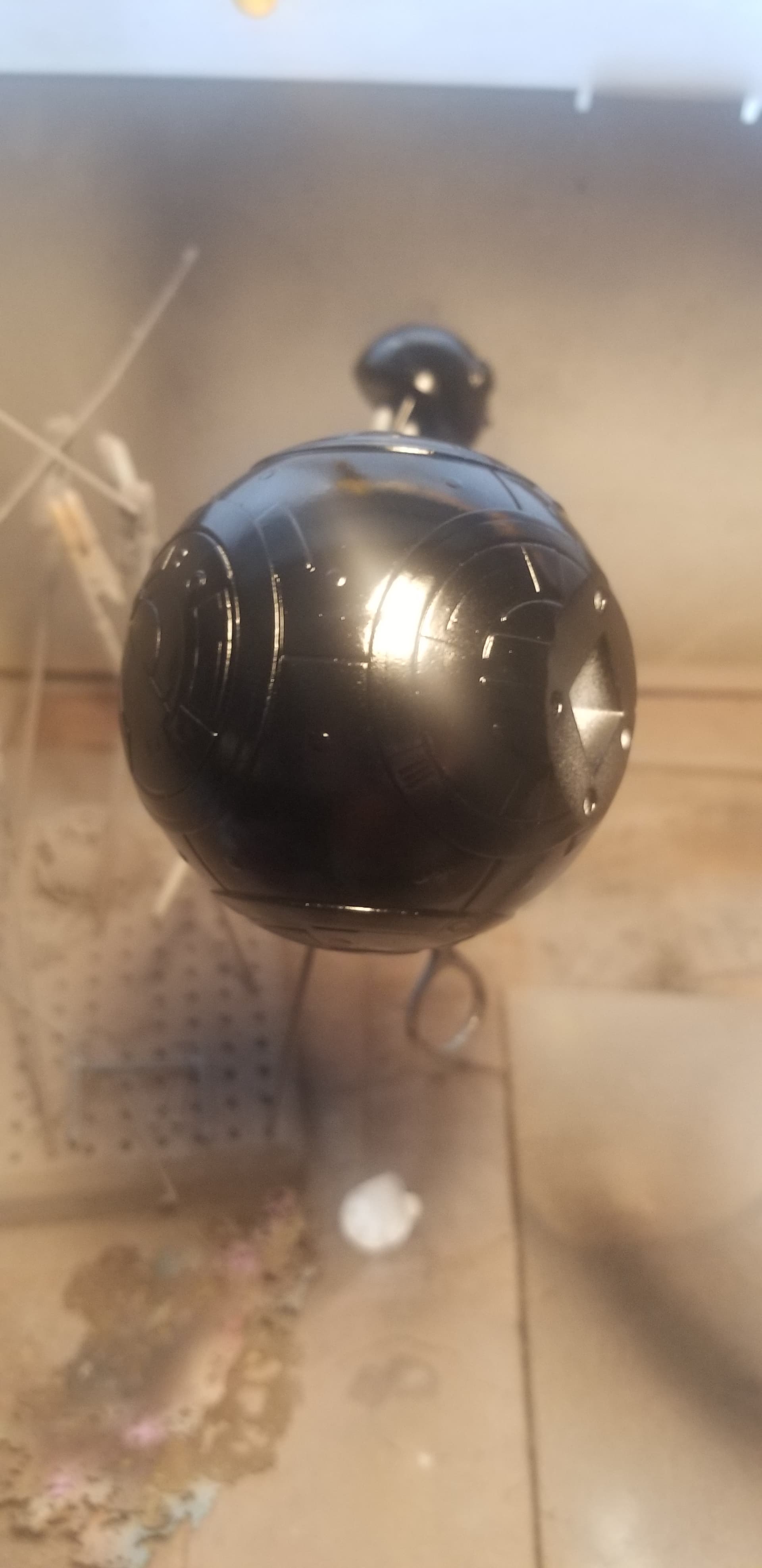

I sprayed the Gloss Black and it is beautiful. The packaging says the finish is equivalent to 1200 grit - I can’t argue with that!
This is straight from the bottle (one coat) on bare resin:
