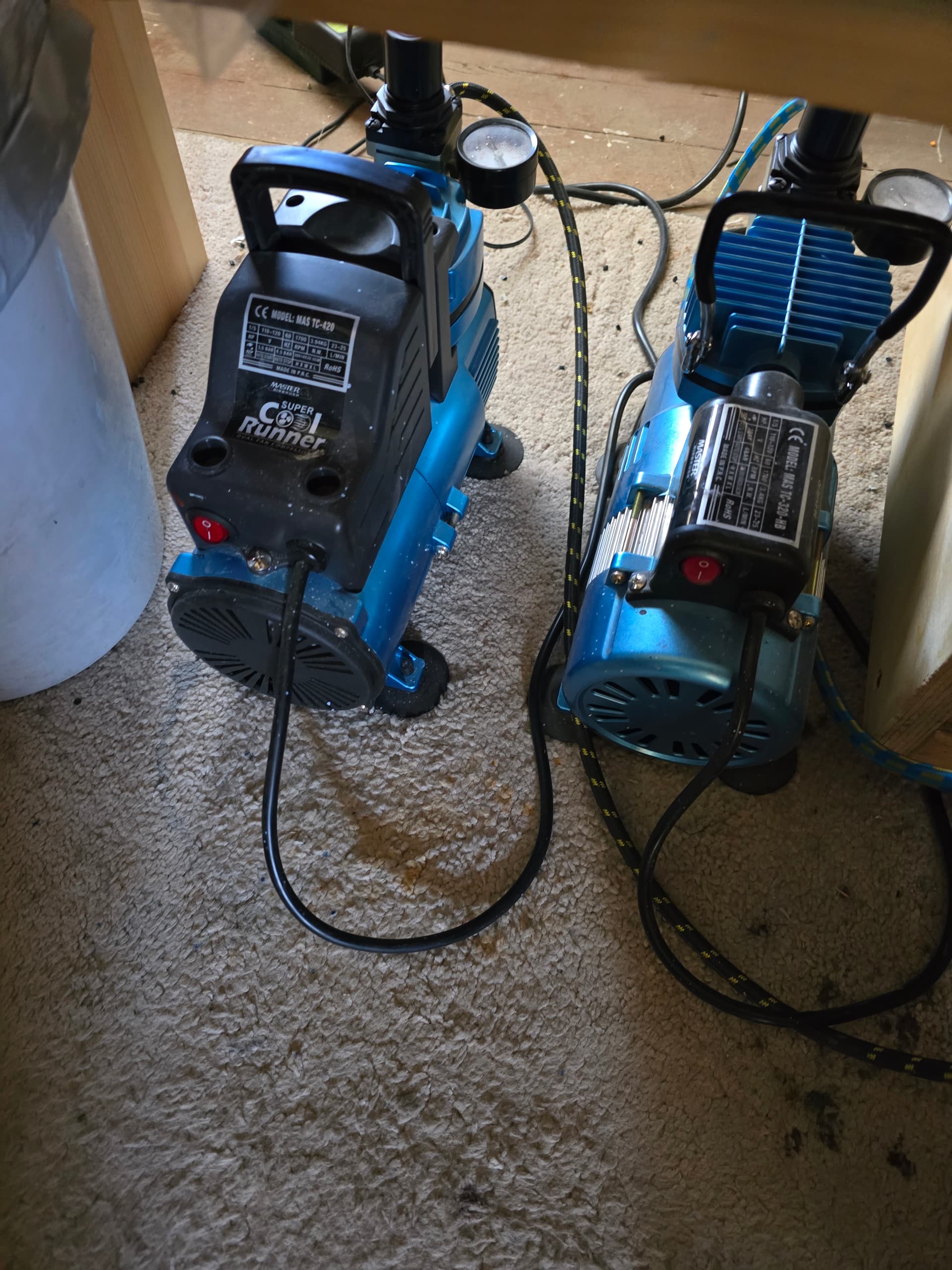

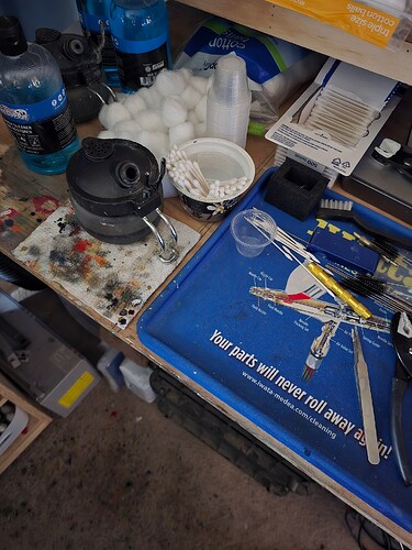

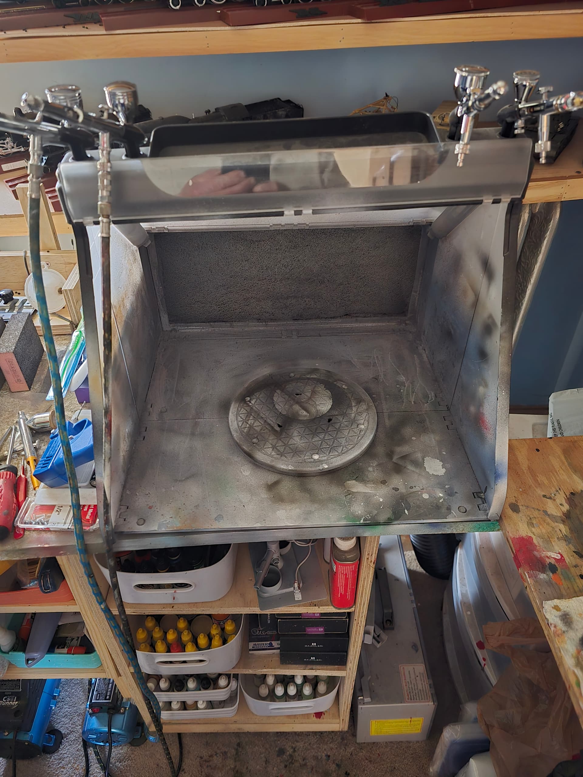

Just wondering how everyone cleans and maintains their airbrushes. Me personally i hae 4 Gaahleri airbrushes. The cleaner s i use are USA Art cleaner and restorer, Tamiya airbrush cleaner once in a while. I pull my needles every four uses, every ten uses they go in a ultrasonic cleaner with 90% Isopropyl Alcohol in it. When i do that it gets totally broken down, lubed up after its done. Here are my compressors, airbrushes, spray booth, cleaning area. The compressors are Masters brand.

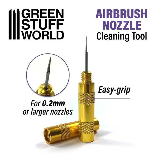

This thread is great info - I feel like I’m doing it wrong, but I just run out my airbrush with X-20A thinner between colours, and between models or after heavy use I use the same to wipe down disassembled components like the needle and give the nozzle a good probe with the spike…

Thank you for your response. I’m glad that it’s helping you. I own one of those airbrush nozzle cleaning tips. That is how i get my nozzles out for cleaning.

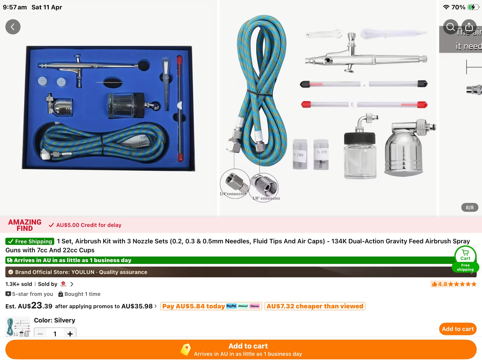

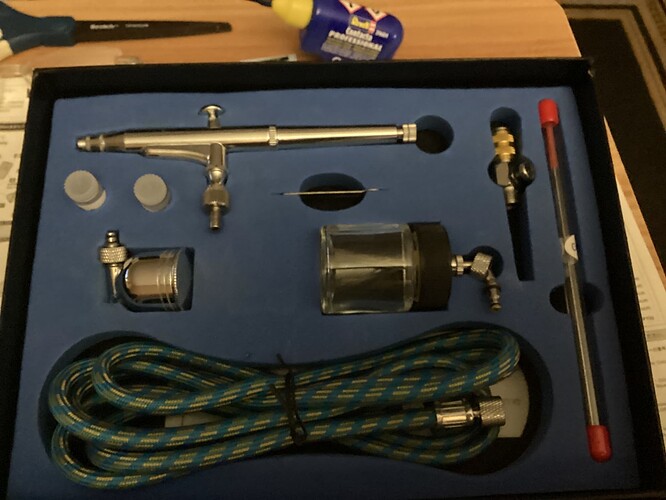

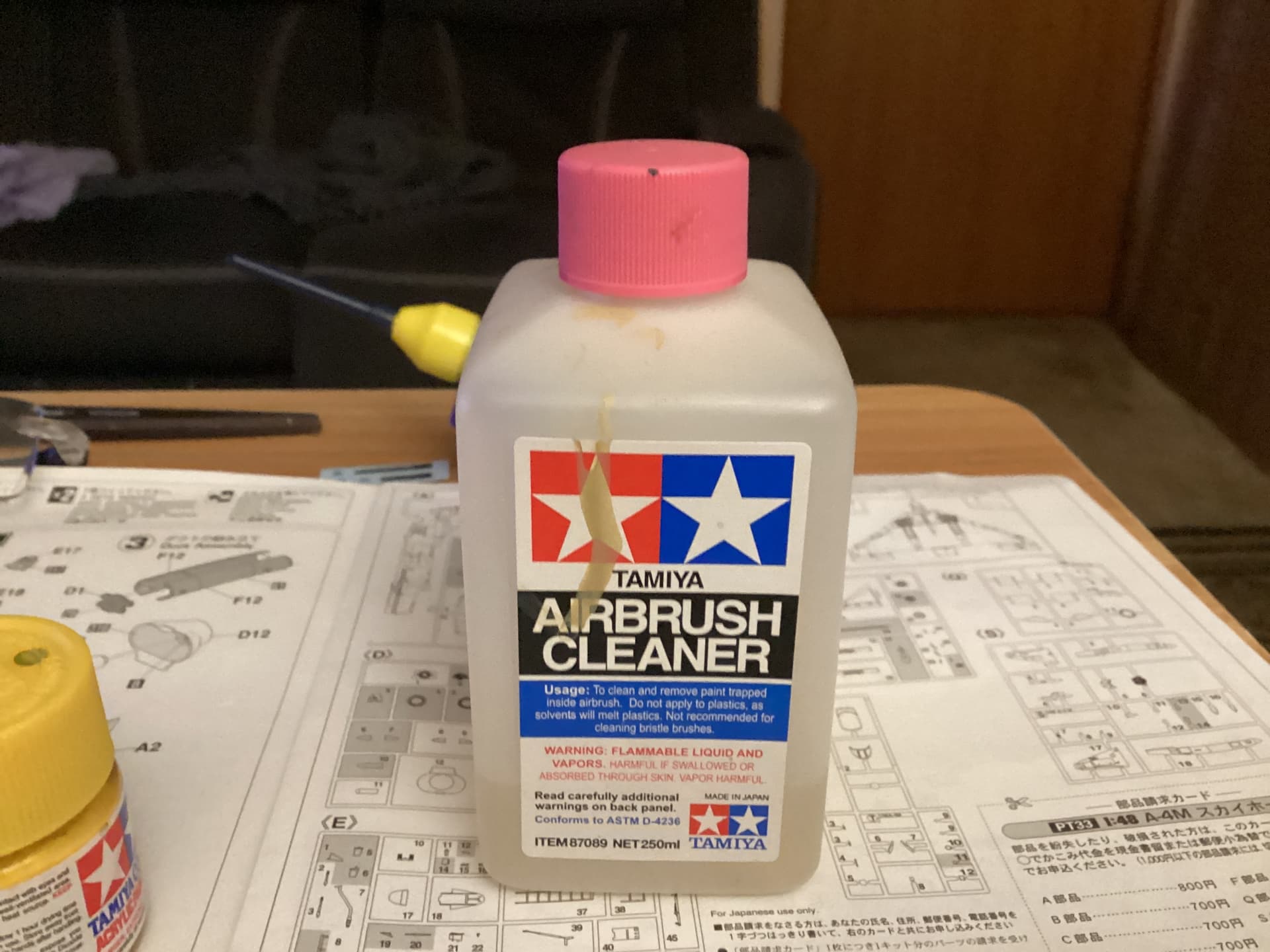

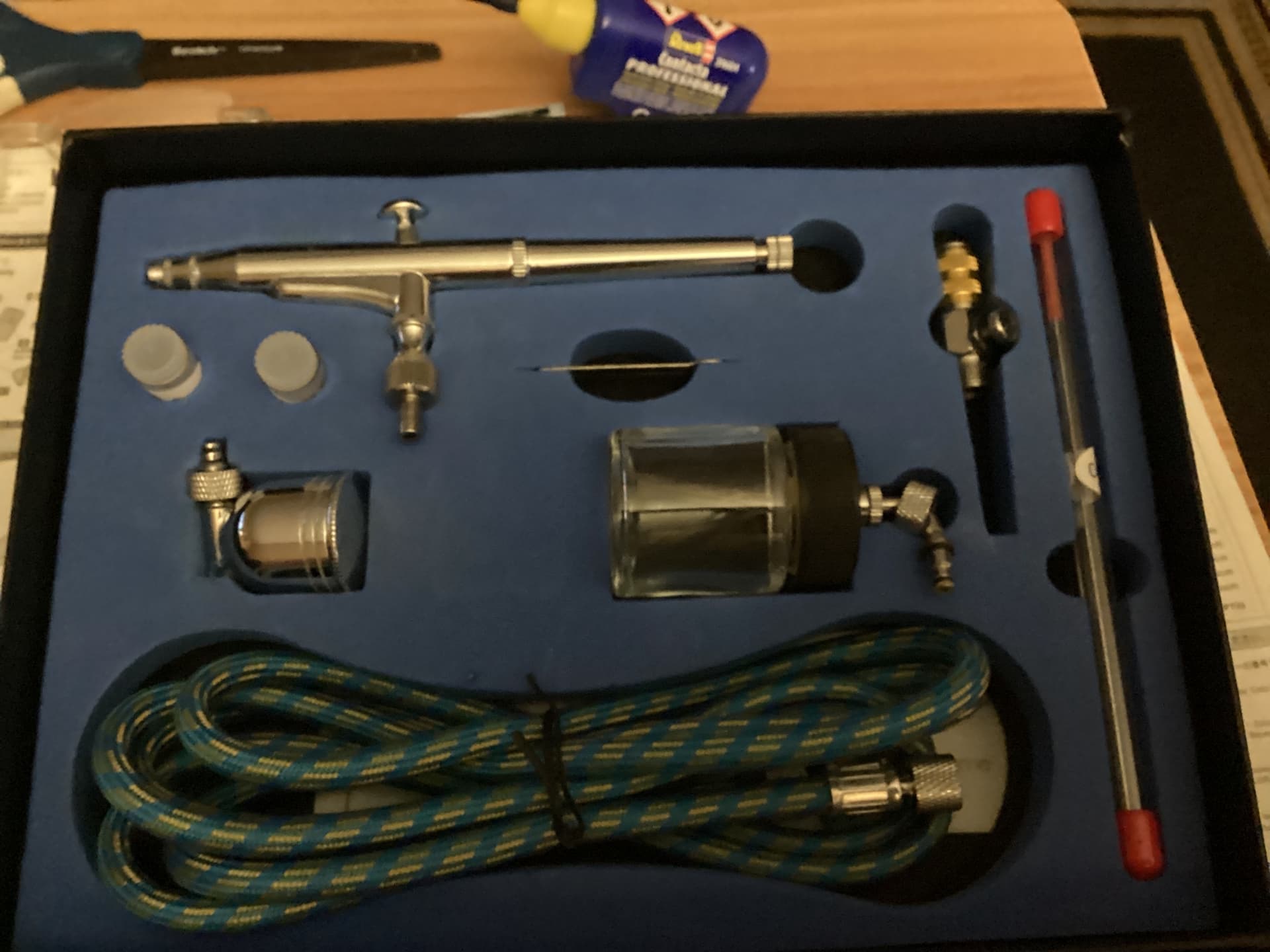

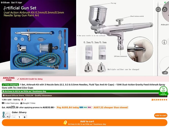

I pull the airbrush apart after every use and clean it thoroughly with Tamiya airbrush cleaner
Interesting, what brand airbrush is it.
I’m not sure of the brand but I have had a few airbrush guns and this has been the best one I’ve had yet . I got it on Temu for a fraction of the cost of a high end one
Gaahleri airbrushes start at $59.99, i use one just for primer. It was abused before i used it forl just primer. Iwata has good airbrushes, i had one before i switched to Gaahleri airbrushes. It basically a personal preference on what brand you want. I had a Talon, Masters, Iwata, Badger witch fell apart om me.

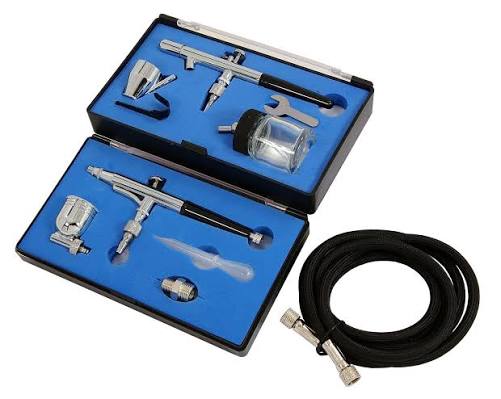

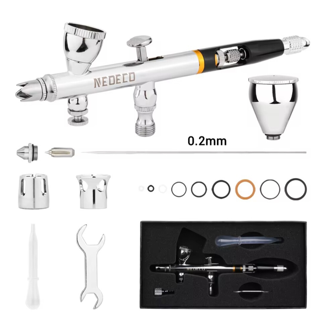

I have cheap airbrushes for primer and a Neoeco for more detail painting.
The Neoeco is a great brush that cost £23 off AliExpress and has a floating needle nozzle and 0.2 0.3 0.5 needles.
Nice airbrushes, never heard of that brand. Thanks you for sharing your method of cleaning. I’m finding this topic very interesting

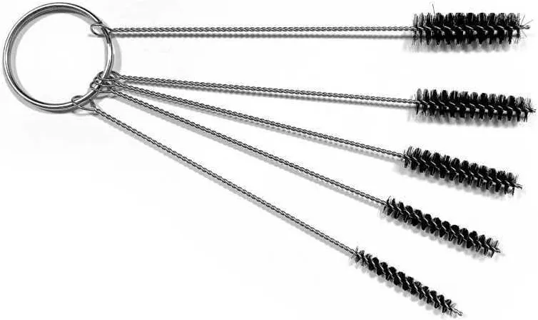

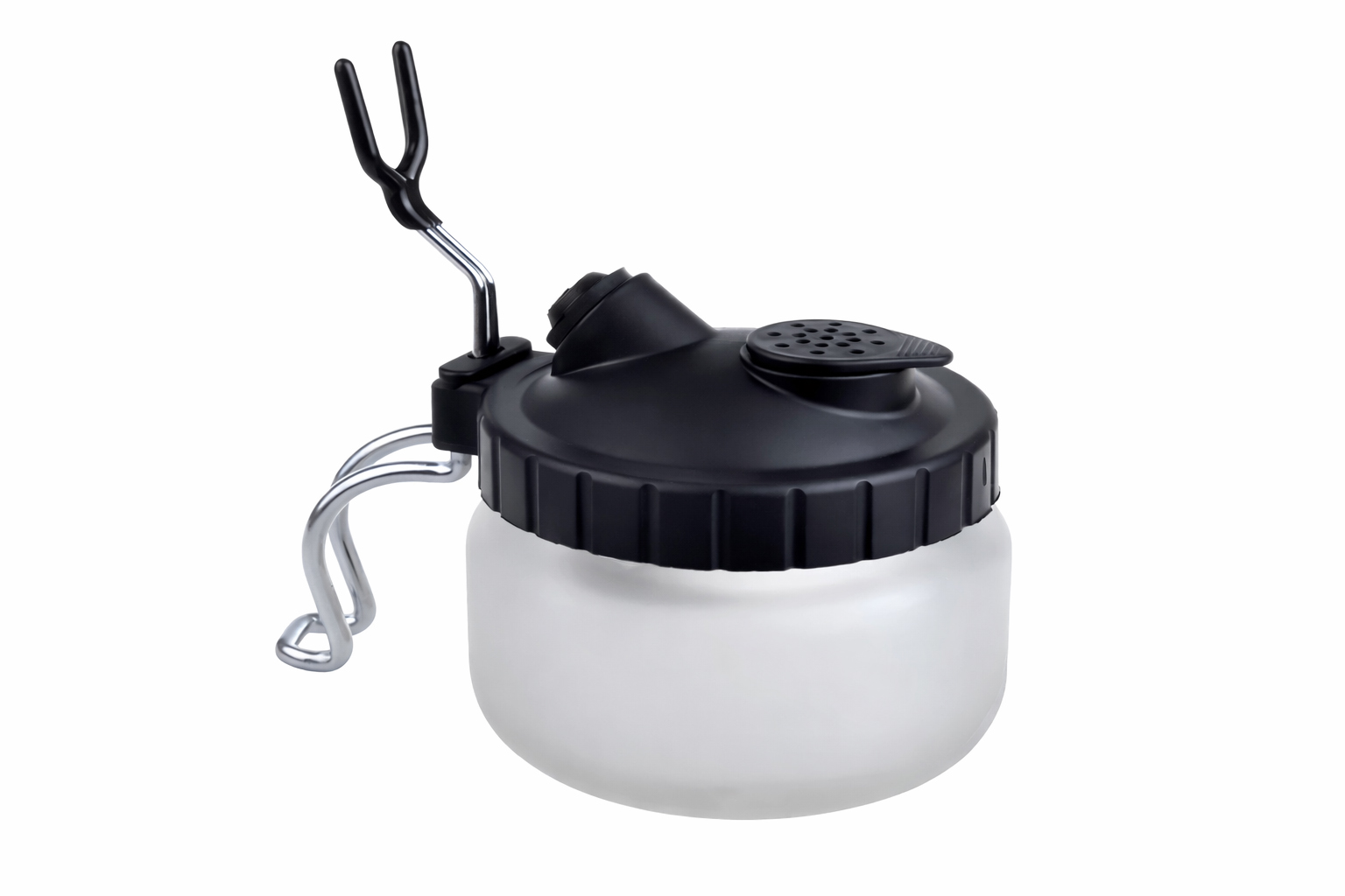

If you’re on a budget you could try IPA but get the 90% stuff or even windex spray but only if you’re using acrylics.
Also some cleaning brushes and cleaning pot
