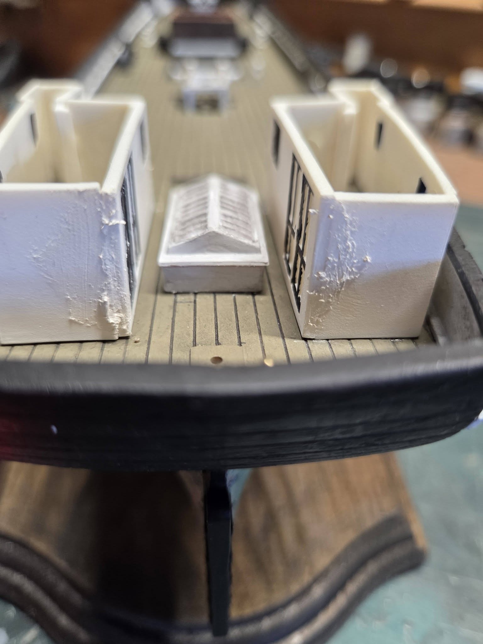

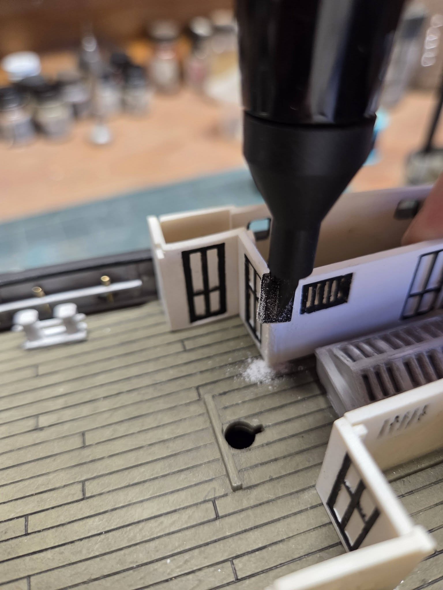

I got some bench time this morning on the aft cabins, gave the primary sand down on the corners, using my micro DSPIAE sander, then filled with Tamiya thin white putty, will re-sand tomorrow, touch up the white, then wash the walls down to dirty them up a bit.

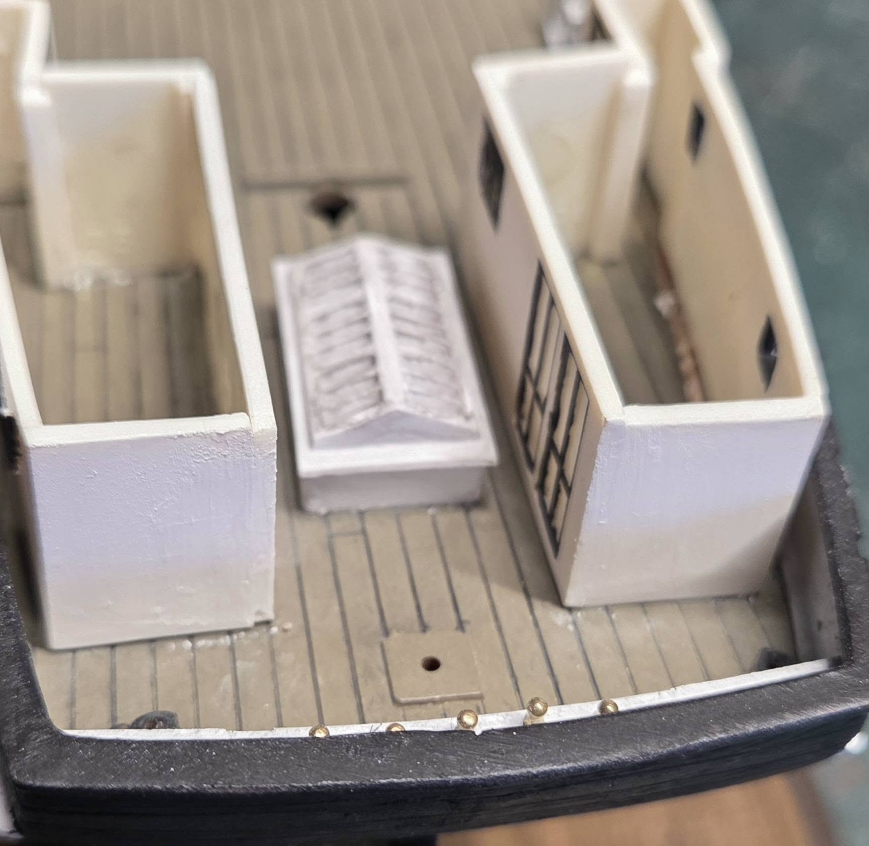

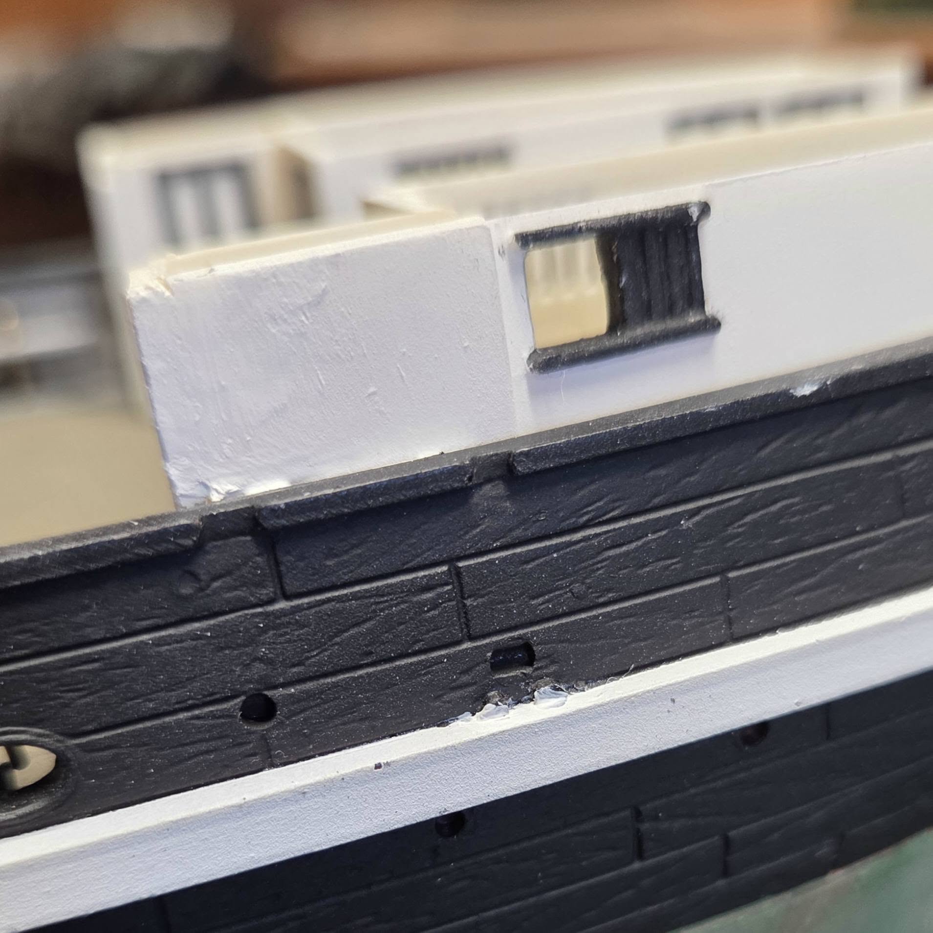

Got most of the final sanding done, once the basecoat of white dries, I’ll sand down one more time and trim the white a final coat. but the seams are fairly hidden. Crazy part of this is that you really won’t see because of other fixtures and rigging.
