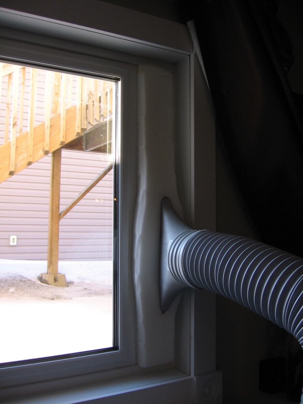

I’ve actually run into the same issue (Minnesota!). However I had an easy fix - my vent window is a basement egress window so it’s in a deep recess, and I ended up building a false inner window lined with insulation and a dryer vent port through which I can exhaust my spray booth. That way the actual window well stays cold all the time.

I bought the cord to run the hair dryer to defrost the window, but now I’m thinking it’s just too dang cold out anyway. -24 Celsius for a daytime high these days. It’s suppose to get less cold next week (I hate saying warm up. That doesn’t happen until May).
Curious……from your experience do you get cold air coming in through the vent duct during a painting session, or does the outlet fan pretty much keep it out? I suppose it depends on the strength and direction of the wind outside?

With the fan running, no air comes in at all. It’s a pretty good blower.
But I have to make sure to reach through the vent hole to close the window, and to put the little foam plug into my duct hose or else cold air just POURS in, since I’m below grade.
@Toimi_Tom That’s a nice solution. I like the wood grain you’ve chosen.
My set up is quite basic. I went with the same solid insulation.
